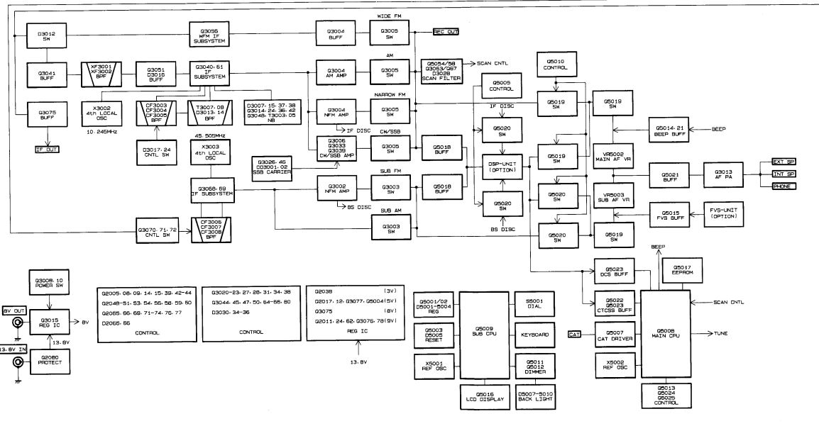

    I have had this radio in the workshop for some time now and am getting no-where with it. Customer reported complete loss of receive, when asked it was working one day and the next no receive. I was able to obtain part of a service manual which is little more than some pdfs of board layout, block diagram and circuit diagrams, none of these are searchable.
    Connecting this to a sig generator confirms the radio is completely deaf, I mean nothing, nada with a starting signal of 5uv upwards, I have checked this across the five bands this scanner covers and same result. Everything else on the radio works fine display, menu's buttons etc.
    Does anyone have a more complete service / technical manual for this radio, and any ideas where to start a (list of voltages and test points would be useful). I would post pics but there is nothing obvious to note on the boards just a pile of smd stuff.
    Thanking you all in advance

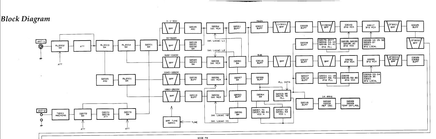

      Sorry my mistake, when I mean completely deaf there is simply no received rf signal, maybe the PLL is unlocked but there is plenty of static coming the speaker just no received modulated signal irrespective of frequency block or mode. One board is the RF board and the other board is the IF board plus the control board etc. I'm not sure where to start injecting a rf signal.
      I'm including scans of the block diagram to kick off.

        Re: Yaesu VR5000
        as long as you got static coming out, the PLL is locked. An unlocked PLL acts like a squelch set up high, mute button pressed etc.
        Maybe one of the IF amplifiers is dead? I had that happening on a TS-450SAT.
        did you check both antenna inputs?

          Re: Yaesu VR5000
          Nods, I checked both antenna inputs there is no difference between them. Thanks for the pdf, looks like there are some voltages on there to check and additionally I was able to find an alignment guide for this radio. There are some basic test points there to look at, not that I am looking to align the radio but there are some checks there that will confirm some of whats working and not.
          Will keep you updated

            Re: Yaesu VR5000
            Same thing happening on the main and sub VFO? Does the S meter do anything? Look at the first schematic on the left (scroll towards the bottom) there are test voltages for locked, unlocked and mute.

                Re: Yaesu VR5000
                go to the IF filter and spray some RF from a frequency generator in it. this way you can tell where roughly the problem is.
