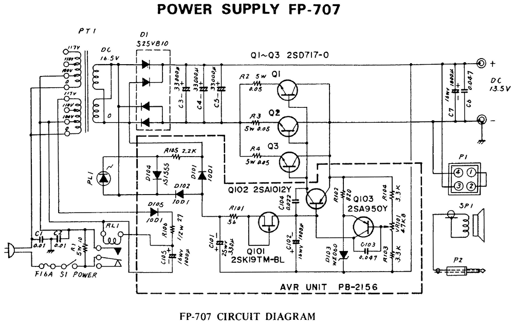

    I'm trying to fix this for my buddy. The power supply would power up, put out 13.8v but drop to 0v with any load.
    He tried to fix it by replacing 3 caps in the "AVR" board, that didnt work.
    I fired the parts cannon and replaced 3 "10D1" diodes with 3 "sk3081" diodes I had, a new 35 amp bridge rectifier, I tested all the other components and for the "2SA1012" was subed with a ECG "TIP53" and I replaced that with a "D45H8G" and same results, 13.8 and 0v under load.
    I pulled the 2SD717 regulators and they all tested as 2 resistors so I assumed they were dead.
    I replaced those with 3 "2STW100" parts and now I did a quick pulse of 120v and its putting out 22VDC
    Is it because I used 2STW100 which is darlington type?
    I'm out of ideas.
    thanks

        When it craters, can you measure the voltages on the error amplifier Q103 and maybe Q102.
        Be careful it's got huge filter caps 99,000uF which can hold a big charge. I would make sure they are discharged through a say 1k resistor before going in there.

          Install the proper transistors for Q1~Q3, I don't think those 2STW100 will work.

            Yeah the PSU will have too much gain and would oscillate with the Darlington pass transistors...
            The JFET current-source is interesting in that it gets a -ve voltage supplied.
            There was a day when people would troubleshoot and test transistors. There's only 6 in the Yaesu.
            I think the cannon got fired too quickly, might be best to aim it first lol.

                In that style PSU most of the time the problem are the pass transistors (2SD717). I’ve repaired tons of these.

                  What are you using as a substitute for 2SD717?
                  I think I'd use (real not Ali/eBay) 2N3055G or 2N3772 but TO-3 package parts are quickly being discontinued.

                      And yes Redwire I hooked up a car tire pump and it was oscillating up and down. So I guess thats a fail.
                      R_J yes TIP3055 are $1.50 and in stock. Guess Ill grab them
                      thank you all for your tips I appreciate it.

                        The SD717's are not darlington's. The TIP3055's are a good replacement fit.

                          ya I seen it say darlington and I just chose to ignore it. Live and learn but now I know to avoid them. Problem solved I hope

                            I just finished installing ST tip3055 (3) and its working great. Thank you for the tip on the tip.
