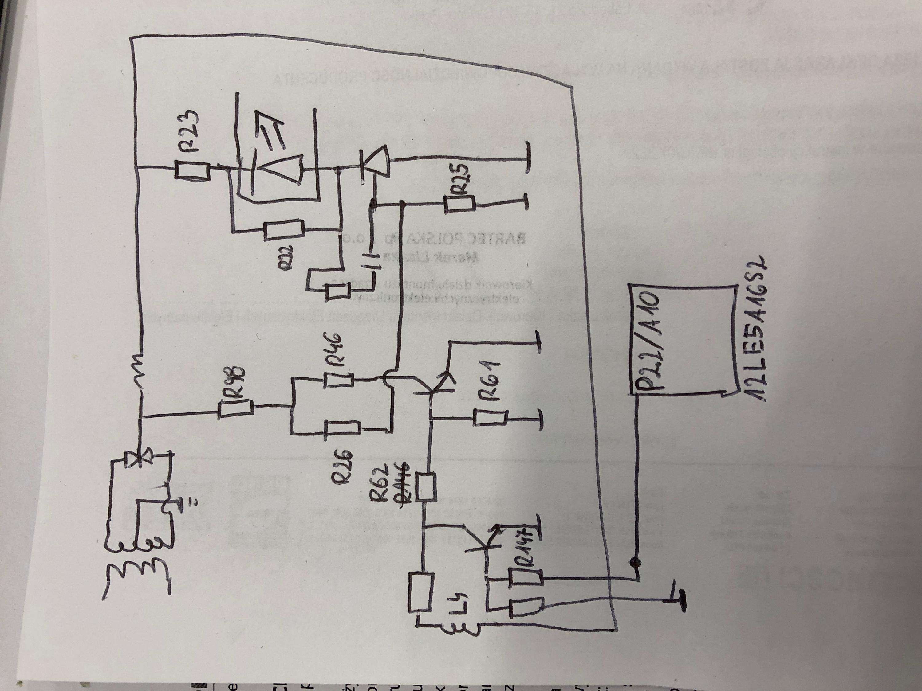

      I also have a device that doesn't work. After switching on the power supply instead of 30V I have 8.3V.
      I drew a converter feedback diagram. I came to the fact that it blocks the signal fed from the 12LE5A16S2 processor to the R147 resistor. After desoldering the R147 resistor, the inverter works correctly and has 30V, but this is not the solution to the problem.
      I am asking for any suggestions.

        Re: Marshall Stanmore Repair
        Image is too small
          A larger picture is attached.
          Edit:
          I measured that instead of 3V on TAS5508C power supply I have 0.6V

            Update:
            What voltage should come out of LM317??

              Type this into GOOGLE: LM317 DATASHEET

                LM317 had the same protector signal as the inverter. After desoldering another resistor all voltages have already appeared correct.
                Unfortunately, no functions are still working.

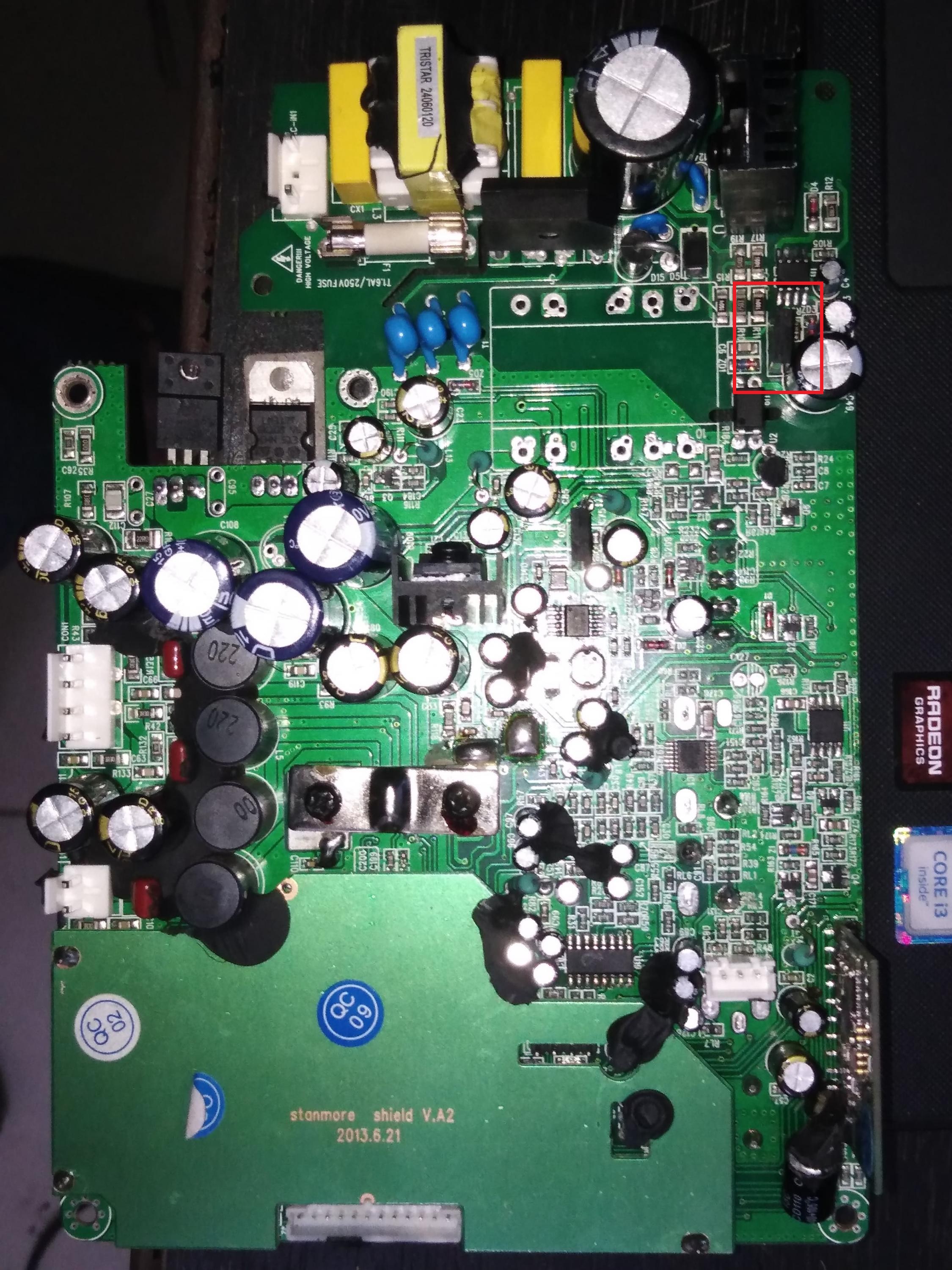

                                  Hello, I purchased a used Stanmore (1st edition) and while the unit turns on, LEDs working, Bluetooth connecting and staying a solid red LED, the sound will turn off when switching media apps (playing music, then playing a YouTube video, then back to music). The issue is very odd, as sometimes when I unpair and re-connect to Bluetooth, music will play, and sometimes it won't at all no matter how many times I try to unpair, unplug, and reconnect...
                                  Speaker works just fine when connected to AUX... I have been able to replicate these no-sound issues with BT over 3 phones in total (Galaxy S7, A50, and iPhone 6S).
                                  Marshall is willing to repair the issue (non-warranty repair), having me pay for shipping. But if I can repair by swapping out a 10 cent part, then I would prefer to try that. However, I'm not sure if Marshall would still repair if I opened up the back...
                                  So has anyone here experienced my issues with speaker working fine with other inputs except no sound on Bluetooth even though it is connecting successfully?
                                  Thanks.

                                    Also, if anyone has had success swapping out the 8-pin surface mount DIP MC34063A who was experiencing my issues (Case#1, Bluetooth connecting but no sound), I would be very grateful if you could try to guide me in how to check the voltage on the part, and anything I need to be aware of when replacing. I have a basic multimeter, and an OK soldering iron kit. My experience is beginner in the electronics field, I've successfully swapped out a damaged micro USB port on a Logitech Bluetooth speaker, so I have confidence in my soldering abilities.

                                          So I received the replacement IC chip (MC34063API) and after a long and arduous effort to solder this larger thru hole component onto a surface mount board, the original intermittent bluetooth problem persisted...
                                          I have already sent the speaker to the authorized Marshall repair shop out of province for $35 CAD to get it fixed.
                                          Hopefully they don't have an issue with the fact that I have a jumper wire from one of the IC pins to the connecting smd capacitor as the damn pin track came off as soon as I touched it with my solder wick
