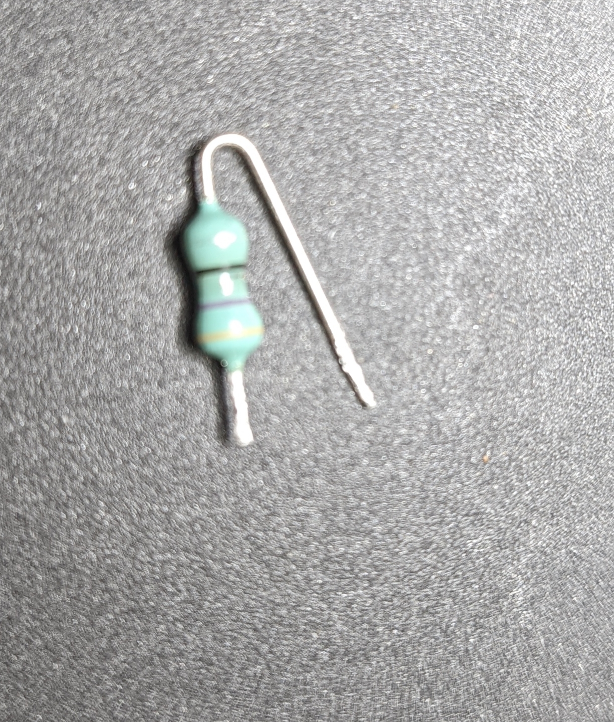

                          Re: Marshall Stanmore Repair
                          Hi Folks,
                          I was finally able to find the issue with my Stanmore, after changing the 12v regulator which is in the middle of the PCB (KIA 7812A) i found out that it's not getting any input current, had to remove it again to trace the input which is feed by L7 it looks like a normal resistor it was a bit toasty, I'm not sure why the numbering on the PCB says L7.
                          my issue is number 2 from the first post, everything works without sounds output.
                          I changed that L7 with a normal 47ohm resistor and I got sound.
                          attaching a picture of L7 location.
                          • SkyHeart
                            • Jul 2022
                            • 11
                            • Sweden
                            #113
                            I think it's an Inductor not a resistor, for me it's the first time I see an Inductor in the shape of a resistor
                            it's been a while since last time I worked with Electronic it's been more than 15 years.
                            thanks for the help guys.

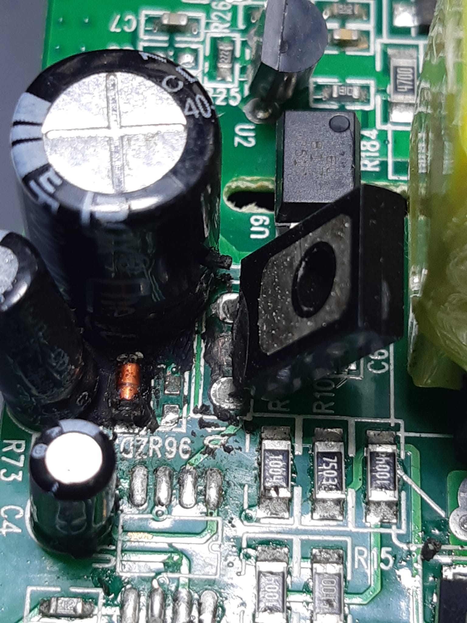

                                Hello guys,
                                R96 is burn can you help me with its value?Thx

                                  #116
                                  Originally posted by DeeJayAlex
                                  Hello guys,
                                  can you post a picture of the location?

                                      #118
                                      Hello guys,
                                      on mine R96 is 10kOhm, (labeled "01C")
                                      Do you know / could you check the values of ZD1 and ZD3 please if it is still open ?
                                      Regards

                                        #119
                                        The Location of R96
                                        Thx.
                                        • DeeJayAlex
                                          • Aug 2016
                                          • 6
                                          • Romania
                                          #120
                                          Regards
                                          Thank You for reply!
                                          ZD1 and ZD3 seem to be ok(0,7mV on diode check)
                                          they are zener diodes, which unfortunately I don't know what value they are
                                          Soon I will start to repair it and if it is successful I will check the voltage drop of the zener diodes so that we can figure it out and I will let you know.
                                          Regards.
