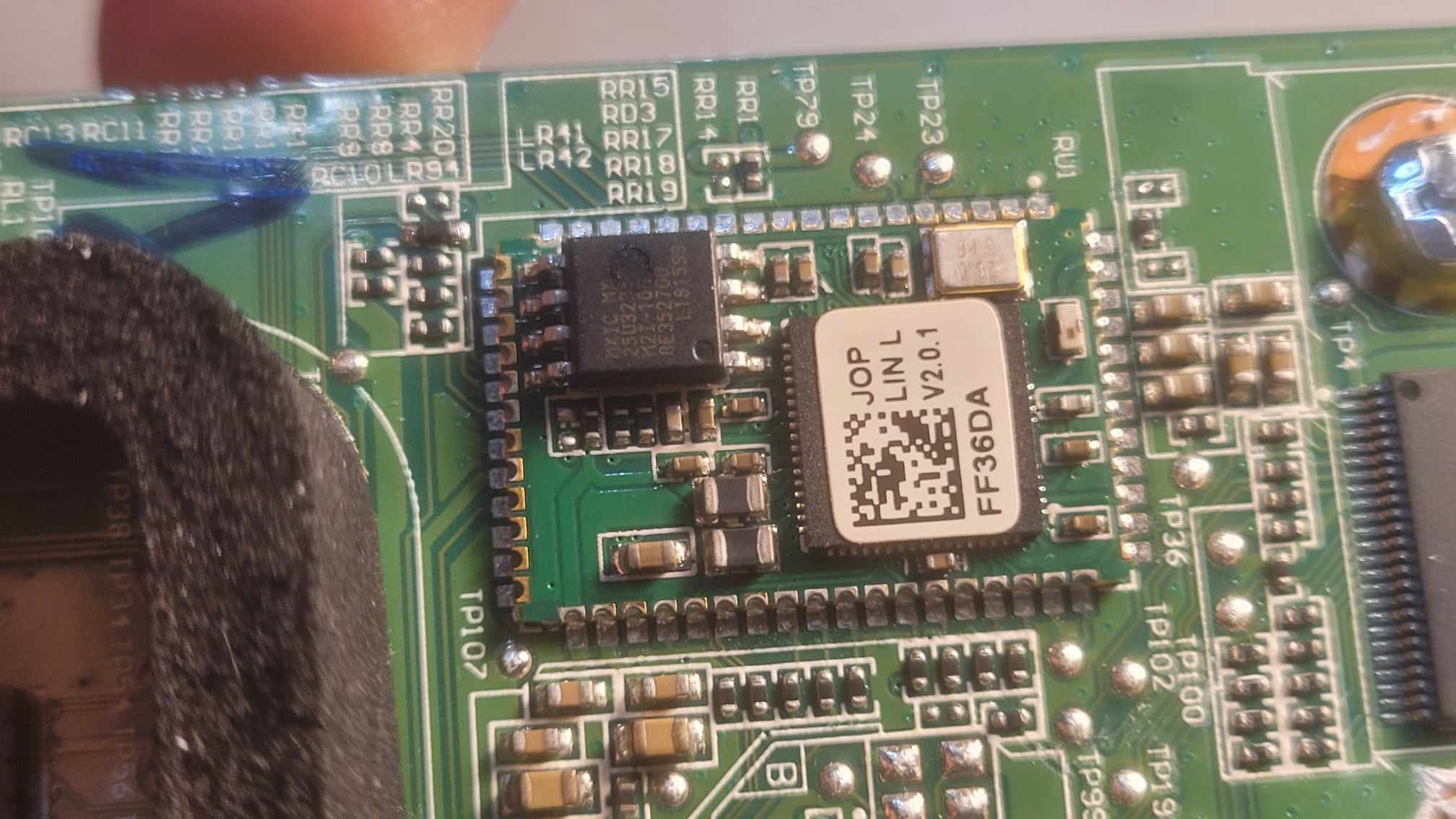

                            • lotas

                              Looking at the photo of the board, we can say that the main firmware is in the STM32xxx controller, and what you posted is the firmware of the wi-fi, bluetooth module.

                                I was really hoping that wasn't the case. In my experience so far with speakers, the firmware has been in a bios/cmos/nor type of chip. I haven't had to do anything with micro controllers. I have had very bad luck desoldering chips. I'm going to have to practice a bit more while attempting not to destroy my live unit.

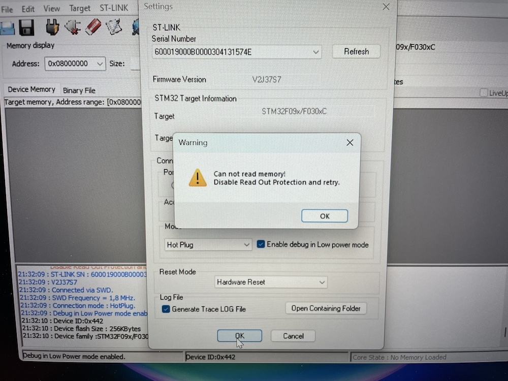

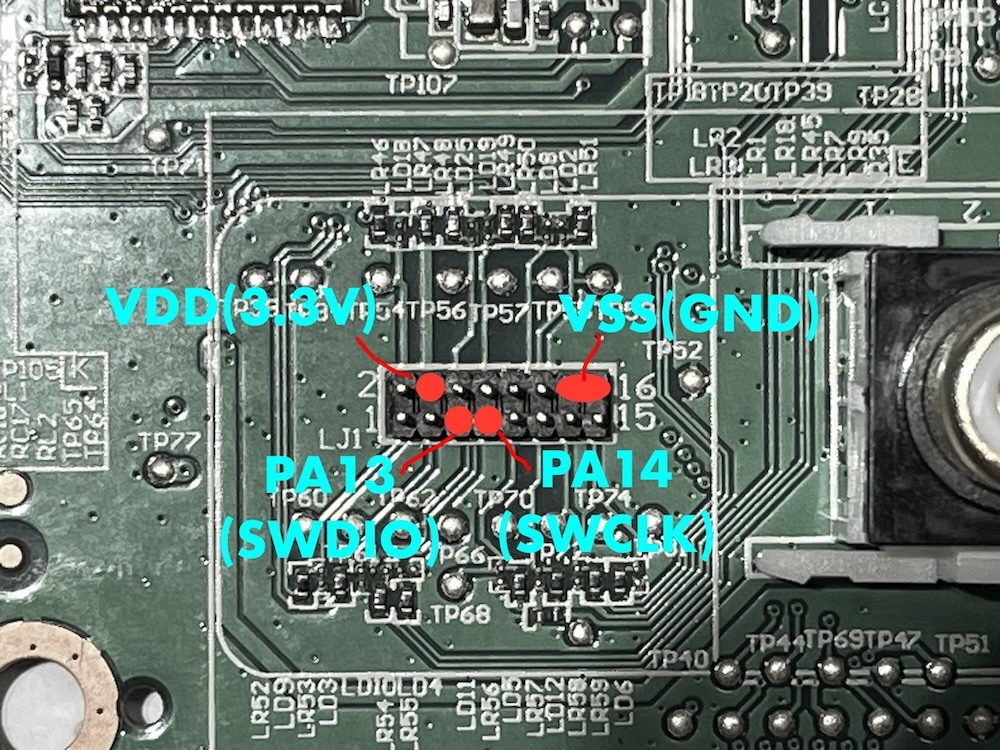

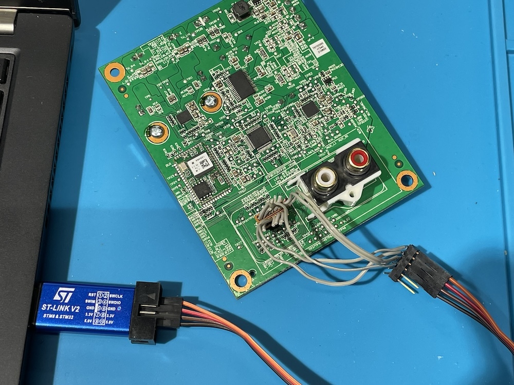

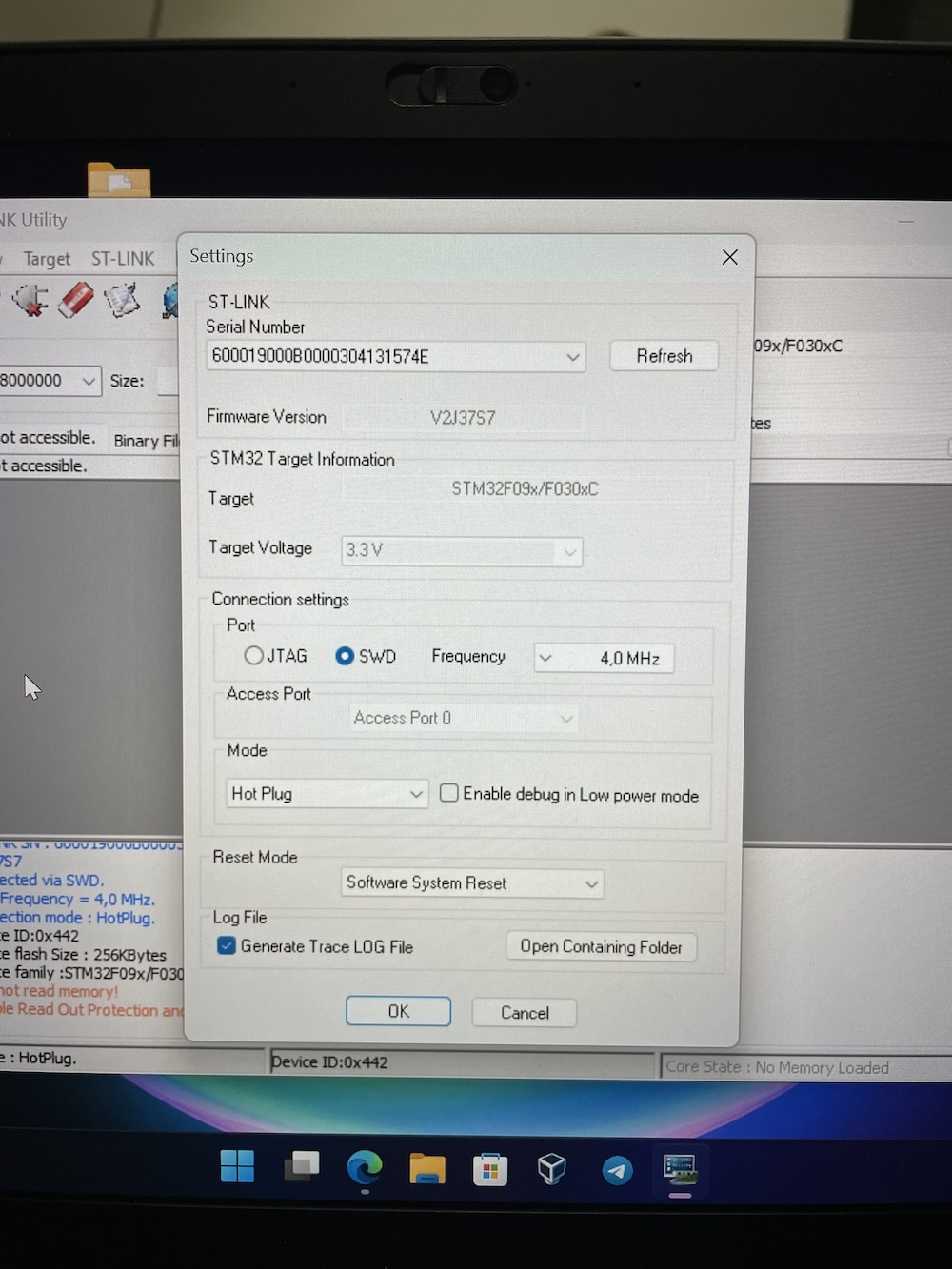

                                  I'm trying to read my potentially bricked STM32F030CCT6 controller. I've bought ST-Link V2 doungle, learned chip pinouts for SWD connection with ST software. Interesting that all necessary pinouts are on "Service Port" so no soldering needed. For now my best result is establishing connection with the chip but i have the "Memory read protection" error which is caused either by my incompetence or internal chip error. Now I'm going to buy blank STM32F030CCT6 for experiments (it's cheap) and later read firmware from working board if I will able to do it. Working board I will have in 1-2 month.

                                    Most likely there is read protection (by default the protection is “0” and in the defer mode you can read the contents; if the manufacturer has set the protection to “1” or the maximum “2”, then when you try to read (unlock the protection) the data will be destroyed and your device will turn into a brick .

                                      Can you share more of this software and pin info? I'm only familiar with CH341a programmer and Neoprogrammer. I can start experimenting with mine if I know what I'm doing.

                                        Yes, sure. You need to use pins 2, 4, 6, 8 on the dongle and pins 4, 5, 7, 16 on Service port. Hope my drawing will help you. But be careful, looks like lotas is right about possible data destruction after read attempt. The software i used was STM32 ST-Link utility. Yo can download it for free after registration on st.com. Connection settings that worked for me are on the photo, but you can try different. Also i suggest the Service port has USB pins for firmware restore but I don’t know for sure.
