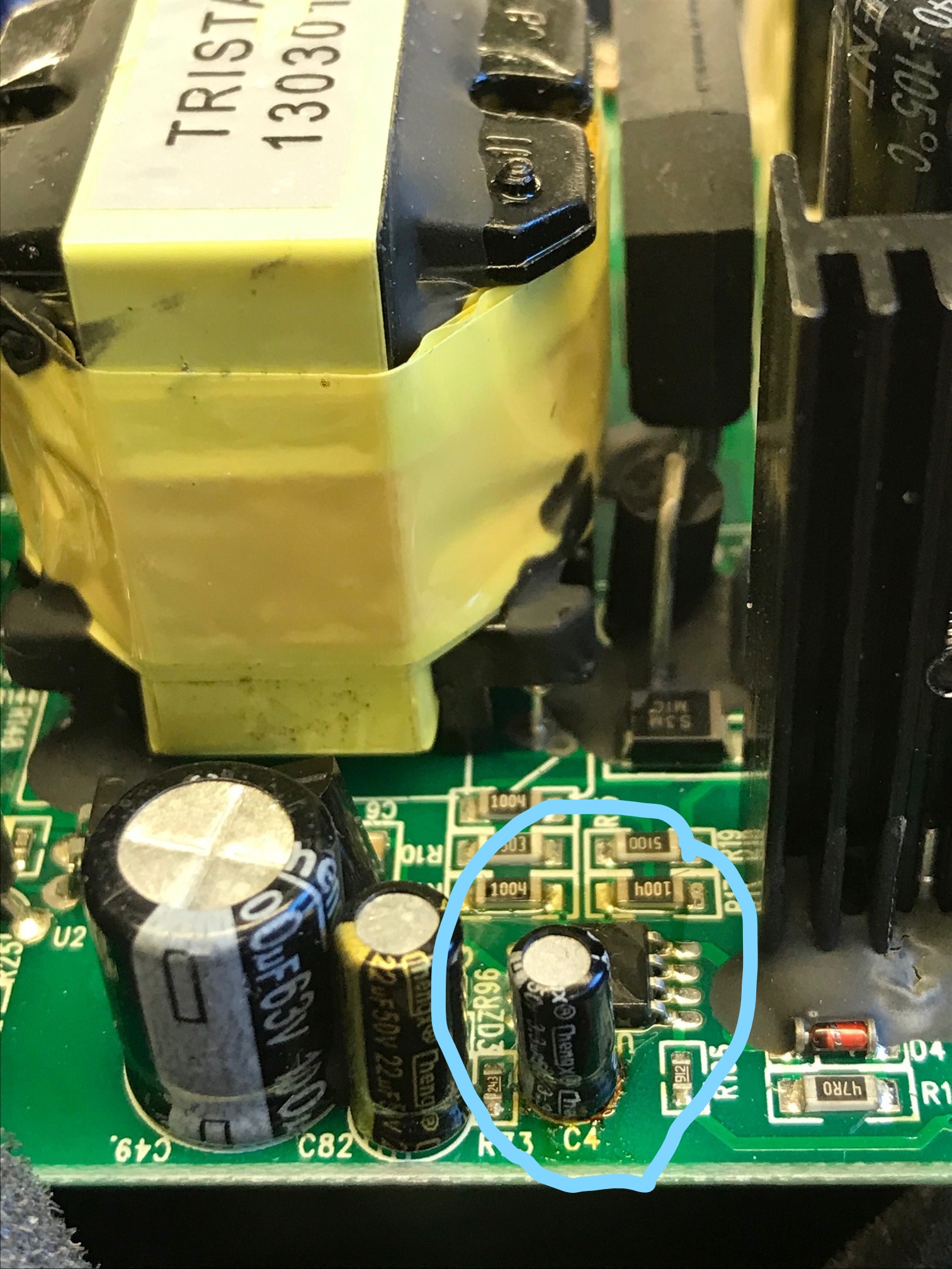

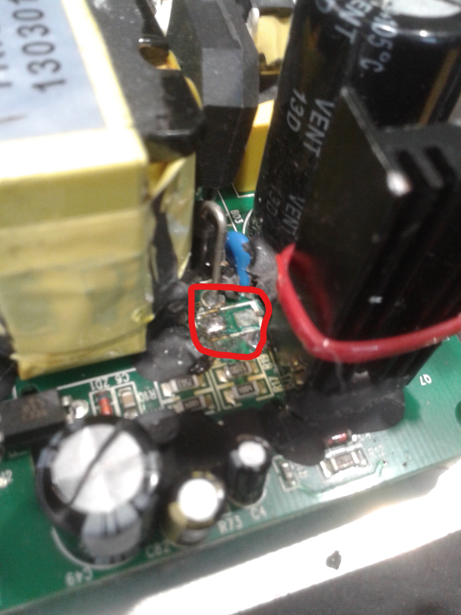

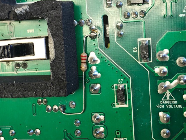

      Interesting thread. I have replaced the burned R23 (220 ohm) with a bigger resistor underneath the PCB. I have attached a picture so you can see how I have done it.
      I have also a picture for you who have problems finding the 3.3 uF capacitor.

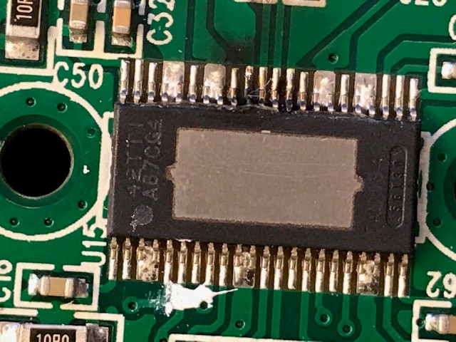

        Update:
        The power amplifier was fried and the 7812 IC together withthe shorted D7 located underneath. Everything replaced except the amplifier.
        The unit started up and this time the bluetooth worked as well Could easy pair it so there is hope for the unit but we see when I receive the power amplifier.
        The amplifier IC has the marking 42TTI A87CG4 (?) but someone else suggests that it could be a TAS5342A IC?
        Has anyone information what the amplifier IC could be?

            As mentioned earlier in this thread U15 is a Texas Instruments TAS5342A (100w Class D amplifier with digital input) in a 44pin HTSSOP package.
            Data sheet: http://www.ti.com/lit/ds/symlink/tas5342a.pdf

                Originally posted by michel91
                Hi Hann,
                I've read your post with great interest.

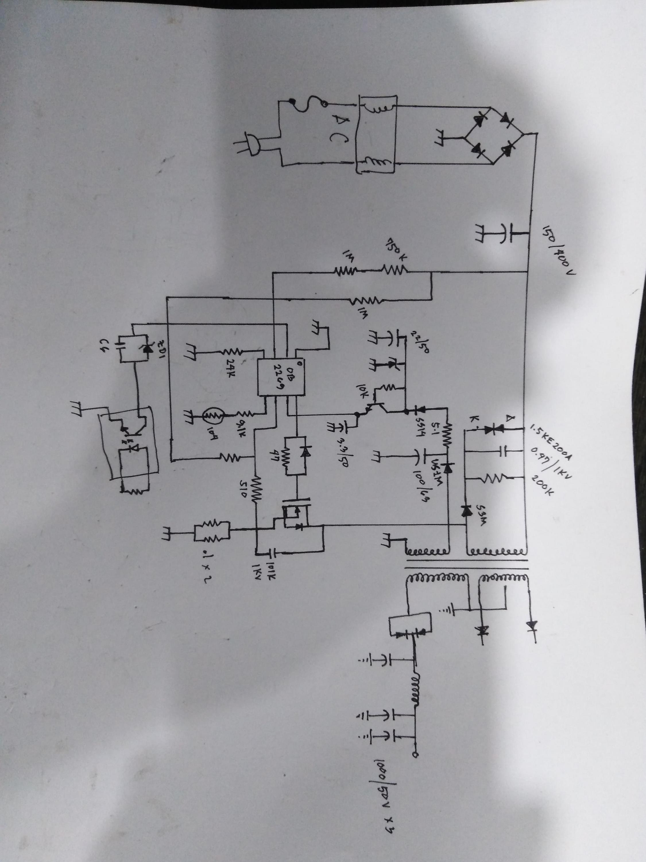

                pla see my drawn schem its near OB2269

                  pls see attached

                      I have one that is experiencing option #4
                      I'm going to change the 3.3uf 50v cap. OF course its marked C4! BOOM! lol
                      i'll post back if it works.

                                  In the post #68 above here is a scheme where your coil would be at the bottom of it, joining two of those three 1000 uF caps. It is L1 as marked on the PCB.
                                  I don't a goop there but because of those caps surrounding it, I can barely make out that there is any markings on the coil.
                                  I would hazard to guess, if you didn't interrupt the coil wire, then it will be OK. Measure across it if you get some resistance, it will be OK. I can measure on it tomorrow to give you resistance value which I would guess will be close to short since the coil has thick wire with just a few loops, at least judging by the outline of wire on the shrink wrap tubing enclosing it.

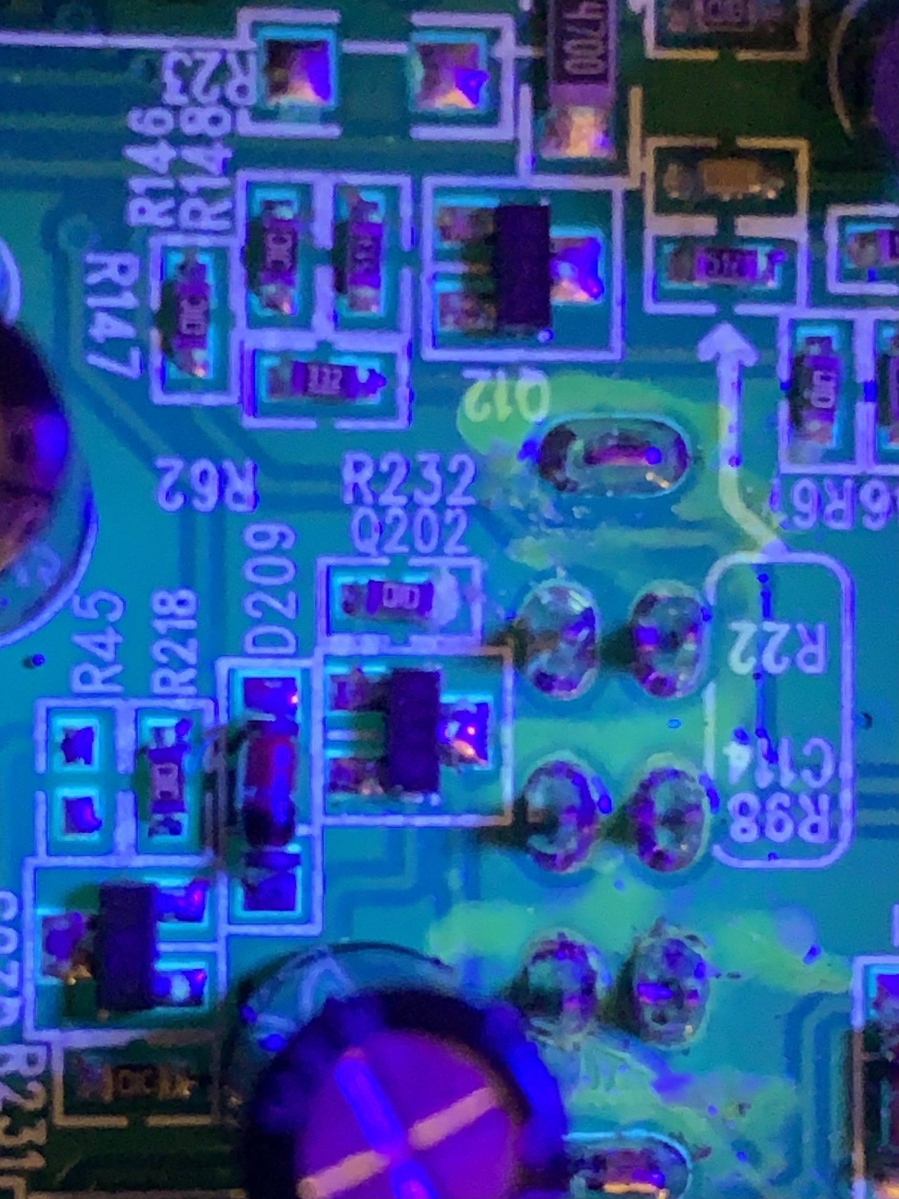

                                      • 6krray
                                        • Oct 2020
                                        • Japan
                                        #79
                                        Re: Marshall Stanmore Repair
                                        I have a Marshall Stanmore AMP that's 2 years off warrantee and have started to make a low pitch > High pitch noise upon power on and stopped playing audio.
                                        It might have been a bad practice but by turning on > off the device a multiple times (like 3 times), it was able to return to it's normal state for a while but seems it's not able to do that anymore.
                                        I've opened the backpanel and noticed these 2 points as seen on the attached image.
                                        1.R232-Q202 Cap seems to have exploded.
                                        I'm not fond of these but is this a cap fuse? Does anyone have any info on what I should be using as a replacement?
                                        2.C8 Seems to be an empty slot which seems to have had a cap.
                                        Anyone have any information on what was/should be placed there?
