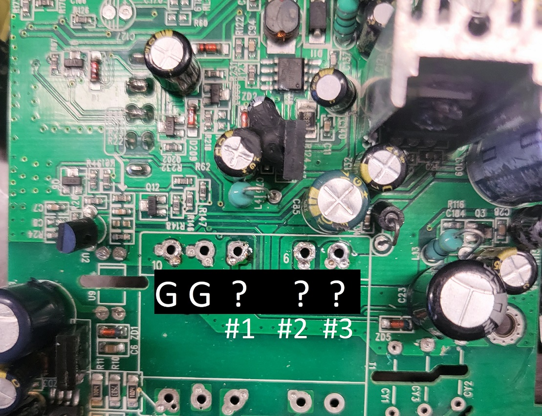

    Could someone tell me the cold side voltages coming out of the transformer?
    Hot side is completely buggered, so I think i will bypass it and use different switching psu.
    My tristar transformer is showing opens.

      Re: Marshall Stanmore Repair
      This speaker barrel has 3 outputs
      # 2x14v and 1x30v
        # 2x14v and 1x30v
        Hmm... Which voltage should go where?
        Two first are the grounds but what are the other 3?
        Thanks in advance.
          #3-30v DC
          #1 and 2-14v DC

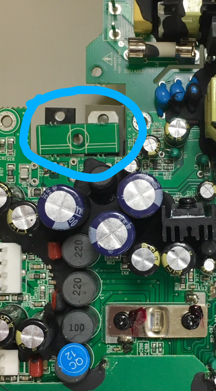

            Hi.
            I have successfully repaired two stanmore. Both had identical faults. 220 ohm resistor to optocoupler burned. I have replaced all capacitors on the hot side. I have changed Mosfet,pwm ic, various resistors including 0,1 ohm shunt. I have replaced everything between pwm ic transformer output and the pwm ic. All diodes except the full bridge. All rectifier diodes after the 3 transformer output. 7812 and power amplifier. Both are now working but one of them have a high pitch transformer whine that also leaks into the sound. If I mute the sound the whining can be heared very clear out of the speaker.
            Does anyone have any idea what i could do?
            I have changed all 1000uf,470uf and 220uf capacitors as well.
            Regards

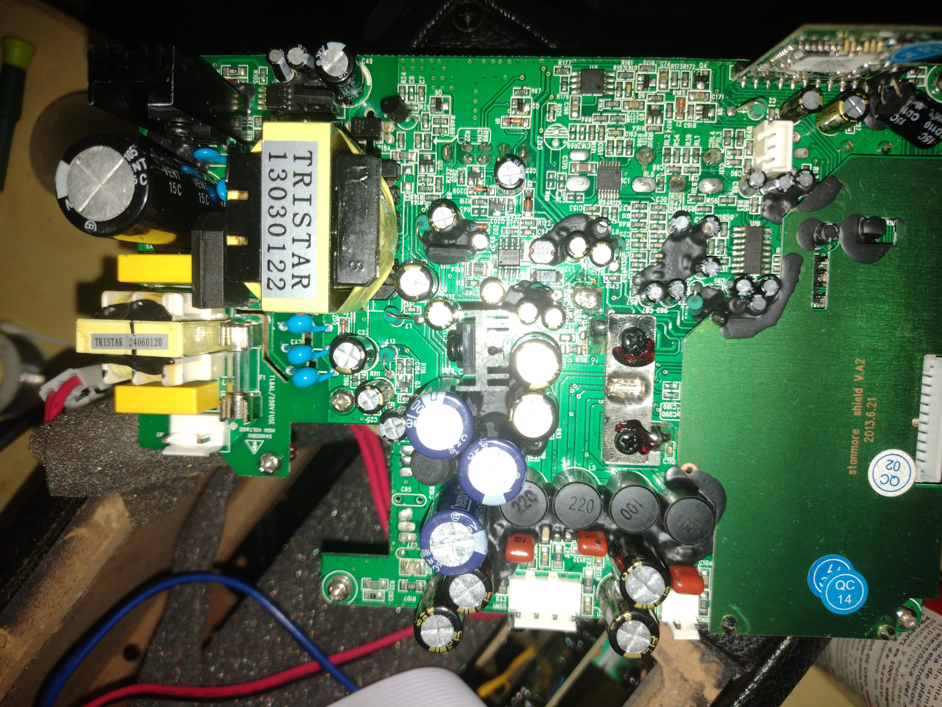

                  I'm not sure if this thread is still active, but my Tristar 13030122 is as shorted as can be and I hoped that maybe someone on here knows a suitable replacement part for it. Maybe via Aliexpress or something. Kind regards

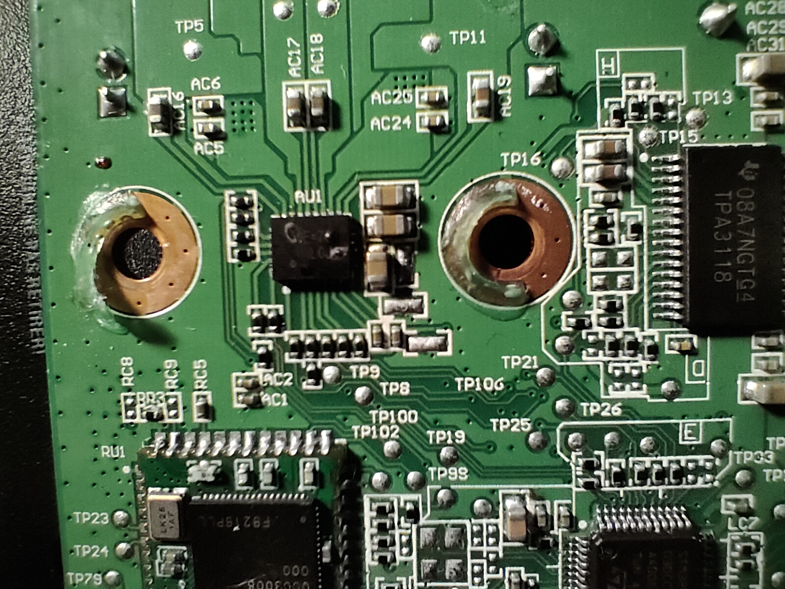

                      Hi, I'm from Argentina. Does anyone know what are the models of the transistors marked in the photo? I have received a Marshall Stanmore team with the lack of these two
                      • SkyHeart
                        • Jul 2022
                        • 11
                        • Sweden
                        #131
                        D8: Fmg23s

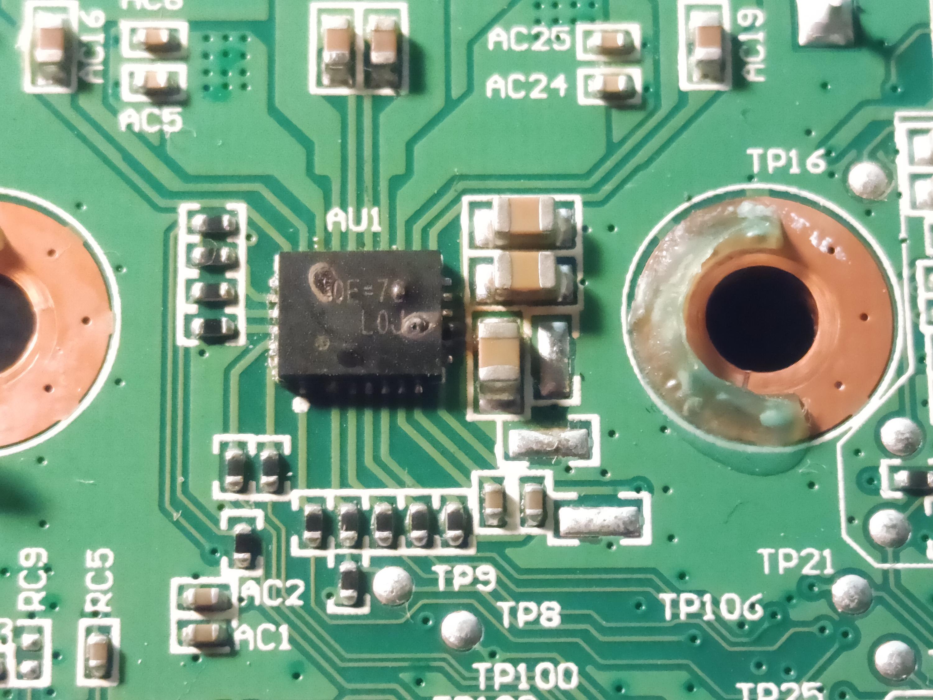

                          Hello, who can help with this chip?
                            • 22215
                            #133
                            Parts with an equals sign = are usually made by Richtek https://www.badcaps.net/forum/showpo...84&postcount=2
                            It could be a Richtek RT9114B .Check the pinout carefully.
                            Datasheet: https://cdn.badcaps-static.com/pdfs/...0b114cc4ee.pdf

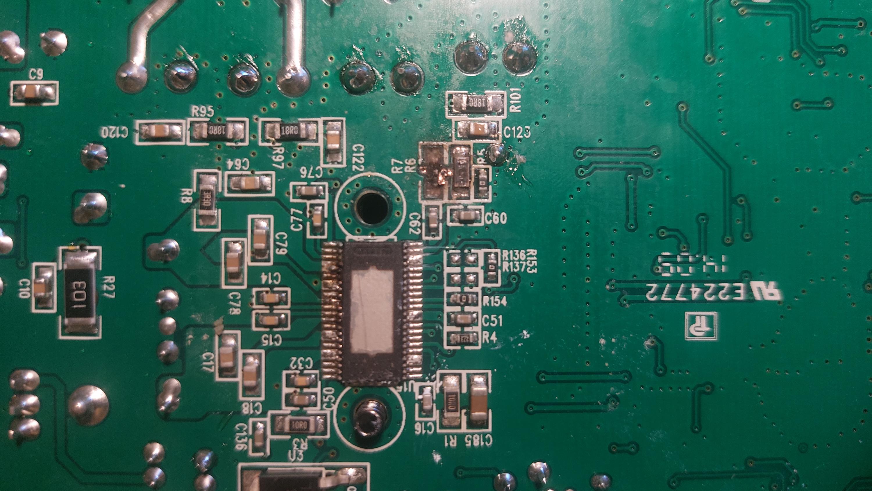

                              Hi friends!
                              I have an issue with a fried R7 on my board. Tried to replace it but the new one starts to melt almost immediately.
                              Any ideas on what the main cause could be? R6 is still ok and brings the correct resistance.
                              I'm currently novice, but soon pro Thankful for all the help I can get
                              • Hombre
                                • Jul 2013
                                • 231
                                • Croatia
                                #135
                                Your audio ic looks quite burned, on it's pins, i assume at least some of the ceramic caps around ic are measuring low resistance across the. If yes lift IC and check again for resistance on surrounding ceramic caps, if it went up your IC is toasted, and that could be a reason why R7 is burning
