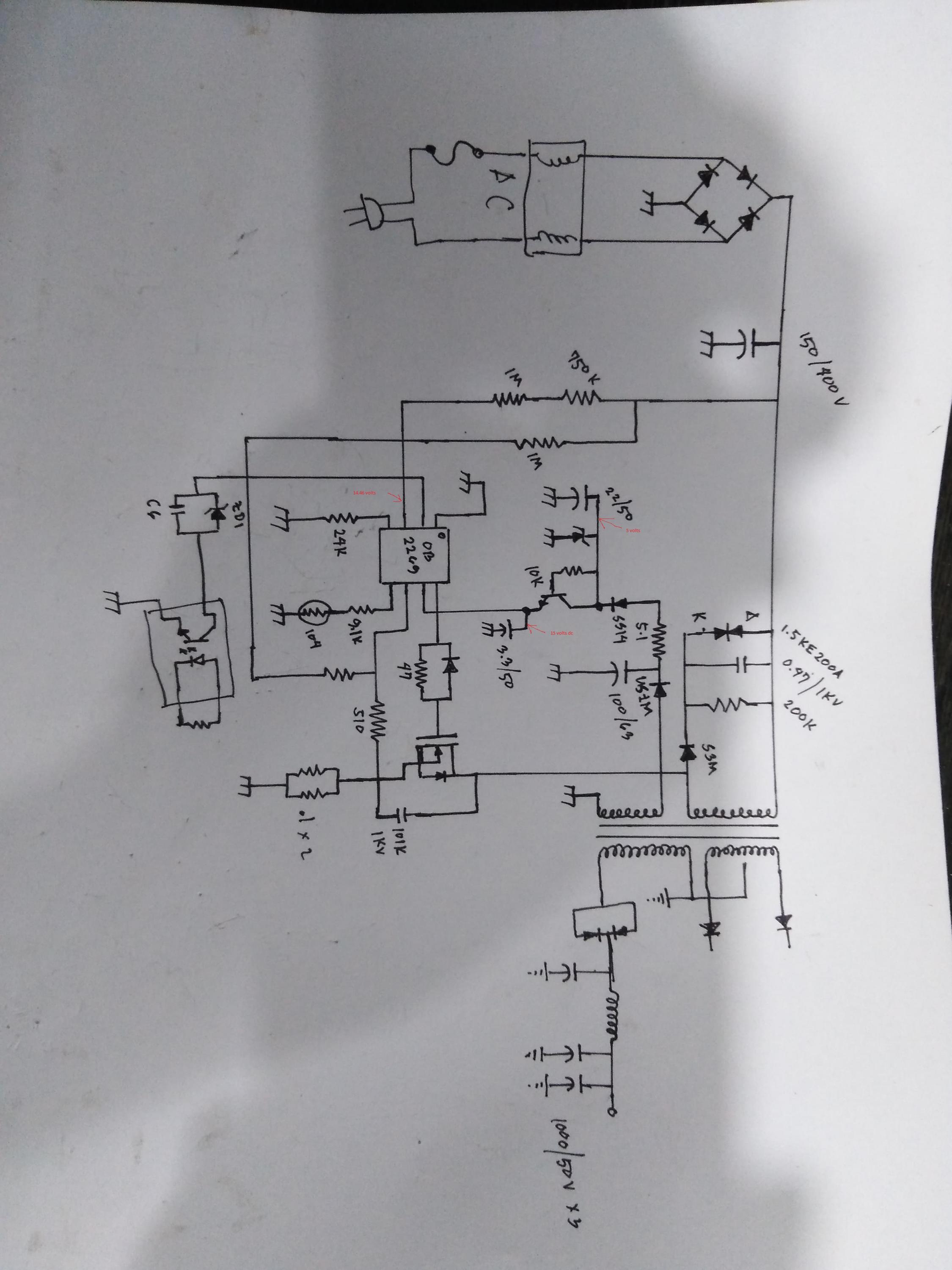

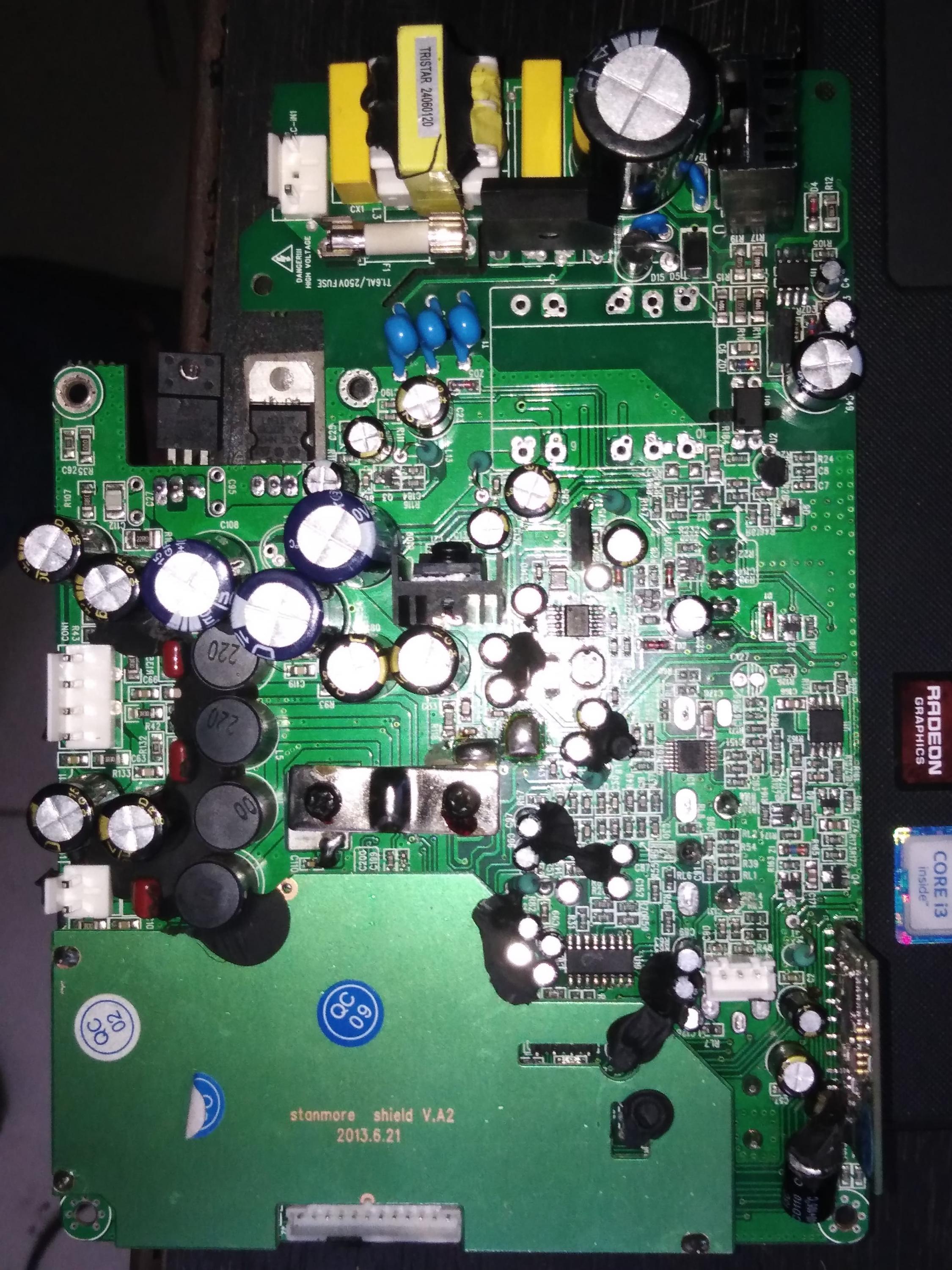

          Re: Marshall Stanmore Repair
          hi im hann, my problem with stanmore is no power. On supply section. Already replaced pwm chip ob2269. Still to success.

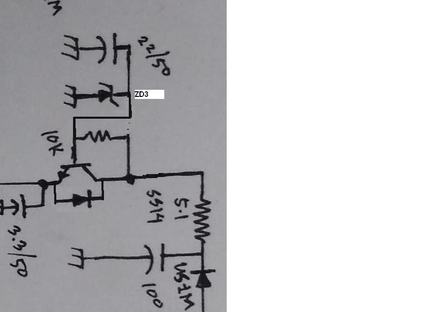

            here is my board and i drawn a schem to find the culprit
            • hann
              • Jul 2019
              • 16
              • Philippines
              tested some voltage mark with arrows, but still no output
                You should have about 30 volts on the 100/63 cap connected to the diode and 5.1 resistor, The zener diode you have 5 volts on is too low.
                Do you have full B+ on the fet drain pin? are the two 0.1Ω resistors on the source good?
                When first connected to a/c, the ic should output pulses to drive the fet, that will induce a voltage in the secondaries of the transformer, The run winding should supply the run voltage (20~30v) to keep the ic operating. Check that the winding is not open, the diode is ok, the 5.1Ω is good and the 100/63 is good. Check that zener diode's number to get its value.

                  I also see ZD1 drawn in series with the optocoupler, are you sure this is correct? Ususlly the zener is across the opto's output, check that it's not shorted

                    #29
                    thank for the comment, i try measure it again.there is no markings on zener.

                      #30
                      sorry for the drawing, its parallel on the opto. thanks for the correction. great help here.

                        #31
                        there is full B+ on fet drain pin, both .1 ohms good, both windings were ok, diode us1m reads .412 volts and ss14 reads .144 on dmm diode test. 5.1 ohms good, 100/63 good.

                          #32
                          Whats the number on the (unmarked) zener diode? if it is bad it could be killing the feedback/run voltage
                          That ss14 seems to read low, was that check in circuit or out?
                          Also, check ZD1 that is cross the opto, it could be shorted

                            #33
                            ZD3 on pcb with blue band, ss14 check out in the circuit, zd1 is ok.

                              #34
                              5 volts on the transistors collector is too low, find out why and you will likely fix the problem

                                #35
                                Are you sure about how ZD3 and the transistor are drawn? Or is like this? This way the transistor acts like a regulator and the zener diode sets the regulator voltage.
                                Any other marks, letters, or bands on the zener? A blue band seems to designate Zener, but there is usually another band that tells the zener voltage

                                  #36
                                  sir R_J thanks for the input sir. i have found the fault. its the 3.3/50 volts e cap, replaced it then voila! power restored. i studied the datasheet on the pwm ic. the e cap doesn't charge that is why the ic wont start. a very big thank to you sir.

                                      #38
                                      Good to see its fixed, That 3.3/50 is a common failure on smps's. and I would have replaced it right at the start. I guess I should have suggested that right away. That cap. needs to charge to the full vcc supplied by the transformer after a couple cycles, if it does'nt the ic will not start and run.
