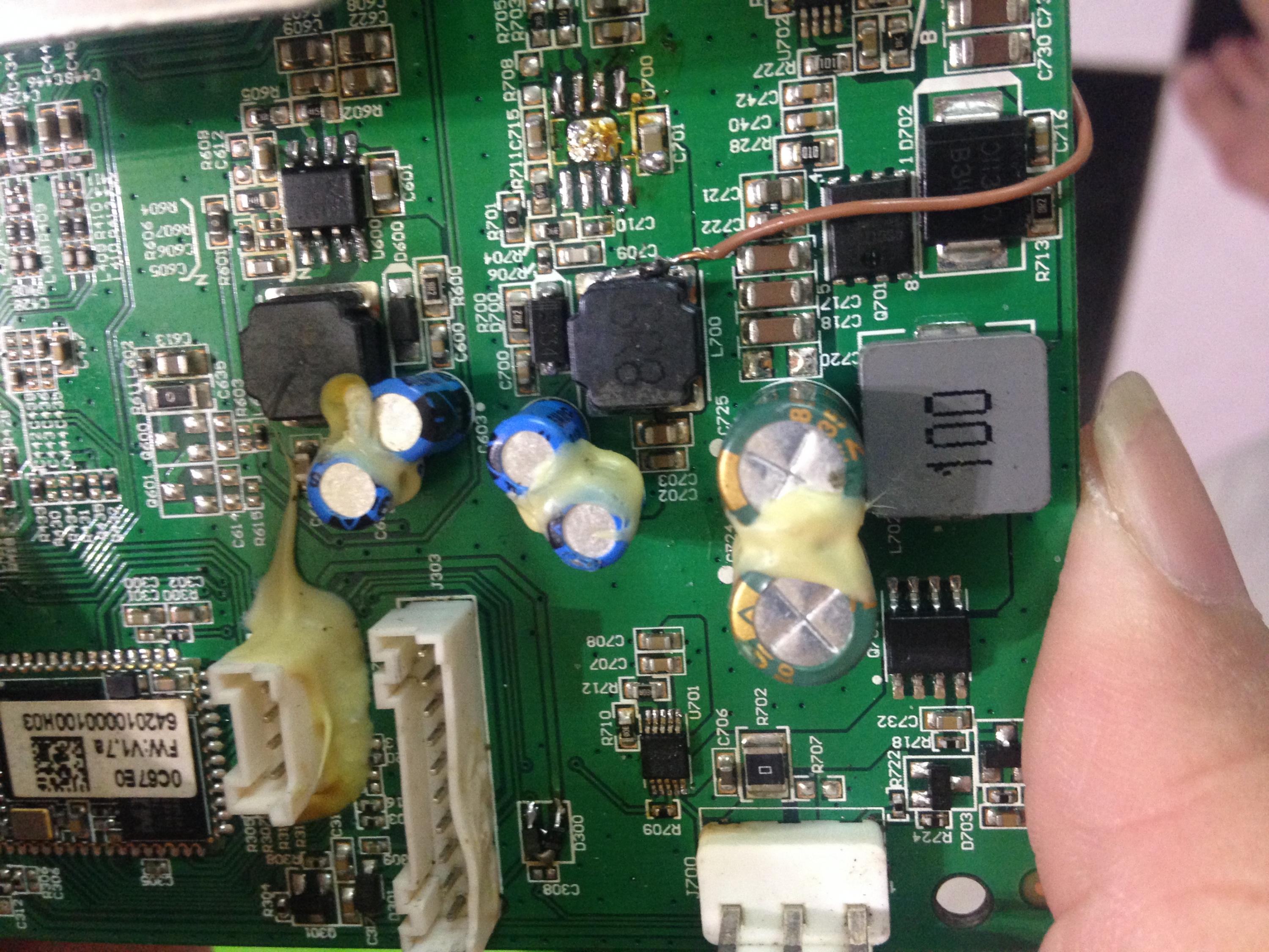

    Check the RESISTANCE between the two legs of C713 (the smallest cap of the four caps) to see what it shows. Make sure to report if the reading is in Ohm, K Ohm, or M Ohm.
    BTW, that black carbon on the board should be removed, it is conductive.
      C713 = 0.6 Ohm, but i have only usual multimeter now.
      Black carbon will be removed certainly, i have not started the repair, only wiped with alcohol.

        Well, more likely one of those 4 caps is shorted out or the IC itself. I would carefully remove hose caps one at a time to see if the shorts will go away.

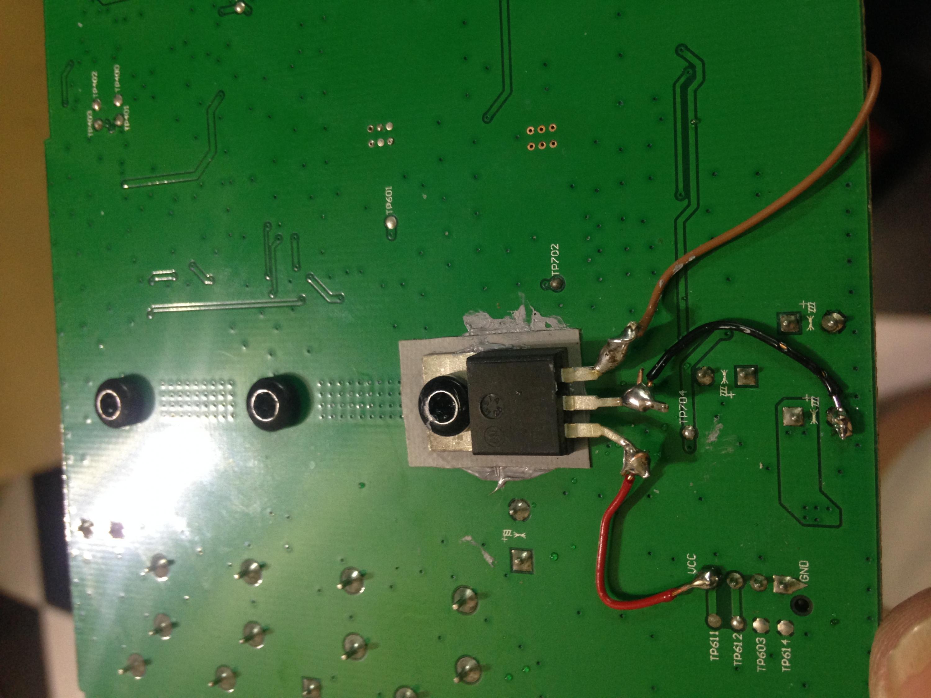

              I'm bad english . I have onyx studio no power . I checked board see D300 explosive and U700 short circuit . I have replace new D300,U700 and still not work ? Anybody help me fix this ? thank

                Are you getting 4.7v from the new U700?

                  I removed C306 and turned on ok but not charging battery . I connect apdator and remove battery and check Vbat pin is 0V

                    U701 is probably faulty, or C706 shorted?

                      I no find replace U701 IC . You can help me new solution ? . I plan to mod a extend power stepdown module for charging battery

                        Finally . I modding power charging battery by LM7805 and everything is OK . But charging battery near 8 hours when battery is very low,can't to start system :P . I'm no care because I alway using power apdater,sometime i go out to use on battery . Thank a lot
