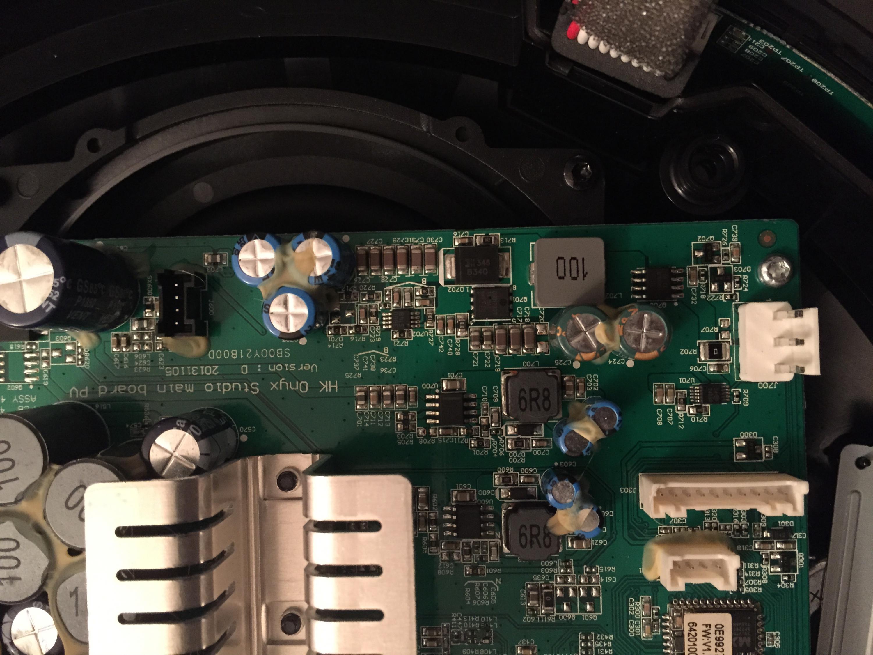

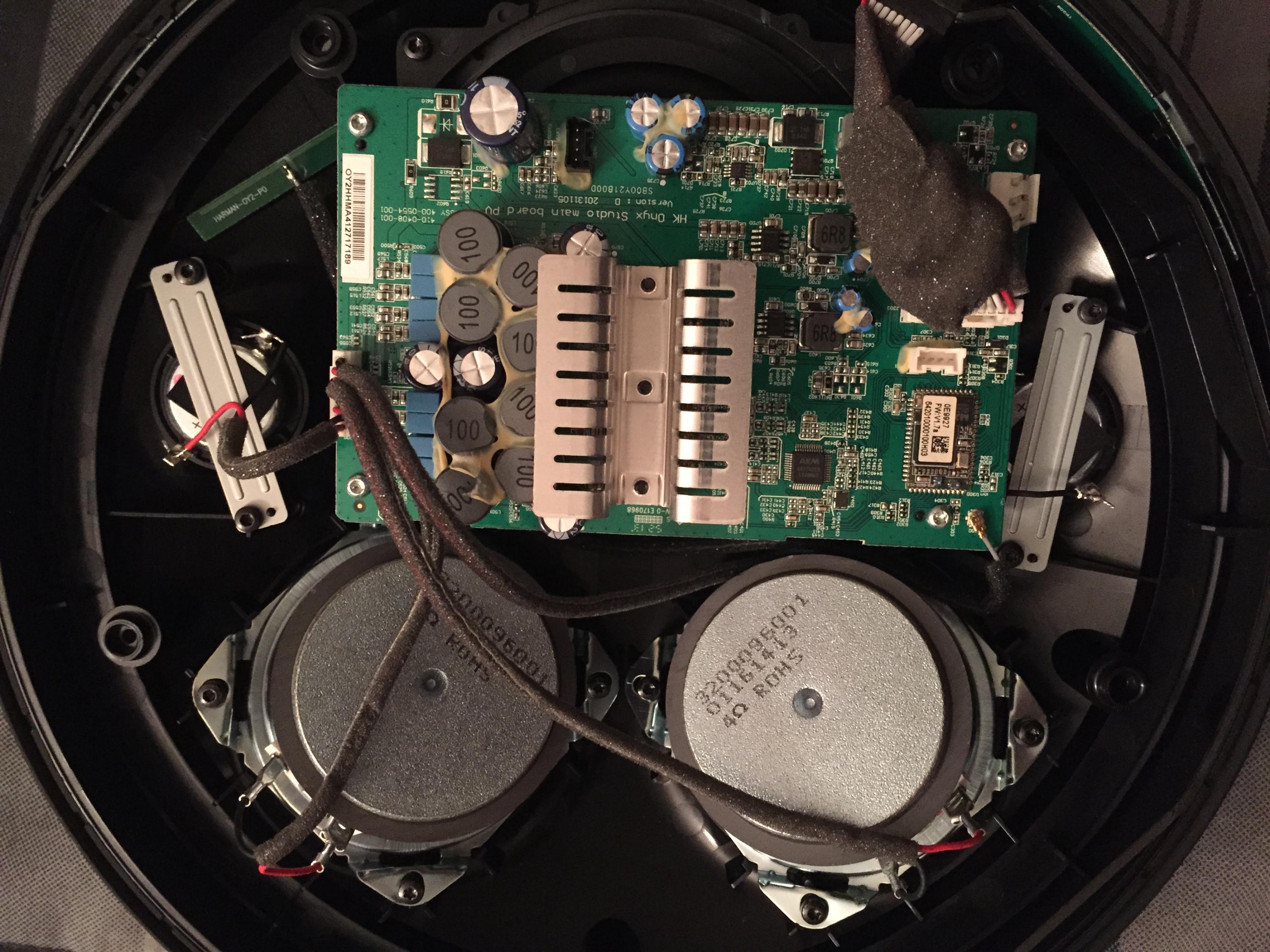

      Re: Harman/Kardon Onyx Bluetooth Speaker - No Power
      Let me know if you need any more/specifics. Left black connector is 19v dc from the charger, the right white connector is what the battery plugs into.
      The battery is rated at 3.7v 2600mah and it seems full at 4.1v
      I'm curious isn't the charger at an output of 19v overkill for it? Or is that meant to charge it faster?

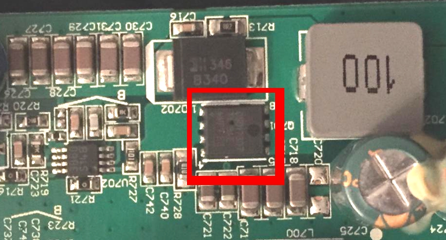

        19v would be overkill (literally!) if it were connected straight to the battery but there will be some voltage step-down circuitry and a charge management circuit somewhere in between the two. There is likely also a boost converter somewhere for when it's running off battery.
        Doesn't look like there's a schematic anywhere so you'll have to do this the hard way...
        I see several possible DC-DC converter circuits there.
        One based around U702 and Q701
        Another based on U700,
        Another on U600.
        Another circuit based on U701 and Q700 it seems too.
        You will need to investigate all these and ensure they are all working. Checking voltage rails is the first thing to do when something doesn't work.
        Post part numbers on all those chips if you aren't sure what they're doing.
        I do see what might be a hole blown in Q701. You should inspect that more carefully.
        U400 is probably a microcontroller to control everything.
        The Audio Amps will be under the heatsinks. Class D ones going by all the output inductors.
                    check what this black mark is!
                          Just examined it closer, it's just a symbol not a burn mark.
