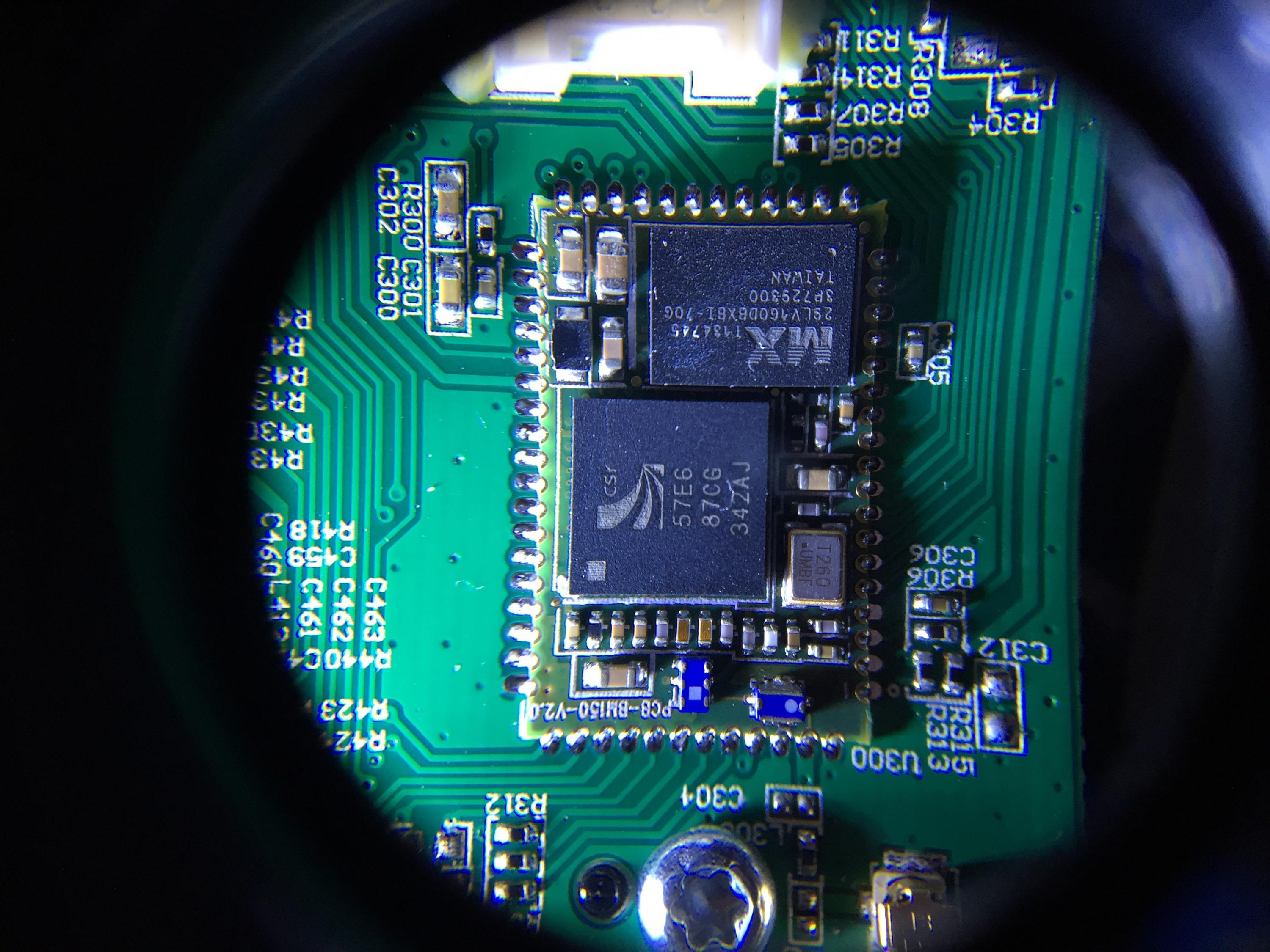

                              • Agent24
                                I see dead caps
                                • Oct 2007
                                • 5072
                                • New Zealand
                                #55
                                Re: Harman/Kardon Onyx Bluetooth Speaker - No Power
                                I know less about Bluetooth than you, I expect...
                                All I can think of are the obvious things... is power actually getting to the module? Is the module's clock crystal working? If there are any external reset or enable lines to the module, are they OK?
                                caphair, can you give us a closer photo of the Bluetooth module to show it better? Maybe there are components on there you could check. Knowing the code silkscreened on its board might also help, since the sticker codes don't come back to anything.
                                Take the sticker off and find the IC code underneath, maybe a datasheet could be found for that. Maybe...
                                -David VanHorn
                                • caphair
                                  • Nov 2011
                                  • 1249
                                  #56
                                  Here's a pic hope it helps. I'm curious to get it going if possible. This thing was $300 brand new. I'm wondering, would the company give out the schematic if I contacted them or something they don't make public?
                                  • Agent24
                                    I see dead caps
                                    • Oct 2007
                                    • 5072
                                    • New Zealand
                                    #57
                                    Looks like it's a BM150 from Sunitec: http://www.sunitec.com.tw/product-it...avi=52&uid=123
                                    Found a BOM on FCC website: https://cdn.badcaps-static.com/pdfs/...667a2bc897.pdf
                                    Also found datasheet for the BM150 here: https://cdn.badcaps-static.com/pdfs/...a02ece2fe5.pdf (Page 4 of this document shows the module's pinout)
                                    Datasheet for Bluetooth chip BC57E687C here: https://cdn.badcaps-static.com/pdfs/...086079d3a0.pdf
                                    You better hope it's an issue with the external Reset line or something, as I doubt troubleshooting that module would be easy, nor would replacing the chip, unless you can do BGA rework. And it doesn't look like new modules are easy to get either.
                                    If you asked nicely and were extremely lucky... you are still unlikely to get it

                                        The following thread discusses the Harman Kardon ONE device:
                                        http://www.oluvsgadgets.net/2015/06/...mware-fix.html
                                        The HK ONE uses the same BM150 module (see the internal photos):
                                        https://apps.fcc.gov/oetcf/eas/repor...cc_id=APIHKONE
                                        Just FYI, the following links constitute a firmware update for the HK ONE. I'm guessing that a similar procedure using the same (?) software but different payload would apply to the ONYX STUDIO.
                                        Uploaded firmware 1.4.1, CSR BlueSuite and installation manual:
                                        http://putit.ru/download/MjMxNjU3OTYyMTUzOA==
                                        http://my-files.ru/d58uuf.JBL_CHARGE_2.7z
                                        http://higgs.rghost.ru/download/89c8...BL_CHARGE_2.7z
