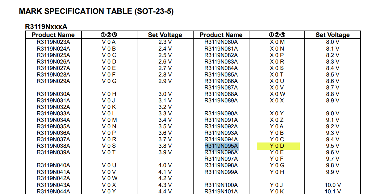

    Cant find what smd code Y0DVA.
    sitting in Harman kardon onyx studio 7. Appreciate any help.

    What was the circuit it came out of?

      Perhaps Ricoh # R3119N095A.
      See attached.

        This is SY8201C

          Thanks but the chip is 5 pins. supervisor ic
            From the photo you can see that now it has 5 pin, but when it was removed, the middle, upper leg could have fallen off. Post a photo of where it is, in what place.
