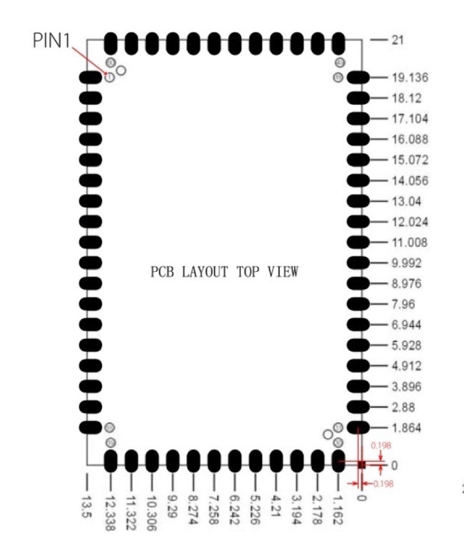

    Re: Harman/Kardon Onyx Bluetooth Speaker - No Power
    Go look at the file SPEC-BM153-V4.3_03122009.pdf I linked\uploaded. On page 3\4 it tells you which pins do what.
    Pin 1 on the module is marked with a 1. In your photo, it's the bottom-right corner. From pin 1, the rest are numbered in an anti-clockwise fashion around the edge.
    Pin 3 thus, seems to connect to R306 on the main board. According to the datasheet:
    "Reset if low. Input debounced so must be low for >5ms to cause a reset"
    So you want to check that Pin 3 is not staying low, as that would hold the module in a reset state and nothing would happen.
    You should probably also check power pins, Pin 12, 13, etc to make sure power is actually getting to the module.

          #64

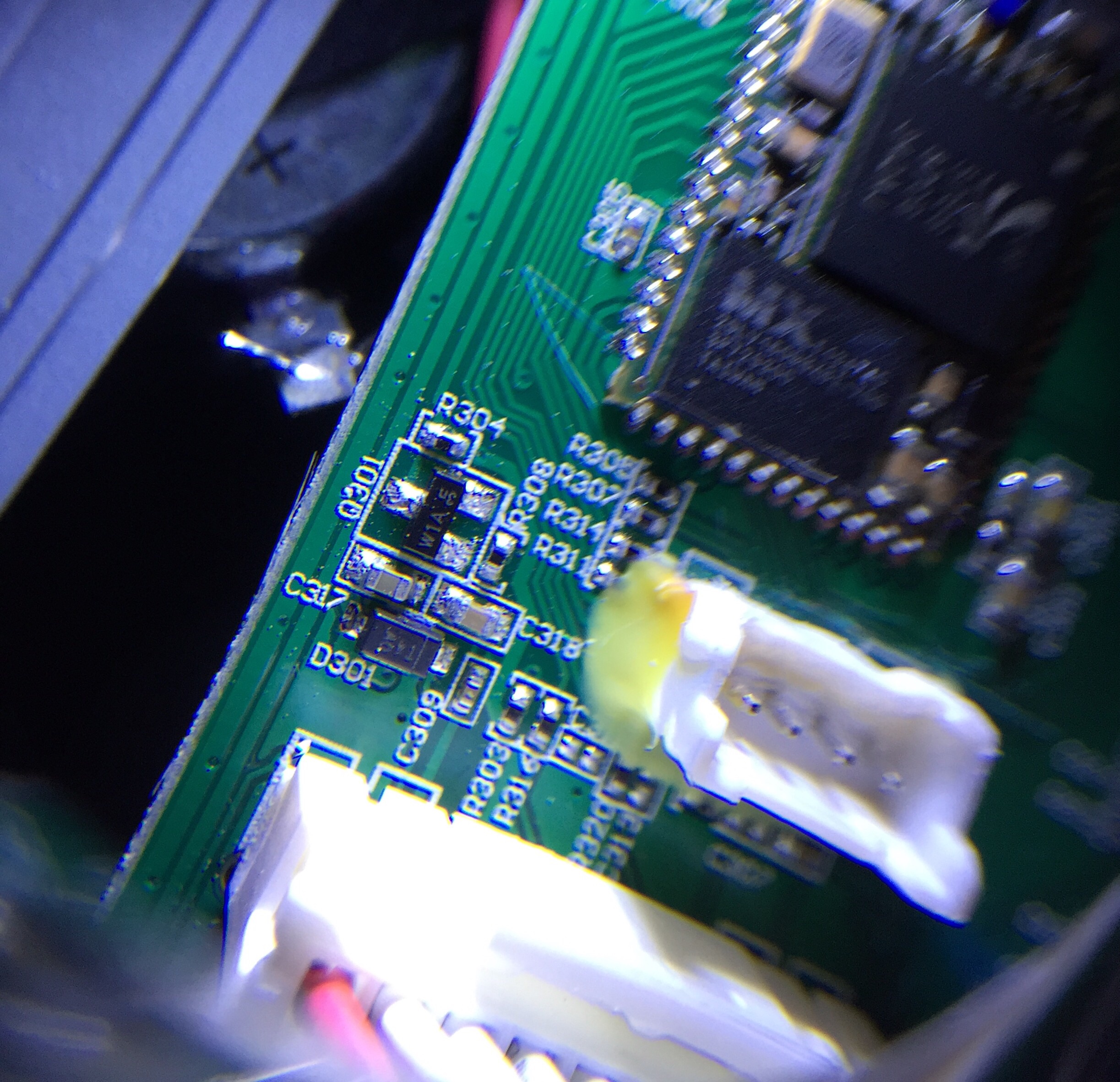

          Ok that layout confused me with the dimensions? On each pin which are numbered
          • caphair
            • Nov 2011
            • 1249
            #65
            Testing voltage at the reset pin it goes to 1v when power button pressed and doesn't change unless I release power button and then the voltage drops.
            Also measured before the resistor going to that pin and get same voltage (to rule out that the resistor value increased)Does that mean it's staying low?
            Also there is 3.3v present on the VDD pin 13 so it is receiving that voltage as well as 1.8v on pin 15 so that voltage is present as well.
              Hmm... that does not sound right...
              The BT module can work on 1.8v or 3.3v, and has its own internal 1.8v regulator, which it supplies through Pin 15, and which seems to be working. I assume that 1.8v regulator is powered from either Pin 32 or 34, or both. (Out of interest, what do you measure on those pins?)
              According to the datasheet, the voltage at Pin 13 determines the operating mode. Since you measured 3.3v on the supply pin, Pin 13 - it seems to be operating in 3.3v mode. 3.3v CMOS logic levels require 2v-3.3v for a logic high, so 1v would not be considered a high in that case. In fact, 1v is barely at the threshold for a 1.8v logic high, which is 1.17v.
              Can you take a close up photo of the area above the module where the trace from R306\C306 leads to R304, near Q301? And see what voltage you get on the each side of R304 too?

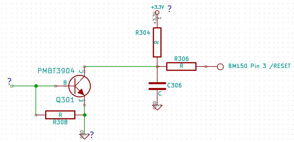

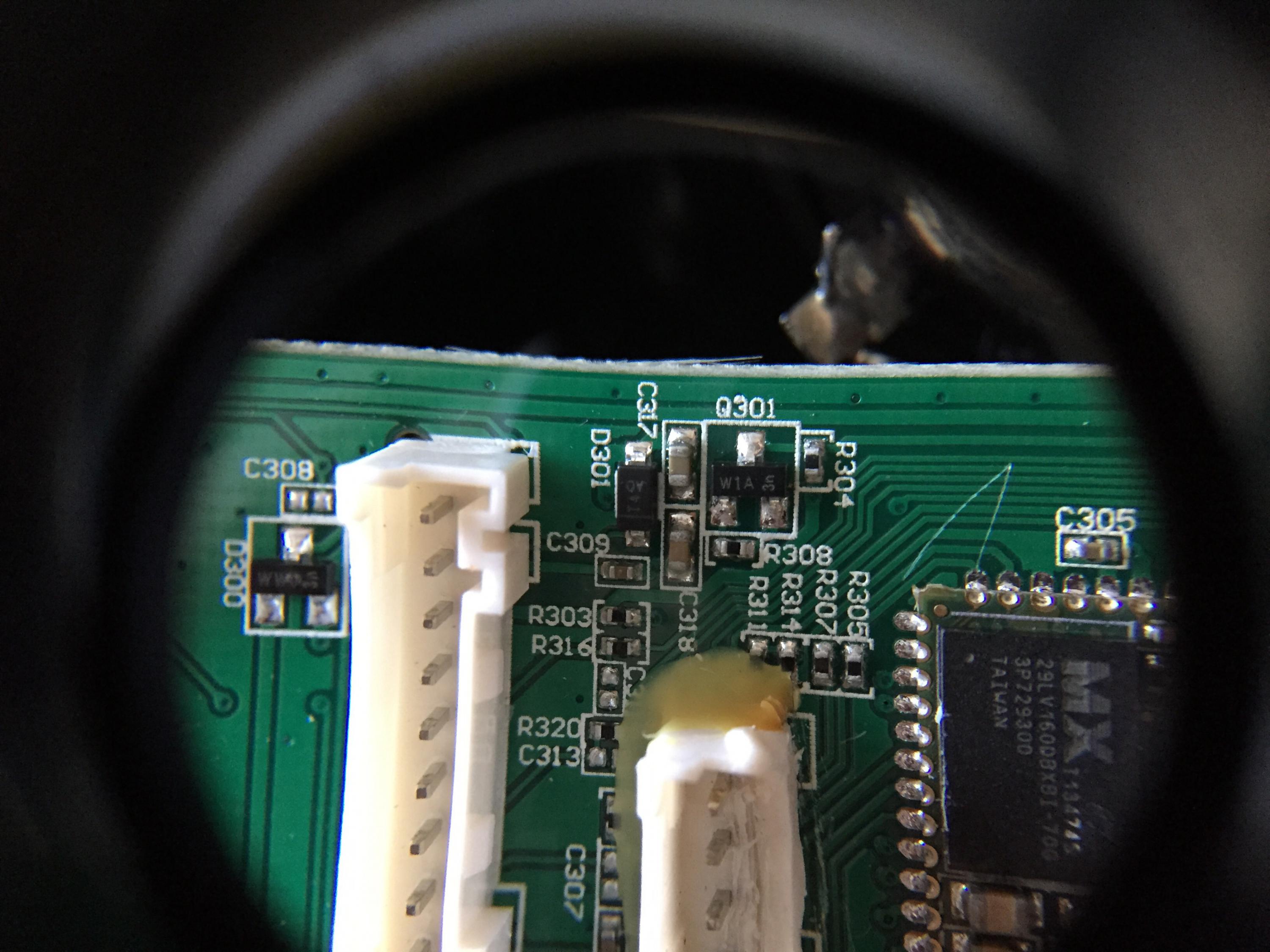

                      #70
                      That is strange. I would have expected the reset line to be either 3.3v or 0v, never 1v. Perhaps R304 is going high or open, or something is partially shorted (C306 or Q301). Or perhaps I just don't understand the circuit function...
                      From what I can see:
                      R304 seems to be a pullup, probably to the 3.3v rail. C306 likely provides the debounce and the 5ms delay the datasheet speaks of.
                      It looks like Q301 is for pulling the reset line low externally from somewhere else, but what exactly turns it on, I am not sure. I've drawn a schematic of what the circuit seems to be.
                      What voltage you get on the base and collector of Q301? Compare these between when reset is 1v and when it is 3.25v and see if there is a difference.
                      For pinout, check the datasheet attached. (The Code W1A comes back to PMBT3904 which is a common part)
                      Also, can you measure the resistance of R306, R304 and R308?
                      Also, do you get any resistance measured across C306?
                      Can you post a photo showing the PCB tracks around Q301 with more light? I can't see where the tracks go near C317 and C318 etc.
                      EDIT (Mistake in Schematic on R308)

                        #71
                        Isn't R308 connected between base and emitter?
                        BTW, the pinout is BCE (left, tab, right).
                        T4 (D301) could be a 2.7V zener or a 1N4148, but it doesn't look like the latter. Perhaps it senses the battery voltage, but I can't see how it would work with Q301 to do this.

                          #72
                          BTW, the pinout is BCE.
                          Yes R308 is between B-E, I made a mistake the first time.
                          Q301 Pin numbers are not correct for SOT23, I think the program defaults to TO92. I've removed them. (Need lunch!)

                            #73
                            Ok I'm getting 0v at base (left pin) of Q301 and 1v on collector (tab) same 1v going into the reset pin.
                            Measurements
                            R304 - 14.2k ohms
                            R306 - 0 ohms - shorted or something in parallel with it shorted?
                            R308 - 220k ohms
                            C306 - 781 ohms
                            • Agent24
                              I see dead caps
                              • Oct 2007
                              • 5072
                              • New Zealand
                              #74
                              R306 may just be a 0 Ohm resistor, although why they'd use that, I don't know. Maybe they had something higher value there during prototyping and testing, and use 0 Ohm in production.
                              Resistors don't fail shorted, and there isn't anything in parallel with it that I can see, so it's probably supposed to be 0 Ohms.
                              If Q301 has 0v on the base, it should be turned off. Thus, it should not be pulling reset low.
                              BUT... If you are measuring only 781 Ohms across C306 (and incidentally, probably also across C-E of Q301) that could indicate a problem. Try measuring resistance across it again both ways (ie, swap your probes around), see if the readings change. Also might be interesting to see what you get both ways in diode mode too.
                              Also can you check if the Emitter of Q301 is connected to ground?
