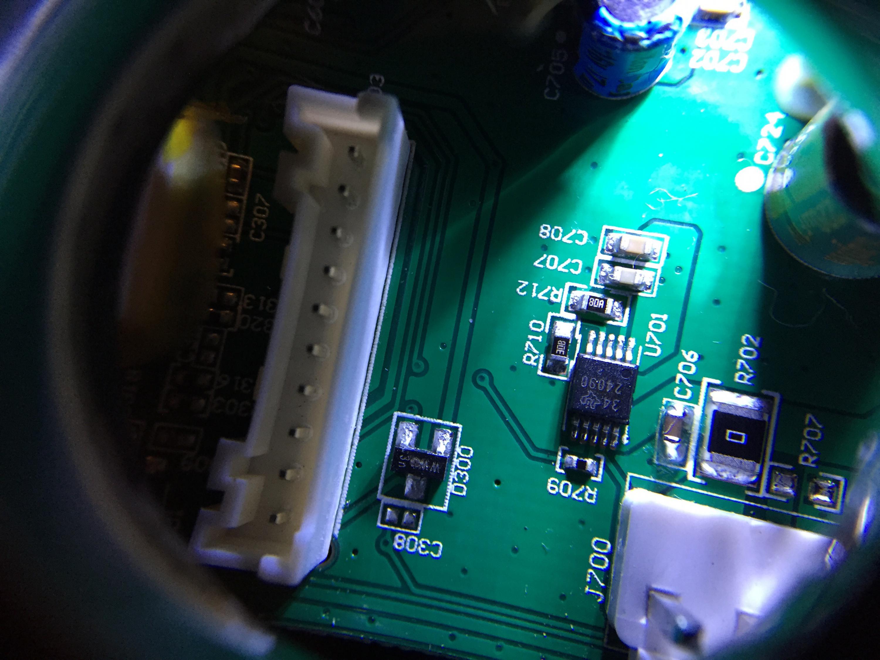

                      Just noticed this, does it look like a burnt mark to you on D300?
                        It does indeed.
                        If it was me, I'd remove the charge IC, check the resistors associated with it again and make sure they're OK, then assuming they are OK, install a new charger IC and new D300. Hopefully they are the only bad parts.
                        I guess you'll need a new battery too, of course.
                        Once you put them in, check the voltages again on first test, and run the battery through an ammeter so you see what happens with the charge\discharge currents and make sure they all make sense, hopefully replacing those two parts will fix it.
                        Are you able to determine what D300 actually connects to in the device?

                          Same output of charger ic .67v is measured on third pin of D300 while the other pins have 4.67v and 4.3v

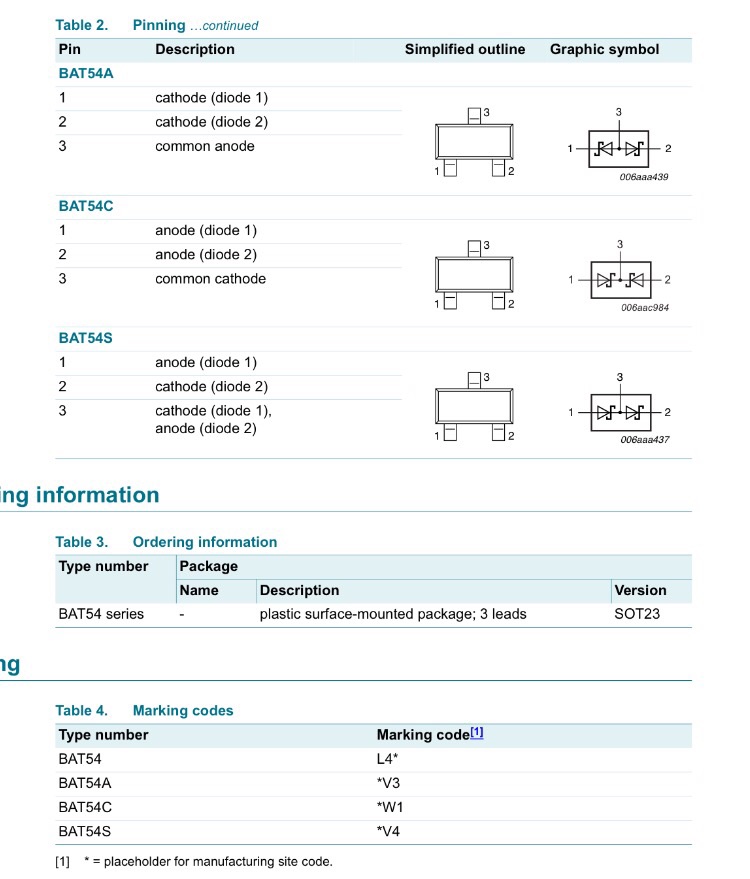

                            So I'm guessing it's a ww1 diode since the burn mark makes it hard to identify I found another similar one used in the over all circuit.
                            Found this https://cdn.badcaps-static.com/pdfs/...49ac0fb0cb.pdf
                            So going by that I measure
                            4.3v on tab 3 (cathode)
                            4.67v on tab 1 (anode)
                            .67v tab 2 (not connected)
                            So that's interesting. Not sure why it'd be blown, couldn't trace it to any circuit. Will try again later
                            • caphair
                              • Nov 2011
                              • 1249
                              #114
                              Re: Harman/Kardon Onyx Bluetooth Speaker - No Power
                              Actually I got those pins wrong, according to this the w1 would have pin outs of the BAT54C
                              Maybe it's used as a reverse voltage protection diode for the charge chip

                                A BAT54C (WW1) dual diode would fit the bill. That said, ISTM that your diode may be OK. AFAICT, D300 could be OR-ing the battery and regulator outputs to the Bluetooth module. This would allow the device to function in the absence of a battery. A voltage of 0.37V would then be a normal voltage drop (4.67 - 4.3 = 0.37V) for a Schottky rectifier at low currents.
                                Code:
                                      BAT54C
                                       3
                                 BAT+ o-->|---+---|<--o +4.67 from regulator
                                    1   |   2
                                       V
                                     to Bluetooth
                                      module ???
                                  So you think it's fine even though looks like there's a burn mark on top?
                                  • fzabkar
                                    • Mar 2009
                                    • 772
                                    #117
                                    I don't know, but I'd change it anyway. It should be cheap enough.

                                      Ok so bc it's easiest to remove, I removed D300 and plugged charger in, without powering speaker on I took voltage measurements.
                                      The input pin of battery charge ic had 4.67v but now no output at 0v
                                      Also at the contact point of where D300 pin 1 would be there was 4.67v and nothing measured on the other two (as suspected with it removed)
                                      Made me wonder if D300 was shorted and causing output of ic charge to be the low .67v?
                                      Seems like it's needed before charge ic outputs a voltage to the battery
