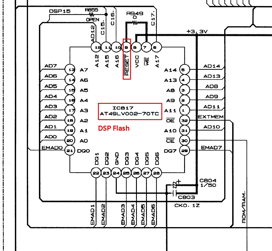

          I need a flash dump for Denon avr-2802 , for eeprom AT49LV002-70TC . Best regars!

                    I need a flash dump for Denon avr-2802 , for IC817 AT49LV002-70TC .
                    Best regars!

                                      I also am looking for the FLASH image and/or replacement flash chip.
                                      My Denon AVR-982 (2802) is collecting dust since I initially debugged it in December 2014. Oscilloscope showed that the DSP is continually resetting
                                      and I suspected bad FLASH chip IC817. Since then, I recently found this post, and I am hoping that Henk "sparx_59" will reply with updated links for the flash image.

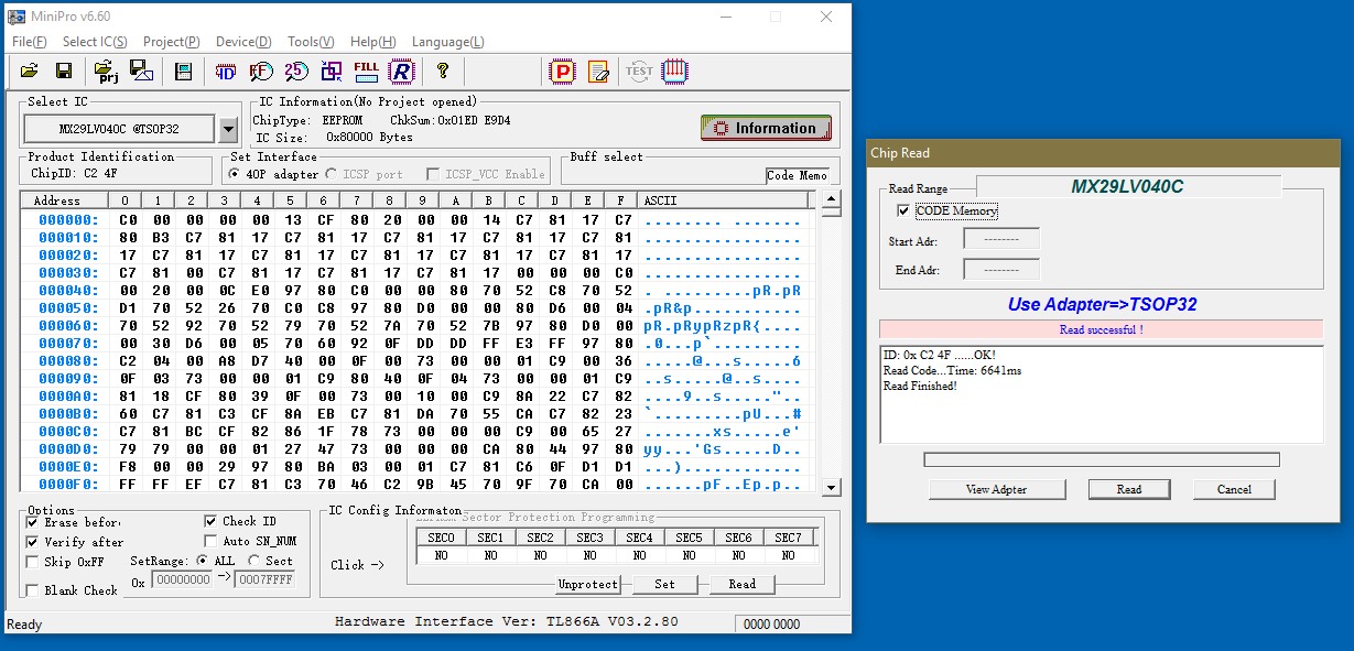

                                        Re: Denon avr 2802: Reflashed bin using Macronix & TL866 pgmmer
                                        I replaced my Flash Chip and reflashed. Some of the symptoms are better (but the unit is not working completely). I wanted to provide some details in case this helps anyone. I also used a much less expensive programmer.

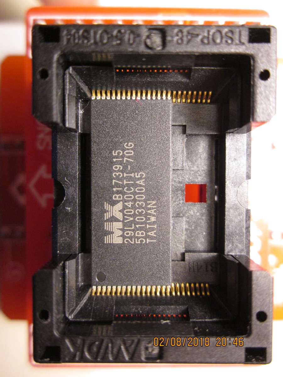

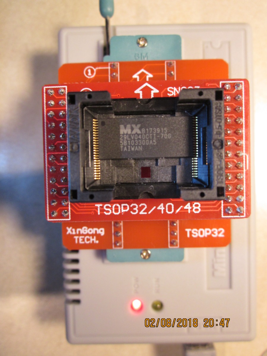

                                        Materials/tools:
                                        (see attached photos.)
                                        The new Flash, although 2x the size, appears to have comparable specs (Voltage, Timings, Access time, and Package/Pinout e.g TSOP 32 8x20mm). I believe the ONLY difference is that Pin 9 (RESET# on the Original FLASH, which is unused/tied high) is now “A18” (because the new Flash has one more address bit since it is 2x the size). The Boot block/programming does not matter because the flash is used in READ mode only on the DSP board.
                                        After I removed the original Flash IC with the Chip Quik, I cleaned the leads, then carefully installed it in the 32-TSOP adapter. Using the TL866/Mini pro, I read out the Atmel AT49LV002 FLASH contents several times. I was surprised that it gave consistent checksum (0x00F6_F4EA). Since the checksum is ‘correct', I am actually not sure that the flash is bad (although it may be “slow” or ‘degraded' as described by Sparx earlier in this forum). I saved the memory image to a binary file. It matched the one described (but not currently provided) by “sparx_59” / Nataf on the Badcaps website (https://www.badcaps.net/forum/showth...t=45694&page=5).

                                        In the TL866 minipro s/w: Selected IC for the new flash: “MX29LV040C @TSOP32”.
                                        Fill memory with zeros (Fill block, code memory, with value 0x00). -> checksum is 0x0000_0000.
                                        Read in the 256K Binary file (File -> open -> select file, and change “clear buffer when loading the file” to “Disable” ). Now the checksum is 0x00F6_F4EA (same as original value).
                                        Read in the 256K binary file again but this time put it in the upper half of the memory (“File-> Open -> Select file -> “File Load Options” -> “Load Mode” : “To Buffer Strat Addr(HEX)” change from 00000 to 40000 (hex)) AND again change “clear buffer when loading the file” to “Disable”. -> Checksum 0x01ED_E9D4. Now the upper half should match the lower half.
                                        NOTE: Doubling the code is not required if you chose to modify the DSP board, to remove the 0-ohm resistor (R949) which ties Flash PIN 9 to Vcc=3.3V, and instead, connect it to ground (to hold Pin 9 which is A18 on new 512KB Flash.) But I figured, I only want to do this one time, so I might as well put the DSP code in there twice, rather than leaving the upper half of the Flash unused.
                                        After programming the new flash with the mini pro, I verified it several times. Then I soldered it back on the DSP board.
                                        I carefully checked for shorts between pads before soldering and removed a few solder bridges. Soldering was tricky due to the 0.5mm Pitch. After soldering, I used an ohmmeter to check for shorts between every pad, and for continuity from each IC lead, to the corresponding PCB pad.

                                          One more attachment showing the screen grab in the mini pro software after reprogramming the new Flash Chip.
