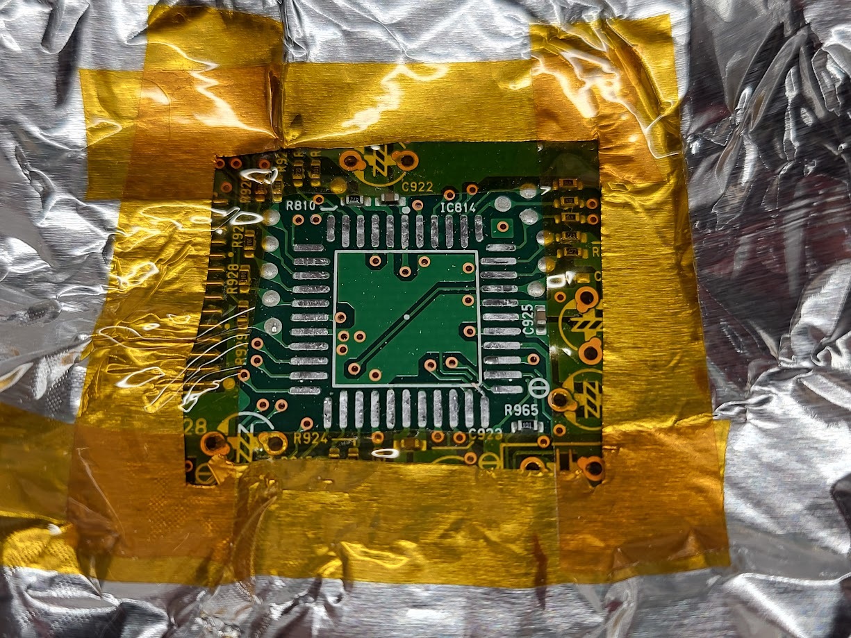

Denon avr 2802 with no sound on speaker
  • Astaloki
    replied
    Originally posted by dbdenon
    Re: Denon avr 2802 with no sound on speaker
    I found my Denon AVR2802 had failed in the way described above. However I noticed that in some situations (detailed below) I could hear very faint audio coming through the amp.
    If you would like to re-use the following functionality of your amp then there is a fairly easy fix. With the ‘fixed' unit I can:
    •Use the amplifier to amplify an external (analogue) source
    •Volume control works
    •Muting works
    •Power speakers A and or B, and potentially surround and sub as separate channels (have not tested)
    What does not work:
    •The radio receiver
    •Switching to any other sources
    •Video switching (untested)
    Step 1 - confirm your amp has the same fault symptoms as mine had:
    A.Connect a source to the FL/FR EXT. IN inputs (e.g. phone, MP3 player, computer) [img]
    B.Connect speakers to the FR/FL outputs
    C.Configure the ‘source' to be EXT.IN
    D.Turn up the volume to around 0dB - you should hear nothing.
    E.Turn off the amp and turn it back on
    F.Only adjust the main volume, turning it gradually up to +18db - you should hear the EXT.IN source signal coming faintly out the speakers.
    G.Note if you do any other adjustment to sources at this point then you will have to power-cycle the system.
    Step 2 - disable the mute which is in place
    There are a couple of places in the audio signal path that the system can mute the sound. Some are electronic and some are electromechanical (i.e. relays). I think what was happening on my system was that because the main DSP was failing (probably due to the ROM failing as described elsewhere) the microcontroller was then muting the signal. The electronic mute used is not infinite, hence why the test in step 1 works. In this step we disable the mute (permanently).
    A.Power off the amp
    B.Take off the top case (as described in the service manual)
    C.Unscrew the back panel (a lot of screws!)
    D.Remove the DSP card to give access to connecter CX114 on the base PCB. [img]
    E.Use a solder blob to short pins 3 and 4 of this connector. [img]
    Step 3 - test
    A.Re-attach “EXT.IN” inputs to test and feed in a signal
    B.Power on the amp and slowly increase main volume from lowest volume.
    C.If this fix has been successful then you will hear sound from your speakers when the main volume is much lower that in step 1.
    D.Having confirmed the fix, reassemble the unit (you could run it permanently without the failed DSP board).
    E.Enjoy a few more years out of your amp instead of dumping it!
    Note: even with this fix any change to the ‘source' will cause the amp to mute until it is power cycled. This functionality works for me (I only use one internet-connected source into my amp) but may not work for you. No DSP or digital functions (like DTS, Dolby, etc) are available. If you need the DSP then consider replacing the ROM as detailed elsewhere.
    The above steps worked for me and my Denon avr-2802 is making sounds once again.
    Thanks so much to dbdenon for his time and effort in creating this work around.
    Leave a comment:
  • Robert85
    replied
    Greetings again, I see that there are not many new posts on this issue, but I'm back with news, I managed to bring back to life 2 such devices with the ideas from this forum, everything boils down to the quality of the parts, by buying quality parts I managed to program the flash,
    Leave a comment:
  • Robert85
    replied
    Hello, I also have this problem with a Denon AVR2802 related to the sound, I downloaded the bin posted on the forum but I can't write it along the way, an error appears, am I not doing something right or is there something else, I used the AT49LV002 as the one in the device, I tried several pieces but without results, I use TL866 for programming.
    Leave a comment:
  • saviabr
    replied
    Originally posted by totof69
    Re: Denon avr 2802 with no sound on speaker
    I am a small French hacker, sorry for the translation ...
    The idea for me was to repair my DENON AVR-2802 without buying a memory or programmer
    Hi, friend! I liked your idea. I also have an Arduino mega 2560 lying in my closet unused.
    Could you send me a diagram of your Arduino programmer and W29C020 memory connections.
    This would help me a lot. Thank you!​
    Leave a comment:
  • Agent24
    replied
    Nice fix!
    Make sure you have a copy of that EEPROM data in case you need to reprogram it again!
    Leave a comment:
  • fox_tango
    replied
    Success!! It was my flash chip! As I mentioned previously, I swapped out the DSP chip and my symptoms stayed exactly the same. So, I replaced the flash IC and I have a perfectly working Denon 982 again! I'm am so grateful for everyone who contributed to this thread and provided the information. A special thanks goes out to azchris! I ordered the required flash chip from Digikey and azchris agreed to program it for me.
    To make the repair, I used mostly the same procedure as before. I made a heat resistance surgical drape from kapton tape and foil. I used my heat gun to heat the flash chip until the solder went molten, and picked it off with tweezers. Then cleaned the pads with solder wick and denatured alcohol. Finally, I soldered the flash IC back on by hand with a fine tip soldering iron. I did manage to create a few bridges on the fine pitch leads, but cleaned it off with the solder braid and all was well.
    To recap my symptoms, it was very faint audio, only audible with volume maxed out, and then if any input source was changed, audio was completely dead. Fix was replacing the DSP and flash IC.
    Leave a comment:
  • azchris
    replied
    Hi, Fox Tango. Glad to hear you are making some progress with your Denon.
    Please see my reply on 2-10-2018 where I posted pretty much everything you should need including the ROM file for the Flash IC.
    The ROM hex file still seems to be available for download; it's in the zip file attached to that posting.
    As I said in that post, I used a Macronix MX29LV040CTI-70G (4Mbit 512k x 8) FLASH IC and Digikey still has it in stock (see my post for the link
    https://www.digikey.com/en/products/...TI-70G/2744774
    Of course, the FLASH IC comes blank so it needs to be programmed. I still have my programmer and I can program the FLASH IC with the hex file
    but I don't currently have any more of the macronix chips on hand.
    Chris/azchris
    Last edited by azchris; 12-22-2023, 09:18 PM.
    Leave a comment:
  • fox_tango
    replied
    I found this thread and it describes my symptoms exactly. I located the DSP chips on e-bay and just got done replacing it. I put a "surgical drape" of aluminum foil and capton tape around the DSP and used my hot air gun to remove the old chip from the board. I thought about cutting the legs one at a time then cleaning up the mess with my soldering iron, but am happy that I tried the hot air first. It came off quickly with no issues. I did remove the tall electrolytic caps from the area first to get rid of obstacles.
Name:	ABLVV85p8djkOODpinjiJMPf5Hb09MFK_8iDes4dd0rAx2OipDT02bHkVy6ZYxq5f8DBUtyJKcM-o8VgoM7g8c2-W8OSMXdO9seFqVoYeZlI1-PBTAhO4lBij72HVHG-yAHnIrrRF0dNW7swTArr1NxY6n3MJoGEZ9nhaTSIJqGg-GN_B-HyJDYP4pFaLgO0Y3HUWRbPxOq8ZuDIpU49GHK09JcI52eHj_CM6LJCzECZYR9Ivut9FvFRM0320xS
Views:	370
Size:	447.7 KB
ID:	3166772 Click image for larger version
Name:	ABLVV85wbuegbTBjxzyWRMiYpQyvyM7H-ll3YME3DFCSl7C_9V7eqpHk7GINbkYrdzjV4P9db7A_qAiKlyacCU7tVZwWWQKhFyzRVnyZ0a3hLof_zjyWiwDPu4WgnkS1hsmN0D0zRG00OtUjN6CW93ADLXOwcK_drlBN7d351OJ5ejsUoZrv4lg8scmFUOZwOWFP2Orc0UWkTSDCtB8hUkNXMs2dY3ot6fkhh1CeAeRIPFbr0lL72LhIu0gZDOj
Views:	359
Size:	440.7 KB
ID:	3166773
    New chip installed:
Name:	ABLVV852oZW4udYbOHZC4GbGQFHiT9sZ-1gEIwnuvBUokDTCSxbINheoS4bXDmeMFLE19QFXMdqth9LVjon9zIs_a2A8ZDGTV1k1_jwKavxk8VVwSthQMaazoy0_g6W_kQcIQzTL8OygkYKdqH8LO_S6-37JlmQWgxDBwNYJMQ_sM0nkkKDazv21JZNAAaISsFLY2Auq7AIK6cg-lWSGqy05aAoVx6Vej75cpWPW8QakY1xTRsX_x6Y743tDCnS
Views:	373
Size:	482.1 KB
ID:	3166774
    Unfortunately, my symptoms remain.
    I've reviewed the previous posts here and am not able to locate the flash ROM data contents file. I think this is my next step. I'm not sure if the previous posters are following this thread anymore, but I'd like to request help obtaining the flash file, as well as any leads on the flash memory device. I've come this far, I really want to try to get this unit back up and running.
    Thanks all for reading and for any advice you can offer.
    Leave a comment:
  • klementor
    replied
    Re: Denon avr 2802 with no sound on speaker
    Hi guys. First of all, I express my gratitude to everyone for this information. I also repaired my Denon AVR-2802. I changed only Flash: Atmel AT49LV002-70TC. The DSP is working fine. I took the firmware here on the forum. I ordered memory chips on Aliexpress. I ordered 3 pieces. Two were faulty and were used. Link to the seller https://aliexpress.ru/item/100500211...00018803732901
    Leave a comment:
  • technocorpsystems
    replied
    Re: Denon avr 2802 with no sound on speaker
    Originally posted by sparx_59
    To be complete: The problem is the IC817. This is a flash chip wich holds the data for the DSP uprocessor. This chip will sometimes fail. The data is still in it, but the processor has problems reading it due to wear. In other words: the chip is getting old. I was lucky enough to be able to read the data from a faulty chip with a programmer. Flashing this data in a freash chip resulted in a fully working rom. I had replaced two boards with these chips, and this fixed the problem. I know Denon does not support the avr 2802 anymore, so I want to share the fix to help ppl with this problem. Please feel free to ask any question! I am happy to answer them.
    Leave a comment:
  • splchina
    replied
    Re: Denon avr 2802 with no sound on speaker
    Hello sparx 59,
    Please can you help?(sorry to disturb)
    Have you any opportunity to send me one chip (AT49LV00270TC)
    for AVR-2802 .
    I have exactly the same faulty on my Denon that you mention on https://www.badcaps.net/forum/showth...t=45694&page=3
    if possible, Im from Portugal and is easy to send to you the paiment for it.
    Thanks for your support
    SPL
    Leave a comment:
  • splchina
    replied
    Re: Denon avr 2802 with no sound on speaker
    Denon AVR-2802 with no sound on speakers
    Please can anybody share the flash file for IC817 AT49LV002-70TC
    many thanks
    SPL
    Leave a comment:
  • ss19684
    replied
    Re: Denon avr 2802 with no sound on speaker
    Sir,denon abr 2802 service manual send my mail id:94430s19684@gmail.com
    Leave a comment:
  • astro1r
    replied
    Re: Denon avr 2802 with no sound on speaker
    Originally posted by sparx_59
    Here you go
    https://www.dropbox.com/s/fcembdd9eq...02%20dump?dl=0
    Flash it on a new chip, solder it on the board, and ready!
    Hello!
    Can anybody share the flash file for IC817 (AT49LV002-70TC)?
    Best regards
    Leave a comment:
  • smailo
    replied
    Re: Denon avr 2802 with no sound on speaker
    Hello, I have the same symptoms like dr z lab. Replaced the DSP and flash memory, but there is no sound. Please share experience with this model.
    Best regards Stanislav
    Leave a comment:
  • sulc
    replied
    Re: Denon avr 2802 with no sound on speaker
    Hello!
    I have Denon AVR X1500H without sound. Everything else seems working. When I change DSP modes, relays don't click (active is only front relay). Has anyone experience with this model?
    Best regards
    Aljaz
    Leave a comment:
  • yl3ggt
    replied
    Re: Denon avr 2802 with no sound on speaker
    Originally posted by sparx_59
    Here you go
    https://www.dropbox.com/s/fcembdd9eq...02%20dump?dl=0
    Flash it on a new chip, solder it on the board, and ready!
    Hello! Could you please re-download this image. I am having the same problem. Thank.
    Leave a comment:
  • dr_z_lab
    replied
    Re: Denon avr 2802 with no sound on speaker
    Folks,
    I also have one of these intermittent 2802s I would like to fix. Here are the symptoms:
    I can get the receiver to work by presetting it to the settings I need then power cycling the receiver by turning off/on the power strip the plug is in. It will come up working in the mode I set it before power cycle. Volume control works and I get good power to the speakers. I can play with the tuner settings and it work fine. If I initially mains power it on set for VCR1 or DVD, for example, it will take inputs from these.
    Once powered up, if I change source I lose audio. If I try to set the source back to the one that was just working, the audio will not come back. I have two choices to get audio back. First if I power cycle the receiver it will come back with audio and the volume control works. Second, if I turn the receiver off/on from the receiver power switch, it will come back with audio but usually the volume control will change the indication but the actual audio will not change level. In this second case I can then power cycle the receiver and it will come back with audio and the volume control works.
    It appears the receiver, on mains plug power up, will return to the last settings before power off but many functions do not work if changed after power on.
    I would also like to add that all my experimenting works with Stereo mode. If I pick a surround mode (dolby or other) I get no audio no matter what.
    What I have done so far:
    I resoldered the flash pins, the analog switch ICs and connector pins while the DSP board was out. No change.
    I replaced the DSP and no change, then I replaced the flash with the duplicate hex code loaded (checksum correct for the 4M part) and no change either. Exactly the same symptoms.
    Unless someone has a good idea what these symptoms point to, I will need to start tracing the signals again and maybe checking pins on the DSP.
    Leave a comment:
  • azchris
    replied
    Re: Denon avr 2802 with no sound on speaker
    I'm not sure what you are looking for, but in post #99 I have included a zip file with the binary for the DSP FLASH IC.
    https://www.badcaps.net/forum/showpo...0&postcount=99
    Leave a comment:
  • dreamguitar
    replied
    Re: Denon avr 2802 with no sound on speaker
    File not present
    Leave a comment:
  • FuzzyOwl
    Denon AVR-X3600H No sound even to pre outs in direct analog mode. Help please!
    by FuzzyOwl
    Hi, I have a Denon AVR-X3600H I'm trying to repair. I have no electronics repair experience but I have a multimeter, service manual and a will to fix it (https://device.report/m/d5de8c00e617...f63147aba9.pdf)
    Everything seems to work except for no sound even through the pre outs. However I will get sound using Zone 2 pre outs.
    Only digital symptom I can tell is it will soft lock when in the Speakers/Test Tone menu and be unable to adjust +/- db during the test tone.
    I've followed the trouble shooting guide, audio check...
    12-05-2024, 11:54 AM
  • benspawn02
    Anthem MRX500 - no sound. R2A15218FP issue??
    by benspawn02
    Anthem MRX500 - no sound
    Dear Electronics Experts:
    I have the following problem I am trying to troubleshoot. Unfortunately, I have contacted Anthem themselves and even a local distributer but I am not having much luck. Also, I have scoured the internet and unable to obtain a service manual. The Anthem service rep has also replied that he is unable to provide me with any service documentation. I have performed numerous searches on the internet and cross-referenced a few other AV receiver makers (Denon, Marantz, Onkyo) and found certain similarities to block diagram...
    08-12-2023, 04:46 AM
  • cazi1001
    Samsung Galaxy A22 - strange problem with sound / speaker
    by cazi1001
    I have a Samsung Galaxy A22 5G with a strange error image.
    If I have a call, I can't hear the voice of the interlocutor and he can't hear me.
    If I switch on the lower speaker, I can hear the interloutor through it and now, he can hear me too.
    If I listen music via Youtube, even the upper or lower speaker don't work.
    If I switch louder or quieter, the sign on the screen show me a headphone.
    If I plug a external speaker via Jack plug or USB-C, I can hear the sound.
    Does anyone have any ideas, what the problem could be?​
    02-10-2024, 09:16 AM
  • Gumboil
    Denon AVR-X2000 no sound
    by Gumboil
    Good day all
    My first post on the forum, tried to find a introduction page, but couldnt. So thank you for having me here.
    After spending most of the past 2 days Googling and watching Youtube videos, I came across the forum, in the hopes that I could get some assistance with the above mentioned amplifier. As I do most days, I switched the unit on yesterday morning, got the relay clicks as per normal, but no sound from any of the speakers. Tried "Audio Direct' and the same issues there. In a panic state, I did a factory reset, without any luck. Then disconnected all...
    06-08-2025, 02:43 PM
  • ChaosLegionnaire
    what i went through dealing with my mobo with dead onboard sound!
    by ChaosLegionnaire
    so i took out one of my spare gigabyte ep35-ds3r mobos from storage for use to do some cpu, ram and video card testing of stuff i bought from ebay and got for free from momaka. he bought 50 e8400 cpus for cheap from ebay some years ago and i decided to help him relieve him of some of his supply since he had waaaay too many!! what did we say about hoarding too much stuff and depriving others of them?! *cough* socialism *cough* lol!
    i had to blow some dust off the board and heatsinks with the datavac as i didnt clean it up before putting it in storage. after finishing...
    09-13-2022, 09:02 AM
