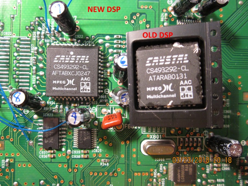

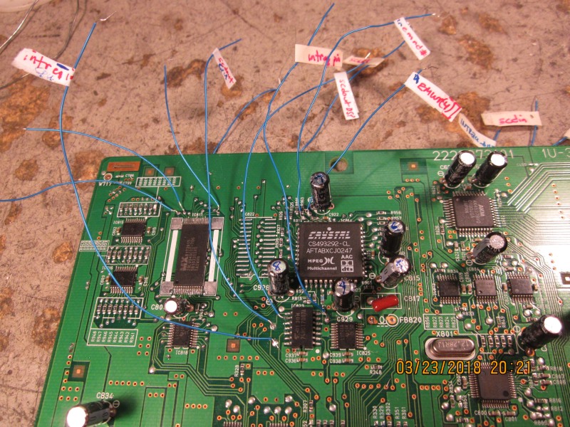

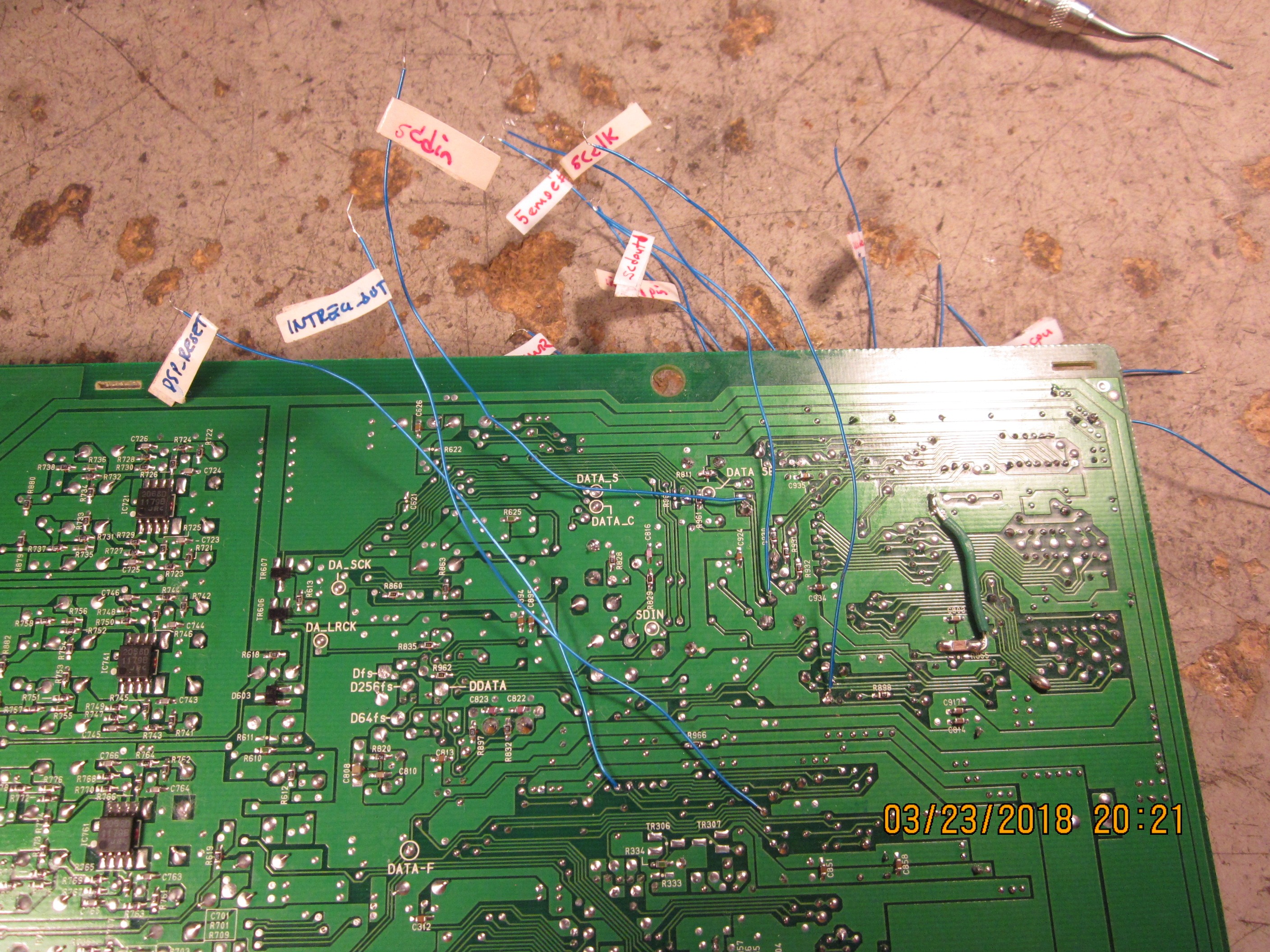

    update: 3/2018: Finally Denon AVR-982 (same as AVR-2800) is working after replacing the DSP.
    After replacing the Flash, the DSP program memory download was completing. However, the when the DSP CPU attempted a Read from the DSP (via SPI bus) the DSP IC did not reply. This made me suspect that the DSP was bad.
    I ended up replacing the DSP chip (Cirrus/Crystal CS493292-CL) and that fixed the issue. The Denon AVR-982 is working (with the Macronix replacement flash which I programmed as described earlier).
    I bought the DSP IC off eBay.
    https://www.ebay.com/itm/1-PCS-New-C...p/263355647333
    Attached some photos with new ICs, OLD DSP, and showing all of the Debug probe wires before I removed them.

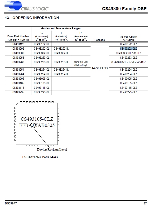

                                this is the IC available at Ali:
                                https://www.aliexpress.com/item/TCC8...ceBeautifyAB=0
                                CS493292-CLZ not the CS493292-CL would it work?

                                  #116
                                  Re: Denon avr 2802 with no sound on speaker
                                  I don't know what, if any difference there may be, and also I'm aware that counterfeit ICs exist in the market so it is more risk to try a different one.
                                  I don't understand why you don't order the IC off eBay, which I know works.
                                  The price on eBay is $US 11.99 with free worldwide shipping.
                                  The price on Aliexpress seems much more (~$25?).
                                        I looked at the DSP datasheet and the -CLZ version simply means it's a lead-free package.
                                        So it should work just fine. (See attached screen grab).
                                        You can download the datasheet anywhere off the web but I've also attached it.
                                        I didn't think paypal would be a problem but hey, order from whereever you want.
