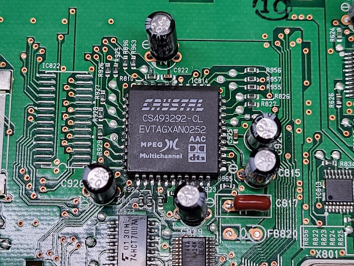

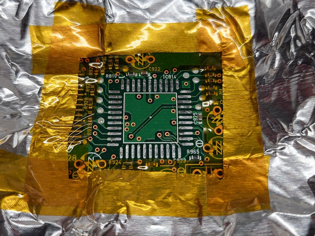

      I found this thread and it describes my symptoms exactly. I located the DSP chips on e-bay and just got done replacing it. I put a "surgical drape" of aluminum foil and capton tape around the DSP and used my hot air gun to remove the old chip from the board. I thought about cutting the legs one at a time then cleaning up the mess with my soldering iron, but am happy that I tried the hot air first. It came off quickly with no issues. I did remove the tall electrolytic caps from the area first to get rid of obstacles.

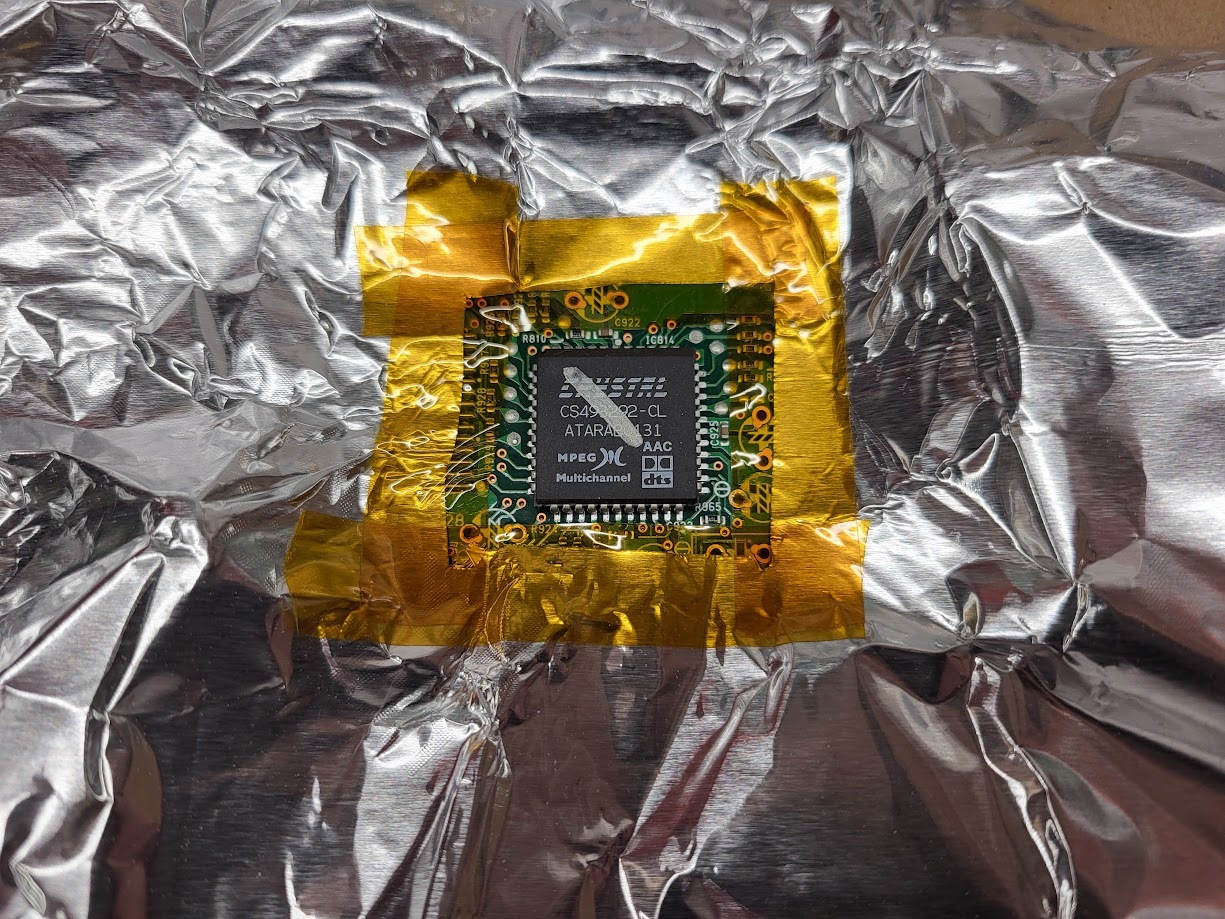

      New chip installed:

      Unfortunately, my symptoms remain.
      I've reviewed the previous posts here and am not able to locate the flash ROM data contents file. I think this is my next step. I'm not sure if the previous posters are following this thread anymore, but I'd like to request help obtaining the flash file, as well as any leads on the flash memory device. I've come this far, I really want to try to get this unit back up and running.
      Thanks all for reading and for any advice you can offer.

          Success!! It was my flash chip! As I mentioned previously, I swapped out the DSP chip and my symptoms stayed exactly the same. So, I replaced the flash IC and I have a perfectly working Denon 982 again! I'm am so grateful for everyone who contributed to this thread and provided the information. A special thanks goes out to azchris! I ordered the required flash chip from Digikey and azchris agreed to program it for me.
          To make the repair, I used mostly the same procedure as before. I made a heat resistance surgical drape from kapton tape and foil. I used my heat gun to heat the flash chip until the solder went molten, and picked it off with tweezers. Then cleaned the pads with solder wick and denatured alcohol. Finally, I soldered the flash IC back on by hand with a fine tip soldering iron. I did manage to create a few bridges on the fine pitch leads, but cleaned it off with the solder braid and all was well.
          To recap my symptoms, it was very faint audio, only audible with volume maxed out, and then if any input source was changed, audio was completely dead. Fix was replacing the DSP and flash IC.
