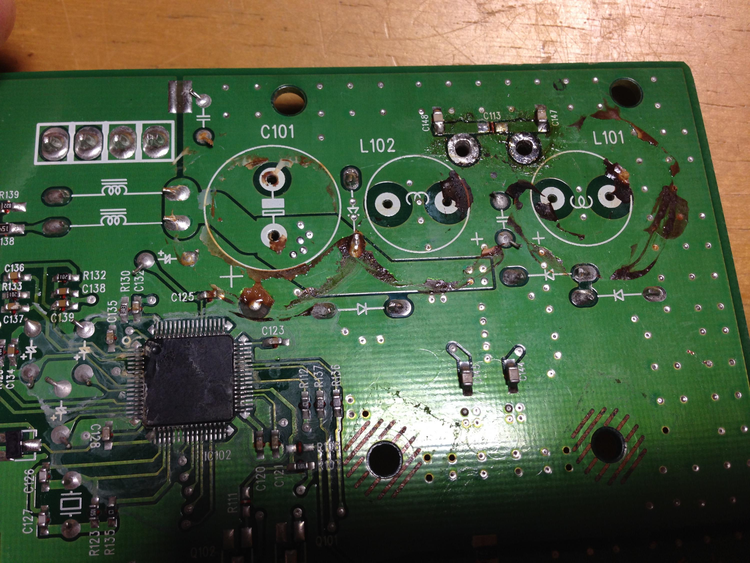

    Hi All,
    My Polk Audio DSW Pro 600 sub decided to stop powering on and I finally got around to tearing it apart. I ended up finding 3 blown capacitors on the amp circuit board (attached pic). The larger capacitor was easily identifiable and I've found a suitable replacement here:
    http://www.digikey.com/product-detai...1960-ND/589701
    However, the other two identical capacitors have no farad, voltage, or temperature rating whatsoever. Only thing on the label is 8019P 100L. I attempted some Googling but I could not find anything concrete. I'm making the assumption that I'll need 105C temperature rating for them as that is the rating on the larger capacitor. Any chance someone knows how to go about finding particulars on these? Caliper measurements are 13mm diameter, 21mm high, and roughly 6mm spread on the leads.
    Thanks in advance!
    EB

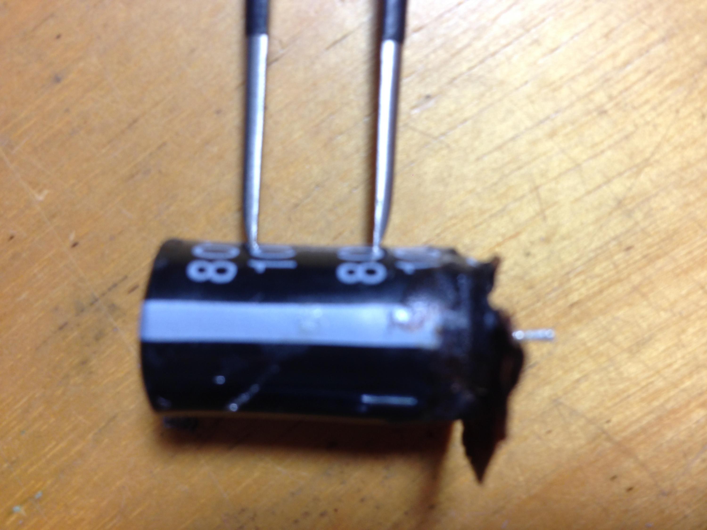

    Re: Need help identifying capacitor
    Is there a stripe on the side? What are the designators for those two unidentify caps Cxx? Can we see the picture of the board so we can figure out the function of those caps?
      • 31111
      foto of the top and bottom of the mystery part - it may be an inductor.
          They must be the inductors for the Class D output filters.

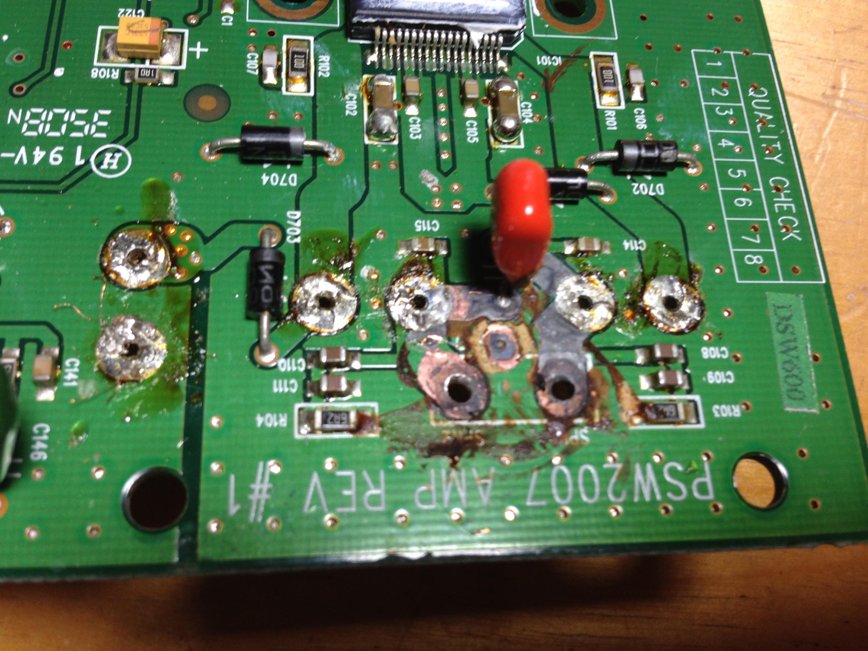

            Thanks for the replies, Guys!
            There is, in fact, a stripe on the side (photo 1). The other two photos are the back and front of the board. The back side is marked with C101, L101, L102 - sorry, you're dealing with a rookie here!
            The two holes between L101/102 had +/- wires soldered directly to the board. Could not get them to desolder even at 475C. I ended up adding leaded solder to the joint and slowly but surely they finally came loose. Needless to say, the board needs some serious cleaning. Am I good using 100% isopropyl?
            Thanks again for all the help!
              C is short for Capacitor.
              L is short for inductor ... so L101 and L102 are inductors.
              Isopropyl alcohol should be fine.

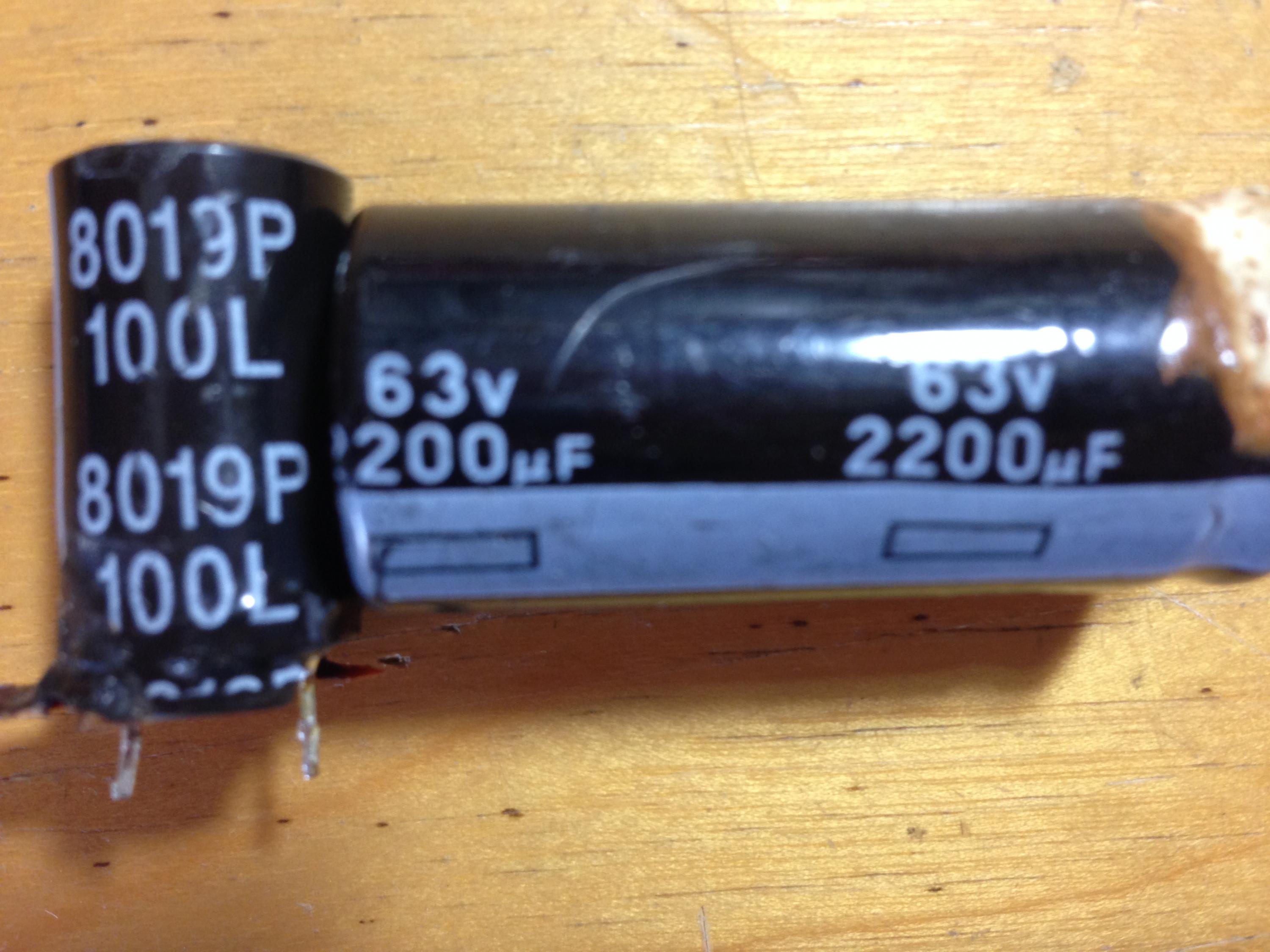

                            • vierdane
                              • Aug 2019
                              • 4
                              I just pullout the two inducer and when looked on google for a cross ref. it got me on that forum. I don't know how to read them the Uf reads 0.08 and the other on read 0.12 . Good ? Bad ? don't know. The 2200 - 63v read 1960Uf giving 20% I think is still good. If I can fix that thing I will post a Video on Utube cause there lots of people just like us stuck with an expensive box. My boar was replaced bbefor the 5 years warranty once and same problem 5 more years later. I there someone that can suggest a crass ref for those guys?
                              • vierdane
                                • Aug 2019
                                • 4
                                Sorry mean Inductor 8019P 100L
                                    Read post 12.
                                    Pictures of the inductor and why do you think it is bad?
                                      They are very likely 10µH coils, I also see Kwang Sung 8019P-23-100L listed as 10µH ferrite inductor
                                      I also see the identical inductor (as pictured) listed on web sites as 100mH but I believe they are wrong.
                                        So I test both inductor 8019P 100L. . Reading 0.00 all three different holms meter including a Fluke. I think they bad? I can't find a place on line where to purchase them.
                                        Unless big quantities.
