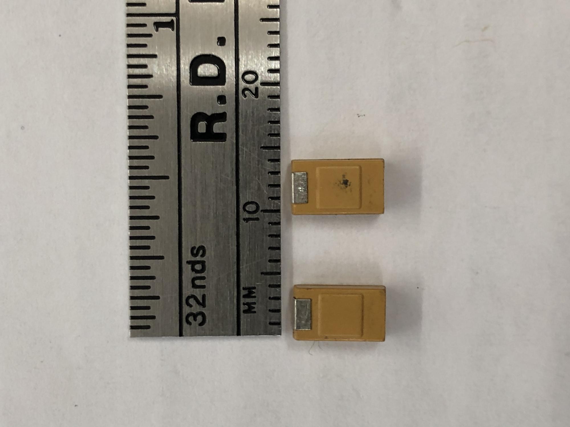

    I need help identifying this capacitor. Voltage and rating?'

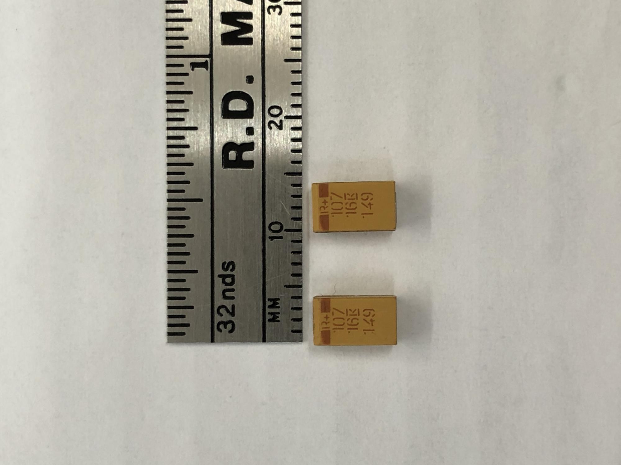

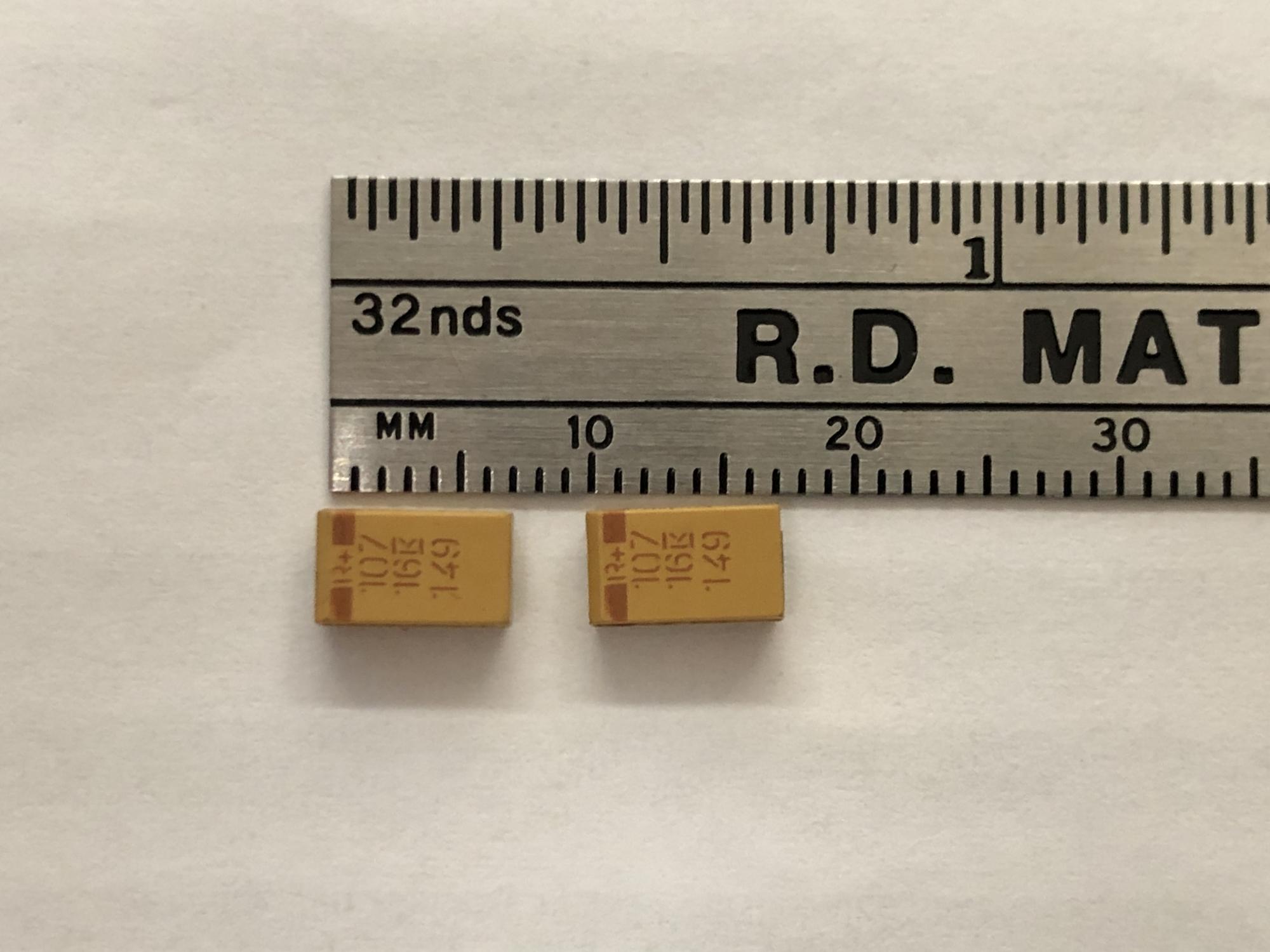

    Re: Help identifying capacitor rating
    107 = 10 & 7 zero's
    so 100000000 = 100uf
    16 is the maximum voltage.
    K means +-10%
    they are tantalum.
    7x5mm is package type D,X,V or W depending on height.

      +1, and the bar is for positive terminal for this Tantalum cap, bar for lytics cap is for Negative terminal.
