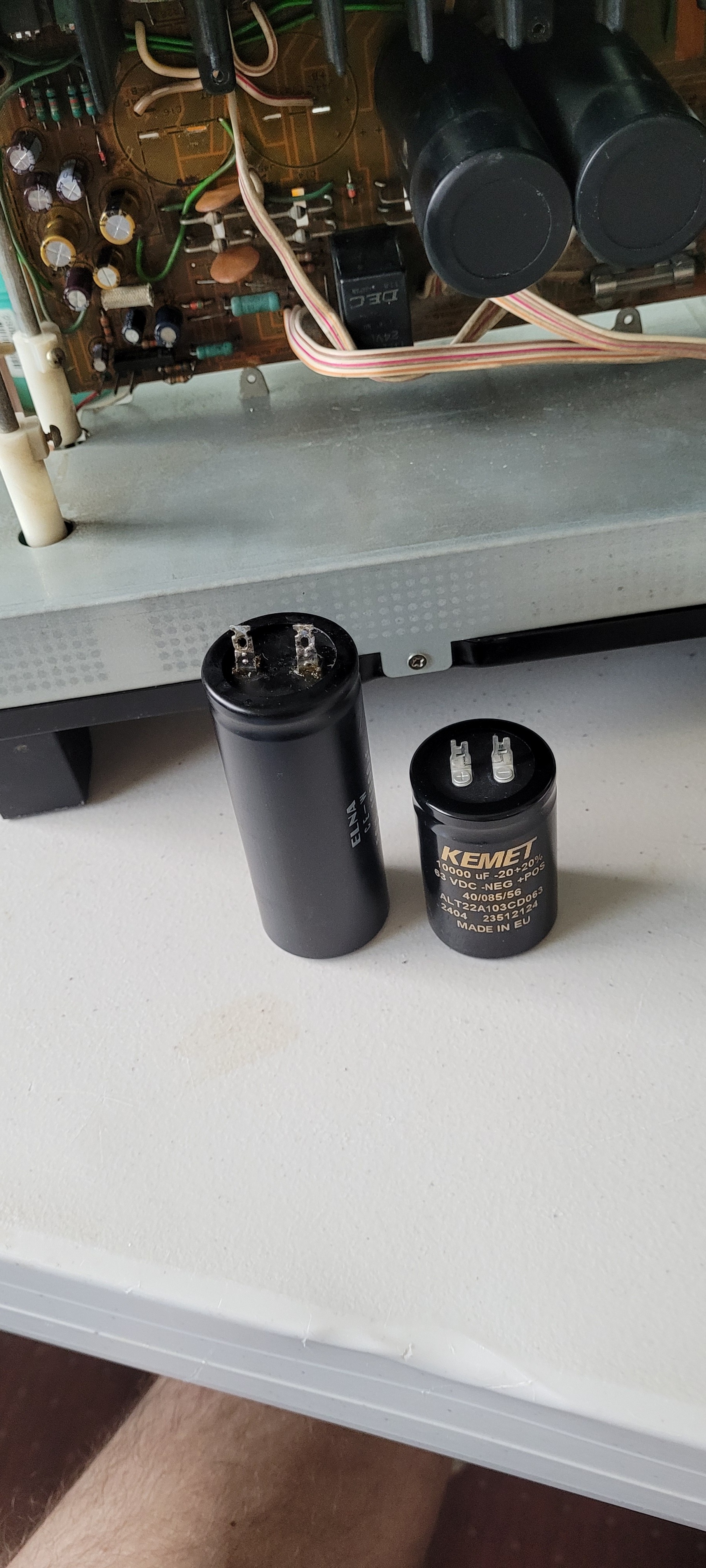

      Monday I'm going to remove the other two caps, check the other components under heat sink, then work on moving those wires, there is sufficient length on all wires. I'll snap a few photos, before , and after. I'll do 1 wire at a time.

        I’d just relocate the affected wires, unless you just can move the whole harness underneath.

          #184
          We have a green wire, and one wire from the harness in each, cap position, so I'll run the green under, and one wire from each side of the harness under, on both sides. Two of the harness wires can just be moved out of the way. Wire is extremely stiff, so caution will be used. It's going to go slow I don't want to damage a wire , and not know, I'll never find it afterwards.

            #185
            why not drill new holes that won't be in the way ?

              #186
              Sure. You could drill a hole in the PCB at a more convenient spot as long as the traces you need are there and install a small post to solder the wire to.

                #187
                Pete, that's all beyond my skill set, my luck I would drill into a trace and destroy a perfectly well cared for amp. After further examination, I will probably just extend the leads.

                  #188
                  NO, we'll beyond my skill set. Probably going to take the chicken shit way out, and just extend the leads.

                    #189
                    Whatever is in your comfort zone and stick with that,

                      #190
                      Yea after further, and closer examination, I can only relocate the green wire, other's will be well short, so I'm going to purchase a Kemet cap whose leads are 10mm, just like the ones I removed. They are a little pricey, but this is my amp so really no problem putting in a few extra $$$ in it. I'm not interested in selling so if I put more in it than it's worth it's ok.

                        #191
                        New caps arriving on sat, should take a day or so to install.

                          #192
                          Ahh! We have to see pics of these new caps installed.

                            #193
                            There coming, give me a day or so. No hurry remember.

                                        #199
                                        Here are the caps, new,and old. See the difference in spacing?

                                          #200
                                          Check this out on Digikey:
                                          56-MAL205018103E3-ND
