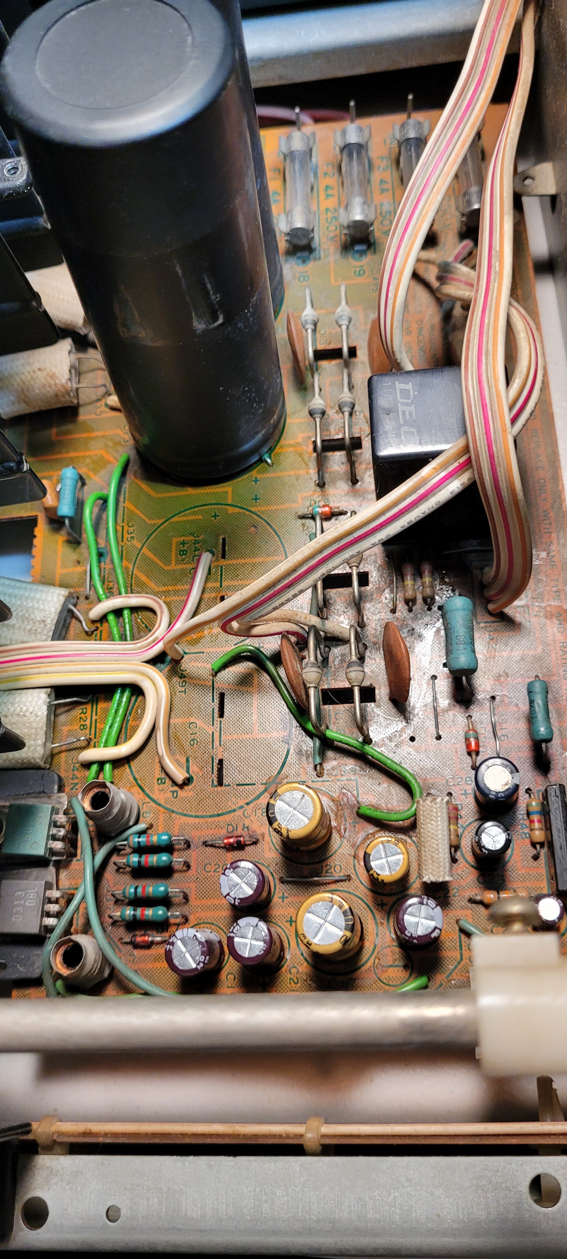

    I've decided to change the caps on the power supply, I might as well, while I'm there changing the main filter caps. I promise no more till I see if I have a working amp . IF not I might just smash the hell out of it, kidding!

            I'm back, started to recap the power supply, have 3 more smaller caps to do, then the 4 larger ones. While I have those large filter caps out, I'll check the components that I couldn't reach. After that is complete, we will test the amp, and hopefully have a perfect working amp. Fingers crossed.

                Oh, before I forget: Take that protection relay out and check it. Also check the coil resistance.
                • rccrasher65
                  • Mar 2014
                  • 626
                  #168
                  I can. I'LL just replace it, I have 8 of them new.

                      I got the first two mainfilter caps pulled, pain in the ass. Who would run wires under a cap. Now my leads on new caps are short. Components are checking out so far. The plate resistors that is. Get back to it on sat. HOLIDAY!

                        put the wire on the other side of the board if it bothers you

                          No, too much work, just a ridiculous design that's all. I'll have to extend the leads with something, they just make it through the board, and are flush with the other side. It would have been perfect if it was another 1/16 in longer.

                            its a dumb design all right.

                              I have to agree, now I have to extend all the leads on the caps because they are short. If they would sit flush with the board that wouldn't be necessary, but wires are run under the caps. More bullshit work to do I guess.

                                Aren’t the new filter caps a bit smaller in diameter? I’d be tempted to relocate some wires.

                                  I'M going to take a closer look, and see what I can do. I recapped my other KA 701, and don't recall having to do all this. Keep in mind it's a little different. I might just have to relocate a few wires. The caps used were kemet, and I have the Nichicon now. Both are snap in type. I don't think any caps this size or value have longer leads. Yes new caps are just a few mm smaller in width. Definitely in height by a good inch.

                                    Yes, usually new caps are smaller than the old vintage ones. One amp must be newer than the other one that’s for sure.

                                      Yea I really never looked into that, I know I bought in 79 or 80. When I was a sophomore in High school. Saved forever for it.Well I have two choices relocate some wires, or extend the leads. What do you think?

                                        Personally and because I can, I would relocate these wires. I just don’t like wires squished underneath components, can’t stand that. But that is just me and my OCD.

                                          Just had to ask, I can , and will relocate them as well. That was just a stupid design. I just can't see engineers doing stupid shit like this, but It did last 50 yrs. I guess it will be a few more days work for me. I'm slow as you can see.
