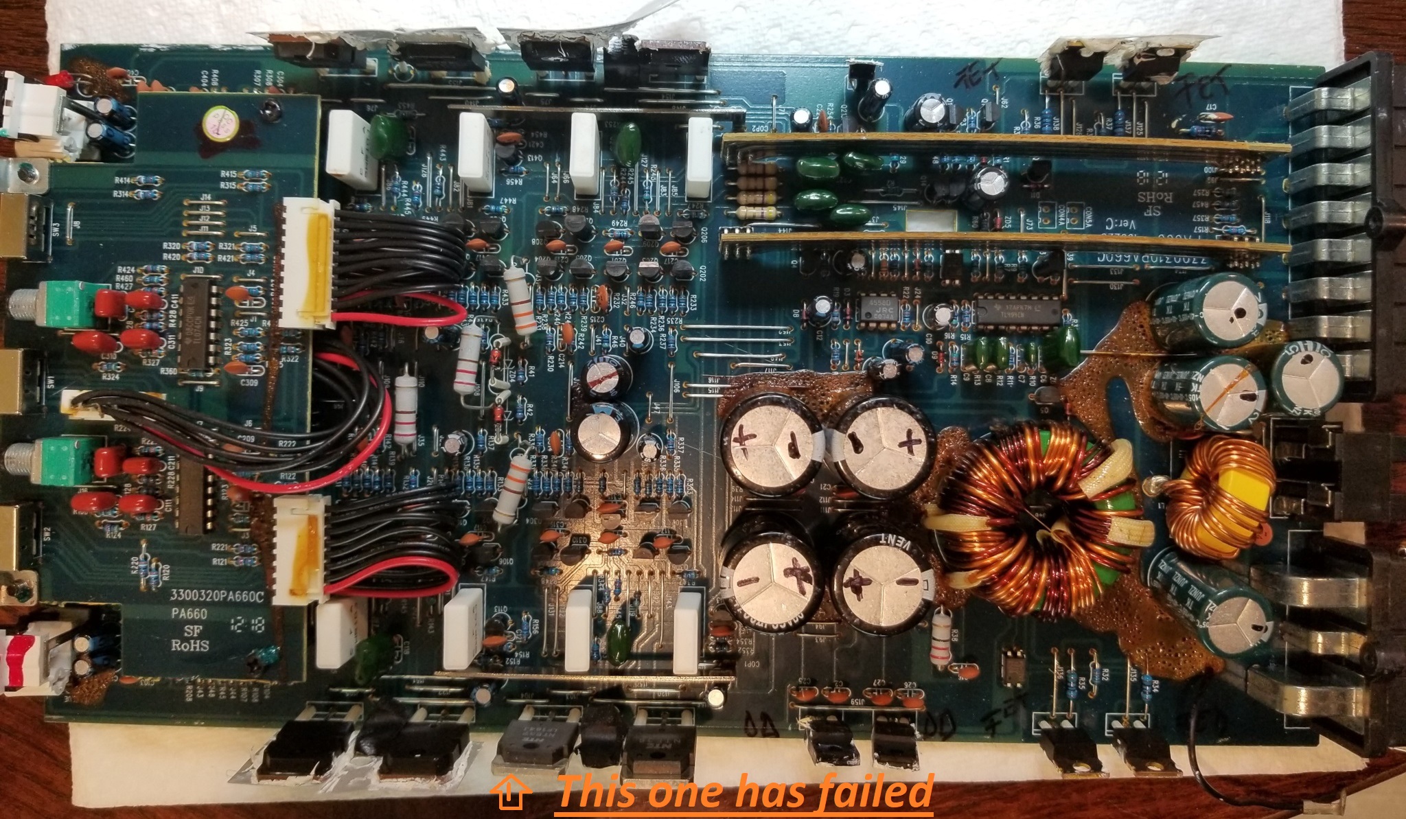

      The PA660 failed again.
      Found a final transistor 2SB668, shorted. After I have removed it, and powered it up, the Red LED turned on, for like 7 seconds and then went off. I'm wondering what that means? The Blue LED(power) does not turn on at all. It could be, that one of the transistors is missing and the amp is not ready?
      It is hard to work on these things, without a SM.

            OK, I have replaced both transistors and the protection LED is off. But the blue LED is not on either.
            I measure -27V, but only +1.4V on the other rail, if I measure it the right way.
            It is hard without a schematic.
            I would appreciate any help. I can't listen to my stereo in my car, because this amp supplies my door speakers. I drive over an hour each way to work and without it, it is very bad.

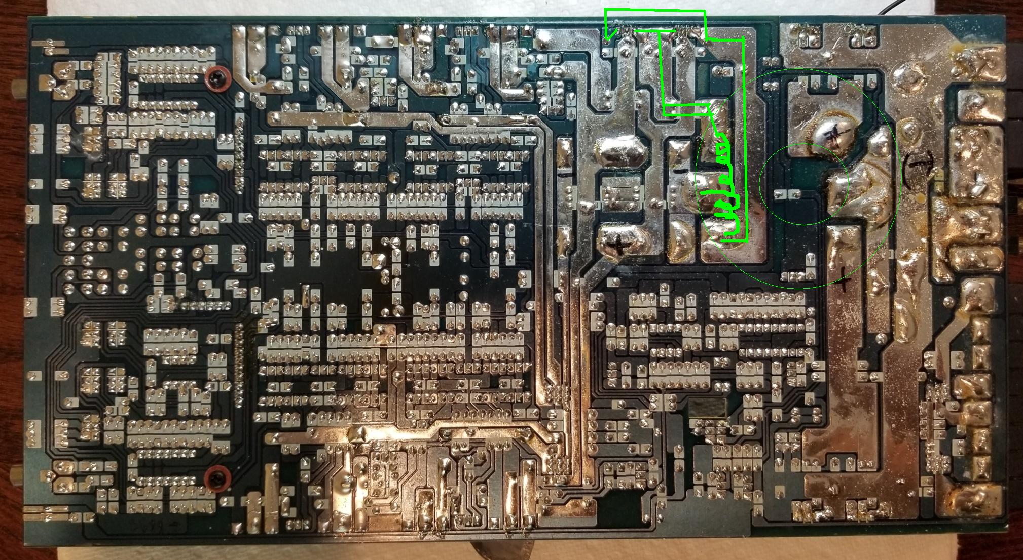

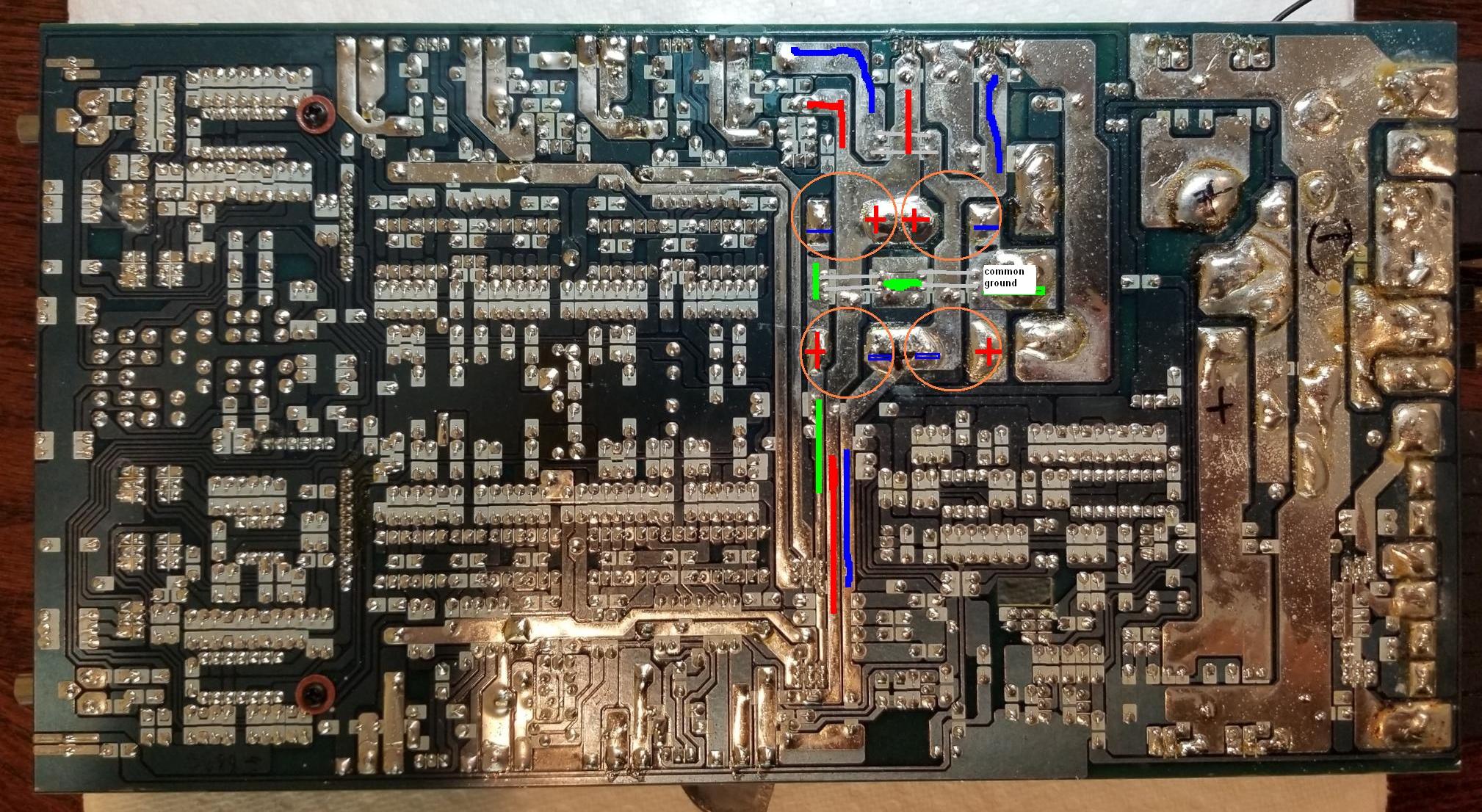

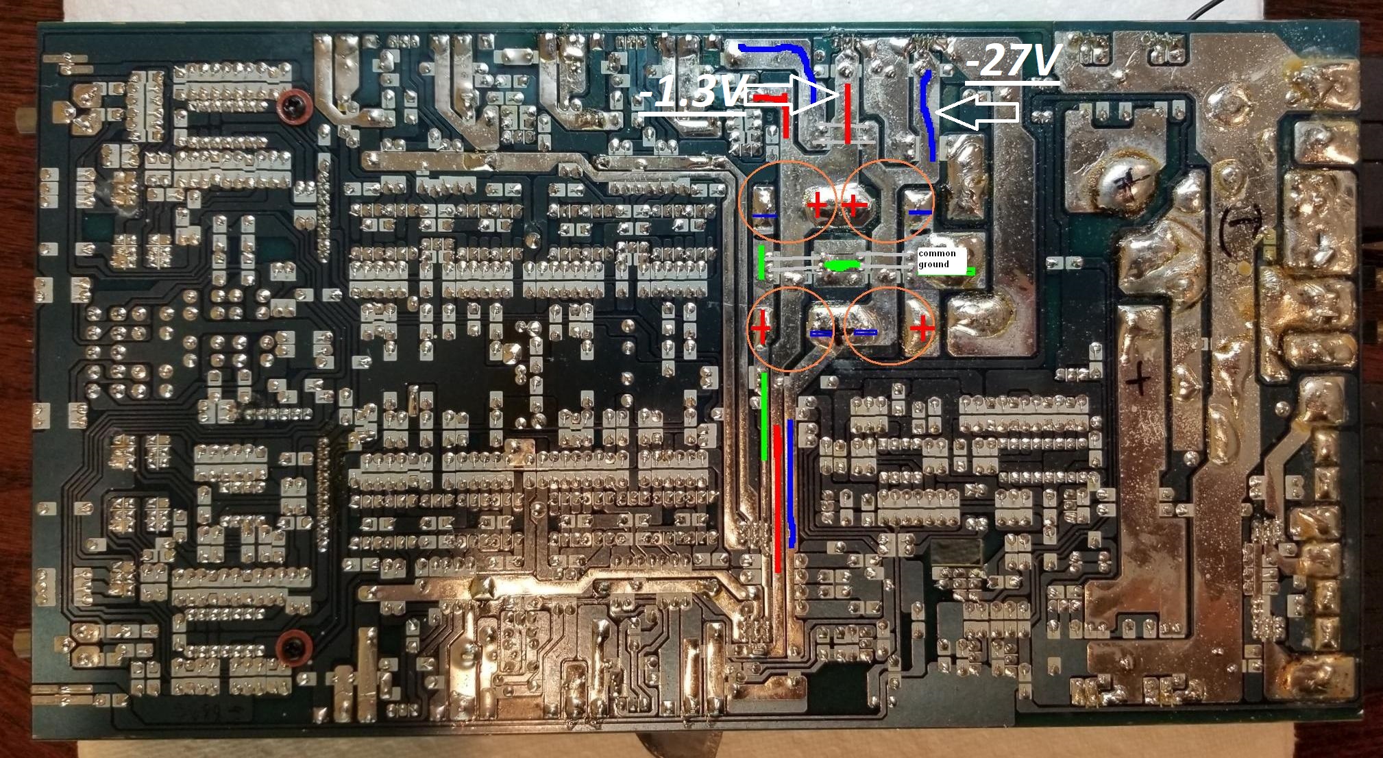

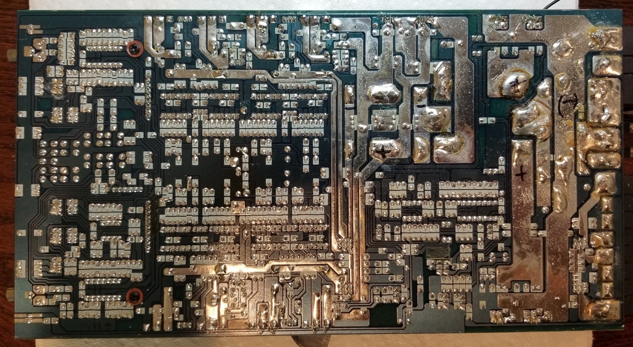

                There are actually 4 big capacitors.
                I believe, that I have the proper voltages, I'm just not measuring, from the right ground.
                I'm having a hard time, to find the proper grounds to measure. I'm in a hurry and I'm not able to think clearly.
                Here are some pictures taken, with my phone.

                  Re: Car amplifier(Polk Audio PA660) question
                  This should be the ground and plus minus marked.

                    I may have made a mistake, when I have removed the two double diodes. I thought that they are the same, but the last three letters makes them different and I did not pay attention to that.
                    1FB2CCA /1FB2CAI
                        The amps is powered by + GND - power supply, right?
                        Why I'm getting only - at both amps? It seems like one of the rails is way to low(-1.3V)
                        What would happen, if I would revers these double diodes?

                          Check the connections on that dual diode, also did you check it to make sure you did'nt blow it when you reversed it
                          If you reverse the diodes you will blow up the amp. What do you think happens if you put negative voltage to the positive of a capacitor... pufff
                          You likely damaged a trace taking them out

                            R_J, you are awesome. Thank you very much!!!!
                            To me it did not seem like there is any bad soldering there(maybe, the center pin on the left double diode, it was a bit suspect), but I went over all 6 joints and the blue led has turned on.
                            The Red LED turns on, for like two seconds and then turns off. Than the Blue LED turns on.
                            Now I have +27V as well.
                            YEAHHH!!!
