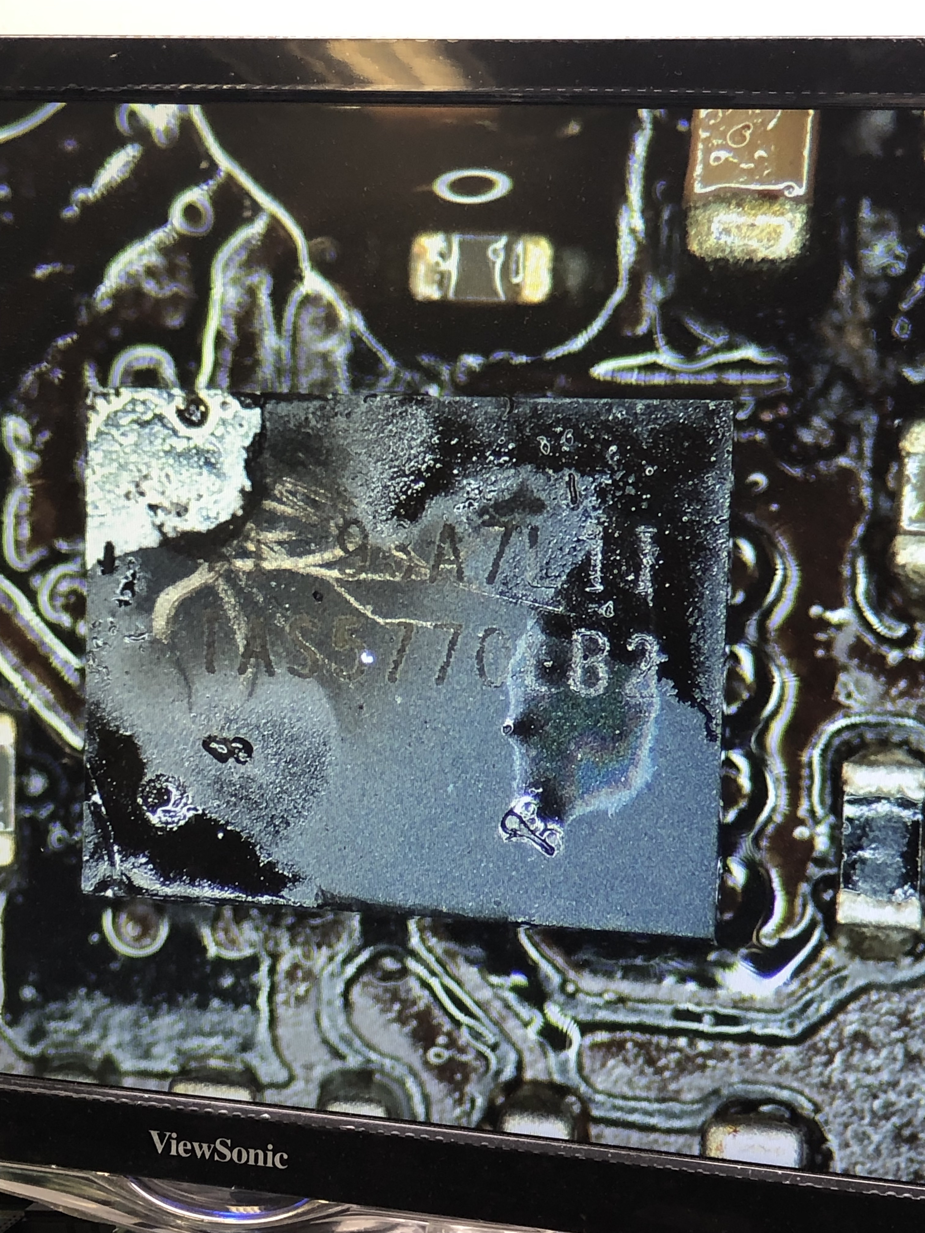

    MacBook Air 2337 - Right I/O Board Audio IC - Alternative Replacement?
    I'm working on a MacBook Air A2337 that had liquid damage on the right I/O board. I ultrasonic cleaned the board and it all functions except the computer has no audio. I tried reballing the audio IC which is TAS5770AC0, but that did not restore audio. I could just replace the entire board, but I wanted to see if replacing the audio IC would fix it first. Mouser has a similar audio IC in stock which is TAS5770LC0YFFR, but I wasn't sure if it is compatible. I was just wondering if anyone knew if I could use the one from mouser as an acceptable replacement or if I need to purchase TAS5770AC0 specifically which I can from AliExpress, but I was hoping I could use the one from mouser because it will get here quicker.
    Link to Mouser IC: https://www.mouser.com/ProductDetail...1Sao5dDQ%3D%3D
    Interestingly, when you click on the datasheet link for that IC, it links to a datasheet for TAS2770. I don't know if that is an error on Mouser's website or what, but thought I'd point that out.

    How did you make out with the repair? Working on an A1932 with no speaker output. Also suspecting the same audio amp to be defective. Will review to source the BGA amp from DK to service this board. Plan B is to replace the entire audio board.
