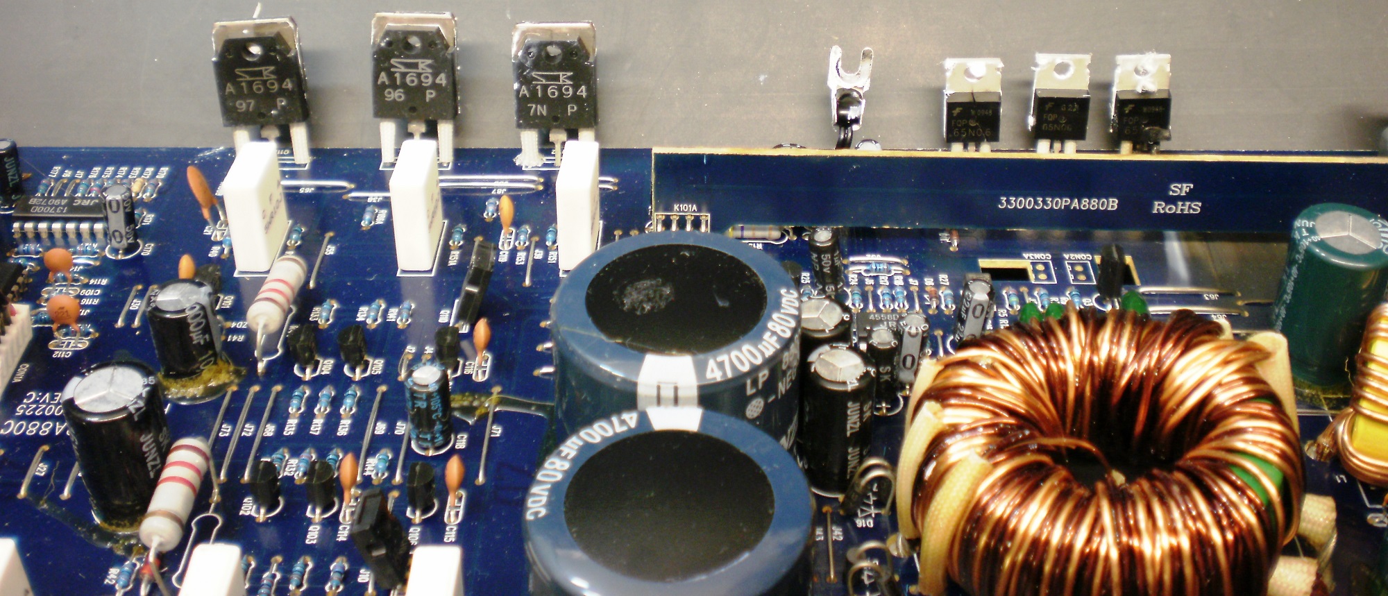

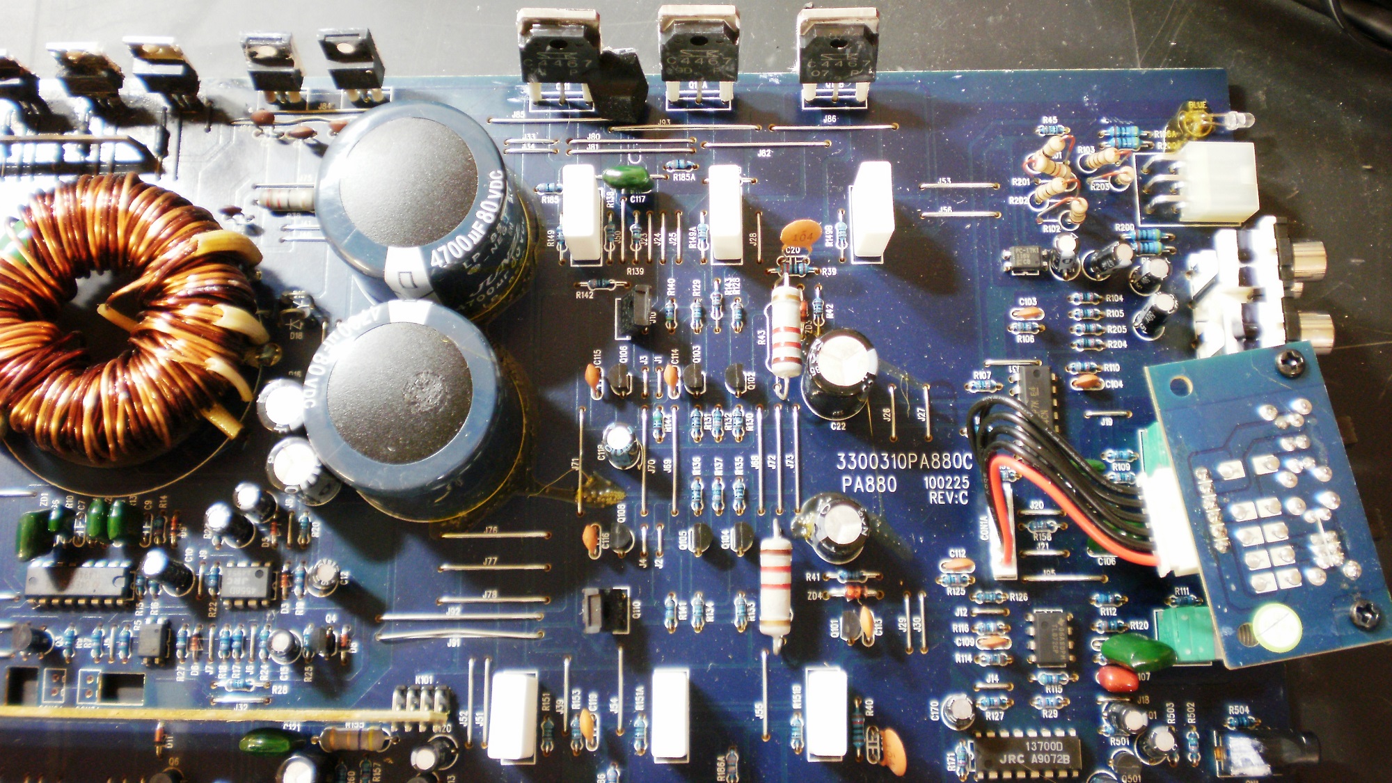

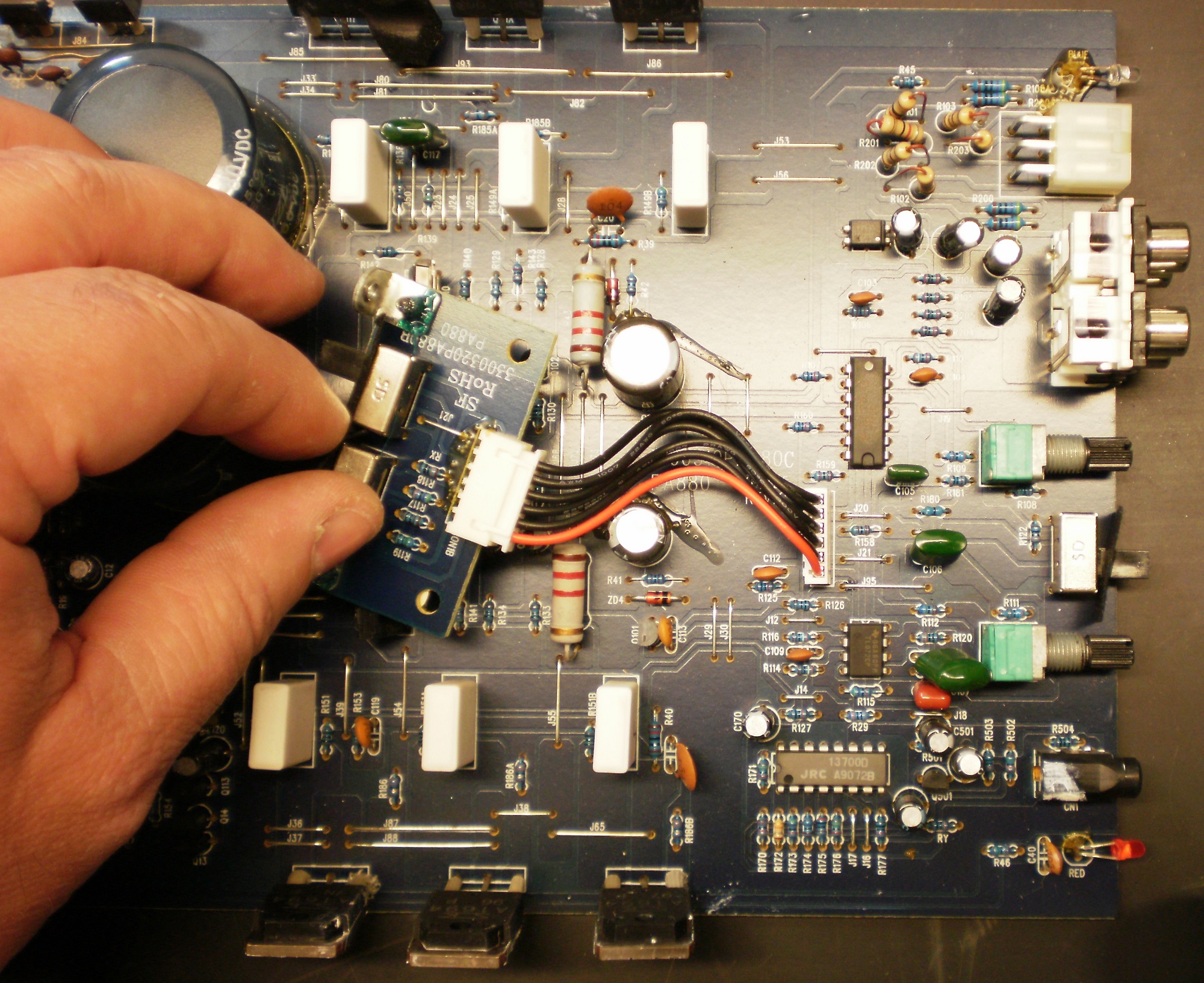

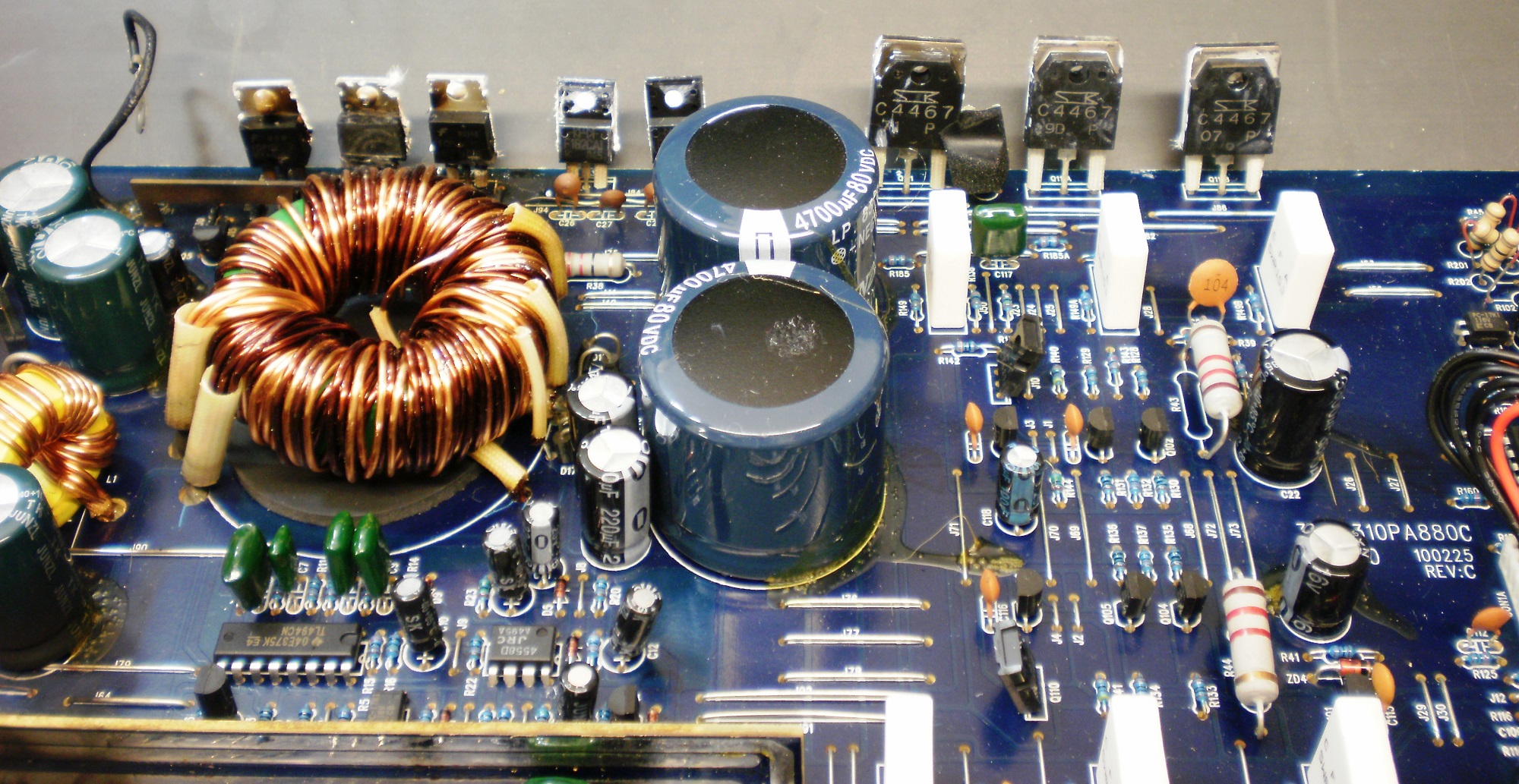

                OK, I have received the PA880 amp and checked it out in a hurry and there is extensive damage in there. The worst that I have ever seen.
                Basically, everything what is mounted on heat-sink, is blown. And not just those.
                I'm at work right now. When I have a little bit of time I will take those pictures that I have promised.
                It's Christmas now and hard to find time.
                I'm contemplating, if it's even worth repairing this amp. Cost will be pretty high.
                I'm thinking of keeping this for my car.
                Transistors are:
                2SA1694/2SC4467 x 3 pairs
                2SC3421/2SA1358 x 1 pair
                power supply:
                FQP65N06 X 6 transistors
                Most likely, there is more that got damaged, I will have to measure a lot of parts.
                All the power supply FETs are blown/cracked badly, there is a lot of ash on the PCB. Mica is brown behind them.

                      Re: Car amplifier(Polk Audio PA660) question
                      Originally posted by tibimakai
                      Wouldn't you have, some substitute transistors for these by any chance? I need to repair this as cheaply as possible. Since I need to replace way to many transistors, it wouldn't heart using some cheaper alternatives.
                      Not/never a good idea. You need plenty of SOA for the output devices, since it's not uncommon for these amps to operate in high ambient temps. Also, they're often "abused"- previous owner ran too low an impedance, further stressing output devices, as well as MOSFETs in power supply.
                      I always use larger/better rated finals, as I described in an earlier post.
                      The MOSFETs in the power supply should also be upsized, possibly the output rectifiers as well.
                      I can't even get two of each, because it's getting to expensive.
                      I will have only a one time go at it, if it blows then I will just put it away.
                      You're not kidding. If it blows up again, that board will probably be burned beyond repair, if it isn't already. I'll need some pix of it.
                      What "two of each" can't you get?
                      I'd be better able to advise you of your options w/ this amp if I had, again, some good pix. If the board is still mostly solid, the amp can be repaired to better-than-new condition.

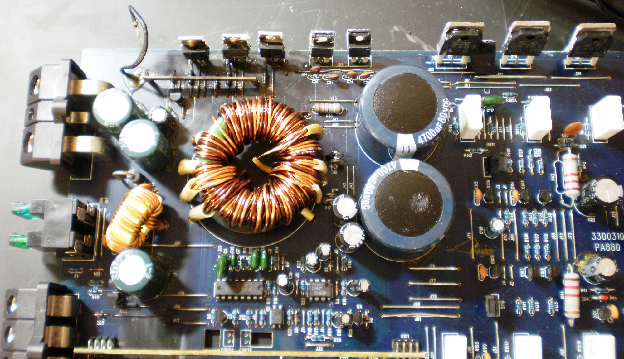

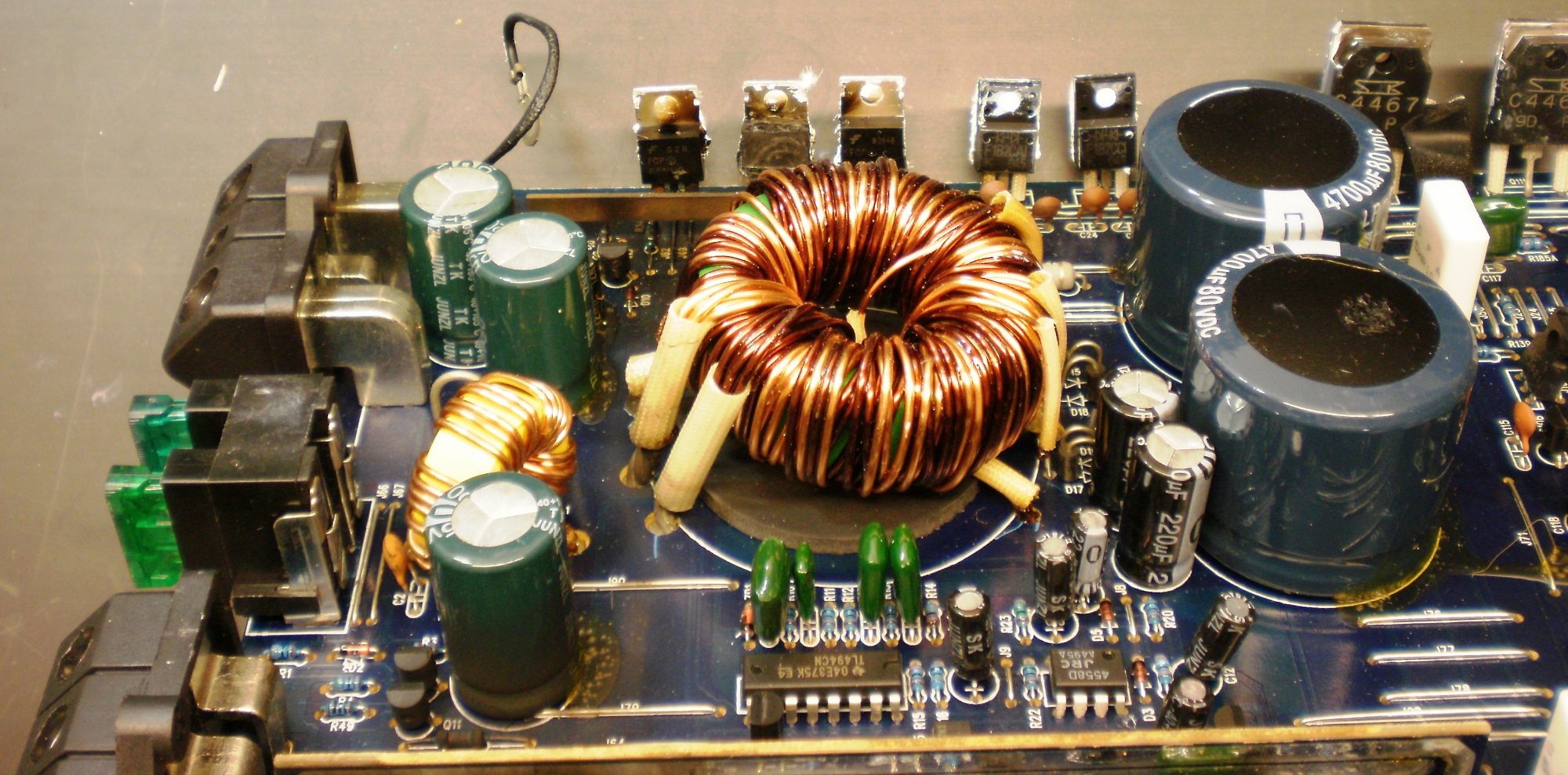

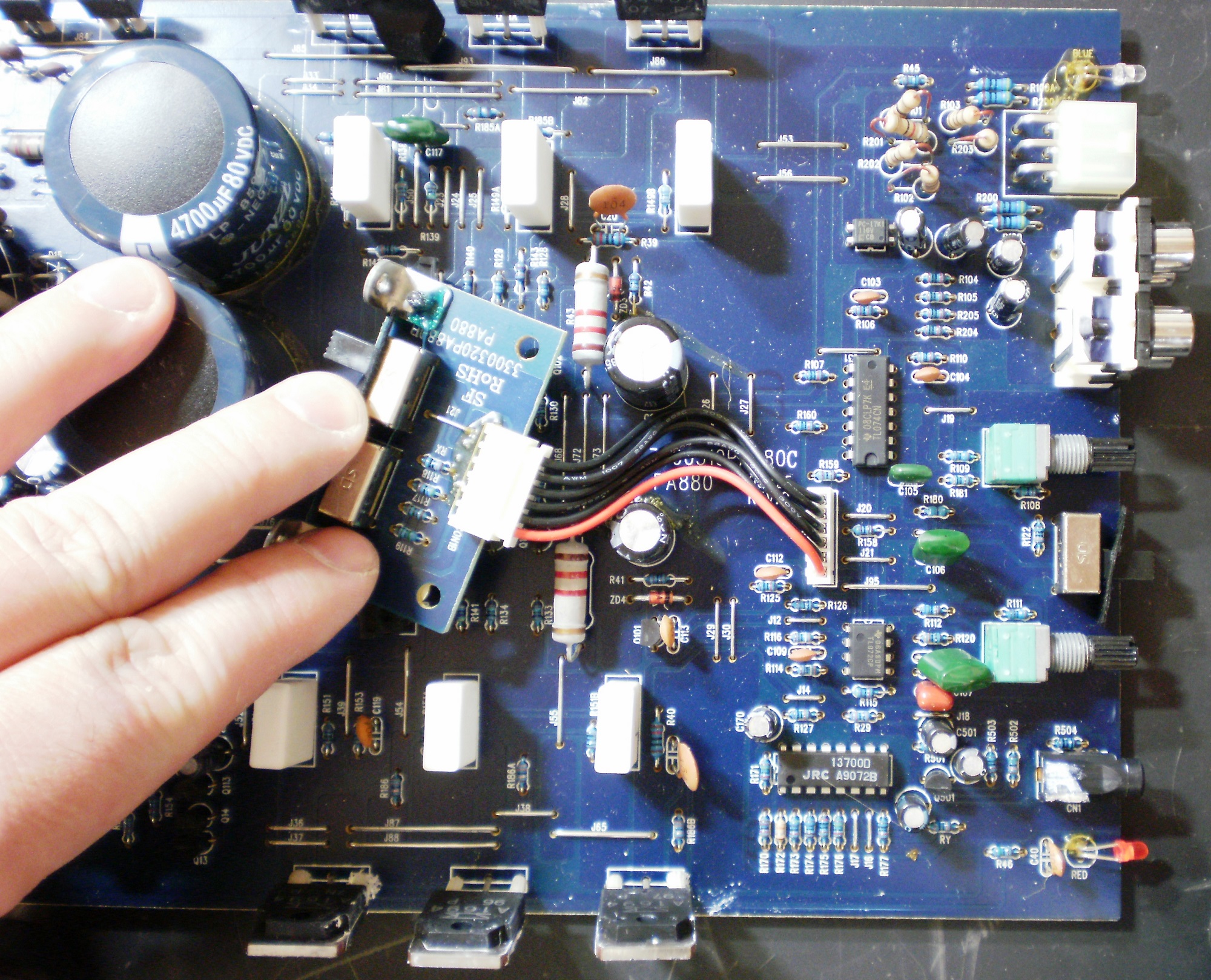

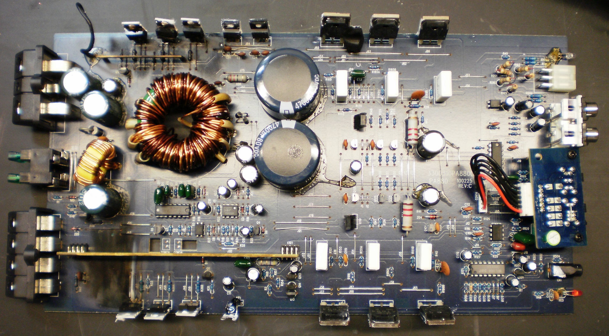

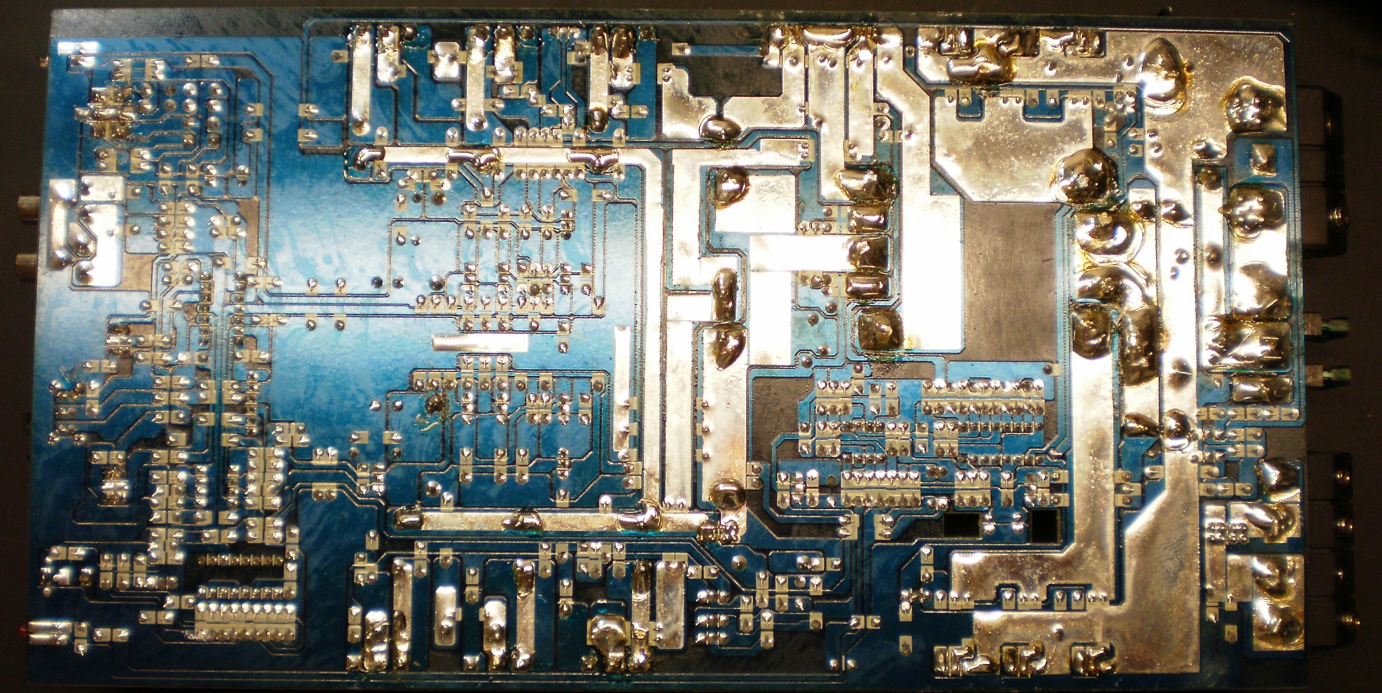

                            OK, I have some pictures, the lighting that I have in the garage, it's not the best though.
                            If it's not good enough, then I will take some other ones tomorrow outside.
                            • kaboom
                              "Oh, Grouchy!"
                              • Jan 2011
                              • 2507
                              What value are the fuses?
                              All MOSFETs in that power supply have blown apart. The diodes could even be bad.
                              Either a cascade failure of finals-> then power supply, or running too-low a load impedance for far too long.
                                        You were right, the two fuses have slightly different green tint. I guess, somebody has changed at least one of them.
                                        I should get some 10A fuses, for testing?
                                        I still have to go through all the components to see which one is shorted.
                                        I know for sure that the 6 x finals, 1 pair 2SC3421/2SA1358, 4x FETs at the PS are blown for sure. Emitter resistors seem fine.
                                        This is how far I have checked so far.
