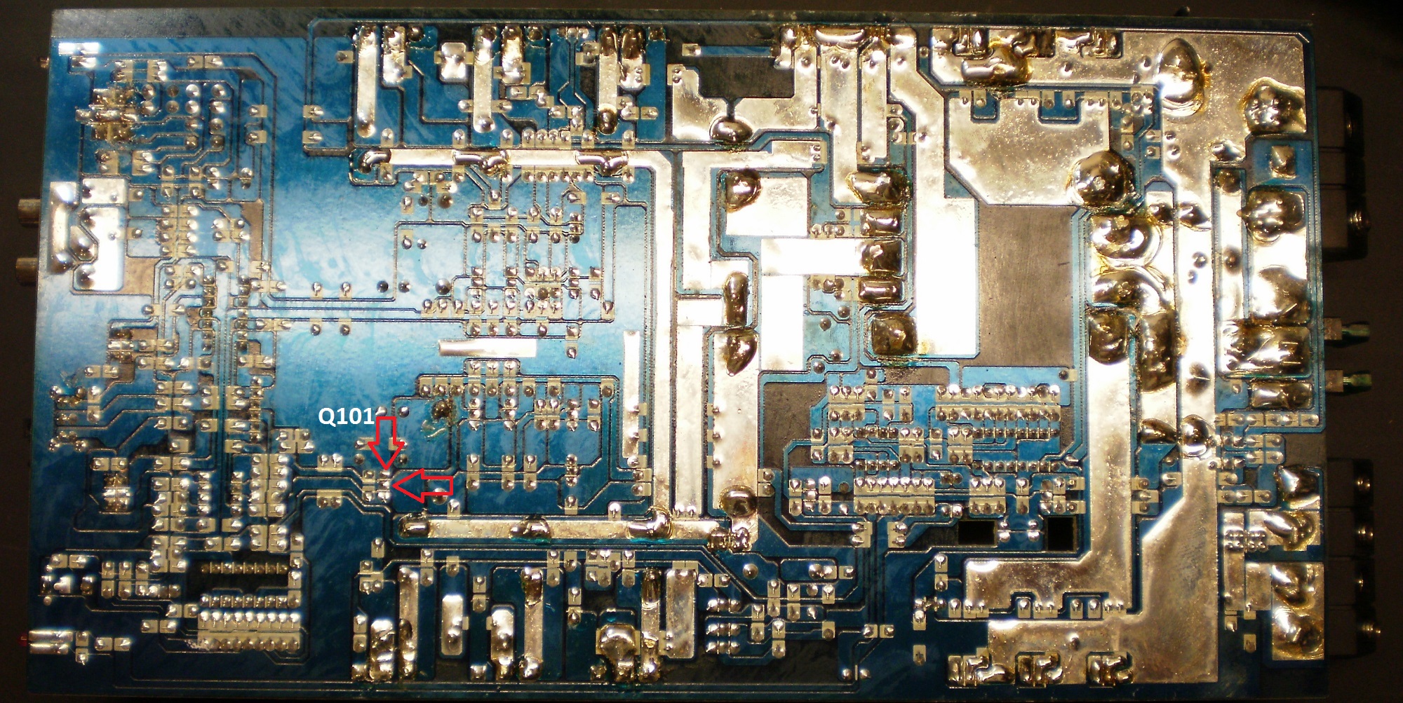

    6 FETs not 4.
    • tibimakai
      • Jan 2012
      • 3680
      Re: Car amplifier(Polk Audio PA660) question
      The PA660, it's working great after replacing the two blown final transistors.
      Next is the PA880(nightmare) amp.
      Need to measure every component and order what I need. I will go with the suggested final pair.
      Any recommendation for the FETs?

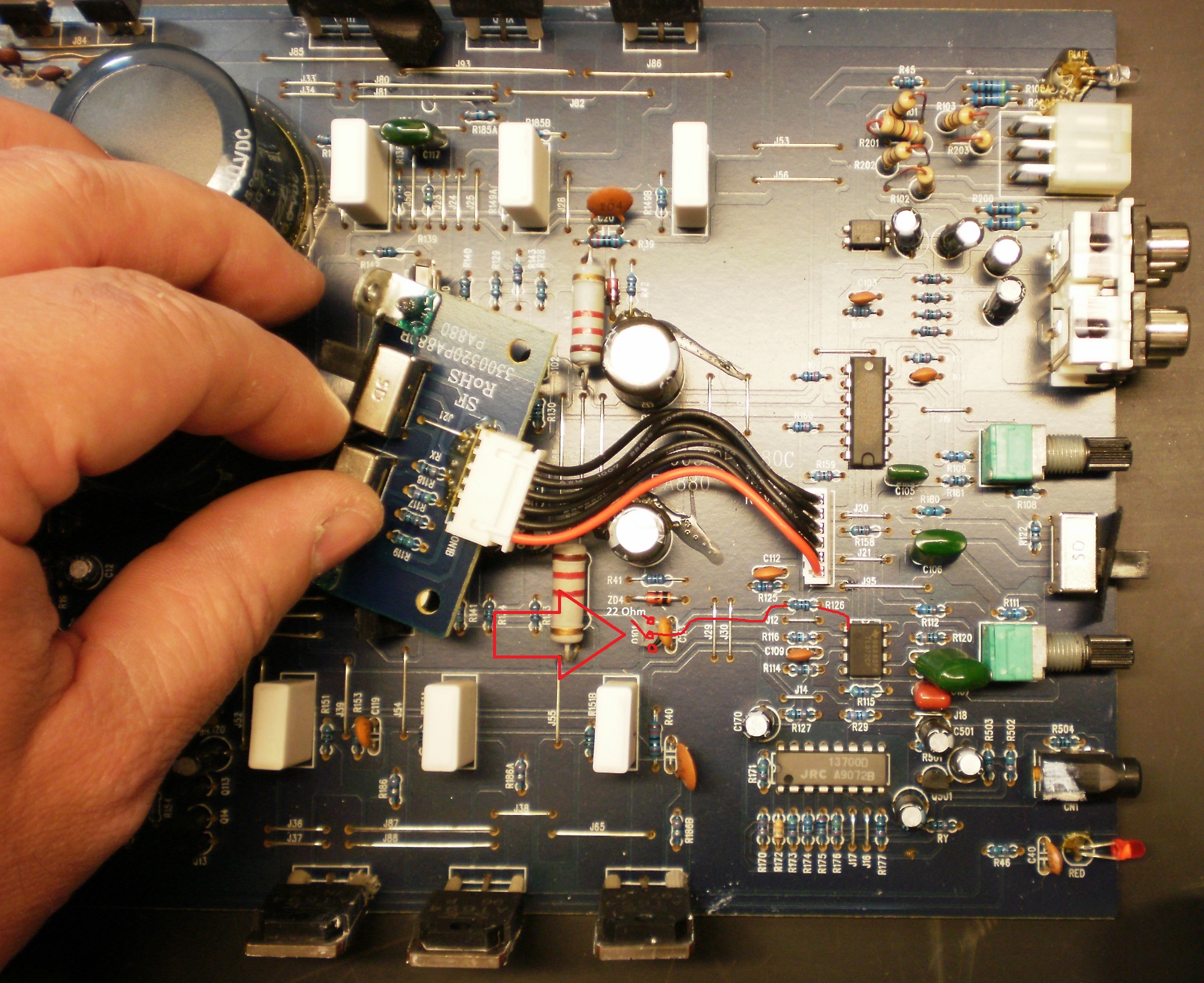

            Originally posted by tibimakai
            I will ask a stupid question, if I will used these transistors and the other finals that you have recommended, the amp will have more power, or they can just take more punishment?
            No, it's not stupid at all.
            As to the question, the latter applies...
            The output power is limited by the supply voltage to the power amp itself. This is set by the ratio of the toroidal transformer in the unit's power supply.
            You may notice a few watts output (5-10) more than with original output transistors, since better ones maintain their beta better with increasing (output) current, dropping less themselves and keeping the voltage to the load (speakers) better/higher. IOW, better devices simply maximize what you should've been getting from the unit from the outset.
            Depending on the RDS of the replacement MOSFETs in the power supply versus the originals, it is possible for them to run slightly cooler.
            But mostly, these little upgrades will make it far more durable and "abuse tolerant," always good for these car amps.
            There are 12 resistors associated with those MOSFETs. 6, 10K-47K, from the gates to GND, ensure that any leakage does not allow the MOSFETs to conduct. These are of such high value that a shorted device's backfeed will not destroy them.
            There are another six, 4.7-22 ohms, from each gate to its driver. Check all of them for opens, since these will be damaged should a MOSFET backfeed.
            Just to be sure, check, with a scope, the drive waveforms before putting the new MOSFETs in.
            Replace the fuses with a single 2A fuse, and apply power through a 10 ohm, 20W or greater, resistor. You should see the amp's caps charge up. Normal voltage should be from +/- 65 to 75V. You'll have less than this with the resistor in the 12V supply, but you should still have those two supplies.
            You'd want to check this without the 6 power transistors soldered in, for obvious reasons.

                          Everything looks pretty good. Two 100Ohm resistors legs are broken off at the through hole, but they all show good values(the ones around the burned FETs).
                          One suspect transistor I have found which I can't figure out if it's good or bad.
                          It's a J111 JFET transistor. Between the Drain and Source, I'm measuring 22 Ohms in circuit. I have never dealt with a JFET transistor before. How can I check it out?
                          8 pin IC is a TL072CN.

                              I have started working again on this amp.
                              The problem is that I don't know what I'm suppose to do.
                              I have replaced all the FETs including the JFET. Tested all the resistors arounf the FETs and they all have checked out good. I have also replaced those three 100 Ohm resistors next to the FETs, which looked black.
                              I have replaced the fuses with 2A once. I have tried with one and it blew it.
                              I haven't tried with a 10 Ohm/20W resistor though.
                              The amp started up and it didn't show any protection error.
                              The finals are not installed yet. Since the PCB is back in it's housing/heatsink I couldn't measure the voltage at the capacitors, but at the pre-finals I'm measuring 60V.
                              I'm lost with the scope measuring. What kind of signal should I use, where should I measure and on what scale?
                              Any help would be appreciated.
                                  I have found a short between + and -.
                                  Need to find out what is causing this short.
                                      It was my mistake.
                                      I have used the wrong screw, to mount the fuses to the front panel. It was to long, and it was touching the positive terminal of one of the fuses.
                                      The amp is working!!
