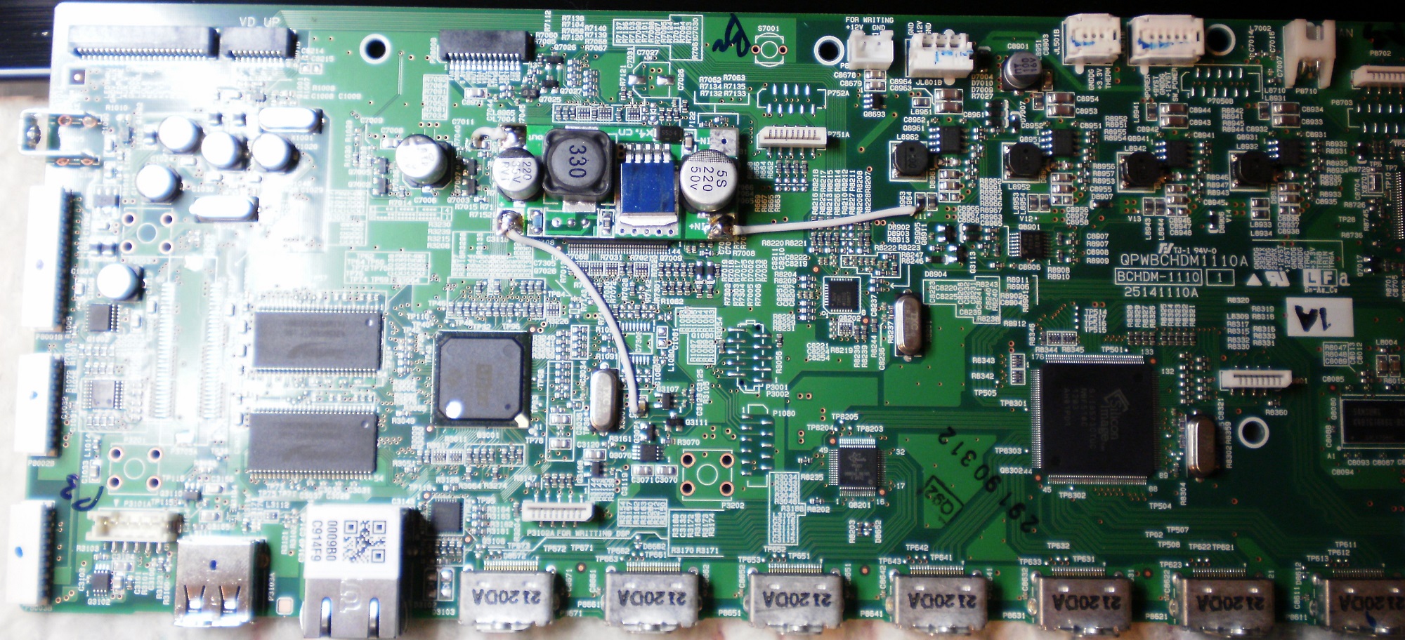

                  I have received the HDMI board today.
                  At first glance, I can notice a mini daughter board installed on top of a processor and two wires soldered to the board.
                  I took some pictures, I will upload them tomorrow and I will compare them with the previous photos, that I have took before I sent it out.
                  The receiver works as it should, awesome service from the Ebay repairman. He is not to far from me, in Garden Grove CA. I have received the board very fast too.

                    Here is the picture.
                    • Alphas
                      • Jun 2014
                      • 3
                      • Earth
                      #70
                      Re: Onkyo TX-NR616 won't stay powered on
                      burnt chips?
                        • 30979
                        #71
                        that small board is an ajustable output voltage regulator from dealextreme.

                                      My understanding is that the TI dsp actually fails, possibly heat related and that it has been superceded by a newer design which may or may not still need the daughterboard. If they are kind enough to return mine I will update.
                                      • tibimakai
                                        • Jan 2012
                                        • 3680
                                        #79
                                        I'm wondering, if the Ebay repairman replaced that dsp, or just added that daughterboard board.
                                          • 30979
                                          #80
                                          you should be able to tell from the soldering.
