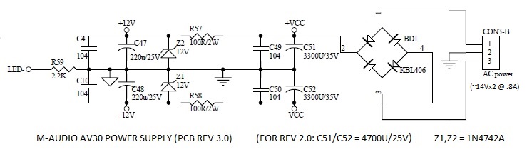

                        Were you successful in your repair? I have the same issue, (C48 & C47 -25v 220uf), (z1 & z2 - ???), (r58 & r 57 -???) (c4 & c10 - 104? with a dot onto of the 0), and (two caps (can't determine pcb #'s) - 35v 4700uf). They all look bad so i figured i would replace them all. I have yet to determine exactly what z1, z2, r57, r58, c4 and c10 are? If i replace all of these will they most likely fail again after awhile?
                        thanks
                        • MarvinPoetry
                          • Jul 2014
                          Re: M-audio AV30 speakers recap and repair
                          The zeners should 15v, I replaced with 1N5352 5W, Originals are 1W. I also replaced the 2 220uf caps, repaired the power connector and installed sockets for the 4558 and TL074 and replaced the ICs. None of this fixed the problem. I read that the 22uf cap, C13 that you can see in the above pic is the issue. I replaced both of those along the edge of the pcb with 10uf and it is working.

                            I bought a dead pair of these for $5 at a Goodwill last week.
                            I cracked mine open and found a Rev 2.0 board where C47 and C48 are domed on top, have blown the plugs out the bottom, burned off their labels, vaporized any through-the-hole plating, and left a charred pit on the bottom of the PCB. One zener diode (which tests open in both directions) and the run around it is as toasted as were the caps. The second zener tests good but also shows signs of abuse.
                            There's plenty of real estate to scrape off some green lacquer and reinstall parts, but... It appears that the power supply section is flawed, and it going up in pyre is a common occurrence.
                            Would any amateur (or pro) designers know what's needed to make the basic power supply circuit in the attached schematic a little more bullet-proof?
                            I've no idea why the only difference in the PS between 2.0 and 3.0 would be changing the main filter caps from 4700mfd/25V to 3300mfd/35V. I suppose the reduced capacitance was just to end up with a 35V replacement cap of approximately the same physical size. But I'd think if they thought it necessary to bump C51 and C52 to 35V, they they'd have done the same for C47 and C48. Could I pitch the zeners and tack on little solid-state regulators?
                            Thank you
                              • 31277
                              i dont know how much current is flowing there,
                              but you could ditch the zeners and the 2w resistors and try a 7812 and a 7912 regulator pair.
                                Is that 14VacRMS from the main transformer? If it is then that would be roughly almost 20Vdc after rectification and smoothing. In such cases, I would recommend smoothing capacitors with 50Vdc rating. Also the bigger the capacitance the better for that smoothing capacitor (usually 4700uF and above). As for that 12V section, I have to agree with stj on using linear voltage regulators such as 7812 and 7912. Otherwise to reduce the stress on that zener diode, you may try putting a series of silicon diodes right before that 100 Ohm resistor to make the voltage drop a bit (each silicon diode usually have around 0.5V forward voltage drop)...
                                • mariushm
                                  • May 2011
                                  • 3799
                                  If the connector says 14v AC @ 0.8A that means there's going to be about 20v after rectification, minus about 1v from the voltage drop on the diodes.
                                  edit: The peak DC can be estimated using the formula Idc = 0.62 x I ac = 0.62 x 0.8A = ~ 0.5 A.
                                  So 19v @ 0.5A... But keep in mind at very low currents the voltage drop on the rectifier diodes will be smaller, and the transformer may output 5-10% more AC voltage, so the DC voltage may reach a peak close to 25v, so it's safer to use 35v rated capacitors.
                                  Let's assume there may be some voltage drop on the transformer at full 0.5A and say 17v DC minimum at any time after rectification.
                                  With 0.5A at the output, normally I'd recommend 1117 regulators with 1-1.1v maximum dropout voltage, but these only support up to 15v at the input.
                                  So you'd have to use 7812 and 7912 or LM317, LM337.. the classics, which have about 2v dropout voltage.
                                  Therefore, if you really want +/-12v in the worst conditions, you want to have at least 14v at the inputs so then you can use the formula to determine capacitance.
                                  C = Current / ( 2 x mains frequency x Vripple) = 0.5A / (2x60Hz x (17v - 14v) ) = 0.5 / 120x3 = 0.5 / 360 = 0.0013888[88] F = ~ 13888uF
                                  So in theory, with minimum 17v DC after rectifier, with a 1500uF capacitor you'd have at any time 14v or more at the input of the regulator, even when 0.5A is pulled through the regulator. Going with higher capacitance, you will just get the minimum DC voltage higher, closer to 17-19v, which in turn will cause more power to be wasted in the regulator and therefore heat it up more, and you'd need a larger heatsink.
                                  The amplifier won't use 12v @ 0.5A constantly, it will only use as much as needed, the average power draw will depend on the volume and how the music is.
                                  But to be on the safe side, I'd still recommend going with a 2200uF capacitor or why not, even 2700-3300uF.
                                  Even if you use a small capacitor, in the worst case scenario (when the volume is pushed very high and power consumption peaks), the input voltage will simply drop a bit below 14v, which means the regulators in turn will output a little bit below 12v. The amplifier chip is designed to work with a wide range of input voltages, so it won't mind a bit less than 12v for a few ms, but you may get a bit of distorted sound. Considering you won't use the speakers at maximum (at least I hope), this won't be a problem.
                                  edit: I initially wrote this post with 0.8A DC current but I forgot to consider the losses in rectifier and smoothing capacitor, so the DC current is actually lower if you use just a rectifier and capacitor to smooth things out. So I rewrote this post with the correct peak DC current.
                                      edit: corrected the post to assume 0.5A peak DC current instead of 0.8A.
                                      Well, here's the datasheet :
                                      On page 2, thermal Resistance, Junction-Air (TO-220) θja : 65C/W above ambient.
                                      At 0.5A, the 1500-2200uF smoothing capacitor will give the regulator a voltage between 14v and 19v, on average let's say 16v.
                                      At 16v in and 12v @ 0.5A out, the regulator will dissipate (16v-12v) x 0.5A = 2w so the regulator will be 25c (ambient) + 2 x 65C = 155 C.
                                      On same page 2, you have the maximum operating temperature of 125C so yeah, you will need a heatsink.
                                      Assuming 30C ambient (because the ambient temperature inside will get warm over time from transformer and other things) and assuming a safe 110C maximum regulator temperature, then you can figure out how big of a heatsink you need:
                                      Tdelta = Tmax - Tambient = 110C - 30C = 80 C
                                      Power dissipated = 2W
                                      Thermal coefficient θ = Tdelta / Power = 80/2w = 40 C/w (which is less than 65C/w so heatsink is required)
                                      Thermal Coefficient Heatsink θhs = θ - θ junction case - θ case-heatsink
                                      θ junction case is in datasheet, 5C/w . θ case-heatsink is the resistance of the thermal paste you put between regulator and heatsink, usually it's about 0.2-0.5C/w)
                                      So θhs = 40 - 5 - 0.5 = 34.5 C/W
                                      So you need a heatsink with a rating of 34.5 C/w or smaller to keep the regulator under 110C when it works at the maximum 0.5A, with minimal airflow going over the heatsink. Ideally, you want to go as low as possible but that means taller or wider or longer fins.
                                      Now you can go on Digikey to find such a TO-220 heatsink, you can simply filter by that θhs column (Thermal Resistance @ Natural in Digikey) and you find heatsinks such as this one:
                                      17c/w : http://www.digikey.com/product-detai...S278-ND/373766
                                      Here's a search result page, with TO-220 (and similar) heatsinks, sorted by price : http://goo.gl/30ivlu
                                      You can look up how much space you have between the regulators (to see if the fins of the heatsink will fit), if you can fit that tall or wide regulator there...
                                      Note that you don't HAVE to fit the regulators on the PCB, the length of the leads isn't really that important in this case, so you could solder some wires and then solder the wires to the regulators and glue the heatsink to the case or screw it to some other place near the power supply.
