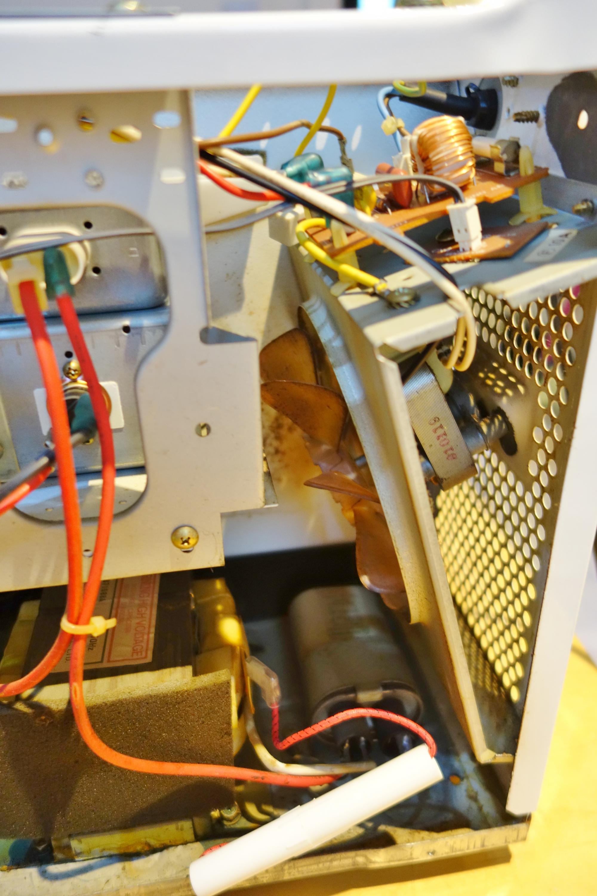

    I recently picked up a used Matsui 175S microwave that was powering up (starts, turntable rotates) but not heating. From looking online the most likely culprit was the fuse, but unfortunately in this one the fuse had heated up and fused with the (badly designed) fuse holder and couldn't be removed. I guess this might indicate further issues beyond the fuse itself but at this stage I just want to replace the fuse and see how I go from there.
    Anyway since I couldn't get out the fuse itself the easiest fix was to replace the fuse holder assembly that runs between the power supply and the main capacitor but in my enthusiasm to get the job done I failed to make a note of exactly what terminal on the capacitor the fuse connected to, and there's two possible places it could've come from. So now I have a replacement fuse assembly but am unsure which of the two spare terminals it connects to. And I don't want to use the trial-and-error approach since this cap is rather large...

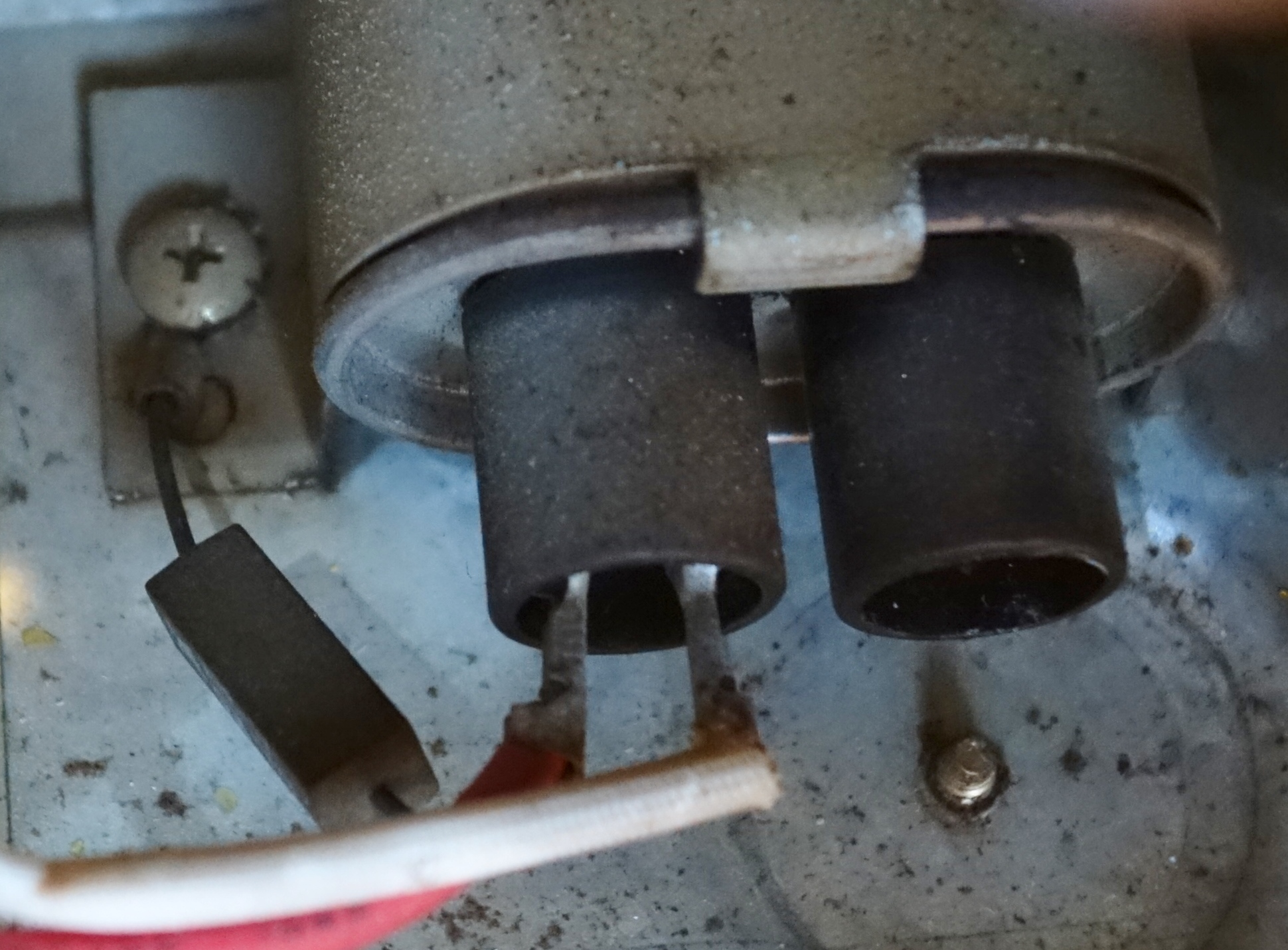

    I've attached a photo of the cap itself (Sang Nong 0.91uF 2100V) showing the two spare terminals; alongside with the schematic that came with the microwave in case it helps. Does anyone with more experience of these types of caps have any thoughts on which one the fuse should connect to? Thanks!

    The red wire with black stripe goes the empty cap terminal, the other end of that red wire with black stripe goes to the fuse holder as shown in the schematic, the cap is non- polarized.
    Can we see the pictures of the fuse holder? Did you check the rectifier diode that is connected to the other capacitor terminal?
    BTW, make sure to discharge that high Voltage cap even though it has builtt-in bleeder resistor. You also need to check all the door switch/safety door lock switches to make sure they are still goes open circuit and close circuit when actuated/de-actuated.

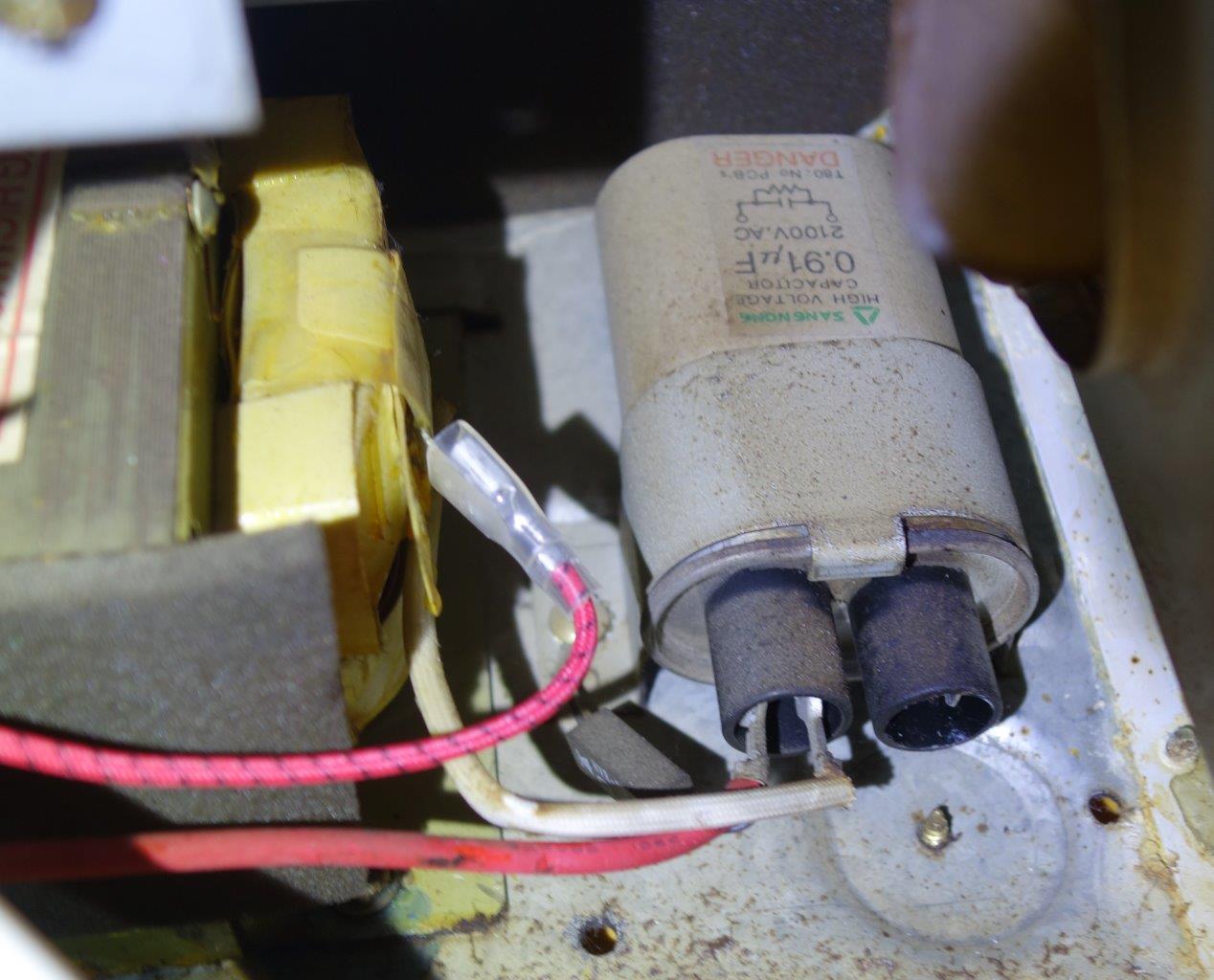

      Thanks Your response confused me a bit at first but I went back and looked at the capacitor again and I think I was misunderstanding what I was looking at before. Each side of the capacitor has two "prongs" on it - for want of a better word - that can hold separate connectors - but it's just the same terminal so it doesn't really matter which of the two available prongs you attach the fuse holder to, am I making sense? I've attached another photo from a different angle as I realise the one before doesn't show what I'm talking about very clearly.
      I haven't actually discharged the cap manually as it's been switched off and unplugged for a week now and I'm assuming that it should have lost all of its charge in the meantime. (Also I don't really have the proper tool for discharging it.)
      I can see the diode you're referring to but I'm not really sure how to test it to be honest.

        It looks wired wrong to me, the diode connects after the capacitor - not to the transformer.
        So I would move the red wire over and I'm not sure what the red/blk stripe wire goes to. It looks low voltage.

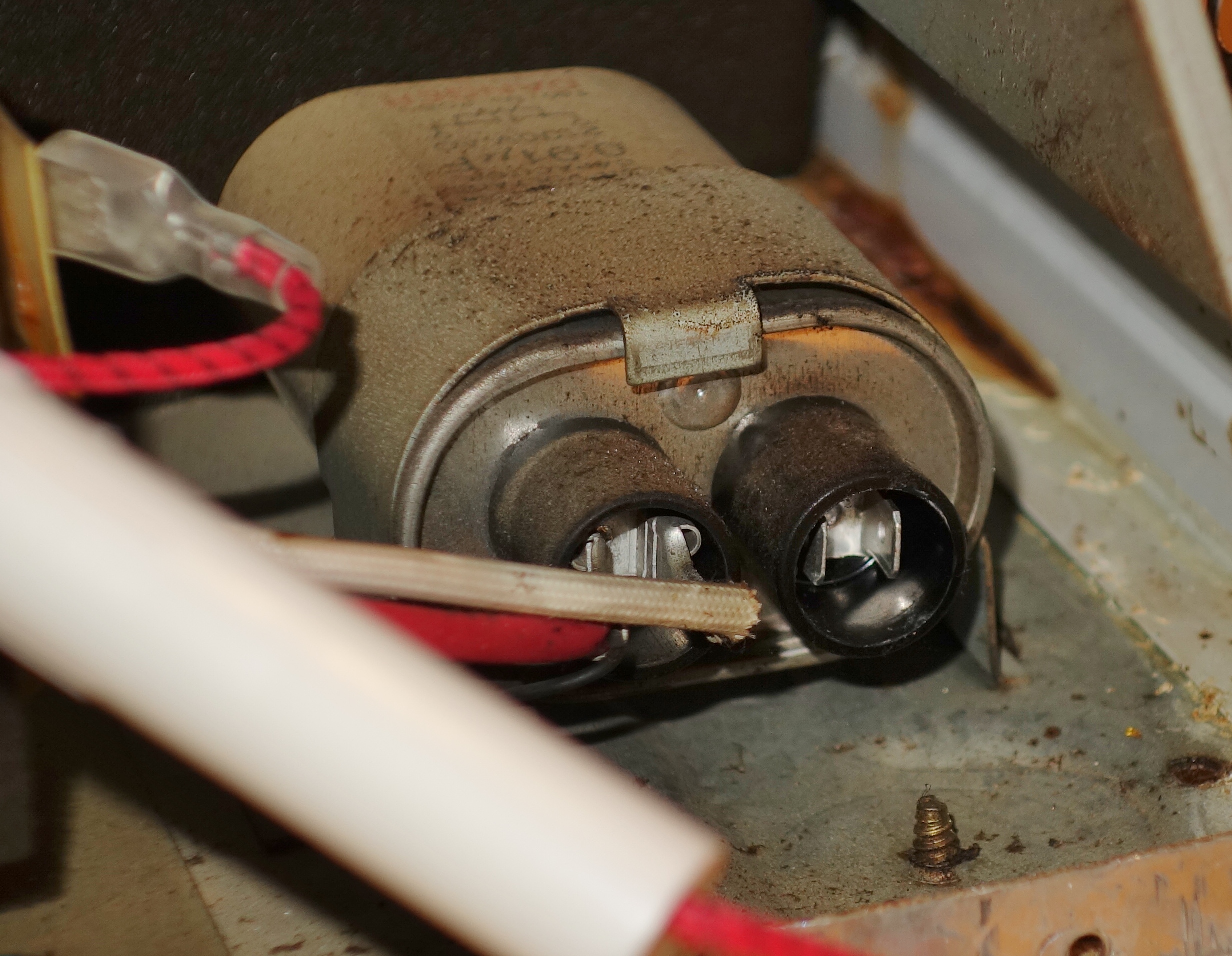

          The diode is connected to the cap itself, not the transformer. I've added another photo that shows it better. I'm not messing with what's already there; I've no reason to believe that there were any existing wrong connections when I got it. The red / black wire is the replacement fuse holder that I was asking about originally; although I think I've now concluded that as long as it goes on the right side of the cap it doesn't matter much how you connect it.

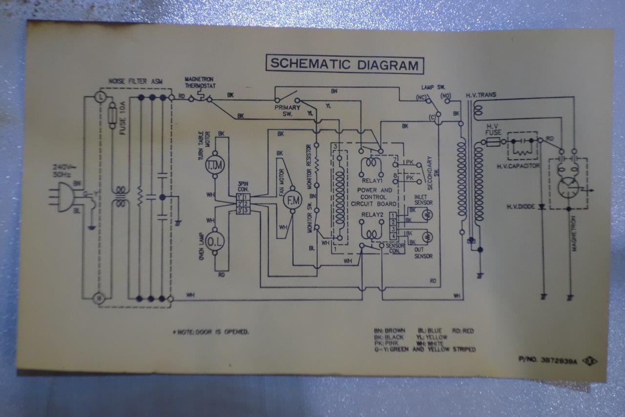

                  OK I've attached a picture to show more, but just to spell it out the connections on the cap are as follows (when I say "left" I mean my left as I look at it):
                  Left hand terminal of cap:
                  - black lead to diode, red lead to magnetron (these two share the same connector)
                  - white lead to transformer.
                  Right hand terminal of cap:
                  - red-with-black-stripes lead to fuse holder.
                  But as I said originally my query was only about the fuse holder, which I unplugged from the right side of the cap without making a note of which of the two connectors it was plugged into. I haven't done anything to the ones on the left, so they must be right unless someone has taken it apart and played with it previously (but that seems unlikely, most people would steer well clear of microwaves; probably I should too but I've started trying to fix this now so aim to get it working...)
                  Also to be clear the fuse I'm referring to is the thermal fuse, there's no issue with the main fuse on the power board because - as you say - the microwaves powers on (clock, timer etc) when switched on.

                      The schematic does show the red wire connections, the white is the filament winding. So the transformer and HV fuse do connect to the cap right terminal like you've got it.
                      Are you going to test the diode and capacitor? You can also check for shorted magnetron.
                      A microwave oven diode has about a 10V drop, so they will not read using a multimeter's diode test function (unless the diode is shorted). These are just basics to save money blowing more HV fuses. The fan looks crooked.
