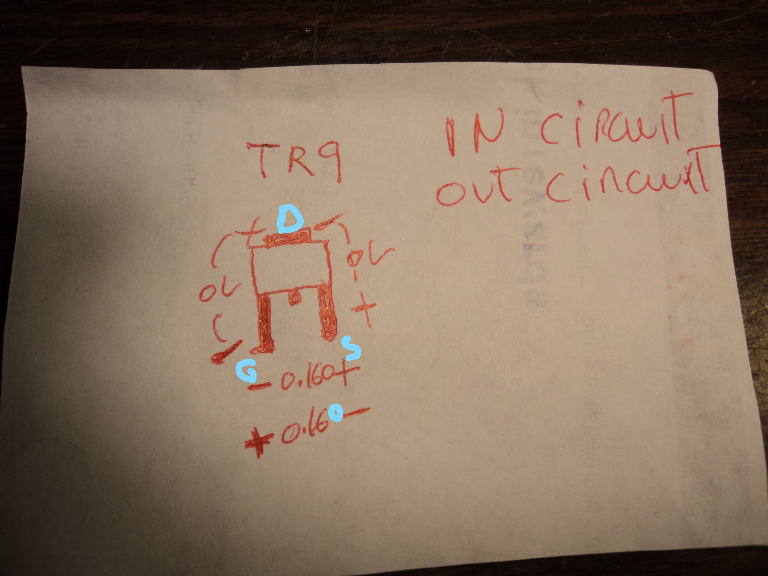

    TR9 dont look good

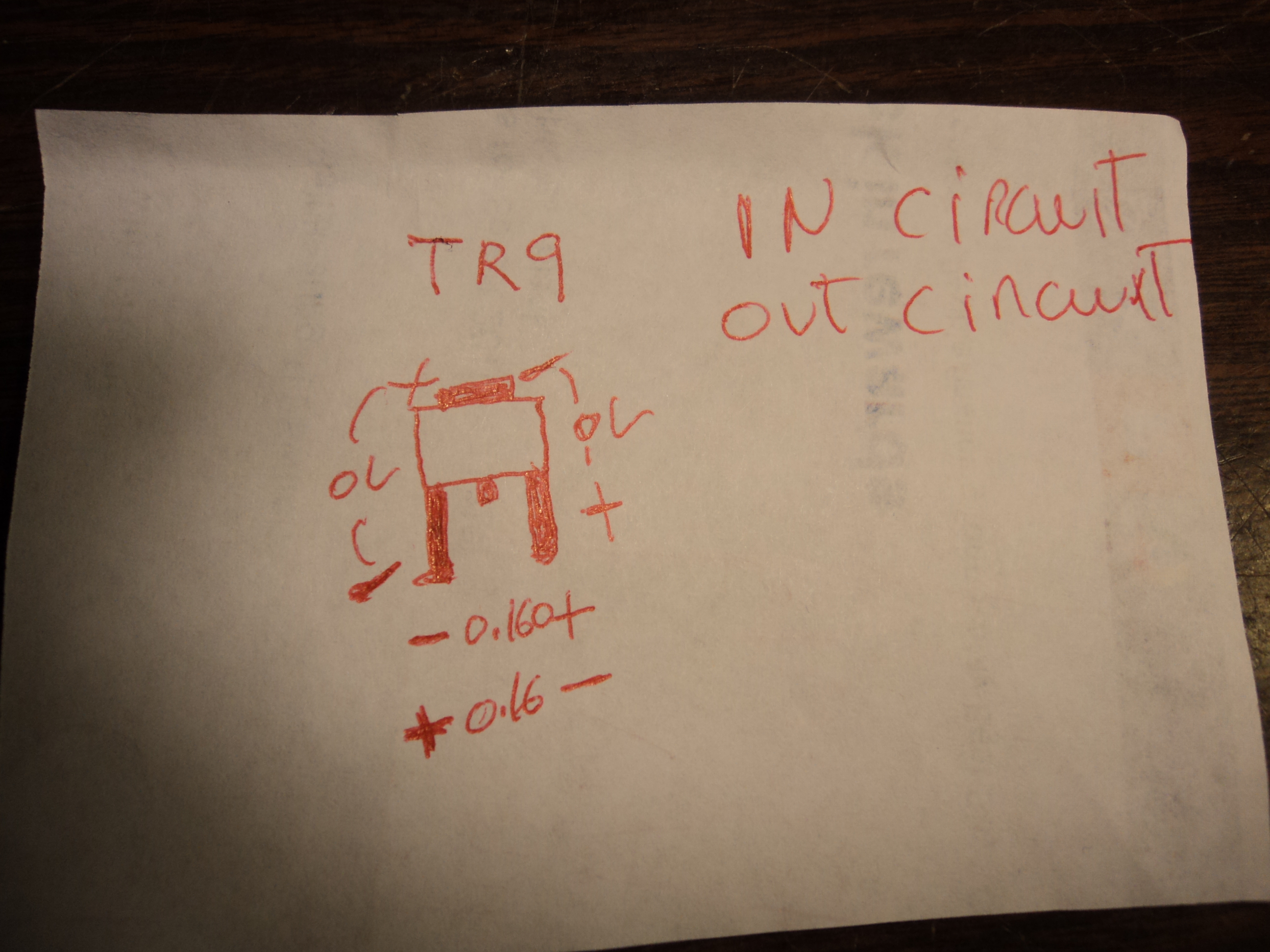

    THanks guys; machine is not mine ,it's a familiar and they told me it was washing and went dead and there was water licking in the water input hose where it enter the hot water pump,i they called me and went there to tight the hose and then went to turn on machine then i found out it was dead i guess in the middle of washing it had water in the tank,i also suspect TR9 , the issue it has no marks of part # on the top,i think this is a N_mosfet ,you think this or similar will do?
    i tested TR9 in and out of circuit with fluke 87 on Diode mode and G to source it, 0.160 either sise

          TR9 dont look good
          Covered in lacquer- they all look like that to some degree.
          TR9 is a triac, hence the "TR" designator. Your readings indicate it's good.
          You were checking gate to one of MT terminals.
          Do not sub with a MOSFET- you'll blow the board up!
          TR9 switches the drain pump. Has nothing to do with the SMPS.

                At this point, I'd solder long-ish jumpers onto C70/71 and observe with a voltmeter. Should be rectified line voltage, 160-170V.
                Also jumpers onto that small cap, 22-100u/16v (I replace with 68-100u/16v), looking for 12v.
                And jumpers on C75, looking for 5v.
                Note I did not indicate polarity WRT common; the outputs are stacked and are referenced to neutral in such a way as to easily directly drive the triacs. Best to measure across each cap individually if you're unfamiliar.
                We're interested in voltages across certain capacitors...

                          hi it's me again i was able to scrape wax off Tr9 and got some info; AGTT4(S) or (5) in the middle 800 (A) or other maybe Amps,then PjM1747c4, it could be a triac,not sure and can be good! no info about it on the web,
                          https://www.digikey.com/products/en/...cs/300?k=triac
