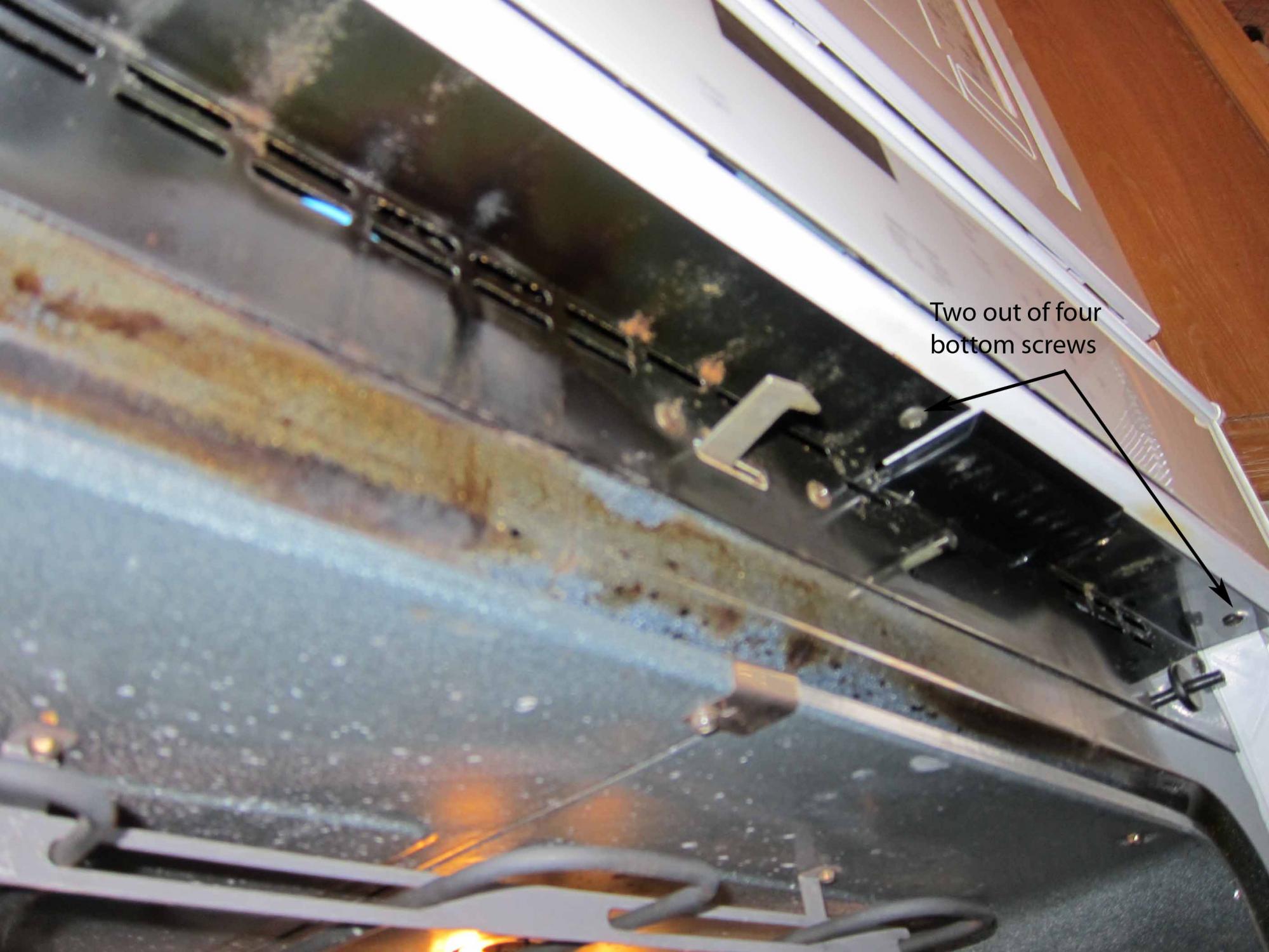

                      Hello bluto,
                      Thank you post for your post. My Jennair Expressions wall oven (model W30400-C) looks exactly like the one you have posted in the photos. The clock display had dimmed and now it's totally blank.
                      I would like to try replacing the capacitors, would really appreciate if you could answer a few questions I have:
                      1. How can I remove the control panel that contains the display? I see 3 white phillips screws on the top panel and 3 black ones at the bottom. Shall I remove al of them?
                      2. How will I remove capacitors? the Are they just plugged in or soldered on the circuit board?
                      Thank you very much!

                            • bluto
                              • Oct 2007
                              • 560
                              #34
                              Re: Dim Clock LCD on Jenn-Air wall oven
                              On my oven there are three white screws on top and three black screws on the bottom holding the control panel on. Post some pictures once you get it out.

                                    • webtalk
                                      • Dec 2010
                                      • 5
                                      #38
                                      Well, I did it! and the clock now works.
                                      Thanks for the help and the info I found on this thread, I ordered the parts online and they arrived in one day (yes I ordered replacement parts for the other caps but only installed C3).
                                      I have posted photos detailing all the steps, but anyone who stumbles on to this thread can feel free to ask questions. For example, I wasn't sure how to remove the wide ribbon cable. Then I remembered, when I had recently fixed my son's Ps3, you just press on the two protrusions on the edges of the plug and the ribbon just slides out.
                                      Removing the old solder took a while. I melted the old solder with the soldering iron then pried out the cap wire using a thin flat screwdriver. Not sure it this process might damage the circuit board but what did I have to lose, since if I was not successful I would have to buy a new module anyways (it's $250 plus 13%tax Cad here in Canada from a local jennair parts dealer).
                                      Anyways, good luck to those who may wish to try this out, but proceed at your own risk.
                                      Cheers.
