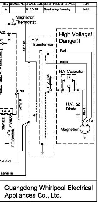

    Hi guys, hope someone an give me a little help here. I bought a broken microwave with the intention of fixing it. The output to the HV circuit is working and after some investigation I found a HV fuse that had blown that was in a plastic carrier under the fan. Anyway I decided to order a new fuse and diode which is strapped across the case and the 2300v cap. Before I replaced these items the microwave hummed normally and it appears to work but there was no heat. Since replacing the fuse - i think the diode was OK - it now make a very loud buzzing noise when on and still no heat. I have tested the Magnatron and it tests as it should with a DMM. I have tested the Cap and it also tests as it should with the modest Cap test on my DMM. It also has no short to case and the discharge resistor is also testing out as good at 10MOhm. In short I now don't know which component Transformer, Magnatron or Cap could be bad. Any help appreciated. I have a Multi Function 1000v tester at hand could I use this to test the components further for breakdown under high voltage?

    Can you give us a make and model number, that helps for the schematic.

      Hi, Thanks for the reply. its a whirlpool jq280 which is not common here in the UK but I do have this link https://www.manualslib.com/manual/98...?page=5#manual
      I agree about replacing parts but I did the diode as its was cheap and as you say something difficult to test with a DMM. I do think the old one was probably good though looking at the DMM readings.
      The diode has crimped on tags that are different so its defo in correctly. I haven't yet removed the magatron so maybe thats the next step to see if there is any sign of arcing?

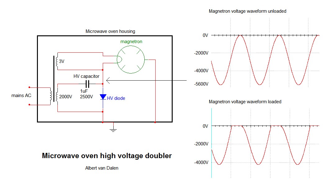

                    I would say that's not right because the circuit is a half-wave voltage doubler and it does not output pure DC.
                    If you use a scope and HV probe, you will see 1/2 wave pulsating DC from +11V to -4,000V. If the magnetron is open-circuit, the no-load voltages go much higher than (loaded) 2kV out of the transformer. The portion of the sine-wave where the cap is charged is also not seen then.
                    Really good information for microwave oven repair is here: https://repairfaq.org/sam/micfaq.htm#mictstmag
                    snippet from Testing the Magnetron:
                    A magnetron with an open filament will result in no heat but no other symptoms. The bad connection may be internal (in which case the magnetron will need to be replaced) or external at the filament terminals (which may be repairable).
                    A magnetron with with a short between the filament/cathode and anode will likely result in a loud hum from the HV transformer and/or magnetron when the cook cycle is initiated but the main fuse will probably not blow. However, note that the actual wattage drawn from the power line will probably be much lower than under normal conditions. Although there will be a high current flowing in the HV transformer secondary through the HV capacitor (likely causing a loud hum or buzz), the real power consumed will be reduced since the current and voltage will be out of phase (due to the series capacitor) and the power factor will be low. A reading on an AC line wattmeter of 300 W compared to the normal 1,200 to 1,500 W would be reasonable.
