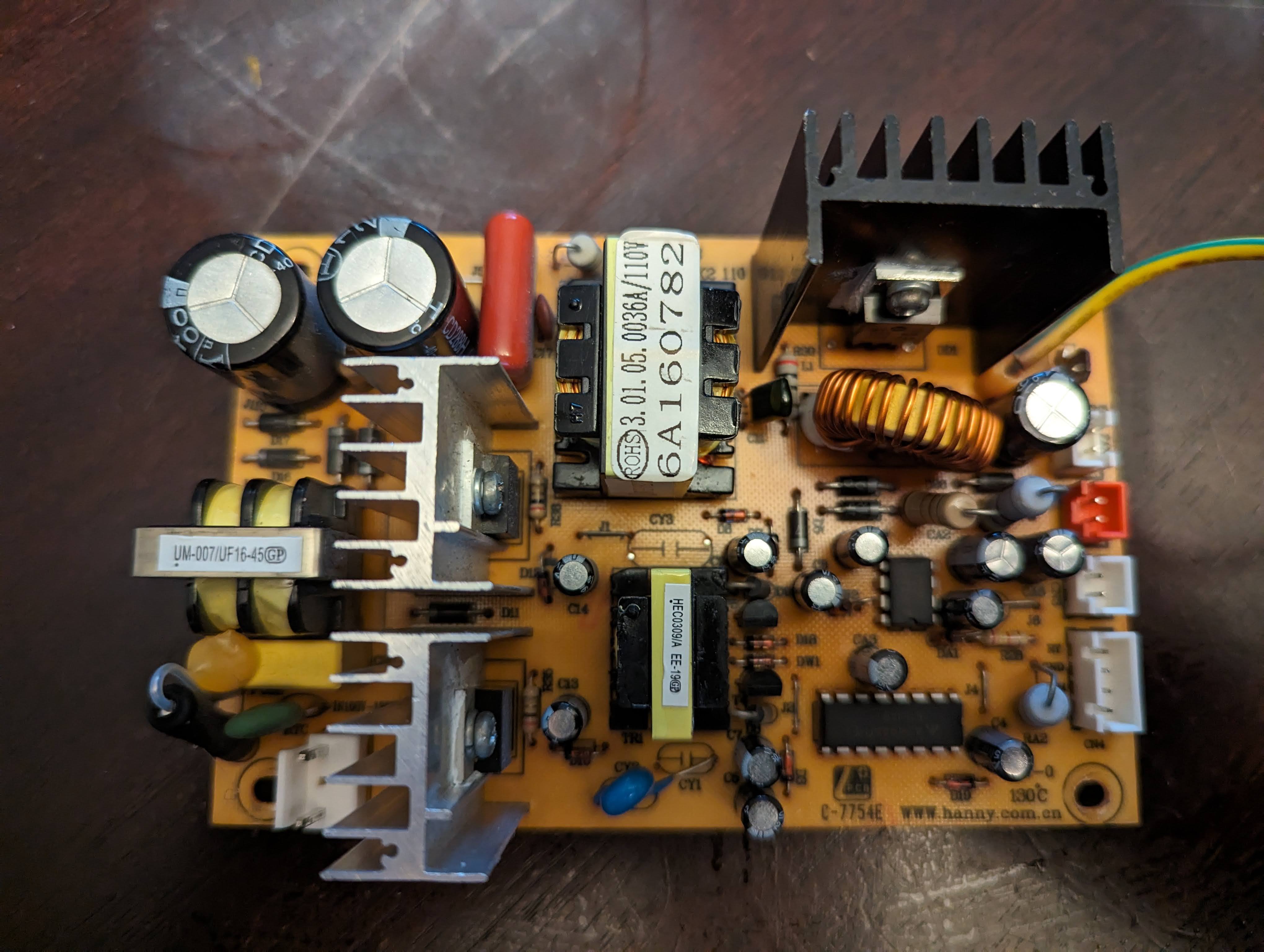

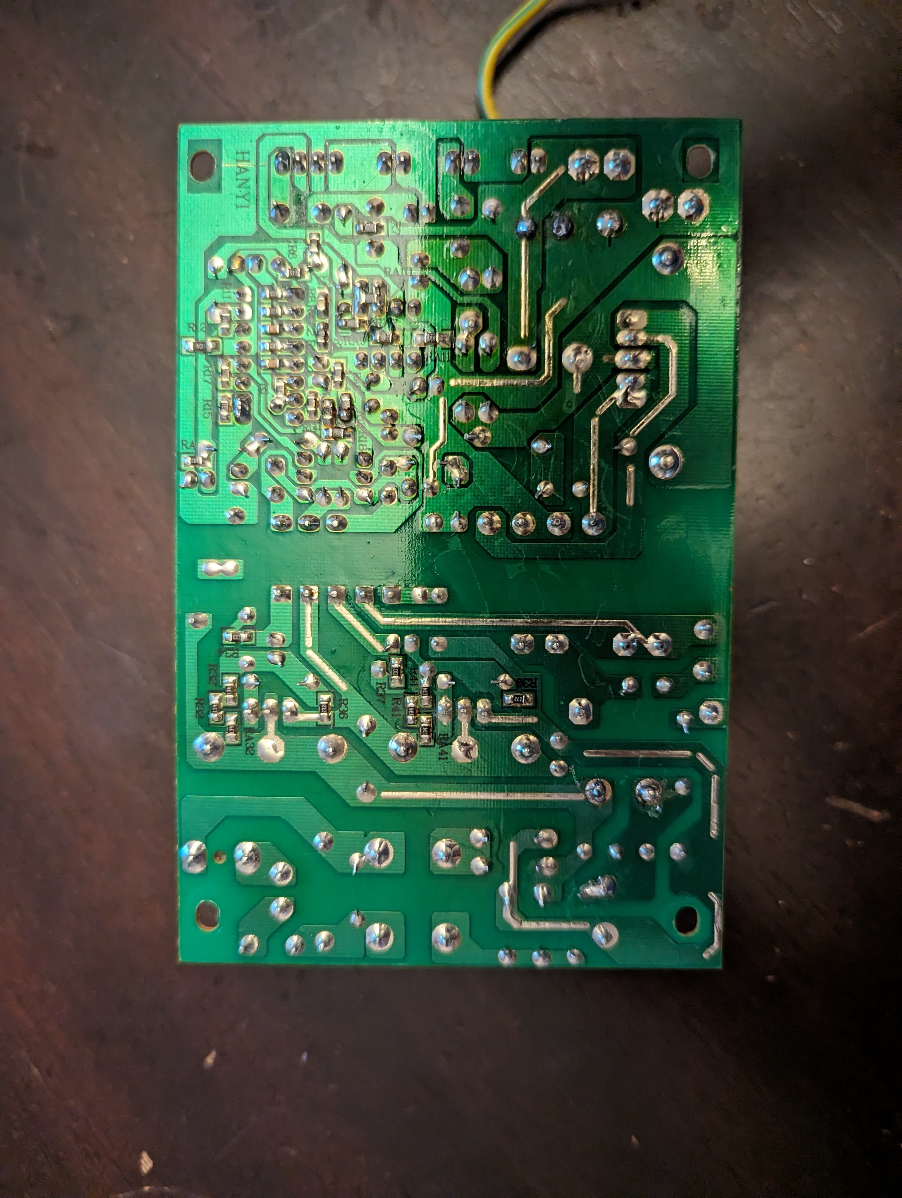

    Anyone have an experience with this board? Ive actaully replaced 2 caps on it before. Worked for a few years. However this time around they all seem good. Ive pulled a few and tested they all test in range. Checked a few of the diodes they all seem good. dont see any popped resistors or anything. The light and screen power on however the fans never kick on. Havent found a skematic for this board however my guess would be a component in line with the fan.
    Click image for larger version  Name:	1.jpg Views:	0 Size:	111.8 KB ID:	3292895
    Click image for larger version  Name:	2.jpg Views:	0 Size:	50.1 KB ID:	3292896
    Click image for larger version  Name:	3.jpg Views:	0 Size:	78.7 KB ID:	3292897

    I would put the board in and heat it up a little with a hair dryer and see if it works again.
    Unfortunately it is impossible to read anything at all from these low res pics. Take some straight shot high resolution pictures from top and bottom an upload them using the attachment function.

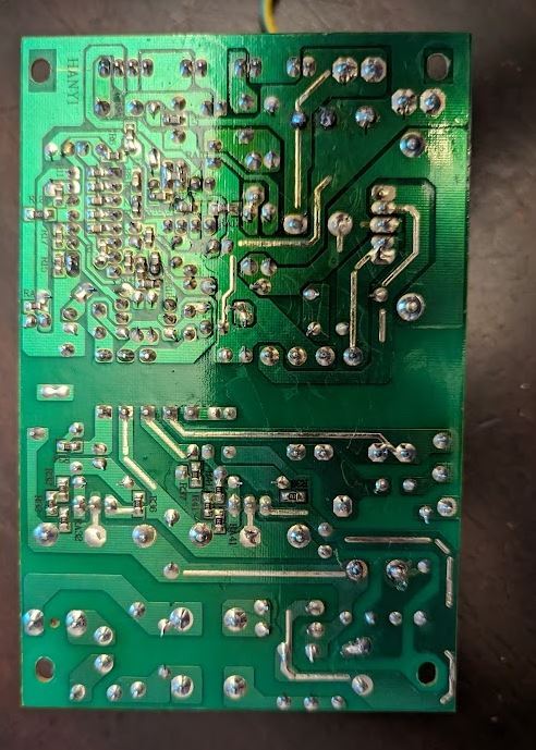

        Full size pics attached.
        Yes it displays the correct temp. The unit has a top and bottom with the same control board. I swapped the boards and everything works as expected. So i know for sure its a component on this board.

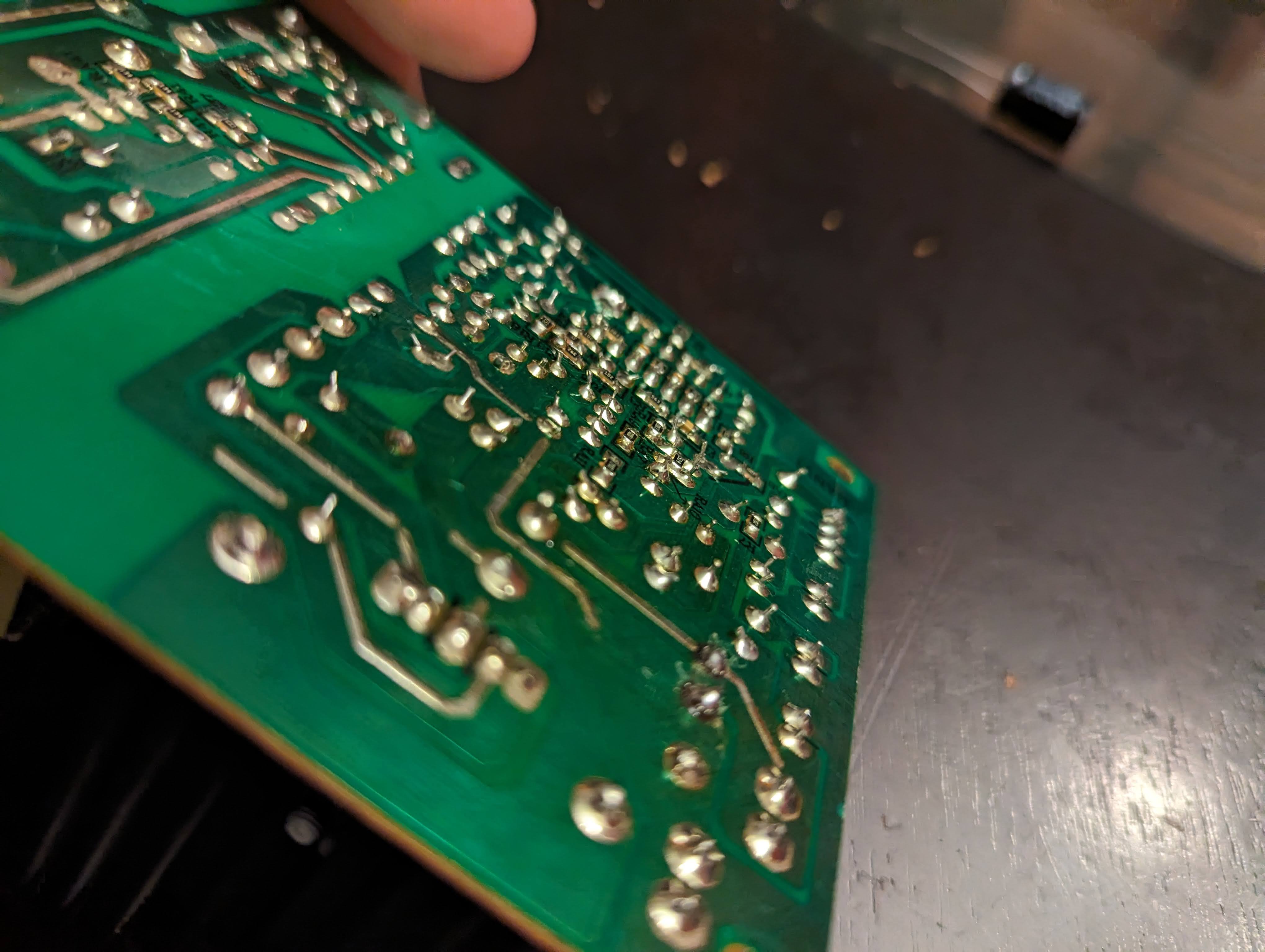

            I see some rings, pad lift and a couple of bad looking solder joints?

              Just not powering the fans it seems. Lights and temp lcd come on

                  Yes. Rings on solder joints. May indicate bad solder joints too
                  Where does the fan hook up to? Maybe take a resistance measurement where the fan hooks up between both boards.

                    Fan connect into the top right plugs the red an white 2 pin

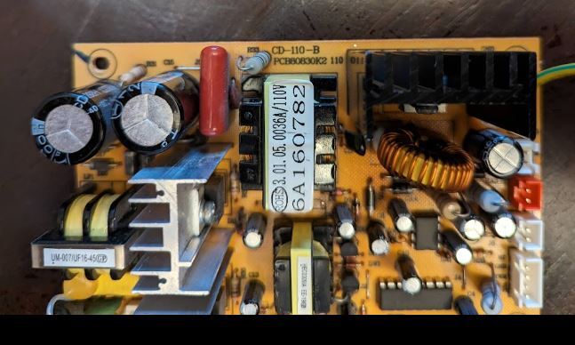

                        could you redo the pics and focus on the bottom of the board instead on the transformers. There area we are looking at is like totally blurred out on the edge.
                        Where the red plug is, there is a 5w gray looking resistor with blackend legs. Looks like it got really hot? What about that bigger capacitor next to it?

                          Which connector goes to the fan(s)? They all seem to be just a fan on/off transistor based on doorswitch or maybe temperature.
                          Other wine cooler repair thread here with Hanny controller boards. Many capacitors fail on these boards and you've only replaced two, big spender lol.

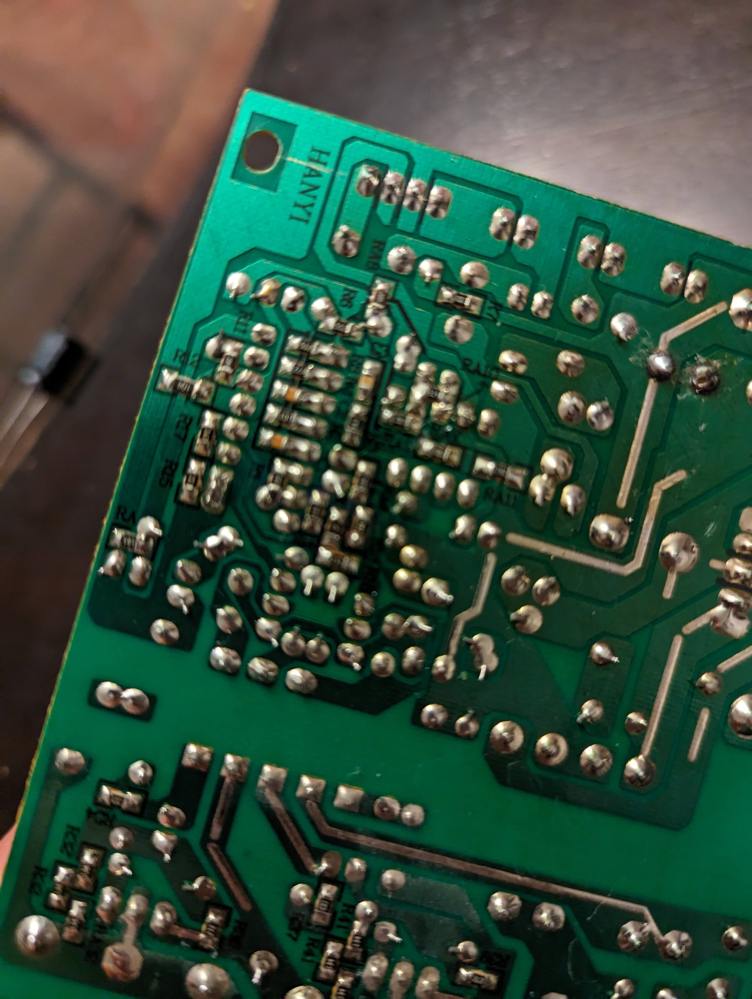

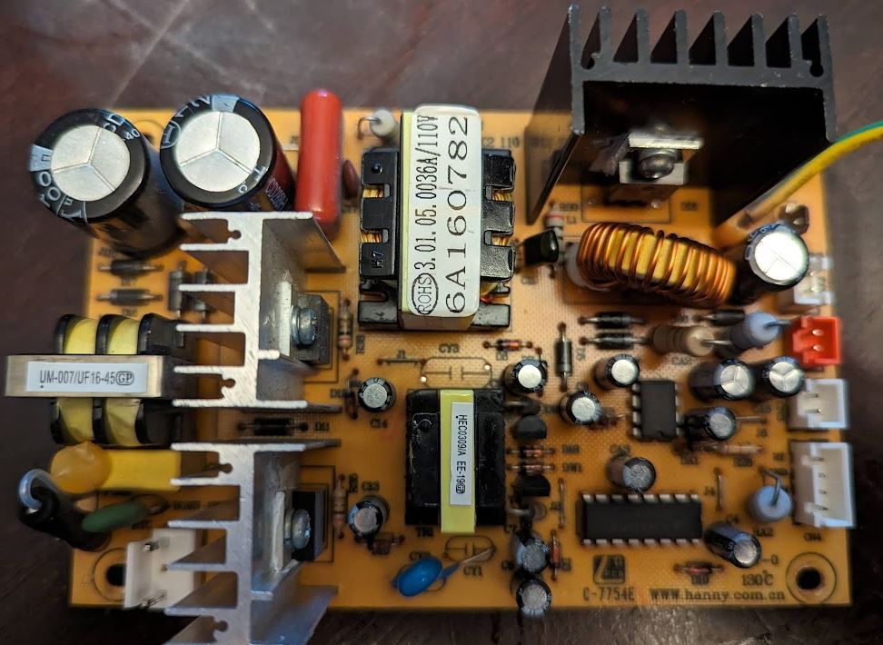

                            Yea that ring was me just doing a quick resoder to get it back on after testing. Ill fix it up more later.
                            Too more pictures, It doesnt look burn in person its more of a shaddow in the pictures I think. Hence the angles

                                        The red connector seems to just go to a power resistor and then the 12V rail. The fan is always on?
