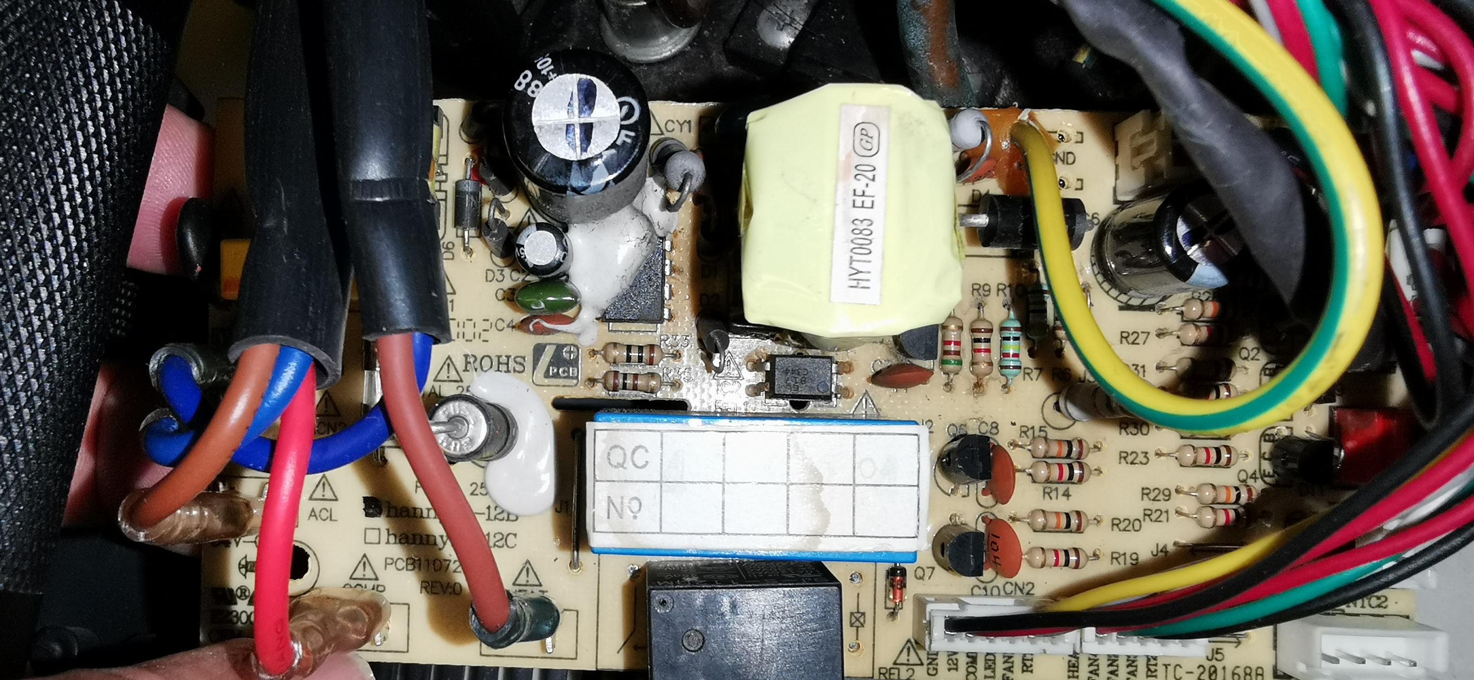

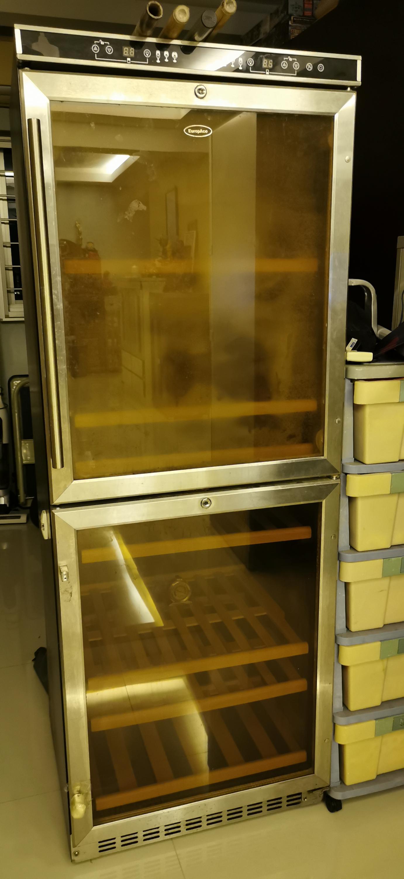

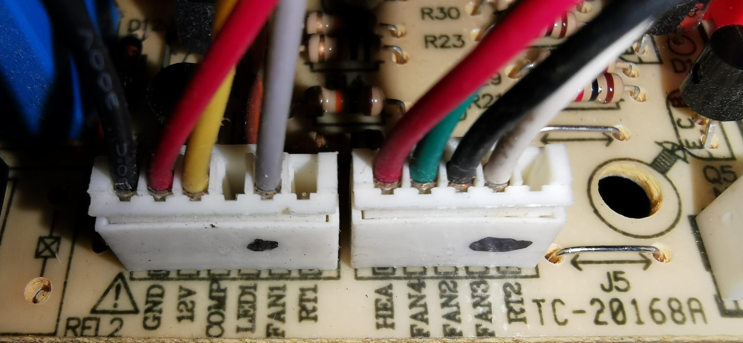

    Received this dual doors dual temperature control wine chiller with some unusual issues:
    1) On powered up, all the electronics seemed to be working properly - lights, temperature settings, current temperature, etc, all displayed correctly. But sometimes both zones will get chilled, sometimes upper zone only, and sometimes lower zone only. The temperature displays will show the correct temperature as it chilled (I placed a stand-alone thermometer inside and they compared correctly)
    2) However, the chilling does not stop at the set temperature.
    3) When both zones are chilling, there is a periodic click-on-click-off sound at every 10-20sec intervals, suspect from the solenoid.
    4) If only a single is chilling, there is no such click-on-click-off sound.

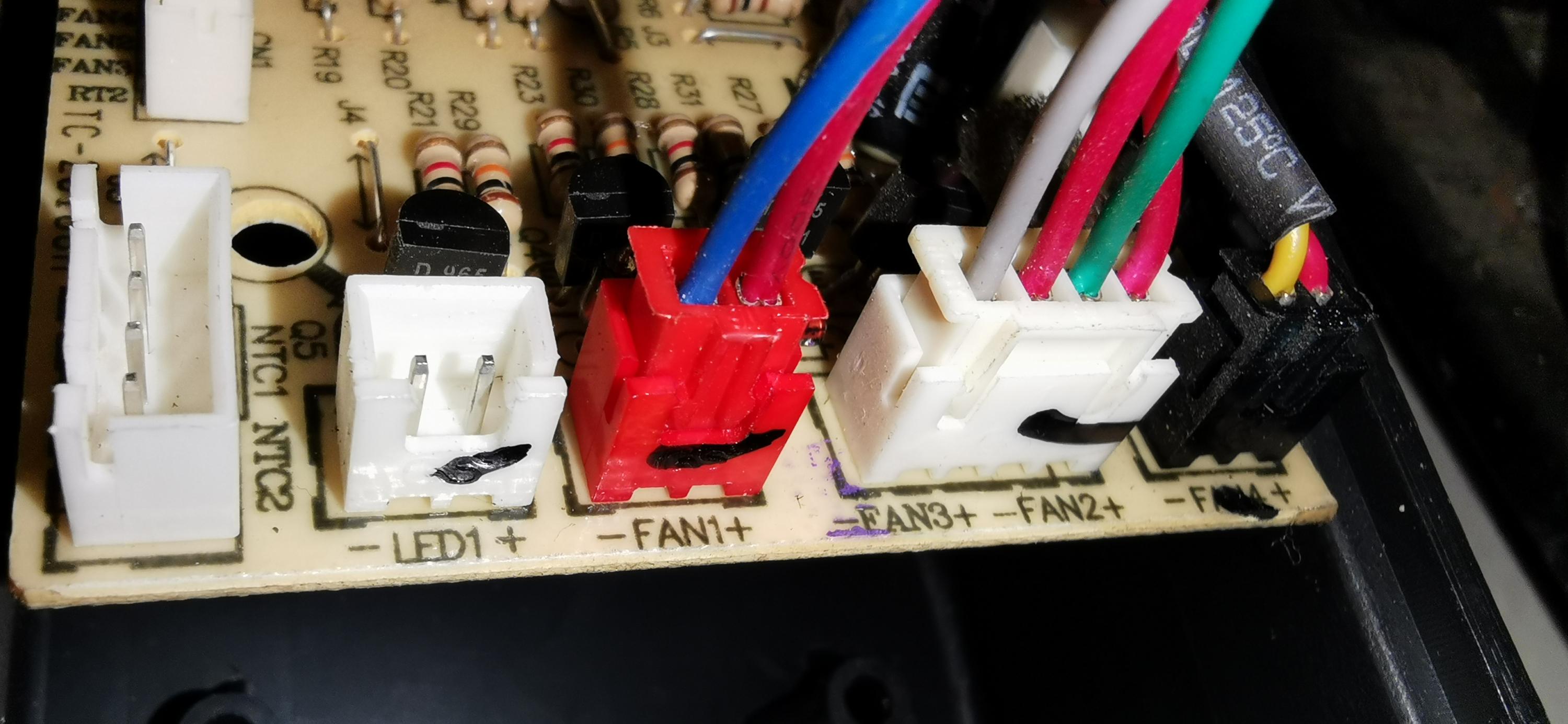

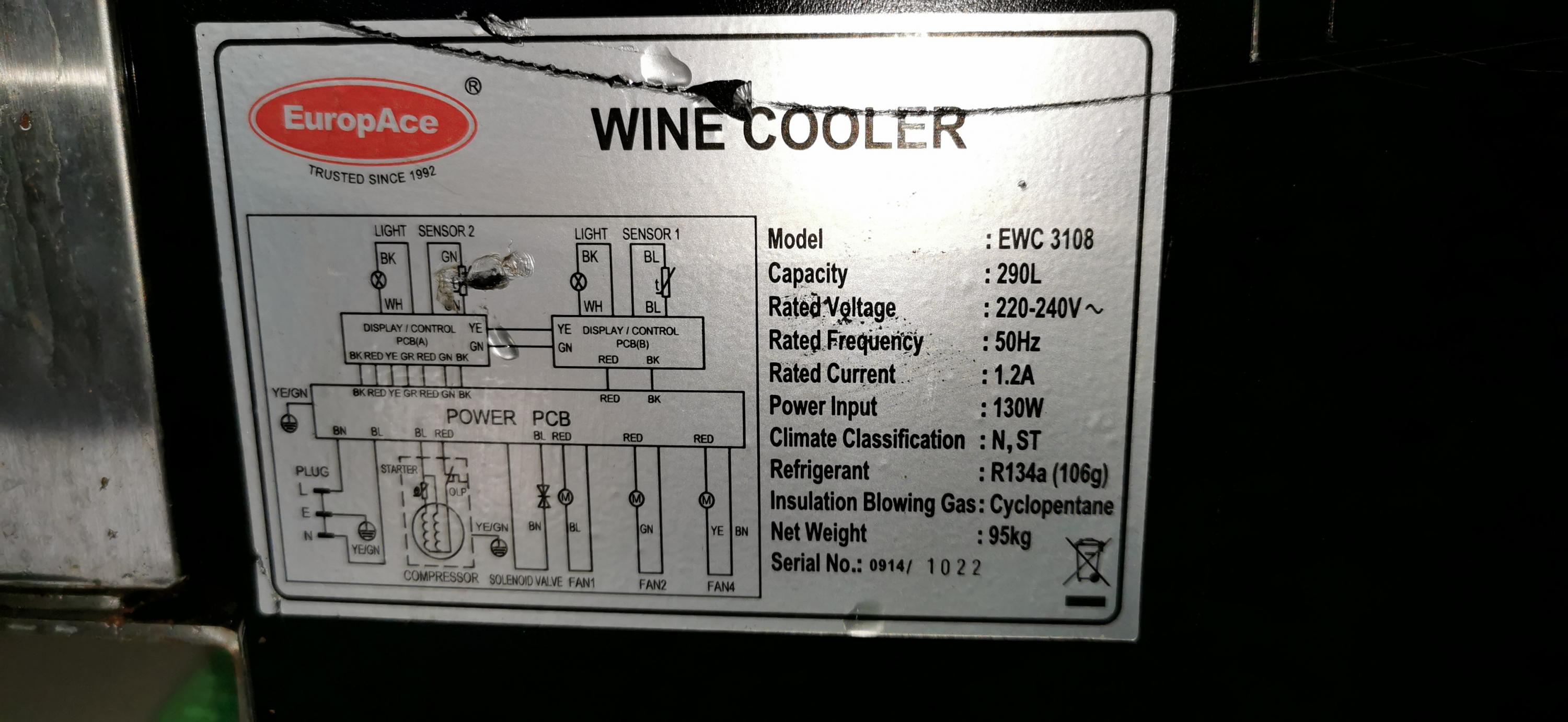

    I did some googling and found this youtube that appears to be the same controller: https://www.youtube.com/watch?v=7zxgGCip8ms
    But compared to the PCB i have, it seems to be missing the wires connection for NTC1 & NTC2 connector (presumably the temperature sensors for the respective zones).
    Is this the root cause of these inconsistent and unexpected behavior?

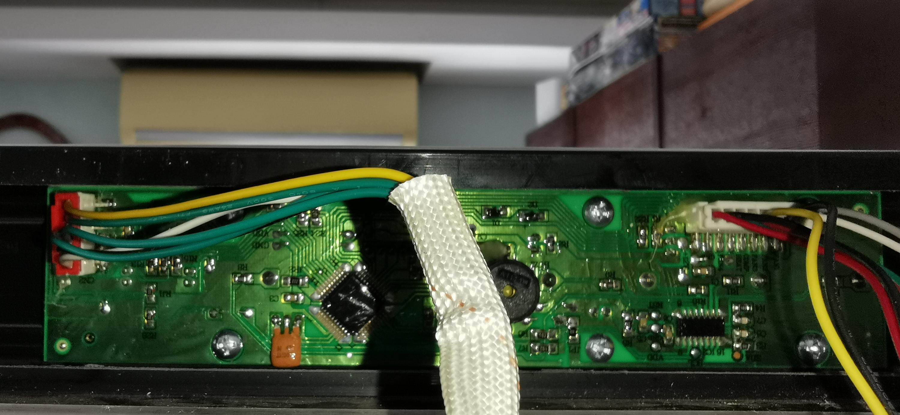

    I investigated further:

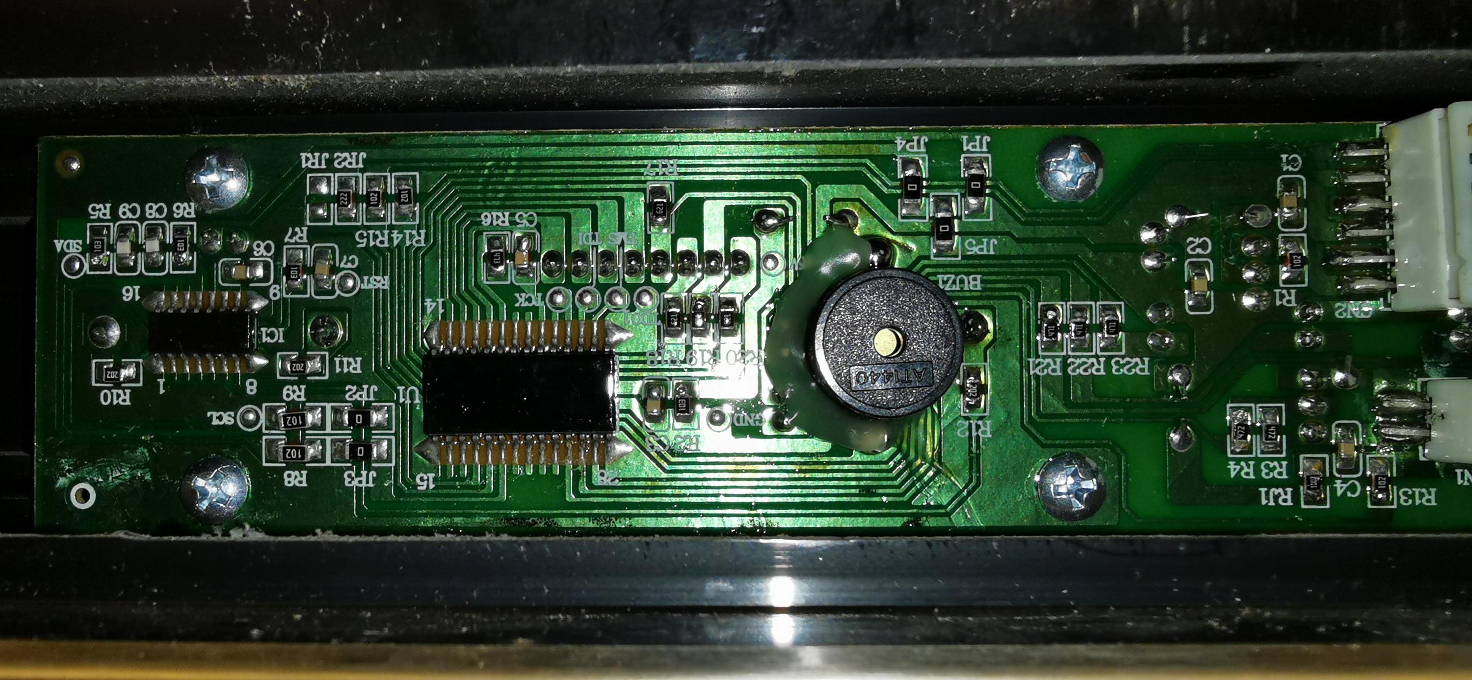

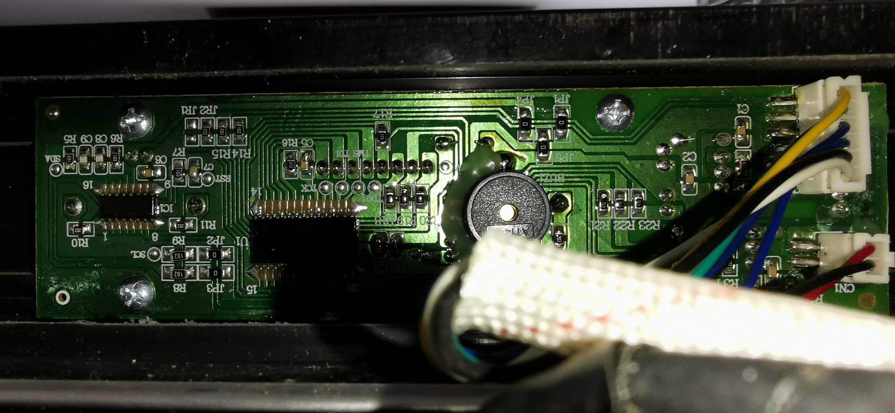

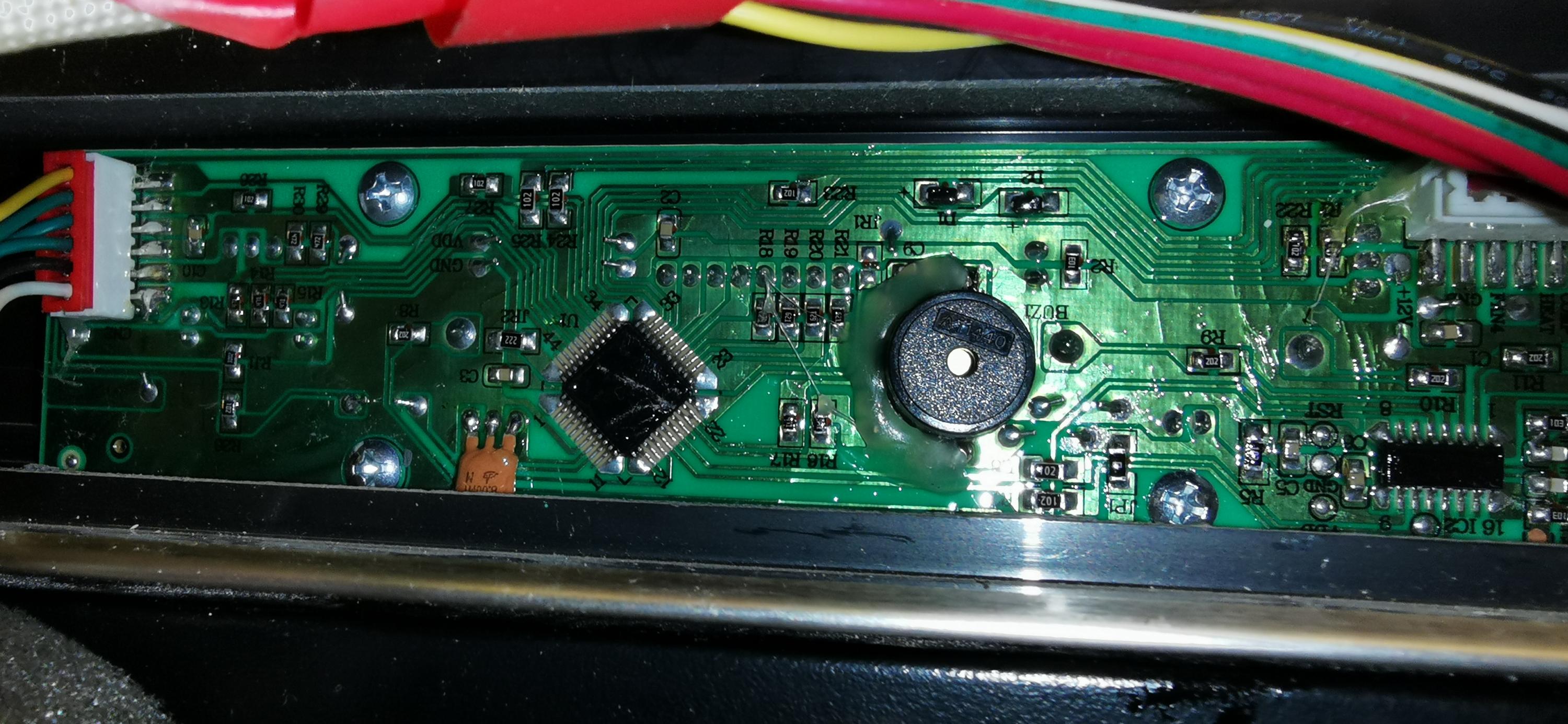

    1) There are 2 display/control PCBs, one for each zone. Checked all the power and signal wires connecting to the main PCB, nothing opened or disconnected.
    2) There is a "COMP" signal from one of these display/control PCB to the main PCB, presumably is to "turn-on/off" the the compressor.
    This might be the reason that NTC1 & NTC2 connector is not use, and temperature control is within the display/control PCB for the respective zone.
    If so, the questions would be:
    1) What's causing it to chill randomly the top, bottom, or both zones?
    2) What's causing it to chill past the set temperature?

          Ok if this is the case look for a optic sensor on the controller board and and check if the sensor is working correctly or not
          You might find the optic sensor near the microcontroller ic chip

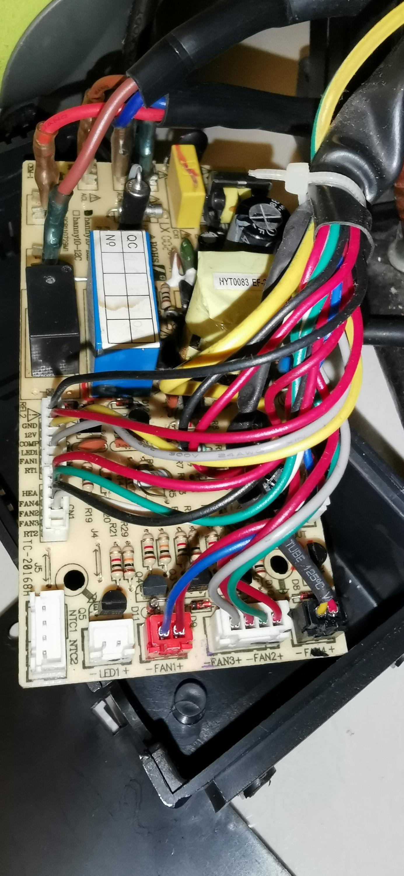

            I do not know what a optic sensor looks like.. what does it do and how to test it?
            I attached all the 3 PCBs, please point it out if you see it, thank you.

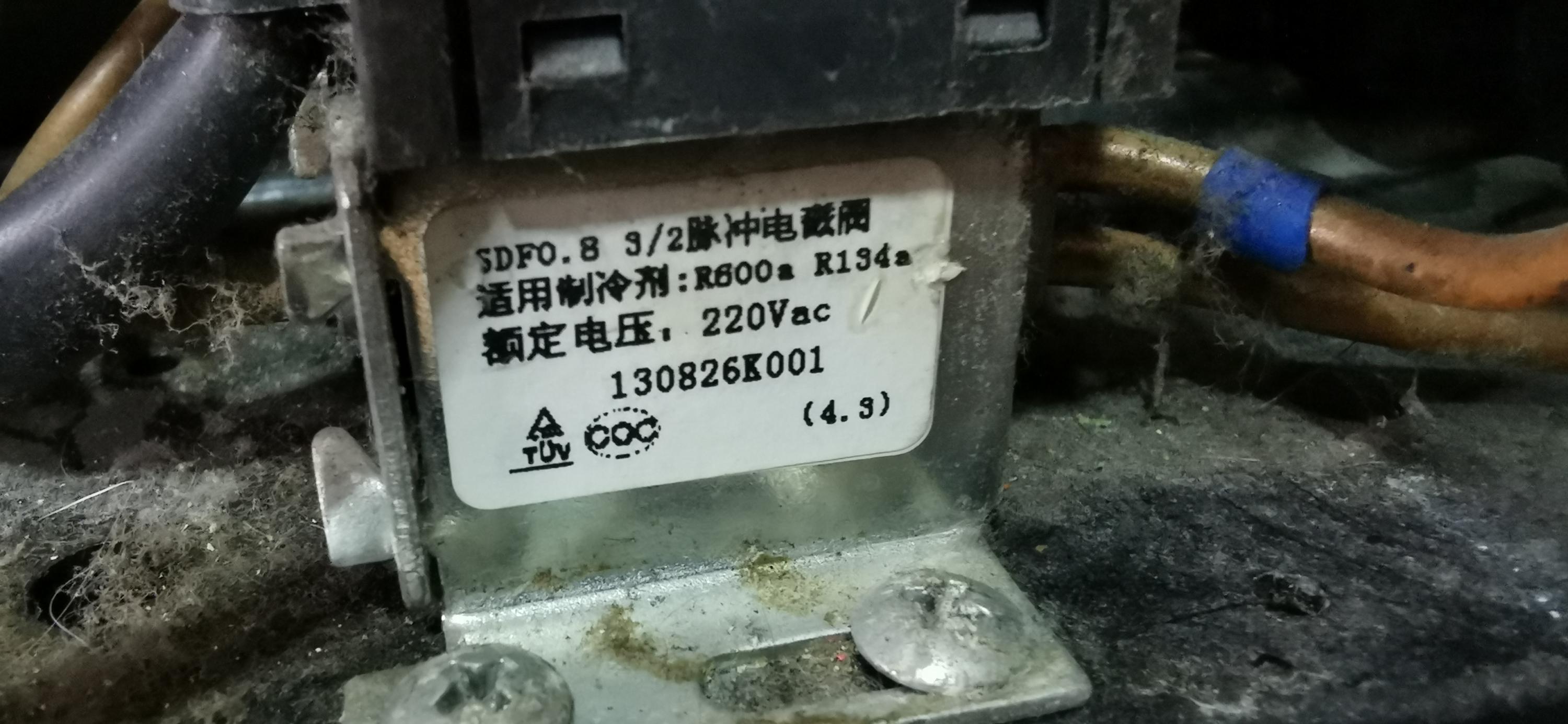

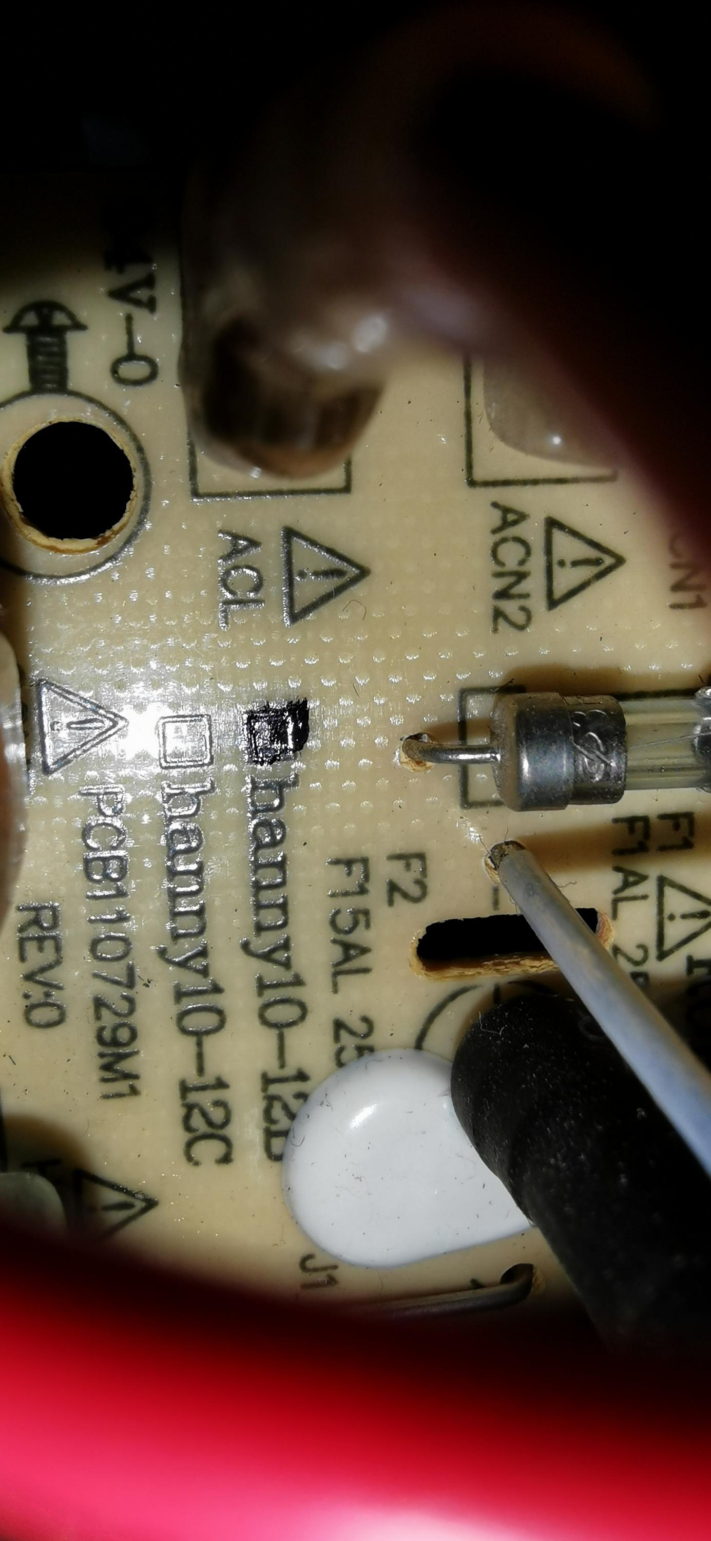

              I did some data collection on powering on, and observed that 8 out of 10 times, only the bottom compartment get chilled (non-stop to below zero). Once or twice the top compartment get chilled. And when it did chilled both top and bottom, the top compartment chilling stopped after a short while, dropping a few degC, while to the bottom compartment continue to chill to below zero..
              I was suspicious of the solenoid valve, and took the voltage reading of it at the main PCB - it only read 45Vac while the rating of the solenoid is 220Vac.
              Does this means the solenoid is not being power up?
                • Jul 2011
                • 6070
                Re: EuropAce EWC 3108 Wine Chiller - Seems like no temperature sensor input
                Well this is your problem alright here if the solenoid valve is only getting 45 vac and it says it needs 220 vac that explains a lot why sometimes it would work and sometimes it would not work
                Yes - > but now the question is why is this happening how is this solenoid powered from a triac or mosfet or something similar

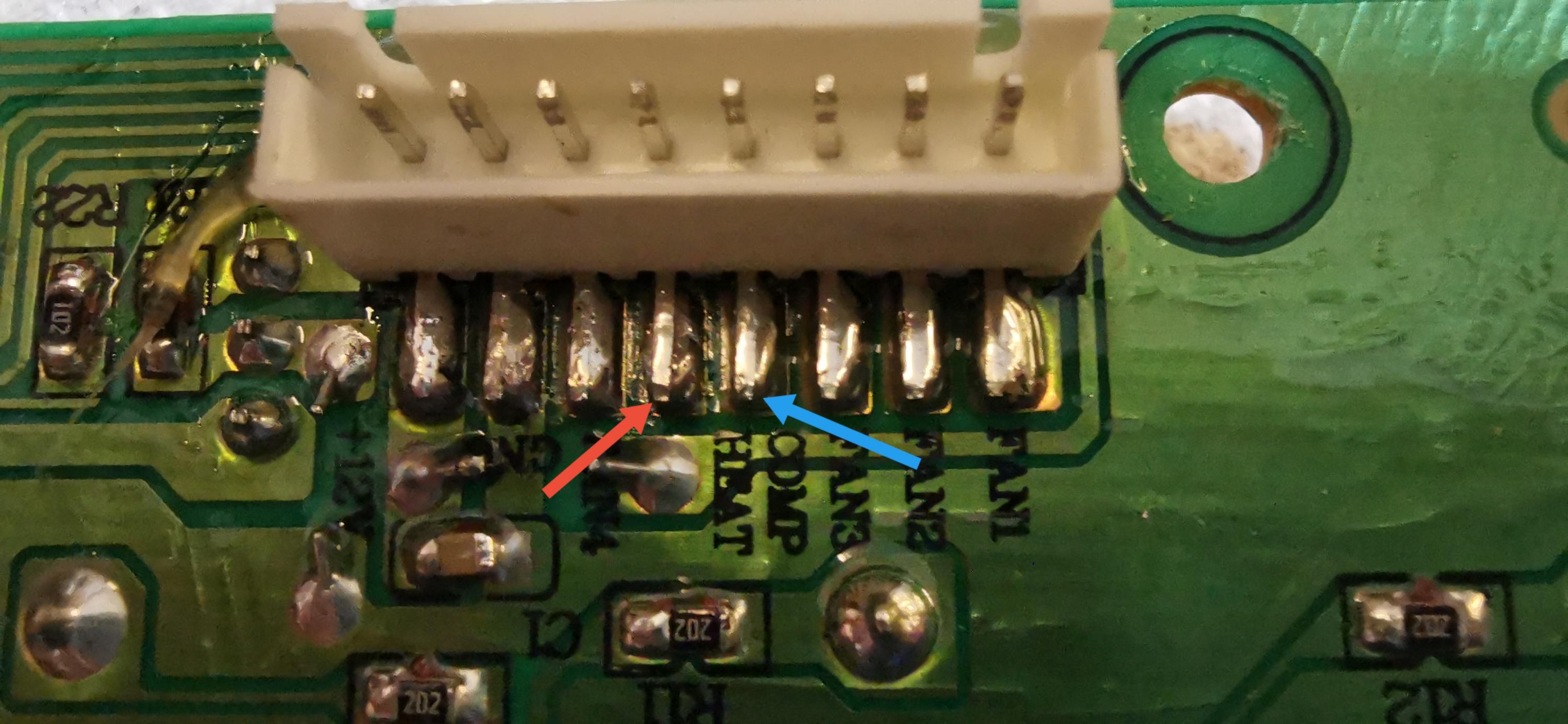

                  I traced the solenoid signal from main PCB back to the display/control PCB and found the voltage is 0Vac. So confirmed there is no signal at source to power up the solenoid valve!
                  Now trying hard to trace the display PCB on why there is not solenoid signal on power up..

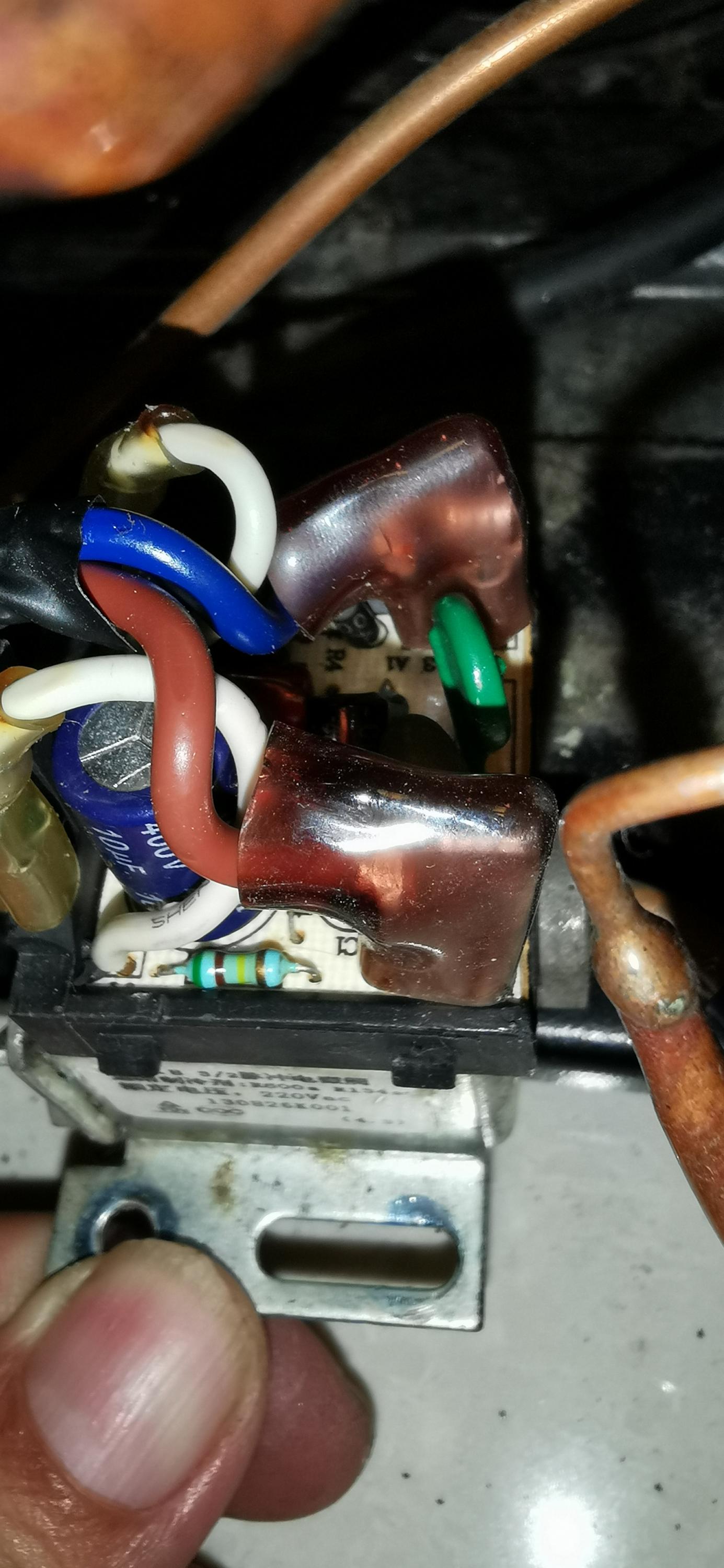

                    I can't find specs and more information about this solenoid beside just basic general functions a 3-way 2-terminal solenoid vale.
                    Anyone can give some insight of how I may "stimulate" the function by feeding external voltage into it?
                    I measured the voltage on "comp" pin (blue arrow), and it reads 4.13Vdc. Can I supply an external 4-5Vdc to "heat" pin (this is the solenoid input, red arrow)?
                    Also, for my knowledge, how would this this 3-way 2-terminal solenoid switches between the 2 terminals/valves?
                      • Jul 2011
                      • 6070
                      When the solenoid coil is not being powered on one side is activated when the solenoid is being powered then the other side of valve is activated
                      In other words when the coil ( with either power on or off depending on how the system is setup ) would be in cooling mode or in defrost mode ) one inlet port two output ports or it could be the other way around depending on how the manufacturer wants it function
                      If it is a dc coil just use a bridge rectifier and power the coil
                      Make sure weather or not it runs ac or dc current this is very important fact to know
                      Have the compressor running when you power the coil for it to change form one function to the other function to work correctly

                        This is a dual evaporators chiller, and the solenoid has 1 input and 2 output to the respective evaporator. The relay to this solenoid is switched on by the C1815 transistor with input from the "HEAT" signal pin from the display PCB.
                        I am thinking of feeding a 4-5Vdc, with a on-off switch, to this "HEAT" signal pin and this should turn on the relay which then switch the solenoid to the other valve. So if I turn on and off this "HEAT" pin, then both compartments should get chilled over time.
                        If this is the case, then the display controller PCB must be faulty because it does not switch on/off anymore (although it worked once when I heard the relay turning on-off, but stopped working after awhile..)
                        Does it make sense?

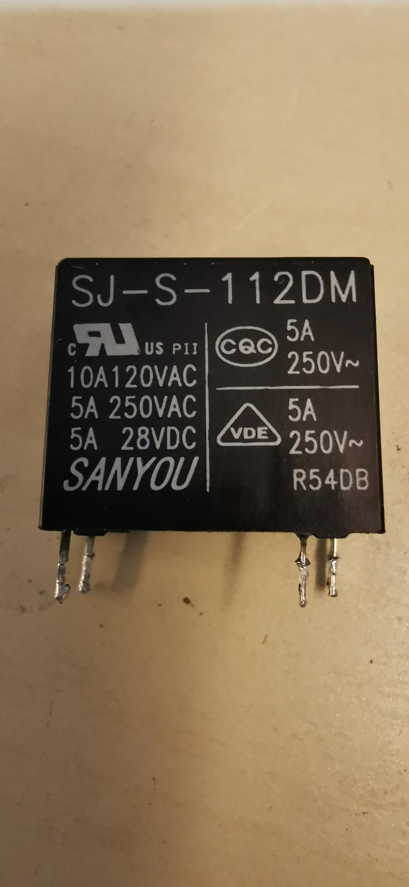

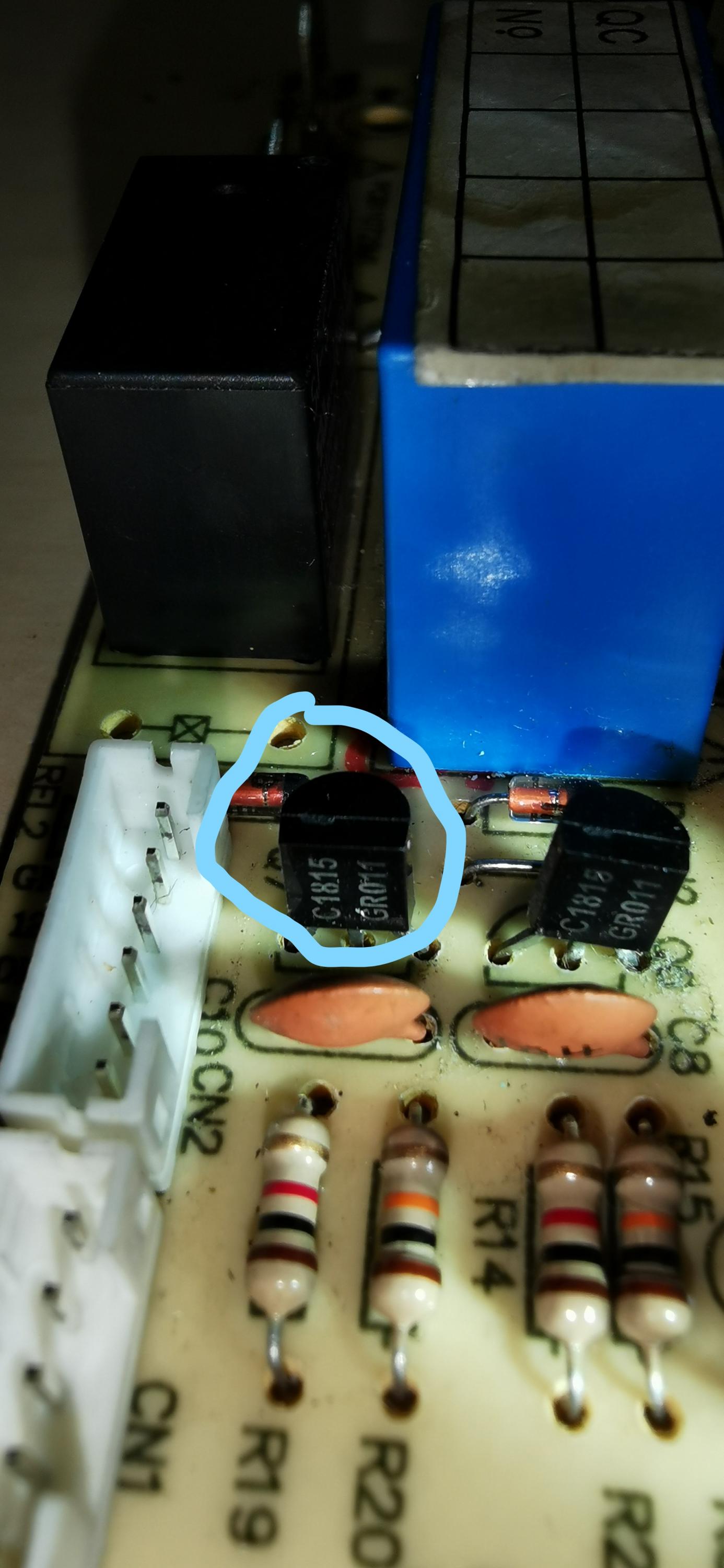

                              Here's new update:
                              1) I have wired an on-off switch between Heat & COMP pins.
                              2) On powered up the relay starts to click-on but click-off immediately
                              3) This click-on click-off is repeating every 5 sec.
                              4) It stops when I switch off the on-off switch
                              5) After about 20 min, the top compartment is really cooled to about 2degC, but the top compartment is just slightly cooled to about 27degC (from starting temperature of 28degC)
                              6) This click-on click off eventually stopped when the compressor is off (as expected)

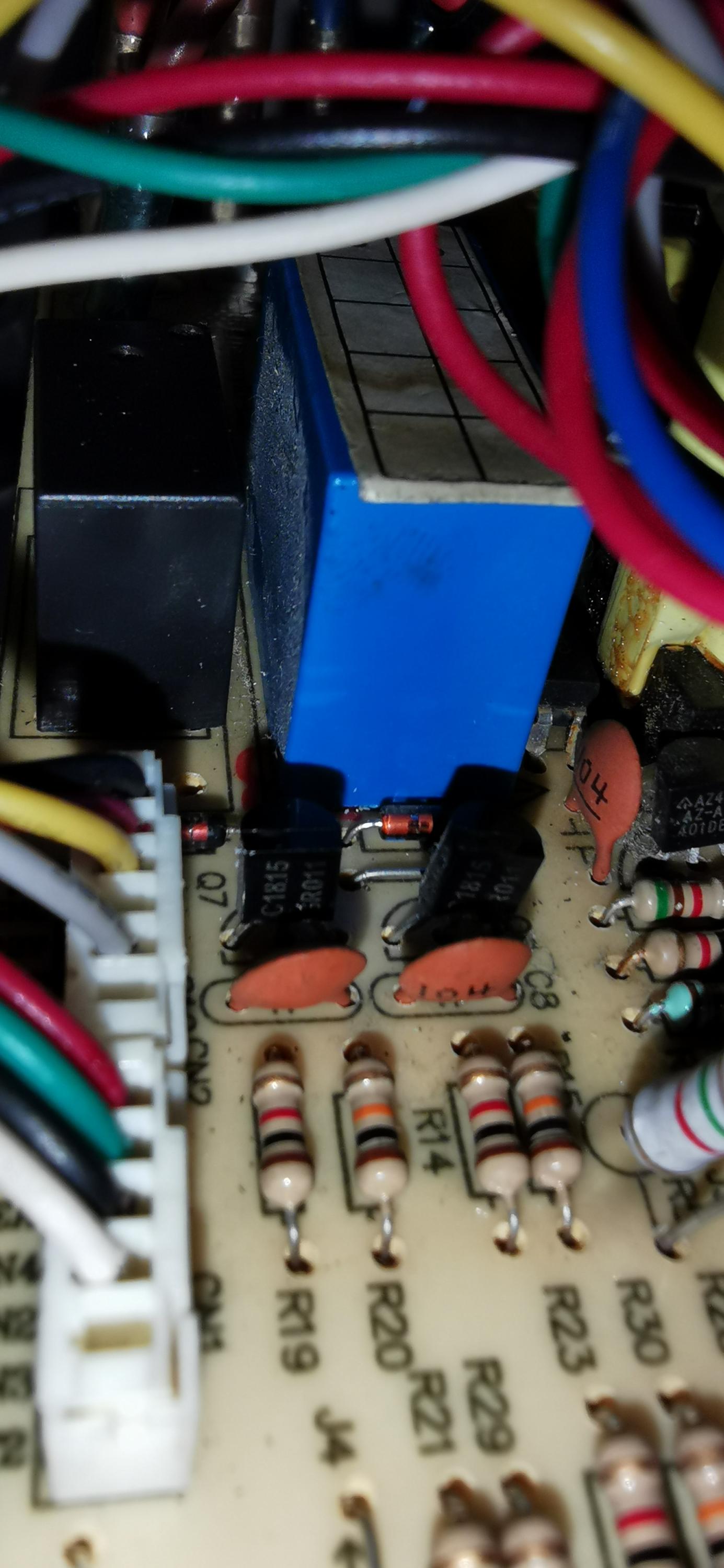

                              Effectively, it seems like the voltage to the C1815 transistor that turns on the relay get cut off immediately after turning it on, and got recharged to repeat itself every 5 sec...

                                  • petehall347
                                    • Jan 2015
                                    • 4451
                                    • United Kingdom
                                    you could monitor 2sc1815 base or just change it ..
                                    on another note i wouldn't use that transistor for a relay driver . i would choose a better one .
                                      Originally posted by sam_sam_sam
                                      If this the case then you could have a controller issue but is it the controller or is it a supporting component of the controller
                                      Okay what does the other transistor across from the one you marked
                                      The other transistor is controlling the compressor relay (in blue).
