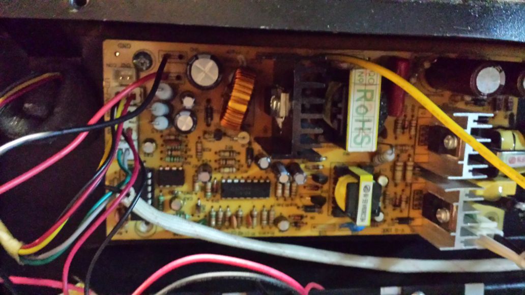

I found a couple helpful articles on here from people having the same problem as myself. I have the dual zone Wine Enthusiast 12-bottle fridge that lost cooling on one side. There was no power to the fan so I knew it wasn't the thermocoupler. I purchased a new board before finding this site but I immediately replaced the caps on the new board with Nichicon. Things were great for a few hours and then the other side died. Instead of another new board, I bought all new caps, diodes, and transistors to try and fix this myself. It powered right on and worked for about 15 minutes before the fan stopped. I can hear a high pitch beeping coming from the board but I can't tell where exactly. It is not outputting power. If I unplug it and wait a bit and then plug it back in, it works for a few minutes before stopping again with the beeping. Does this ring any bells?

So you replaced ALL the caps except the large main filter cap? Pictures?Never stop learning

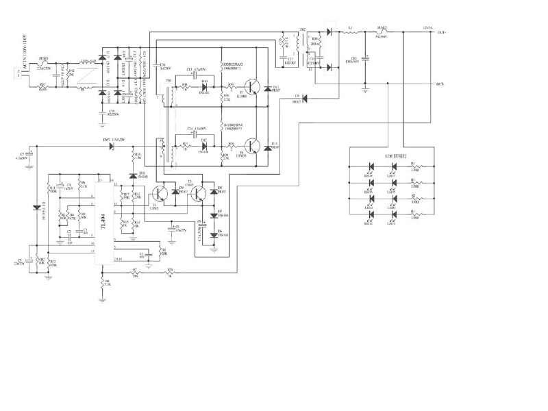

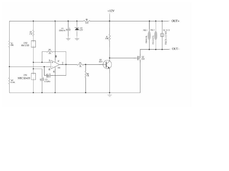

I found a schematic for a wine-cooler power board that looks similar to what you might have, except that extra socketed-DIP IC. I can't read PCB part #'s in your pics.
That circuit shows it's an always-on 12VDC 5A power supply and a thermistor/op-amp with power transistor (somewhere) linear? controlling the fans and Peltiers, which are all in parallel.
The temperature sensor on CN1 has something in series on CN2 which I think is a door switch.
You can try warming up the temp sensor with your fingers or a lighter and the voltage to the Peltiers/fan should ramp up. Or apply ice and it should back off.
Can you check the 12VDC is always good, LEDS not flickering etc.Attached Filesif you find these attachements useful please consider making a small donation to the site
