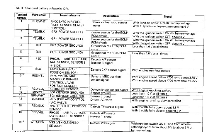

                              Here is the shop manual for this car ... the fuse in question is in the fuse box that is in the engine compartment, and it is tagged in the shop manual as "UNDER-HOOD FUSE/RELAY BOX" Fuse No. 9 (7.5 A)
                              You can see that there are several systems connected to that fuse, and a couple of them have a self-diagnostic mode that can be enabled with a dance as the book describes.
                              Also, I did check the alternator and it's kicking out 14.8V consistently, even under load so I'm thinking the voltage regulator is doing it's job nicely.
