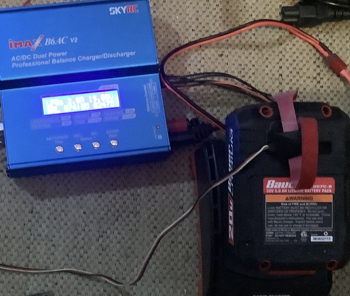

        Originally posted by sam_sam_sam
        Well what I have found out is that you have to set the voltage at 21.5 for it to work correctly if go pass this point it goes into an error if go lower than 20.5 then it does not charge correctly but the charging circuit does not seem to get very warm so the issue is with the primary side of this switching power supply it is not designed correctly it should not over heat the switching transformer like this
        You set it for 20.1 volt however it does not completely charge the battery fully it about 4.1 volts per cell which I could live with
        But where do I find a switching power supply that has an output of 21 volts this is hard to find 24 volts is more common
        One thing I noticed is that the capacitors in this device are not very good ESR values
        ( at least 1/3 higher than a brand name capacitor )
        for a new non brand capacitors
        So I am going to replace the capacitors that are less than 100uf and see if this makes a difference or not
        Well changing the capacitors helped however it still over heating the switching transformer so just got discussed with this issue and did some modification
        ( removed the circuit board from the case and removed the balancing wire connector from the battery charger connector to the battery pack and put the balancing connector for the SkyRc IMAX b6 battery tester )
        So now I can recharge my battery packs with worrying about the charger going up in smoke
        Just want a to able to charge these battery packs
        I might still use this battery charger for very low amp hour battery pack 5c1p to not stress the battery charger
