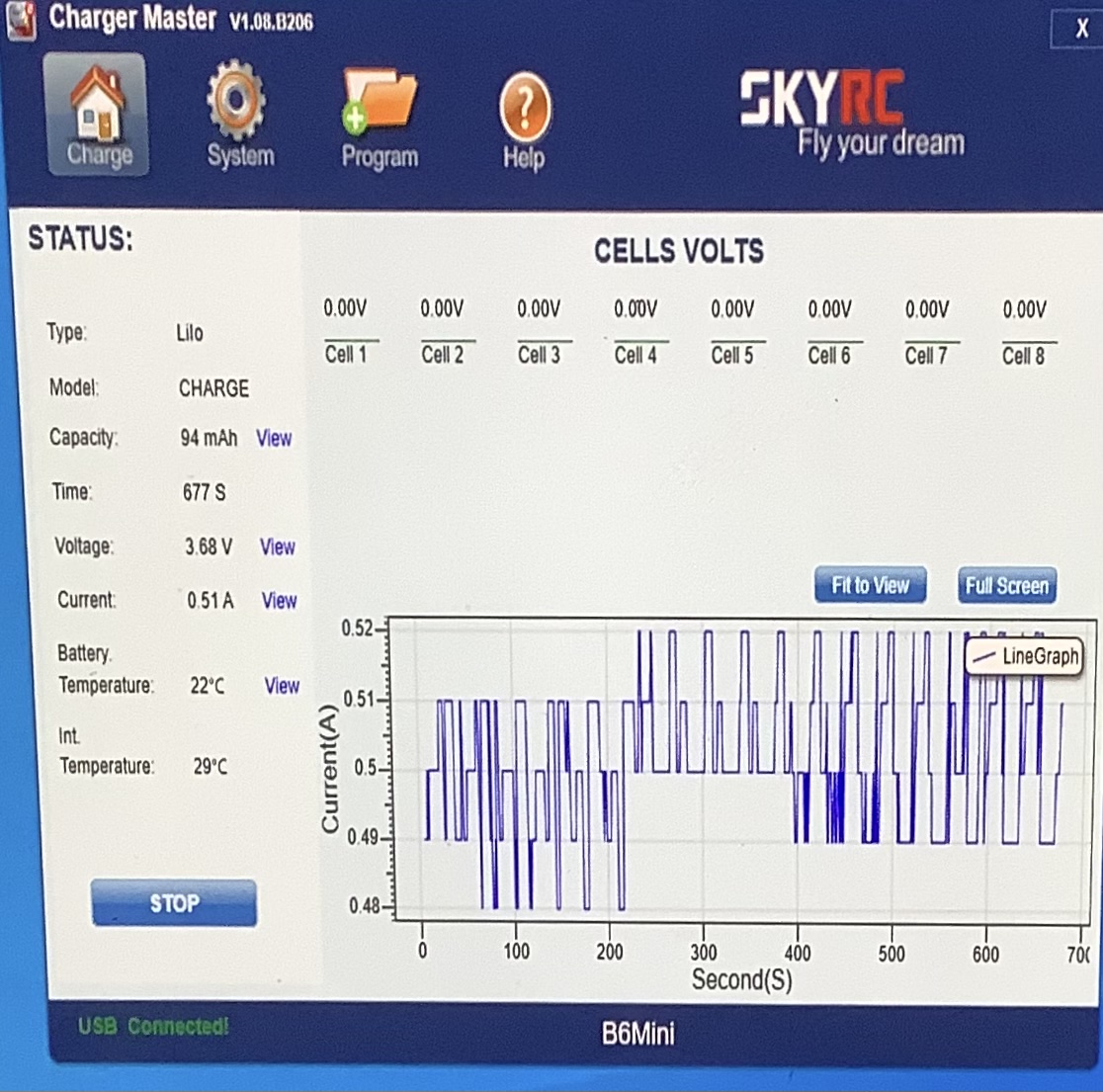

      I have downloaded the software for the IMAX B6 battery charger / discharger tester
      The results are not what I expected to get but it will allow me to charge and test the batteries that I commented about before that heat up if you charge them above 4.0
      The one thing that I do not like about this charger is that you can not adjust the cutout voltage which is very limiting but what it does have is a temperature sensor monitor that does stop the charger if the temperature goes beyond the temperature that you set
      I have the temperature sensor cutoff set to 32*C so I do have have to sit there and watch it continuously which is a pain in the a**
      I can look at the graphic display page to see at what temperature does it start to climb so I know up to what voltage I can use before it starts to climb
      The item that are marked as “ view ” and it changes the screen
