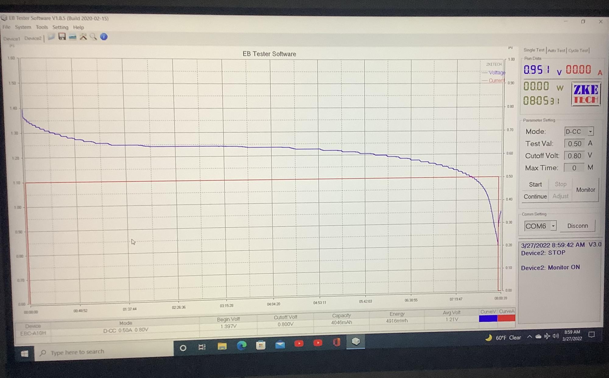

    Here are the results from the 500 milliamperes load test
    1.00 volt @ 500 milliamperes hours = 3.96 amp hours close enough to 4.2 amp hours = 95% useful life left in this battery cell
    Well worth $5.50 a pack

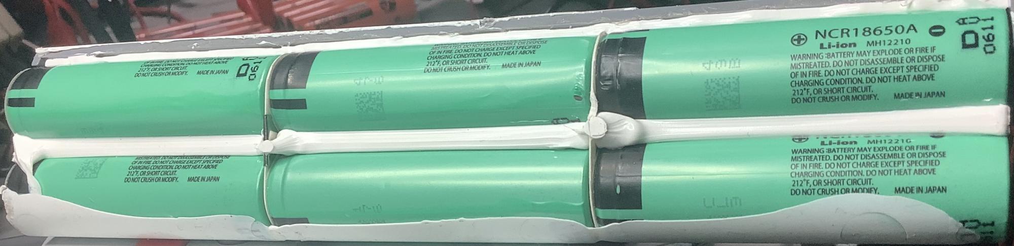

                I did some testing on these battery packs that I bought from Battery Hookup and they are nice however there are couple of things you should know one is it dose have a BMS protection board but it is kind-a cork-e the way it works
                One the cutoff voltage is 4.25 per battery cell (not real thrilled about this
                Second the fuel gauge is weird in that from 9 to about 10.50 volts it flashes one LED light until it get above 11.50 volts when it gets above 12.00 volts all 5 LEDs are on I left it charging on own once it got passed 11.30 volts until this morning when I checked the fuel gauge again
                The BMS protection board hookup is first three and the last three pins on the connector are used the rest of the pins go no where on the board
                One final note about this BMS protection board is that when it has reached the cutoff point and you discharge it a little bit to reactive the charging mode it is still locked and will not allow you to charge it until you get below 12 volt before it reactive the charging mode very interesting the way this BMS protection board works
                I kind-a like this because I can use this BMS protection board with a solar panel and not worry about it severely over charging the battery pack which on some BMS boards when you remove the charger and reapply the charger again it charging again and it does not matter how many times you do this it keeps charging not at a high current but just the fact it does this I not thrilled about that the fact that some BMS protection board do this crap

                    The BMS protection board specifications are as follows
                    Cutoff voltage at discharge is 7.9 volts cutoff voltage on charge is 12.81 volts ( this is a little higher than I would like but it not as bad as I seen before but the lockout feature is what I like about this type of controller )
                    The fuel gauge is weird in that from 9 to about 10.50 volts it flashes one LED light until it get above 11.50 volts when it gets above 12.00 volts all 5 LEDs are on
                    The last picture is of the controller ic chip
                    Here is the data sheet for the controller ic chip
                    When I put the power supply wires on the BMS protection board and put it back in the enclosure I will recharge the battery pack again to 11 volts and then start the charging cycle again but keep pushing the fuel gauge button to get a more accurate idea of what specifications this part of this circuit has for my own information I will also post the results
                    I will post some pictures of the BMS protection board and the power supply wires and what it will look like after it is put back together
                    I have a couple of solar panels that I want a BMS protection board that would not allow the batteries to become over charged I found what I was looking for in a BMS protection board
                    One note the cutoff voltage is not 2.640 volts the cutoff voltage voltage is actually 7.90 volts
                    The amp hours are 9.604 which is what the data sheet says that it should be for 3 cells in parallel
                    This is the best battery pack that I have bought from Battery Hookup so far
                    I only had one other battery pack that I like the BMS balancing protection board unfortunately I only have one pack that is this way the other battery packs were only BMS protection board but it was only a 8.2 volt battery pack not going to be able to use it on a 12 volt solar panel because I only have one battery pack that is that way
