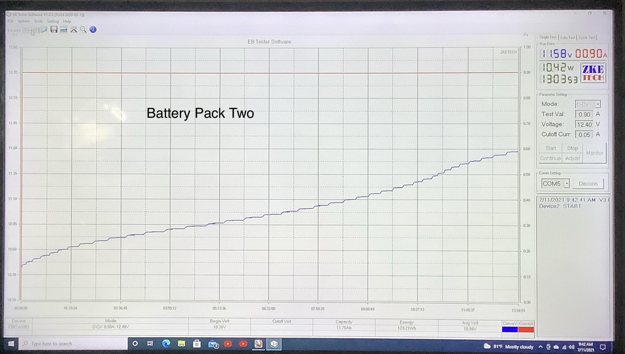

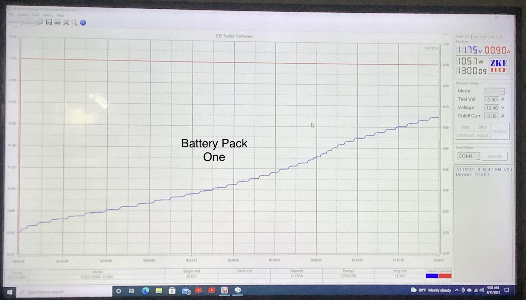

                  I have a correction to make I was not discharging the batteries I was charging them to 12.40
                  One note these batteries start a about 2.5 volts for each cell or maybe a little bit lower than that
                  When I first started charging them because the battery voltage was so low I only charging them at 80 milliamperes when they reached about 11 volts
                  ( one battery pack at a time because of the software of this battery testing machine I can only see one screen on top I would have to click on to the other screen because I was doing other thing I only wanted to see real quickly where and what the results are at that given point in time and do a temperature check as well )
                  [ someone might think that I could open two screen on the computer and I could have done this but I was also using the IMAX b6 charger at the same exact time but this software for the battery testing machine has slight issues when you open two separate screens it does not always want to behave it self in this mode of operation I do not feel like dealing with it so I don’t ] plus it is more difficult to save the individual screen and bring them back up for use later is another reason I do use dual screen
                  I took off the charger and let them sit for a week to see how much they dropped off in voltage which was not much
                  Through out this hole process the battery have not heated up at all
                  I will load them at 1 amp and charger at 1 amp and see if the results are any different from the way I have been charging them to bring out of sleep
                  When I have finished this charging/discharging cycle then I will discharge at 2 amps and charge them at 2 amp which I will have watch closely for any issues that might arise
                  I have no plans to use any current higher than this for charging or for discharging them

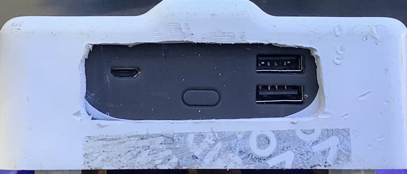

                                    Here is a project for what I did with one of these battery packs
                                    https://batteryhookup.com/products/2...cents-per-cell
                                    Right now it has the Boston Power batteries in but I am going redo it and use the 18650 batteries in it instead
                                    And repurpose the Boston Power batteries for something else that requires more current and more running time with a better BMS balancing protection board
