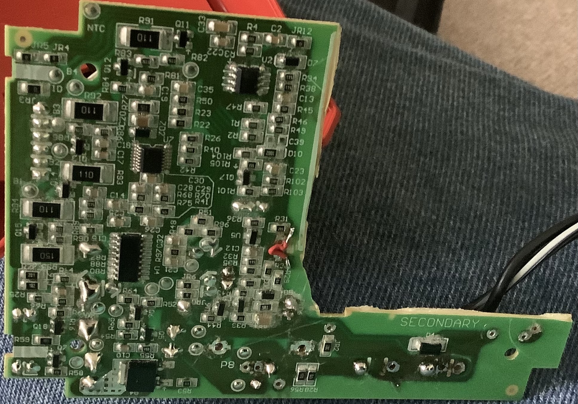

                Originally posted by sam_sam_sam
                Well I have taken apart the air compressor and it does have two battery voltage monitor modules and a dual input module that separates the battery inputs but is not isolated from each other
                One module controls the motor which has three wires so I not sure what type of motor it is the other module has the battery wires going to it
                So my plan to have two power supply battery packs is going to work all I have to do now is do testing on a bunch of batteries and get them in battery pack cases and hook them up and put the air compressor case parts back together and do some real world testing
                Well I have bought two of the 5 amp hour battery pack and they are using Samsung 2500 batteries this why the battery pack preform so much better well worth the money for these battery packs right now they have a sale on save $18.00 when buying two battery packs
                I would have taken them back and got my money back if they had not been brand name batteries
                My plans have changed I will probably buy two more of them when they go back on sale again
                  Here is the more
                  Just as I thought the BMS balancing protection board is part of the charging board look at the top and bottom of this board I have never seen this before done like this
                  I like the idea that you can use the battery connector in another case if you want to
                  When I charged the 1.5 amp hour battery I did not notice this issue it’s when I was charging the 5 amp hour battery is when I noticed this —>
                  There is an issue with the switching transformer for this battery charger the transformer gets very HOT to the touch and you can smell that it getting very hot
                  I going to see if there a way to modify this charger because I do not like the fact that the transformer is getting this hot
                  Even if this might mean that I have to use my SkyRc charger to charge the battery packs

                    I've noticed some "current limiting" PSUs don't *really* current limit, rather it just depends on the controller from self destructing, so it's really "wattage limiting"... Not sure if this is the case when "wattage limiting" still allows the transformer to overheat.
                      Is there a solution to this issue

                        Yes there is. Most power supply designs from the past 20 years use current mode controllers, so the quickest and easiest solution is to increase the value of the resistor in the source of the primary switching MOSFET.
                          Can you please point out the resistor in question so I know for sure which one you are talking about
                          I have decided to take a different route on this charger but I also have another one so please post what you have in mind and I will give it a try

                            Well what I have found out is that you have to set the voltage at 21.5 for it to work correctly if go pass this point it goes into an error if go lower than 20.5 then it does not charge correctly but the charging circuit does not seem to get very warm so the issue is with the primary side of this switching power supply it is not designed correctly it should not over heat the switching transformer like this
                            You set it for 20.1 volt however it does not completely charge the battery fully it about 4.1 volts per cell which I could live with
                            But where do I find a switching power supply that has an output of 21 volts this is hard to find 24 volts is more common
                            One thing I noticed is that the capacitors in this device are not very good ESR values
                            ( at least 1/3 higher than a brand name capacitor )
                            for a new non brand capacitors
                            So I am going to replace the capacitors that are less than 100uf and see if this makes a difference or not
                              This is actually wrong, it still simply limits the wattage.
                              To get full current limiting you have to design your own add-on circuitry.
