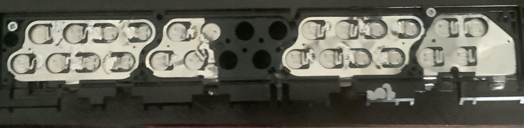

            Update on the use of this battery pack
            https://batteryhookup.com/products/2...-6-4a-299-99wh
            I have modify one of the half battery pack that I split into two separate battery packs one of them is seven cells the other one is a six cells
            The six cells battery pack is the one that I modify I am turning it into a 3S8P instead of 6S4P
            which is fairly easy to do but you have to be very careful removing the tabbing from the batteries that you are separating I just have to make a slot in the plastic battery enclosure for the extra battery terminal and wire into the the battery pack that I want to create
            I also bought the metal enclosure for this battery pack that I plain on putting the battery charger board in this enclosure
            I will post some pictures of it when I have finished the project
            I have not decided what I going to do with the other half of this battery pack that is 7S4P
            I might remove all the tabbing and reconfigure how this battery pack is setup
            I might make it 5S5P and have three open battery slots that would not be used I just need to decide how I am going to use these batteries

                              • Jul 2011
                              • 6040
                              #174
                              Re: Here is a good used source for 18650 batteries
                              Here are some pictures of the 7S4P modified to 3S8P fairy easily to do but a little bit time consuming to get it this way
