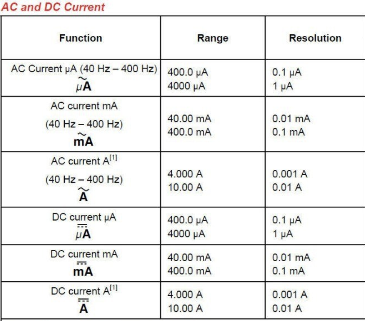

        OK, lets take this spec from a web site selling this meter...
        Is this thing saying that it can only read microamps NO LOWER than 400µA and no higher than 4000µA?
        OR would it read 5µA without any problem at all?
        Edit: After looking at that a little closer, what I THINK it's saying is that when the current is under 400µA, the resolution will be .1µA and when it's over 400µA, the resolution will be 1µA ... ???

          Can we see more details spec about the spec of this meter? Make and brand?
          As shown, it can read down to 000.1uA on 400uA scale with one decimal point resolution.

              That spec came from a Fluke 17B+ ... I went ahead and ordered one. I'm pretty sure it will read µA below 10. Based on my experience with the Fluke 117, that spec suddenly made sense as there are thresholds on my 117 where the resolution changes as you get higher in a reading which makes sense since the available screen space for numbers gets crowded as you read higher values ... but to switch that up at 400 seems a bit odd to me... 999 makes more sense. ☺

                It's just marking two different microamp ranges for the 3¾-digit LCD: 0.0 to 399.9 µA and 0. to 3999. µA.
                (and of course it has 40mA, 400mA, 4A, and 10A ranges... need more digits if more precision is needed...)

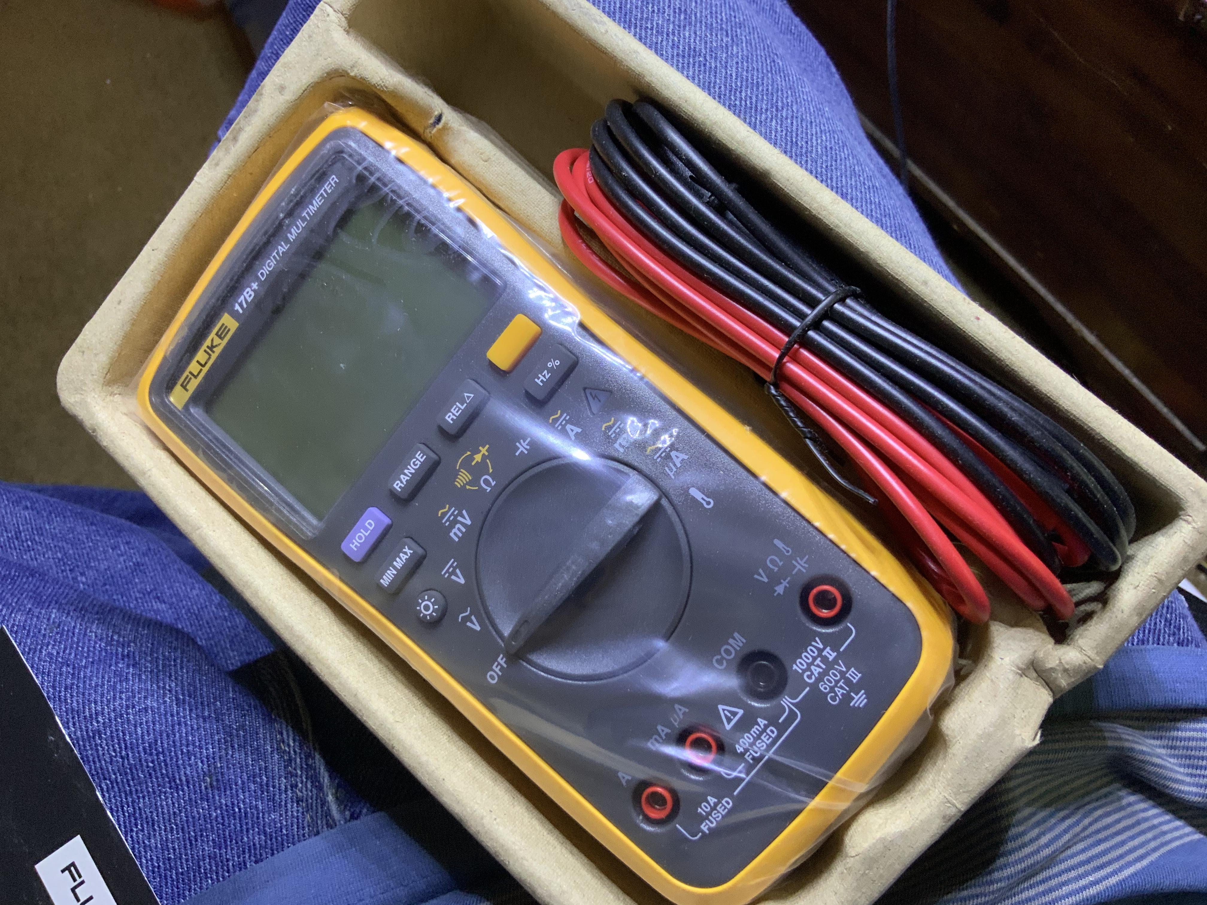

                      Got the new meter ...
                      Even got a nice case for it - the zipper compartment was mandatory as my last one only had an open pocket and I was constantly chasing pieces that would fall out of it.
                      Right off the bat and I know this is probably nit-picking but the sound of the beep it makes is more pleasant than the 115. And notice the display - it's got larger numbers and more real estate all around. Also, the backlight produces a much cleaner look than the 115 has with more even light distribution.
                      Next, I need to test the microamp ability ... back to my ATTiny85 project and experimenting with the Tiny's sleep modes

                        That's great, you can't go wrong buying a Fluke. Buying a Uni-T however, those are true garbage multimeters, they have awful input protection circuits.
                        Keep in mind the uA current-shunt on the majority of multimeters large, at 1k ohm. So you get a large voltage drop or "burden voltage" across the shunt as it's called. e.g. 200uA is 0.2V loss and if your load goes well over full-scale for the uA range, the input protection diodes clamp at around ~2.4V drop across the DMM.
                        Schematic for Fluke 17B attached here.

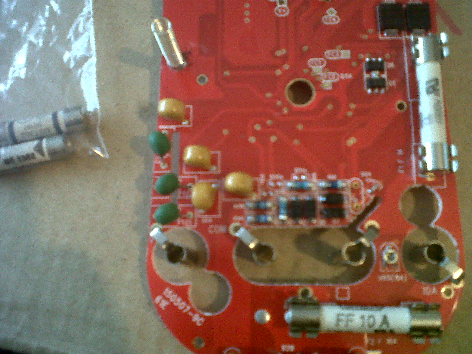

                                  i fitted my own movs - and big FF rated fuses.
                                  i dont mind paying 45$ and adding them instead of paying $80+ to have them to begin with

                                      What MOV's did you use, it's that people don't know they need them until the big IC is damaged.

                                        the mov's are 07d751k
