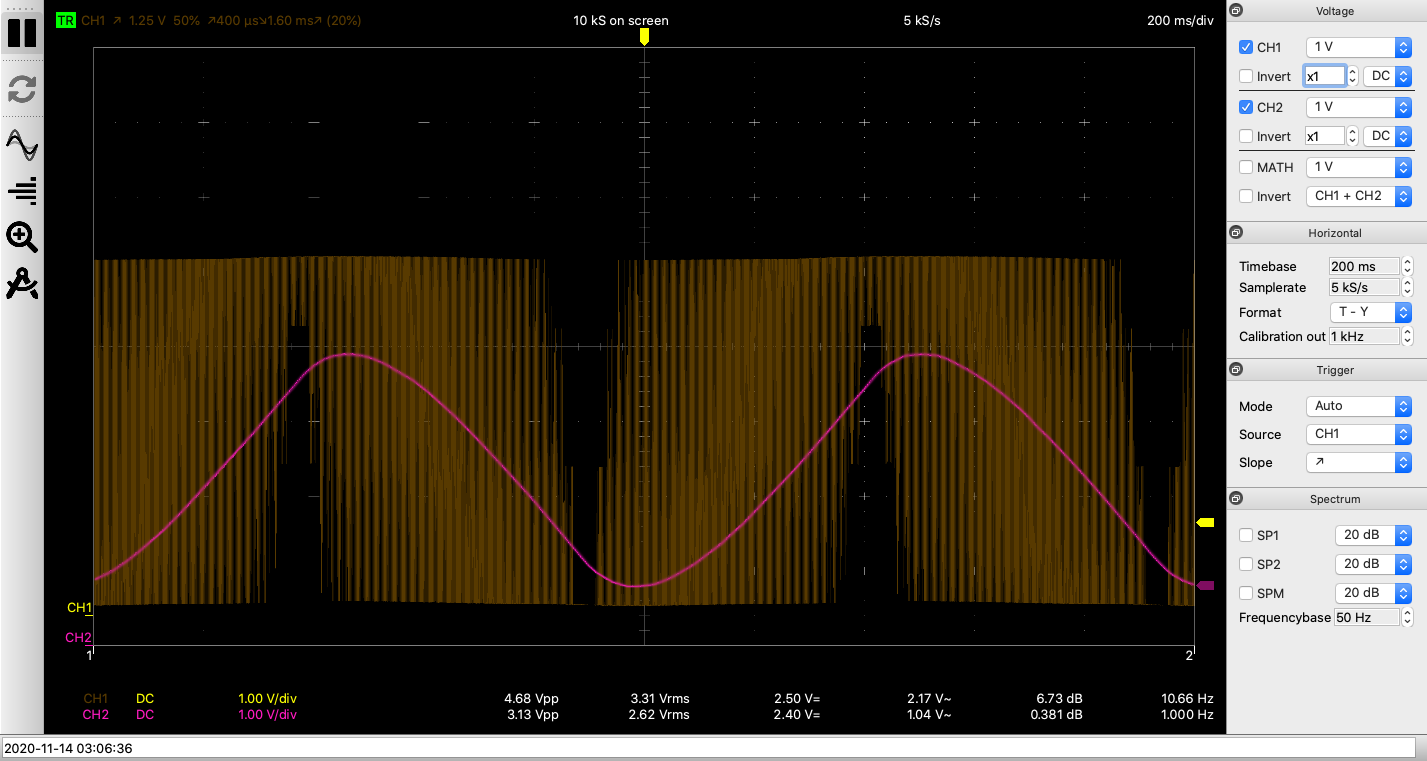

    This is connected to the electromagnetic stirrer that I'm working on which I discussed in another post - for those who remember...
    Anyways, I wanted to smooth out the voltage going through the coils as I vary the voltage to get a smooth spin on the magnetic pill. And since I'm doing this project with an Arduino, I only have PWM to work with. So to smooth it out, I use an RC filter which initially works pretty good.

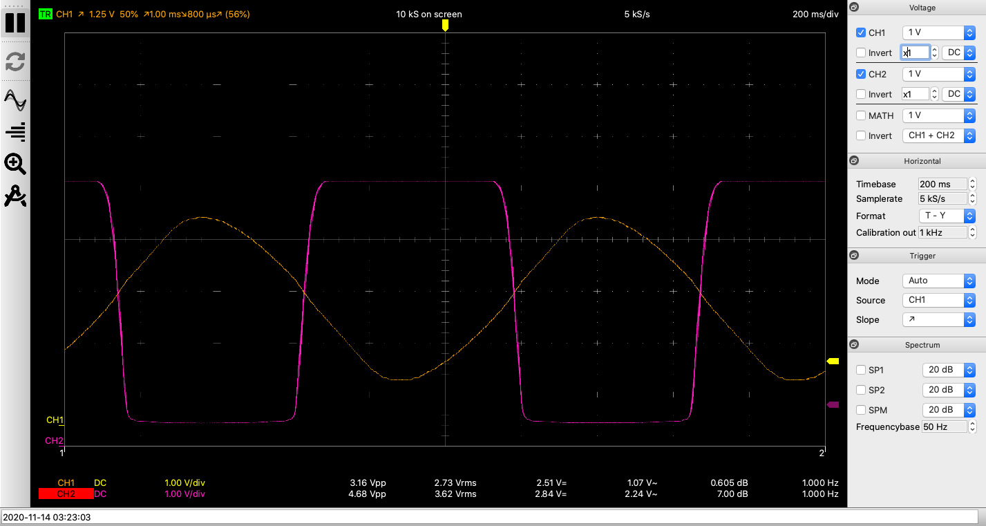

    Here is the input PWM vs filtered output before putting the load on it

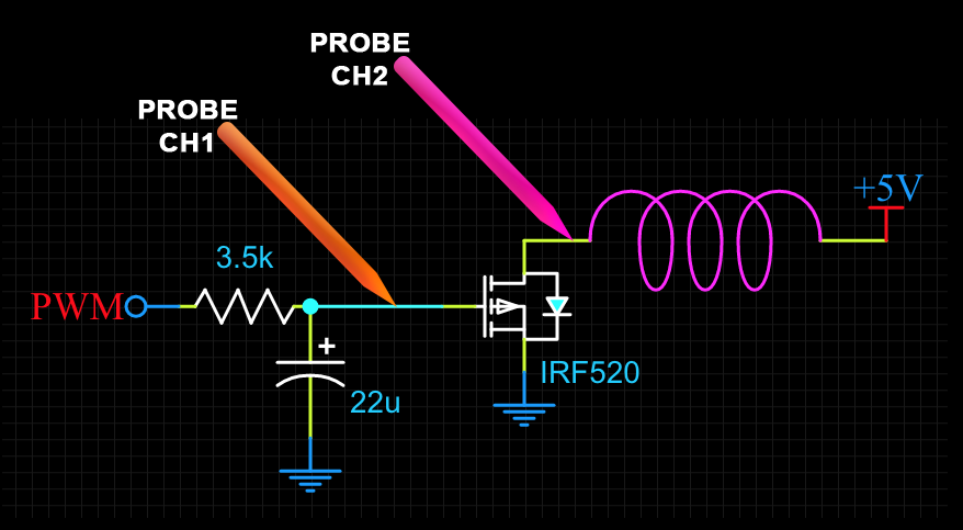

    Then, I attach the coil and move the leads of the scope as per this drawing

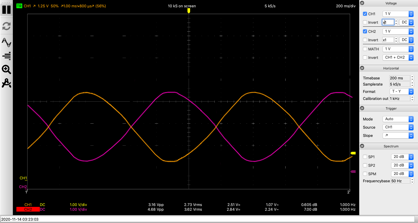

    However, this is the final result...
    The voltage going through the coil seems to spike pretty quickly on the up and the down swing...
    Using photoshop, this image is more what I would LIKE the wave through the coil to look like.
    Is there anything I can do to smooth it out? I'm assuming that the spiking is because of the inductive properties of the coil?

    Re: Weirdness with a filtered PWM through a coil
    your going to see back emf from the stirer and backpulses from the coil itself - good luck trying to kill that.

        • 31258
        no, your stirer is in constant motion so when you have no coil pulse the stirer will transfer some current back into it. (because it is still in motion)
            You need to correct the MOSFET, you show P-CH in your schematic, it will not work, the current will flow through coil straight to circuit ground via body diode of the MOSFET. Did you actually use P-CH MOSFET?
              No, I am using an IRF520
                You're dealing with the unpredictable gain of the transistor around its threshold and will be tough to do without a feedback system, perhaps with an op amp. Unless you have special needs I'd say do away with smoothing the pulses with PWM, you'll be fighting it to no avail.
                Plus as you have it now you'll be wasting quite a bit of power... alas it's all a tradeoff anyway.
                  Here's a corrected schematic
                      i dont see how that circuit works,
                      the fet is voltage-driven, not current driven.
                      so once that 22uf cap gets charged - it stays charged.
                      shouldnt it have a parallel discharge resistor if your trying to use it as a "shock absorber"?
                        Also, are those screen shots of your Oscilloscope or screen shots of the simulation program?
                        The cap will have to be discharged through that 3K5 Ohms resistor when PWM goes low but if the PWM frequency is too high for that RC time constant then the cap will never be discharged completely. It also looks to me that the MOSFET is operating in linear region with that 3V of Gate drive.
                        What is the PWM frequency? Your screen shots are just hard to read/see.
                          He probably programmed the driver to both source and sink current, so yes this should work as long as the RC delay is shorter than the desired low frequency cycle time... much shorter...

                          If he wants to get the input to look like output, needs negative feedback to get amplification ratio down to 1:1.
                          Yep sure is, and he has to in order to get it to work the way he drew it, and then hence the concern about power.
                            My osciliscope.
                            If you click on the screenshot image, it should pull up the full-size version which is exactly what I see on my screen. All of the values are calculated by the software and shown at the bottom of the display under the wave.
                            It works ... you can see by the screenshots of my oscilloscope that it works... I think the cap discharges through the resistor maybe? Or maybe the load that I have attached to it which would be the gate of the mosfet.
                              I see a problem with your project- the coil can only generate one magnetic pole or nothing- let's say it's the North pole. For any kind of motor or spinner, you also need to generate the opposite (South) magnetic pole.
                              Because current can only flow in one direction, the coil only makes a magnetic field to attract the magnet but not repel it.
                              So an H-bridge or AC drive current is needed for both directions. The sine-wave you are trying to make is only half a wave (of current) really. It goes up and back to zero but does not reverse polarity.
