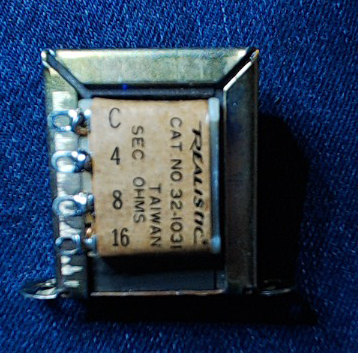

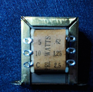

    I don't know a whole lot about transformers beyond what they do functionally ... I've never made a circuit that incorporated a transformer so I've never had to spec one out or even figure out how they connect. The one time I tried to re-use a transformer from a circuit I connected it wrong and literally made a loud bang when I connected power to it ...
    Anyways, I found this one at a thrift store for $1.25 and was wondering if it could be used to step down 120V AC ... it looks like it was used somehow in an audio circuit as each side has what looks like a Common pin then a selection of wattage and on the other side, a choice of 4, 8, or 16 Ohms, which I assume is relevant to the speaker you're connecting it to...

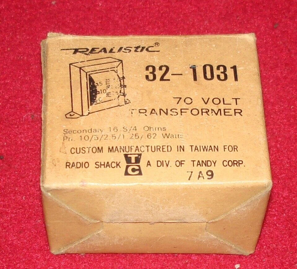

                    Here is a new 70 volt line transformer in the box, ebay $15.00

                      BTW I missed the original question, whether it can step down 120VAC. I doubt it or at least it probably would get hot. It was clearly designed for the audio range. You're better off locating a transformer marked for line voltage use.

                        OP you have a 10W 70 volt line audio matching transformer. It is used for bigger paging and PA speaker installations.
                        It is not suitable for use as a mains power transformer. It does not have high voltage isolation between primary and secondary, and at 120VAC it would be saturated. That and paper wrap is not the greatest for flammability.
                        The turns ratio is about 5.5:1 using the 16 ohm tap.

                          Radio Shack speaker transformer, used to match to 16, 8, or 4 ohm speakers.
