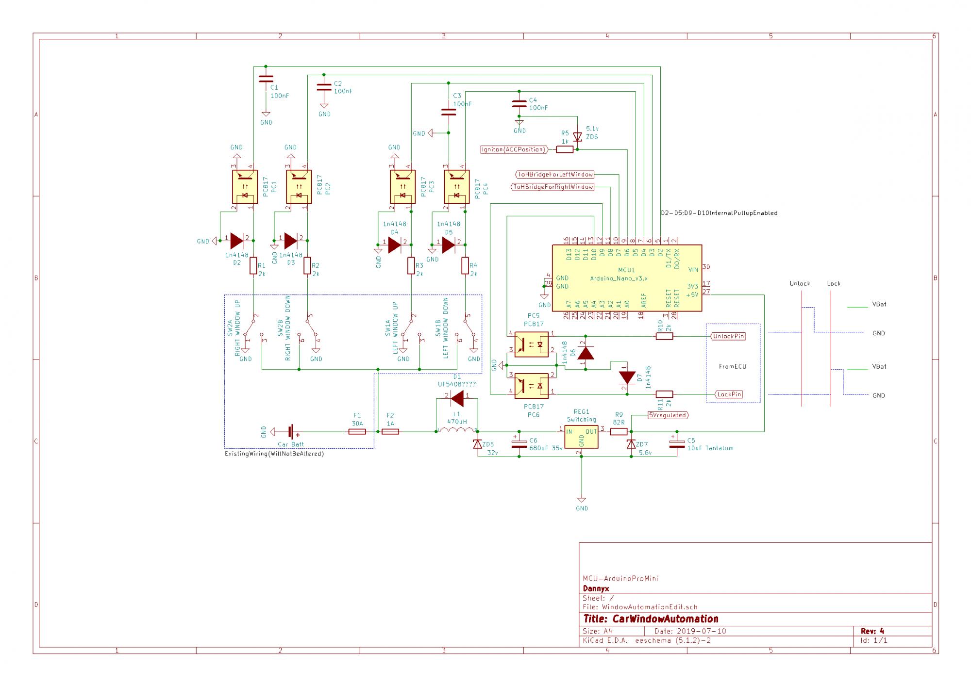

    I am curious as to why the OPTO LED's side are not running of the regulator in your circuit. It looks like you are using OPTO as level shifter.

      Re: Running a microcontroller in car - power supply aspects
      This
      It's mostly out of commodity and to keep the car's circuit as stock as possible. 12v is present at the switches already, so to run off 5v, I'd have to cut the incoming power wires from the car's system to the switches and wire in my 5v line there, which of course would work, but I just don't want to alter that part. It's not a pleasure working on the wires in that dash - very tight in there, with wires going everywhere, so it has to be as plug and play as possible: connect it up then get out of there as quickly as possible
      Wattevah...
        #43
        I see, trying to keep wiring as original.

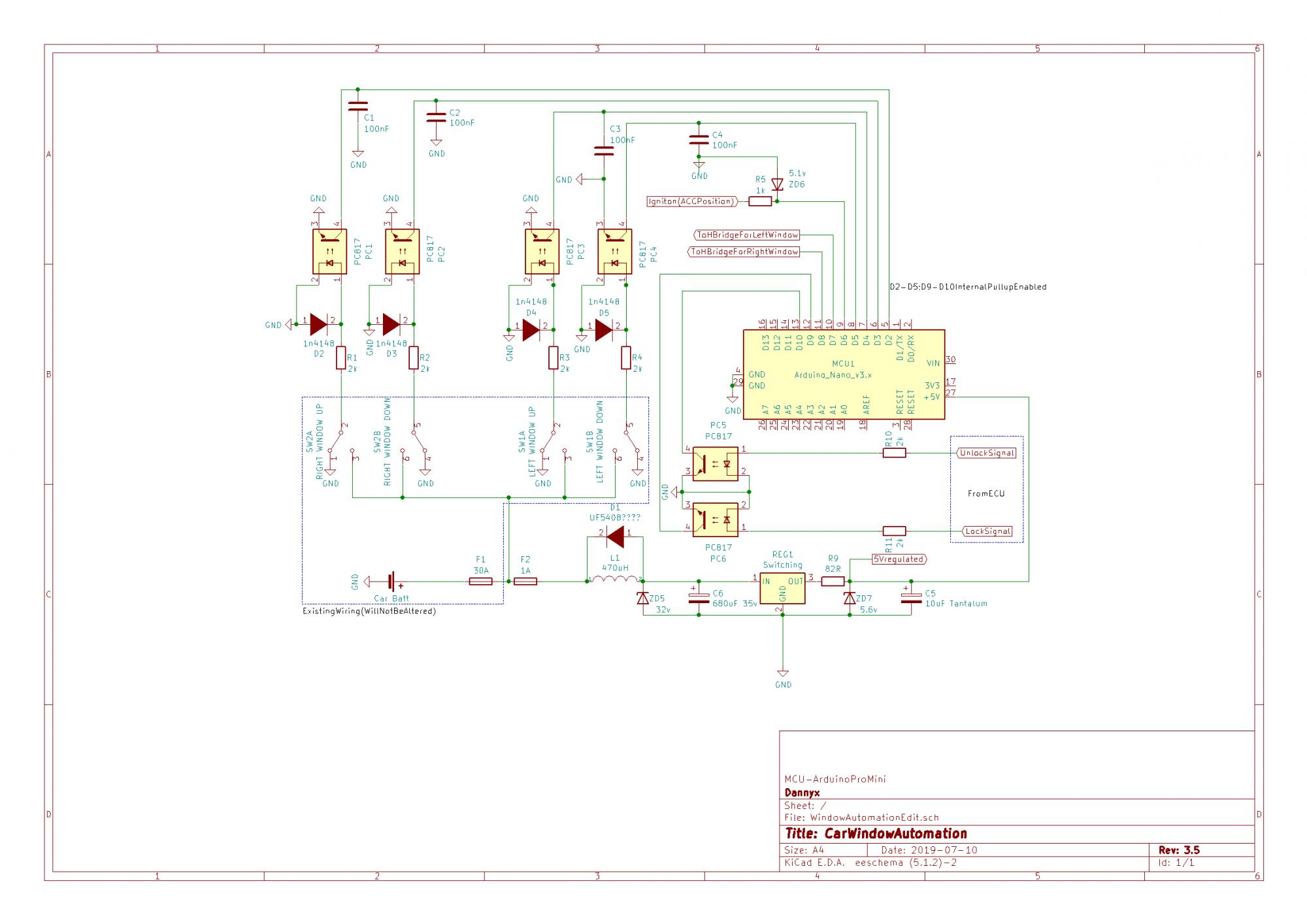

            #45
            Had another look over the schematic and made another change: the lock/unlock signals on the right now also have optoisolators (PC5 and PC6). This is actually how the circuit is currently set up on the breadboard, but I omitted those two for some reason. Trouble is, I can't add a protection diode there because those pins swing low/high when locking/unlocking. Basically those two wires I labeled there run from the ECU to the 4 actuators in the doors and 1 in the trunk and I need to somehow tap into them to trigger certain functions on the Arduino. It's a simple H-bridge inside the ECU that does this I THINK: when you lock the car, the LOCK pin gets 12v on it and the UNLOCK pin stays low. When you UNLOCK the car, the reverse happens: U/L pin gets 12v on it and the L pin stays LOW. I measured this to confirm. Adding a diode there would create a short, yet I still need to have some sort of protection there, since linear actuators create a ton of inductive kickback which overtime can kill those LEDs. A capacitor perhaps ?

              #46
              Why would Low (Grounded) signal be problem? The MCU signals are ref. to GND. Am I missing something?

                #47
                Actually you're right. I was thinking the pin would short out through the diode, because for some reason I mistakenly assumed the diode would go between the L and U/L pins themselves, which is not correct - it would go between EACH pin and GND, so when the pin is pulled high, the diode is reversed-biased and doesn't conduct and when it stays low, it's essentially GND, so no current flow either.
                Another thing that confused me is the way those L/UL rails are laid out they look very similar to a split-rail supply, with GND being in the middle, L being let's say + and U/L being -, although it's nothing of the sorts, so that's another thing that threw me off, so you're right: diode across each of those LEDs and I should be good. Can't believe I screwed up on such a simple electronics circuit
                Wattevah...

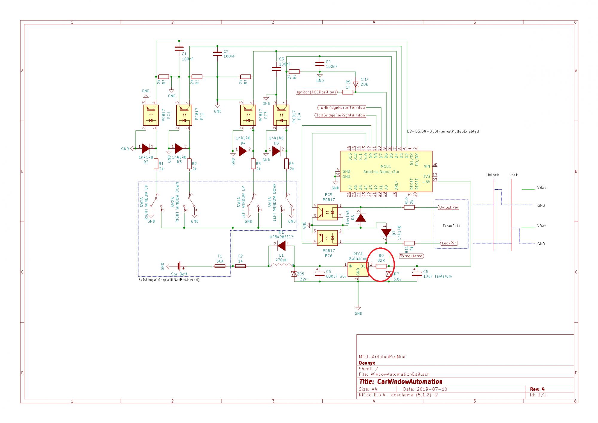

                  #48
                  Updated schematic. Added D6 and D7, plus a simple plot of the lock/unlock pins.

                    #49
                    Alright gents (and ladies, if there's any watching ), since I'm on my winter break and I have some spare time on my hands, I thought I'd go back on this project which should've been finished last year
                    Here's what I've been up to: as you guys suggested, I went with 2k resistors for the LEDs of the optocouplers instead of having the zener diode as well. I tested and it works, so I rolled with it.
                    Pullup resistors: you guys suggested using the internal pullups on the digital pins so I wouldn't have to use external ones, but I could not get this to work - either I'm doing something wrong (most likely, since we all know I'm a bit of noob at this stuff ), or simply changing the pinMode in the beginning is not enough and I have to tweak the rest of the code as well. What happens is I do pinMode(x, INPUT_PULLUP) and measuring with a multimeter shows the pin does indeed go high after pulling the 10k pullup resistor off the breadboard, but when I push the button and the optocoupler turns on and pulls that pin low, the action related to that button being pressed gets stuck on and runs continuously. If I understand correctly, it should work the same, with no other changes....
                    Current sensors: I played around with the "analogRead" and a current sensor and I think I got this one right: I used the serial monitor to read the values the pin was giving me at different voltage inputs, from 0 when fully grounded, all the way to 1024 (I think) when pulled all the way to 5v. The current sensor I got (which I can't remember for the life of me what model it is right now), outputs a value between 2.5v at 0A and 8v! at 30A! (if I remember the datasheet correctly). My car window motor draws precisely 15a when the motor is stalled, so to test this on the bench, I paralleled two 10w low-ish value resistors to drop their resistance even more, wired this setup in series with my current sensor and put the whole thing on my power supply. I began cranking the voltage and observing the values the sensor gave me at different currents. It's approximately 3.8v at 15A, so I took a note of the value the serial monitor was giving me and I'll use this to tell the program to stop the H-bridge when it detects this value consistently for 1-2 seconds to prevent false triggers from the inrush current...at least that's the theory...

                      #50
                      It looks pretty good so far
                      R5 1k is a bit low, I would use 10k for less heat. If ZD5 is a good size, you could get rid of D1/L1, they can be awkward. D1 could be smaller 1N4004, or just in series with power and no L1.
                      Arduino Atmega328 pull up resistors are about 36k ohm, PC817 transistor even really hot 90C has 1uA leakage current. So you should not be having problems with that, here is code I use for pusbutton only w/pullup:

                                    #57
                                    Back on this project, being stuck at home for the moment, more or less against my own will. I had a look at my schematic and though I could drop the 82 ohm R9 entirely and just put a fuse between the output of the regulator and the micro. The thinking behind this is that if the output ever overshoots, ZD7 conducts and blows that fuse anyway, since I'd put a very low current one - 200mA or thereabout I reckon should be low enough....not sure how fast it'd act and whether it'd save the micro from getting toast though...

                                      #58
                                      i'm not sure what r9 is even there for,
                                      but i know c5 should be directly across the regulator - how the hell can it stabilise the output with 87ohms in the way!

                                        #59
                                        See posts 32-34. That resistor has been a common discussion topic ever since I made the schematic It was just a thought I came up with.

                                          #60
                                          One typically puts a transistor in series with a fuse to PROTECT THE FUSE!
                                          (i.e., fuses take an eternity to blow)
