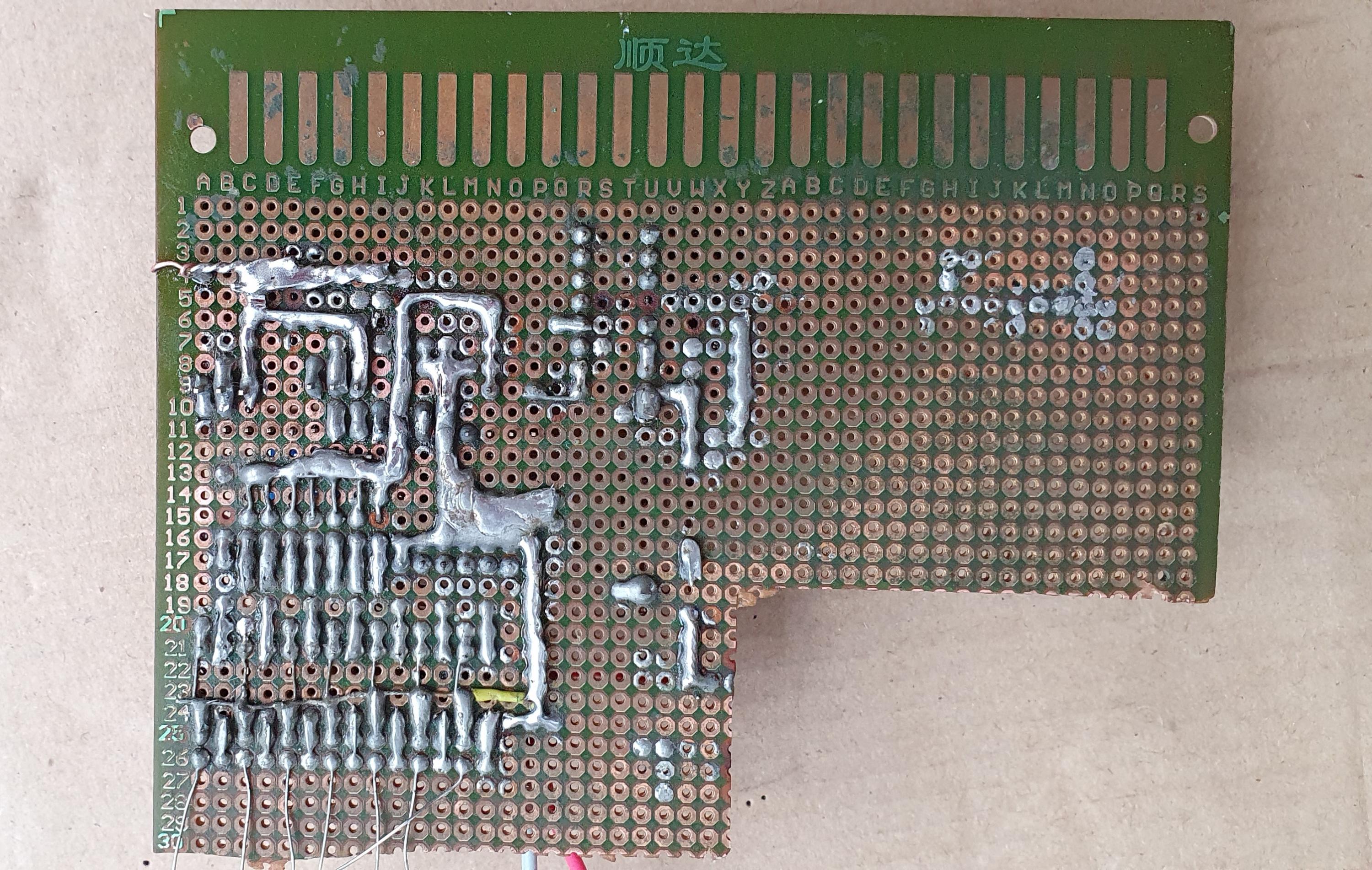

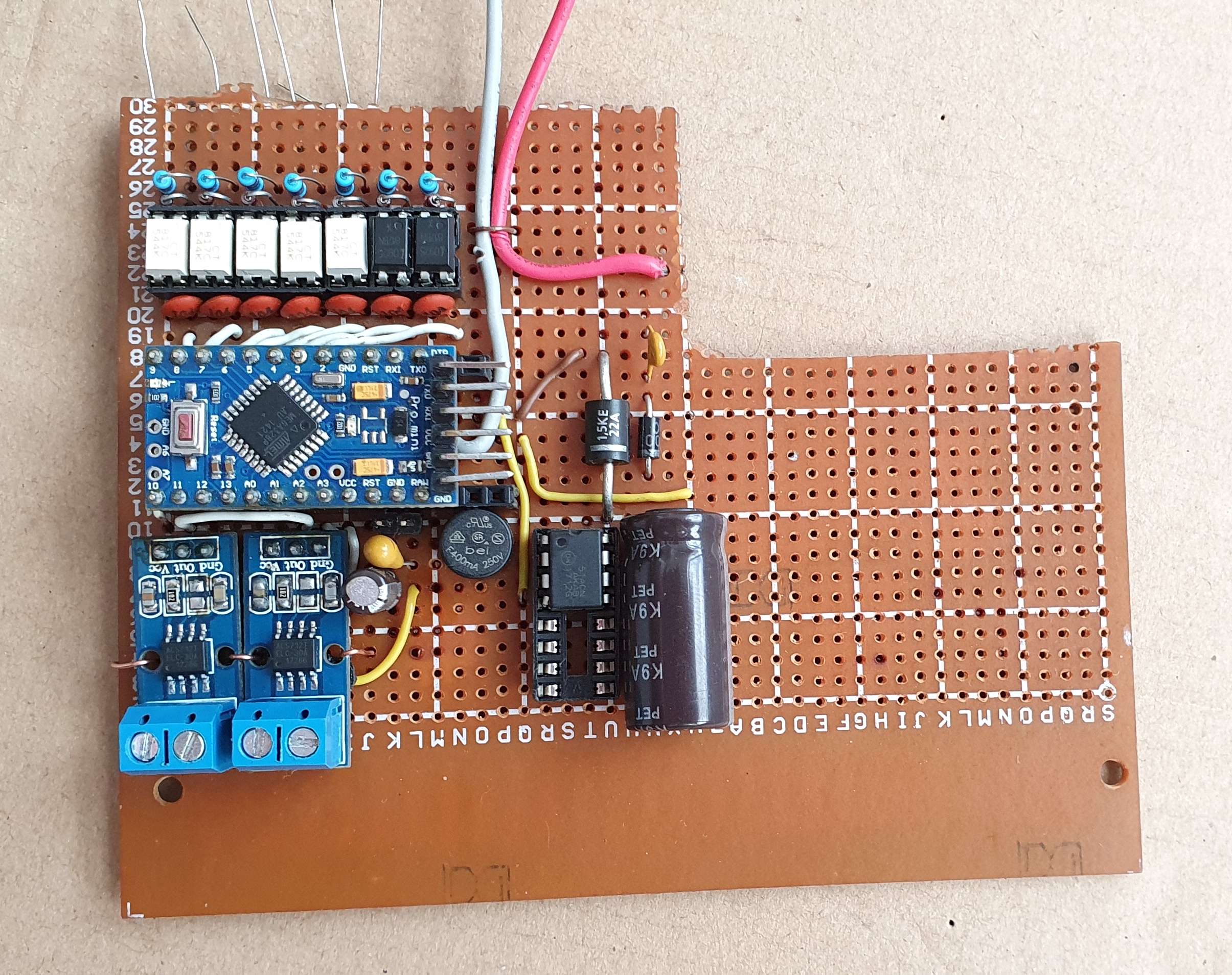

                                      Alright guys, here's an update on this project and some pics of the board which is almost ready, component-wise at least. Yes, it actually took me this long to work on it some more - go ahead and laugh
                                      I added the two current sensing boards in the lower-left today, but haven't done any testing because some personal stuff came up just as I was getting ready to plop the Arduino on the headers and upload the code.
                                      Your boy Danny also made a little screw-up: I ordered the wrong relays I ordered relays with 5v coils, which was the original plan, since I was planning to drive them directly with the Arduino, but then I thought 12v relays and transistors might be better, yet my brain must've been stuck on the 5v idea and hence I ordered 4 of those - fail.
                                      To make matters worse, the first set of 4 I ordered had a knackered one among them which had something rattling inside, so I had no choice but order ANOTHER set of 2 (the minimum quantity the seller offered), so now I have 6 big and blocky 5v relays......
                                      Ok, so what do we do now ? I was just about ready to start over and order a set of the correct 12v relays but that would take a couple of extra months to arrive and with autumn just around the corner here, my time is pretty limited to finish this project and install it (it's already taken a laughable amount of time), plus I don't want to get stuck with 6 hunks of plastic I paid good money for, so I'm thinking of using a resistor in series with them to power them off the battery and still use the transistors to interface with the arduino - haven't done the math yet, but the current on them seems to be around 0.17mA.

                                        How many ohms are the 5V relay coils? It looks like 1-4 of them could be on at once, worst case. A big 6V zener?
                                        • Dannyx
                                          CertifiedAxhole
                                          • Aug 2016
                                          • 3912
                                          • Romania
                                          #160
                                          Re: Running a microcontroller in car - power supply aspects
                                          Since the relay pulls 0.17a at 5v, I think it's possible to work out the resistance to be around 30 ohms, though this is on paper - haven't measured directly with a meter. Since it's a coil and has some inductance, there's probably other factors which influence it, but I think it's in the ballpark.
                                          I was thinking of simply adding a resistor in series with the coil to run it off 12v...
                                          Wattevah...
