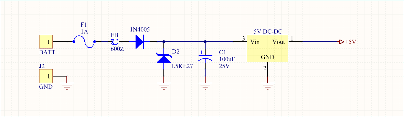

    Remember my EE mantra I keep preaching- "the fuse always comes first" - not after a bunch of stuff. You don't want the fuse after the 5V SMPS- if it has failed and the zener clamps, the SMPS will smoke and then what fuse is there? the 30A one?
    I still like the series reverse-diode because the car cannot discharge the 680uF cap.
    A 5.6V 5W 1N5339B zener clamps near 6V anyhow, I don't know if a ATmega328 would survive. I would not bother with the ZD7 protection on the 5V, if the 5V SMPS is dead then everything is dead.

      Re: Running a microcontroller in car - power supply aspects
      There IS a second 1A fuse in there after the 30A one (which is the automotive one already in the car's fuse box). I'm not sure how an LM buck regulator like that fails. Does it short to GND, blowing that 1A fuse, or does it become a wire, sending the input into the output ? If it's the first, then the 1A fuse should go. My "work" on the 5v output had been to protect against the second scenario.
      You mean post #9 ? THIS ?
      No, from what I read, 5.5v is the max you can hit an arduino with. That's why I currently have a 5.1v zener in there and that 82ohm resistor. It works, though I could probably get rid of the resistor entirely and lower the output of the buck regulator back down to 5v-ish, since it's currently at 6v to allow that zener to actually "work", so it's a regulator after another regulator, which I'm not sure how useful/practical it is...

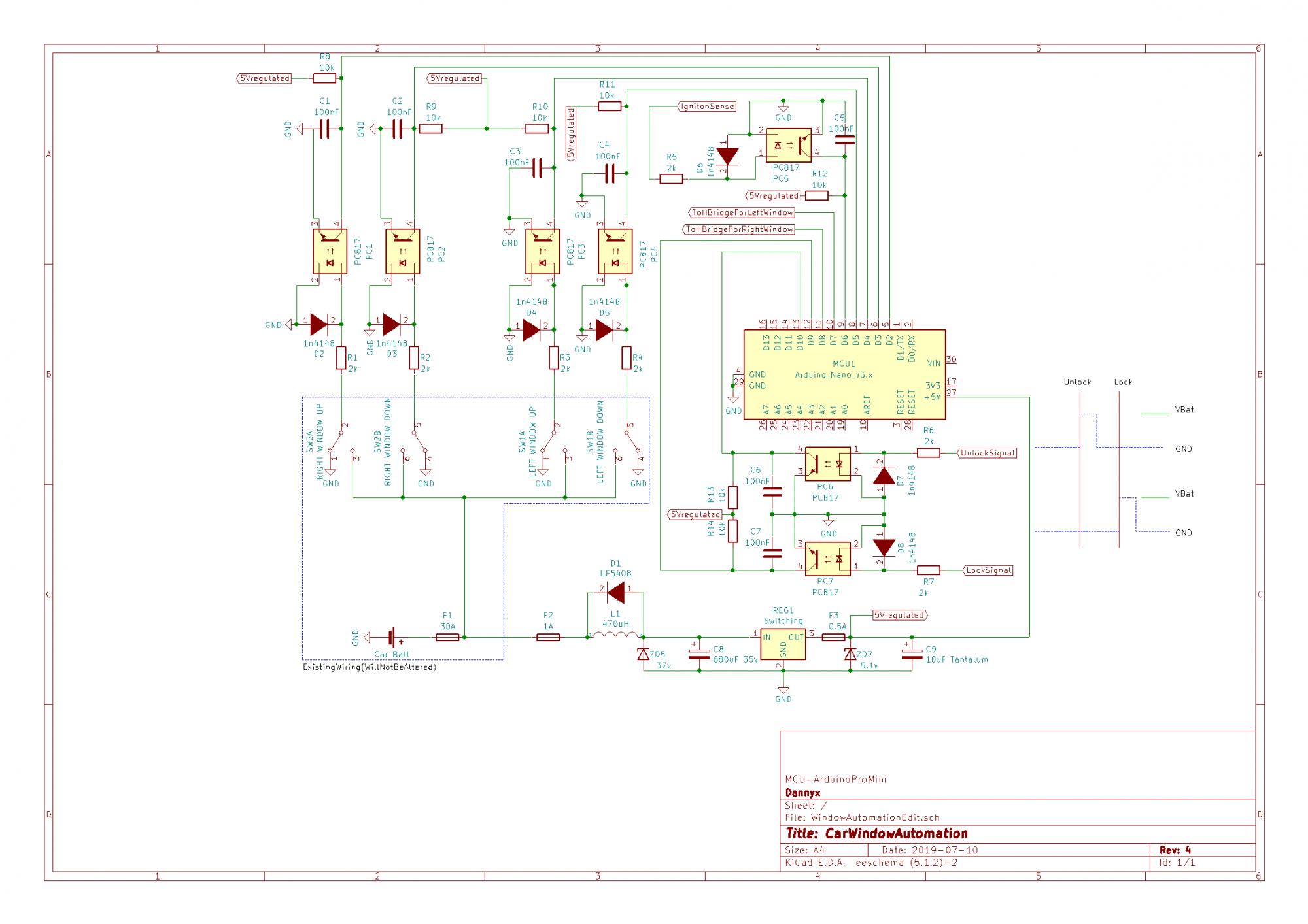

            #65
            I noticed some errors in my schematic, so here it is again. I also uploaded the KiKad file in case someone wants to mess around with it. Cheers !

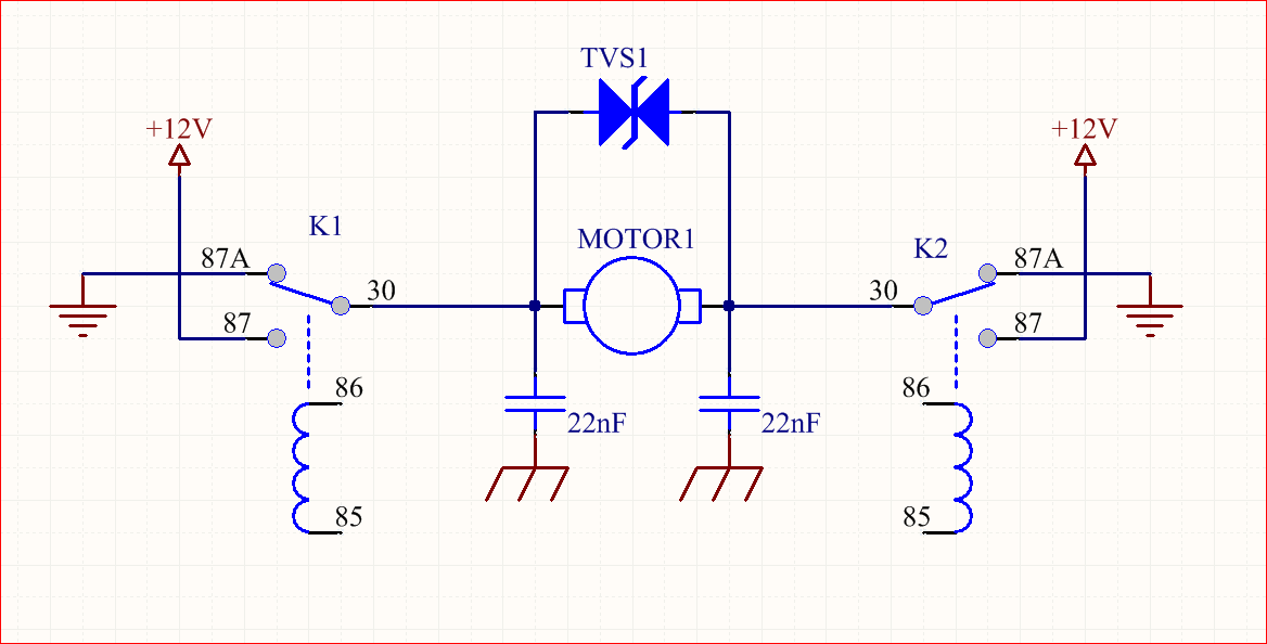

                #67
                Another decision I made is to go with traditional relays for controlling the motors rather than with an H-bridge. It's cheaper and simpler, but messier. I got myself a couple of ungodly relays and plan on using those to create a basic changeover arrangement to switch polarity.
                I'll have to add some form of arc suppression across their contacts + a transistor to drive the coils, since they're 12v and the arduino can't drive them directly.

                  #68
                  Originally posted by eccerr0r
                  I was caught off guard when working with a Variac where this statement is wrong or at least must be carefully revised...
                  Where a source of power is, always a fuse first - to prevent fire. No if's and's or but's. Any feed or branch circuit always has a protective element first.
                  A Variac with lone fuse after it does not give coverage for the Variac failing causing bonfire. It could somewhat protect it from output overload but not input overload. You would be surprised how many EE's are stupid and have no fuse anywhere, I think it's (fuses) actually a 4th year University course lol.
                  Originally posted by Dannyx
                  [...] I'll have to add some form of arc suppression across their contacts + a transistor to drive the coils, since they're 12v and the arduino can't drive them directly.
                  I used changeover relays for my power door locks, they are tougher than any H-bridge and I had no regrets. Just a bit big but oh well.
                  A snubber or TVS across the motor will protect the contacts and I would add a couple EMI caps so the Arduino does not crash when the relay contacts spark, as they always do to some extent. If the relays are close to the Arduino it can crash due to the EMI from the contacts.
                  A ULN2003 is a good relay driver or just use discrete transistors.

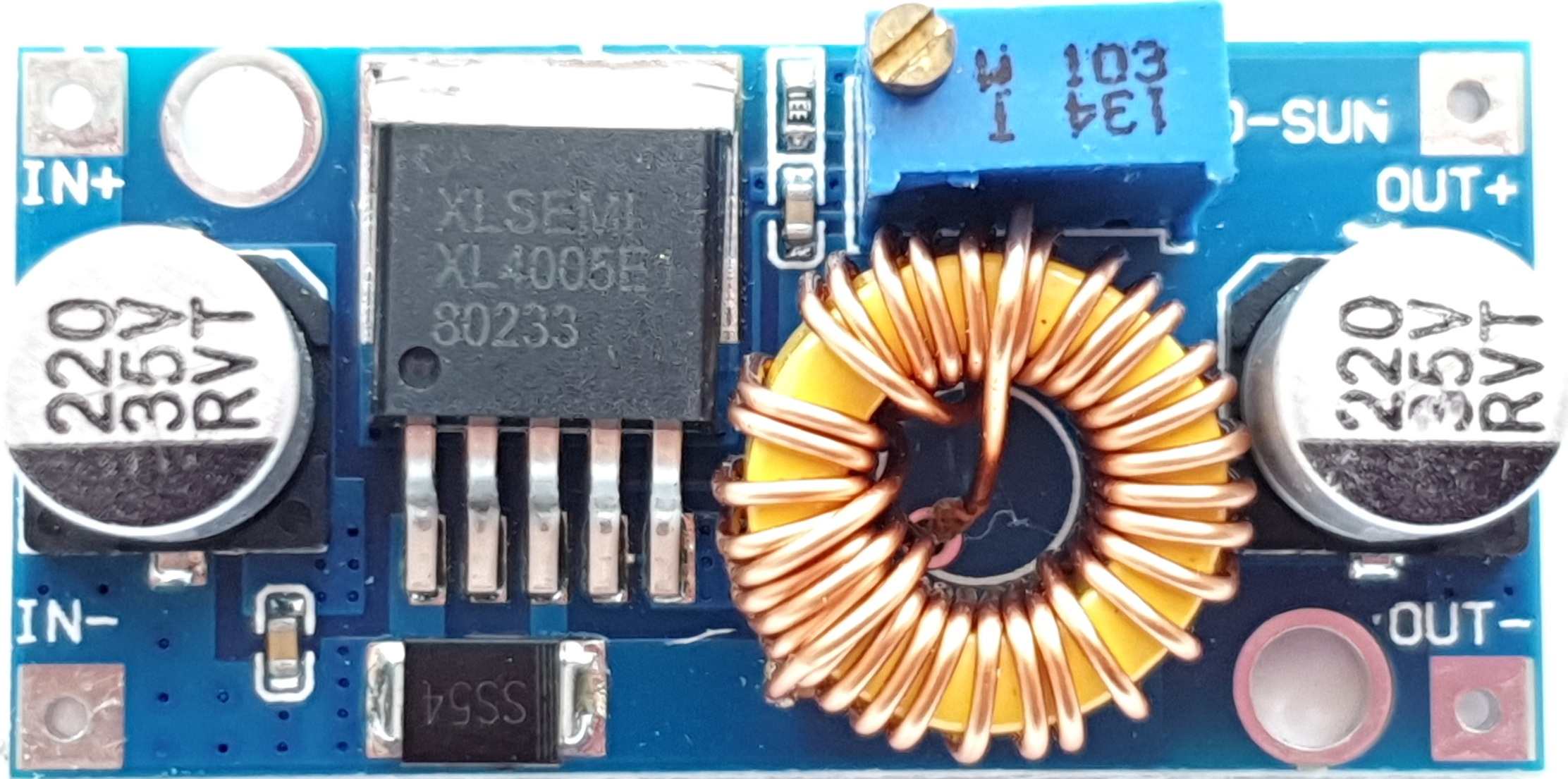

                    #69
                    I guess there are fake LM2596 boards out there. The IC runs at 50kHz, not 150kHz and put in a 1k resistor instead of the pot, for 5V out.
                    My main worry would be if the mystery IC can run at 30V input (during a spike). I would bench test the module first. The zener on the output with a 1A fuse I think will protect the Arduino if the module shorts and gives say 12V for a while.

                      #70
                      Yes - big indeed, especially at this high current.
                      R+C snubber like this ?
                      I was just thinking of that and yes, the arduino will be right next to the damn things, so I'll definitely have to do this. Where does this go ? Across the motor's terminals ?

                        #71
                        Maybe something like this sketch as a starting point.
                        For EMI, it depends on the motor's wiring (long run or not) and if the metal housing is grounded. The brushes arcing can make EMI as well.
                        I think a bi-directional TVS will limit the back-EMF from the motor and the relay contact arcing will be small.

                              #74
                              My buck converter doesn't even have an LM on it - it's a XL4005E1 so this should be interesting

                                #75
                                It looks not bad, many chinese DC-DC have a 1A diode which quickly cooks.
                                Arduino Nano uses about 20-35mA, so I wonder about using a 5A buck converter? If it is OK with light loads and regulates OK- but it might waste power.
                                I think the spec. limit for a car is about 70mA quiescent drain before the battery goes dead when the car is parked for a few weeks. Subaru firmware bug made their ECU use 150mA, which quickly wore out and killed the car's battery and pissed off all the owners who had to buy a new battery.
                                You can put the Nano to sleep and wake it up if IGN is on. The USB IC apparently draws most of the current.
                                I use a small LDO LP2950 for my MCU car projects, and the bigger 5A TPS40057 modules for USB car charging cell phones. Those use about 50mA (with LED) at rest.
