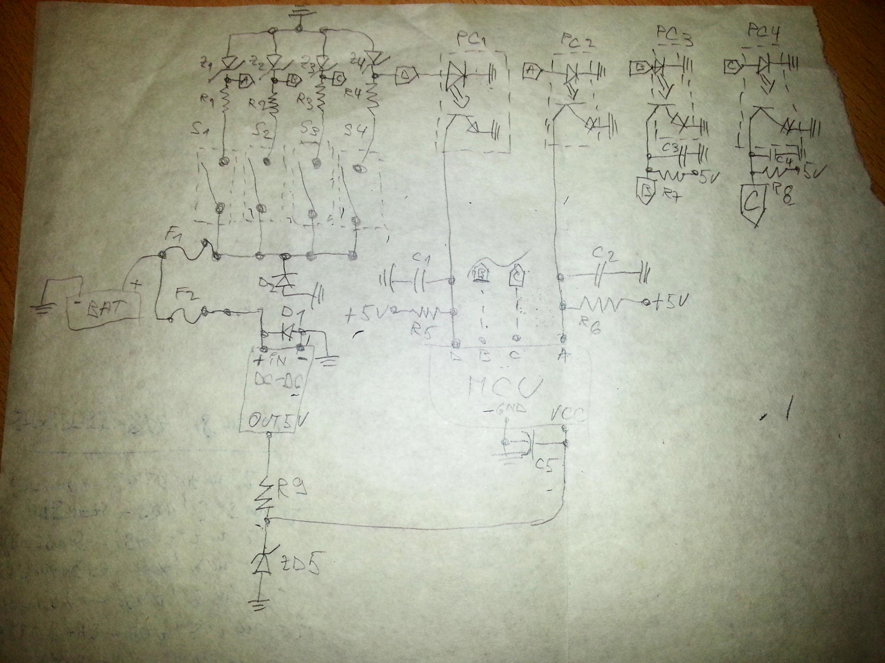

    Good day folks. Some of you may know that a while back I was messing around with a little Arduino Mini and made up a little circuit to automatically roll my car windows up and down and all that jazz...not important right now. The project is built and runs as it should on a breadboard on the bench, so I thought before transferring it to a perfboard and shrinking it down, I should go over the power supply section and how I'm going to power this thing, since the electrical environment of a car is not the same thing as on the bench with a wall wart and there could be some problems down the line which I may have overlooked. I may have actually gone overboard with the power section and wanting to make it as bulletproof as possible, it probably had the opposite effect and I gravitated away from electronics industry standards and made it more complicated and inefficient if anything. This apparent complexity may not necessarily result in a better electrical environment for the micro itself...
    There's a diagram attached and it's a bit of a mess, so please bare with us
    1) it's powered all the time, so I'll wire it straight off the battery.
    2) the top branch which goes through F1 is straight off the car's system - no regulation at all - so it can be anywhere between 11v and 14v (and probably more due to inductive spikes ! !). The reason for this is because those switches (S1-S4) are actually the rocker switches for the power windows and they're already wired in to the car, so I want to keep this as PnP as possible and not alter the existing harness, so rather than implementing my own step-down circuit here as well, I'm doing it this way: the voltage present at those switches goes through R1-R4 when the switch is pressed, to the 5.1v zeners Z1-Z4 (just noticed ZD would be the correct notation for those, but anyway) and to the anodes of optoisolators PC1-PC4 respectively. This pulls the collector low which in turns pulls pins A-D low and the micro know what button was pressed. There's two windows and 2 directions (UP/DOWN), so 4 sets of each. Hope this makes sense. I only drew 2 of the pins, and added "tags" for the other two. Also, the H-bridge which will be used to actually drive the motors is not pictured ! This setup is perfectly functional on the breadboard right now as it is.
    3) to power the micro itself I send "V-BAT", let's call it, though a DC-DC step-down buck converter which drops it to around 6v and then did something which you probably shouldn't/don't need to do and send that through a resistor+zener combo AFTER the buck converter itself, the thinking behind this being that if the buck converter overshoots or shorts out for any reason, the linear zener regulator would still prevent V-BAT from shooting straight into the micro and killing it...THIS is probably the most "incorrect" part of this whole setup, despite being functional. It's worth mentioning that I'm powering the Arduino Mini straight via the VCC pin and not using the on-board regulator via the RAW pin. In fact, I removed the regulator from the board entirely. Maximum energy conservation is also important.
    4) values for the components:
    • C1-C4 are 100nF ceramic caps
    • C5 is a 10uF tantalum
    • R1-R4 are 1k
    • R5-R8 are 10k pull-up resistors
    • R9 is 82R
    • D1 and D2 are UF5408 Schotkkys
    That's it for now Let me know what you think and what should be improved. Thanks.

    Honestly, what you are planning sounds pretty good. If you were worried about power spikes, you could probably improve things by putting in some additional filtering at the source, like a 25v 100uf and then an inductor, but that would probably REALLY overkill. (Especially if the MCU is a mini, which can already handle up to 12v.)
    Probably, if it were me, I'd just go with what you've written out and then add additional filtering later if it becomes a problem. Though, I'm just a hobbyist too, so a pro might come by and make me feel quite foolish. lol
    A question on the Schematic. On those optocouplers, were you meaning to draw this (or I might be misreading) with the "transistor" side bypassing the switch? Then were you thinking of turning on the optocopular using the io from your mcu? At the moment I'm reading the schematic like you are wanting to be able to send an output to the mcu when you press the switches on your car's panel. I could be understanding things a bit wrong though.

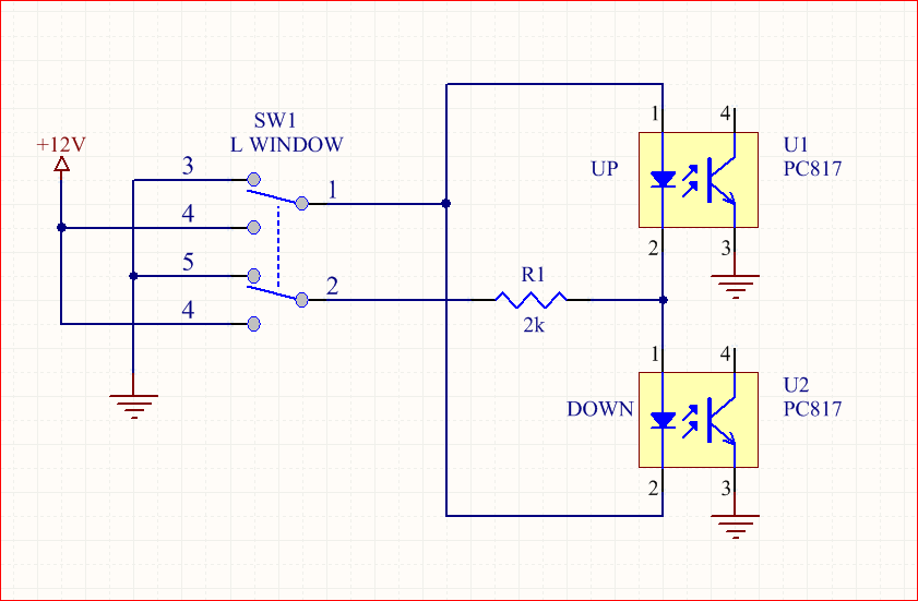

      Correct: those switches are just a schematic representation of the 2 switches for the windows. Each has two possible states: UP and DOWN, obviously. Let's say S1 is UP for the left window and S2 is DOWN for the left window. When the switch is closed, the linear zener regulator becomes active and the LED in the optoisolator is turned on. The transistor is thus turned on and the I/O pin is pulled low. When the switch is released, the LED "dies", the C-E junction becomes resistive and the pin is pulled back to a HIGH state via the 10k resistor. Hope that clears it.

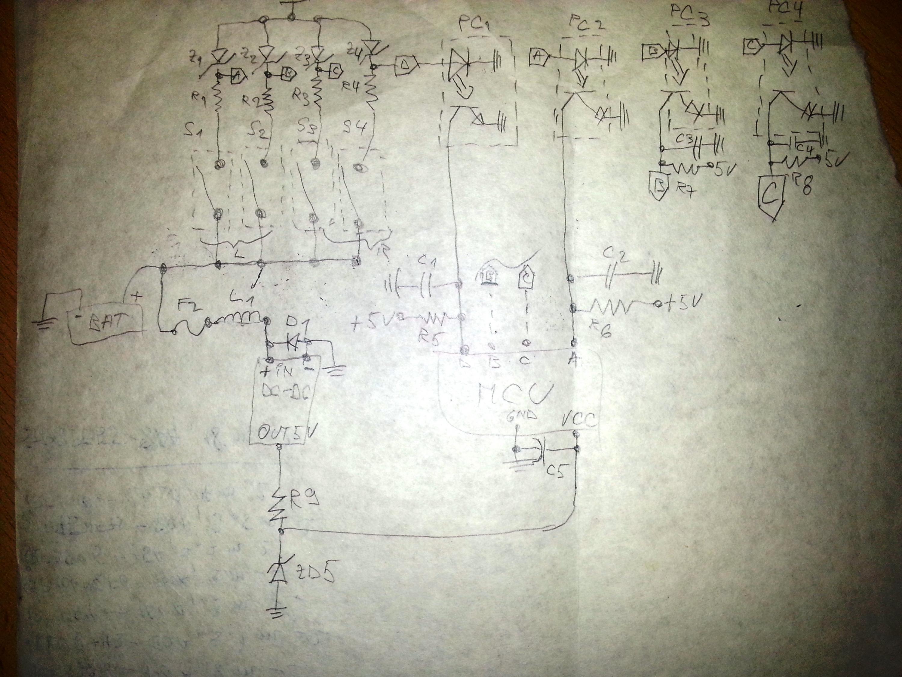

            Just realized I made a little f-up in my diagram and should also explain in more detail how those switches actually work, since it may be confusing to some: the 4 switches in my diagram are just schematic representations of the actual rocker switches on the dash. Notice I added L and R for the two sets. In reality, there's 2 rocker switches (one for each window) and each of them has two "poles" which are pulled to either VCC or GND depending in which position they're "rocked".
            This diagram explains it: when "resting", both poles (1 and 2) are grounded. When rocked to either side, one is pulled to VCC while the other one continues to stay grounded. In my case, imagine pole 1 of the switch in the diagram goes to the linear regulator formed by R1 and ZD1 and pole 2 goes to R2+ZD2. What happens is when the switch is pushed in the "down" position, R2+ZD2+PC2 become active and the micro's A pin is pulled low, telling it to do.....something, doesn't matter. Likewise, when pushed into the "up" postion, R1+ZD1+PC1 become active and pin B is pulled low. I don't think there's any problem with the linear regulator staying grounded when not in use, since (if you had your thinking cap on) you'll notice all 4 resistors remain grounded when the switch is resting, or at least one of the poles will always be at GND.
            The way I tap into this is I cut the two wires currently going from the switch to the motor (from pins 1 and 2) and I'll solder matching male-female XT60 connectors to both the switch side and the motor side of the resulting wires. The "control" input of my control box will also get an XT60 connector that accepts the one coming from the rocker. The output of the H-bridge will get one that matches the one going to the motor. The reason I'm doing it like this is to allow me to quickly revert back to the stock setup if something goes wrong, by removing the box entirely and plugging the switches right back into the motors as they were, since the XT60 connectors will not only match the box but each other as well.
            Now, F1 and D1 will not be there, since that part (before the rockers) is already present in the car and will not be messed with. What I have access to is the "outputs" of those rocker switches, so I'll only be able to tap into where the "poles" of the switches are. The correct diagram would look like THIS then (can't get the damn lighting to look any better ).
            Also, you're saying I should drop choke L1 in series with the buck converter like that ? Also remembered what you said about the caps on the input of the buck converter, but I had already snapped the pictures, so let's assume there's a cap after L1

              Consider this for the window switches. You do not need protection zeners or diodes because one opto protects the other against reverse spikes, and +ve spikes get current-limited by the resistor. Even a 100V spike is about 50mA for the LED- which it can take.
              What is the 5V DC-DC converter, how many volts is max. input?
              I use a 27V TVS (1,500W to 6,600W) at the input to limit +ve spikes to ~40V like 1.5KE27A or larger. I would have it for D1 instead of UF5408.

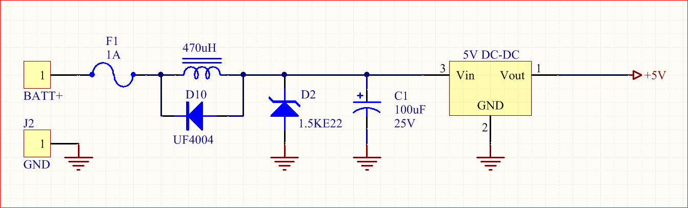

                  This is what I use in cars. For me it's quicker to draw it in KiCad or Altium we use at work. A pencil is more powerful but taking pictures of paper sucks.
                  If you use an large inductor to filter out ignition and fuel pump EMI, it can add to a spike sometimes and make them worse. So you have to be careful. If I have room I add 100uH-1mH with a diode across it, instead of ferrite bead.
                  Your 5V regulator needs to take ~30-40V input max. and 6V min. or else the Arduino will reboot when you start the car, cranking gives low voltage.
                  I think an Arduino Nano needs around 20mA. I use an LDO LP2950 to power it and a sleep command to go down to a few mA.
                  I can explain each part if you want to make sense of it.
                    So I should have the diode reverse-biased across the coil and place this setup in series with the input to the regulator ? What diode should this be ? A regular 1n4007 or an UF one ?
                    The DC-DC converter can take 32v max apparently.

                      I know adding a filter inductor is a good idea but it added new problems.
                      The inductor back-emf can make a spike worse, so they add a diode across it. This is the circuit I remember. I will check with the people I know that design automotive ECU's.
                      Are you sure the LM2596 can run off your car battery? I thought it uses a lot of current, and more with an Arduino running. You should measure it, or run it off IGN power.

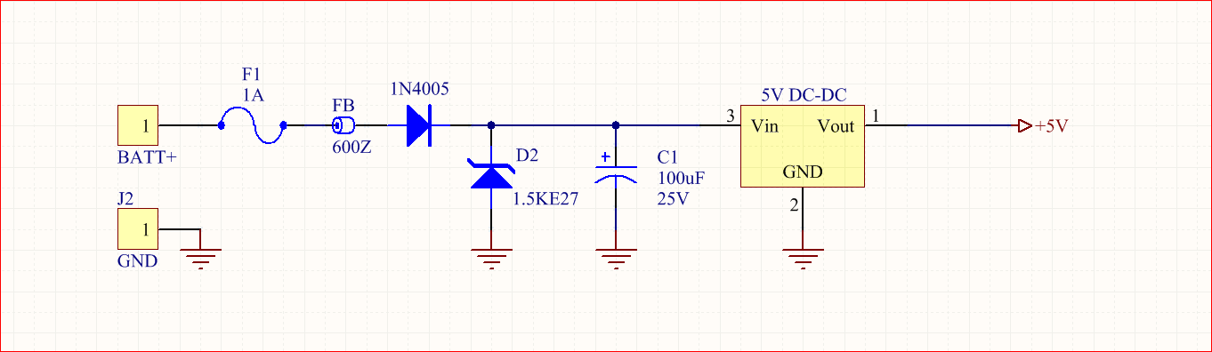

                                    If you put a scope on a car's 12V power, there is a lot of low frequency noise from the ignition system, fuel injectors, fuel pump motor, alternator ripple etc. It is a few hundred to a few kHz, and over a volt pp.
                                    It is worse if you have an old battery or old wiring connections like rusty grounds and battery terminals.
                                    The noise is differential (not common-mode) so it is between 12V and GND. A mains SMPS makes lots of common-mode noise (between LV secondary and earth GND). Rare to see a CM choke in a car.
                                    If it's an old car with a distributor, which makes a lot of RF interference and is one reason car makers went to coil-on-plug. It's hard to read an O2 sensor when you have many kV arcs in the distributor nearby.
                                    An inductor on 12V input helps with noise in either direction (coming in from ignition, or going back from 5V SMPS to car). For analog car stereos it used to be big iron-core mH's and now 22-470uH choke or whatever fits is still enough.
                                    The minimum is a ferrite bead and TVS+reverse diode. The ferrite bead is to stop high frequency >1MHz noise from affecting AM radio of the ECU.
                                      Ok, so no CM choke then. Your last schematic seems to be what I should go for - the one with the 470uH coil and diode across it.
