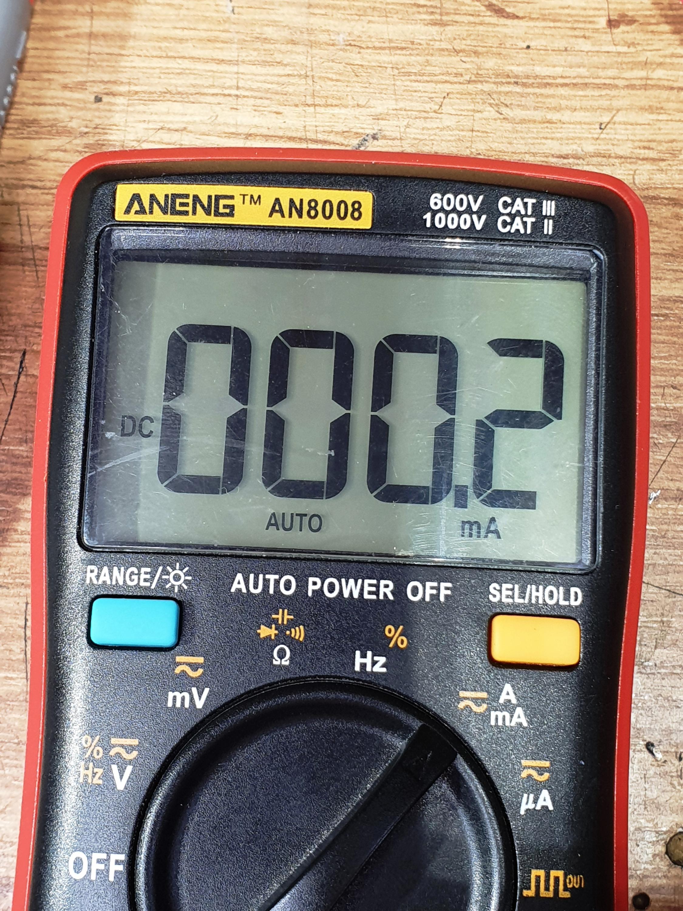

          #124
          Re: Running a microcontroller in car - power supply aspects
          Progress
          It works and draws 4mA without the Arduino plugged into the headers and without the current sensors (wanted to make sure it actually generates 5v there before I plug anything in...come to think of it, I should probably make the current sensors removable too...
          Back to the bench now

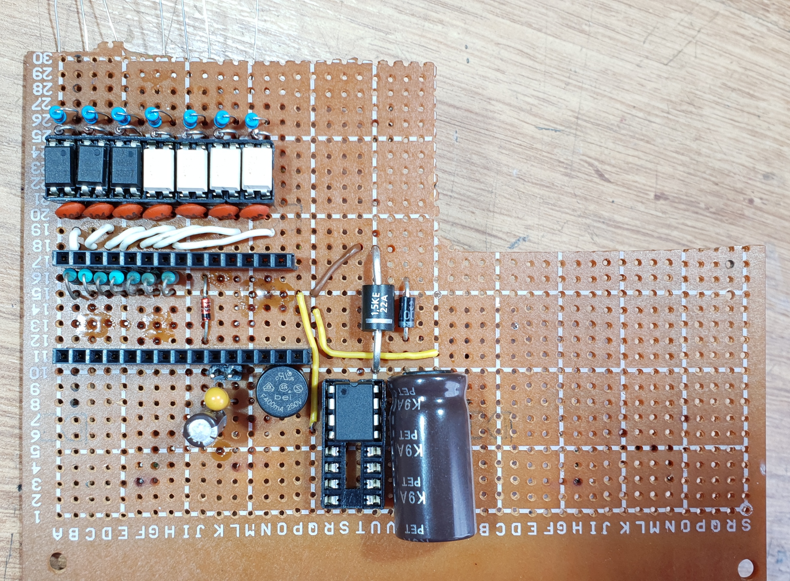

            #125
            With no MCU, 4mA drain seems a bit odd? LP2951 uses 0.1mA and I did not see anything else in your circuit using current.
            • Dannyx
              CertifiedAxhole
              • Aug 2016
              • 3912
              • Romania
              #126
              Caps perhaps ? Maybe some leakage on those diodes and optocouplers ? It'd sure be great if I could trim down the power draw even more...
              Wattevah...
              • redwire
                • Dec 2010
                • 3912
                #127
                It just seems weird, I would go after it because it's high.
                You can try pull IC's out of their sockets and see if that narrows it down? But remember the cap has a charge before putting the IC back in. The diode under the Arduino, if it's 5.1V zener maybe or the tantalum is leaky?
                The big 680uF cap would have mA leakage if it's a CapXon lol.
                • Dannyx
                  CertifiedAxhole
                  • Aug 2016
                  • 3912
                  • Romania
                  #128
                  The diode is indeed 5.1v, though the voltage across it (the VCC of the Arduino) is 5v exactly and I heard zeners actually take a bit more than their nominal value to break down and start conducting. I could try pulling it off to see if it makes a difference, though it's soldered in really well...it will be a nightmare to do. Same goes for all the other non-socketed parts thanks to my "patented" method of bending the leads to form tracks - it's one of the huge downfalls of this idea >_>
                  It's a 1000uF Samwha WL series, now that you mention it...not sure what to say about it. I read it's slightly "over" the RD series, but inferior to the WF series, if this is at all correct or relevant...
                  Wattevah...

                    #129
                    Just try pull the Vreg IC out of the socket, then you can see if it is ahaed or after, the current drain.
                    I find chinese electrolytics have high leakage currents.
                    • Dannyx
                      CertifiedAxhole
                      • Aug 2016
                      • 3912
                      • Romania
                      #130
                      I'll remove the IC and supply 5v directly with an adapter or something and measure the current draw on that. It'd be great if it's just the cap, since I can easily remove it and replace it (hopefully with something better quality)....
                      Wattevah...

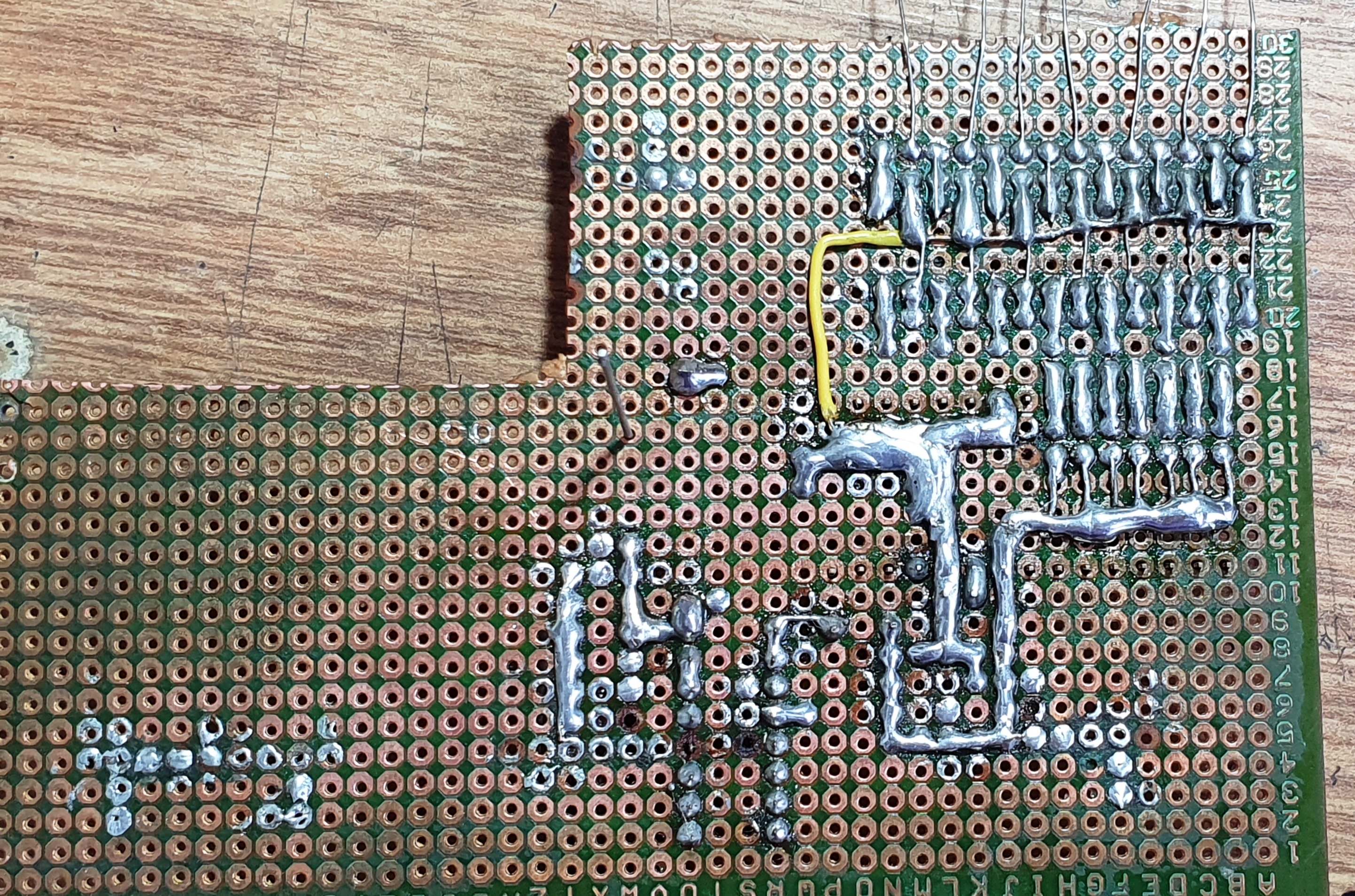

                            #133
                            I came up with an idea to try and track down the part that's drawing spurious current without having to tear the traces apart: I started by removing the IC and optocouplers from their sockets, since it was the easiest thing to do. I then supplied 5v to the "regulated" output of the IC from an external PSU and measured the current draw on that - 4mA are still there, so it's not the IC, nor something on the 12v side.
                            I then tried out each type of component individually with the power supply, by using an identical one from my parts bin and placing it in series with the bench supply and my ammeter, including the three types of caps and the 5.1v zener diode. None drew any current at all. The zener diode starts breaking down at around 5.5v, as a side note, which is great news because that's the maximum the Arduino's VCC pin can take.
                            I then supplied 5v after those pull-up resistors, to confirm whether it's those ceramic caps that draw current, since they were the only part remaining on the board, but no they're not: I get no current draw here at all ! With all said and done, my money is on the small 10uF electrolytic or tantalum cap on the 5v rail (on the output pin of the IC), although I tested these individually and neither drew any current at all ! I must admit the idea of placing two types of caps of the same value (10uF) on the output of the IC is an undocumented/unfounded idea of mine that I came up with on my own, fearing a single electrolytic may fail due to the hot environment and result in the output overshooting (having seen what the IC does with NO cap at all >> 10v on the output !), so the more professional folks out there may be quick to pan this, but hey - learning
                            Wattevah...
                            • Dannyx
                              CertifiedAxhole
                              • Aug 2016
                              • 3912
                              • Romania
                              #134
                              Sorted. It turns out the zener diode ZD7 was clamping too low for some reason, causing excess current drain. I removed it and replaced it and it's now working as it should
                              I also installed the polyfuse, so this whole thing is ready to be tested on the car now
                              Wattevah...
